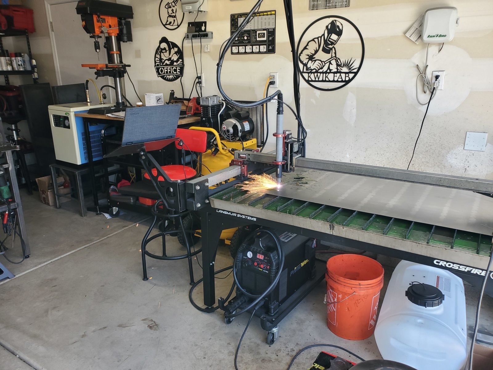

    Rarely make anything personal so I went out to grab some steel
    Little sign to go above our aquarium; 22" x 13"
    Unfortunately, I got lazy and kept my bigger nozzle on causing me to lose some detail, but it still cut alright
