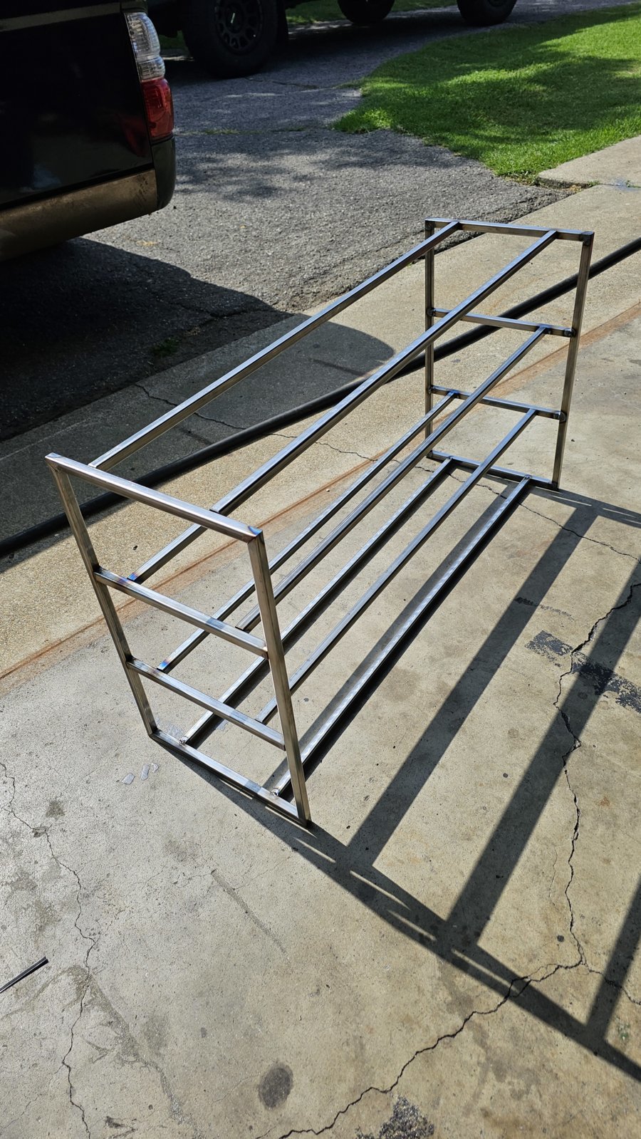

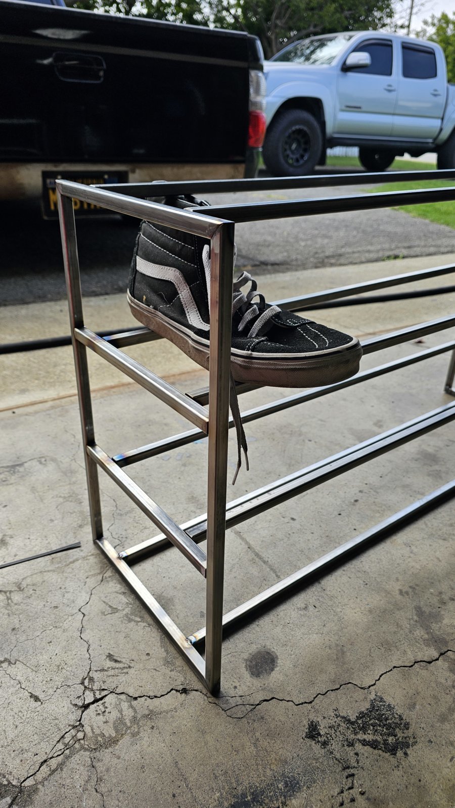

    Damn! That huge for 1 shoe!

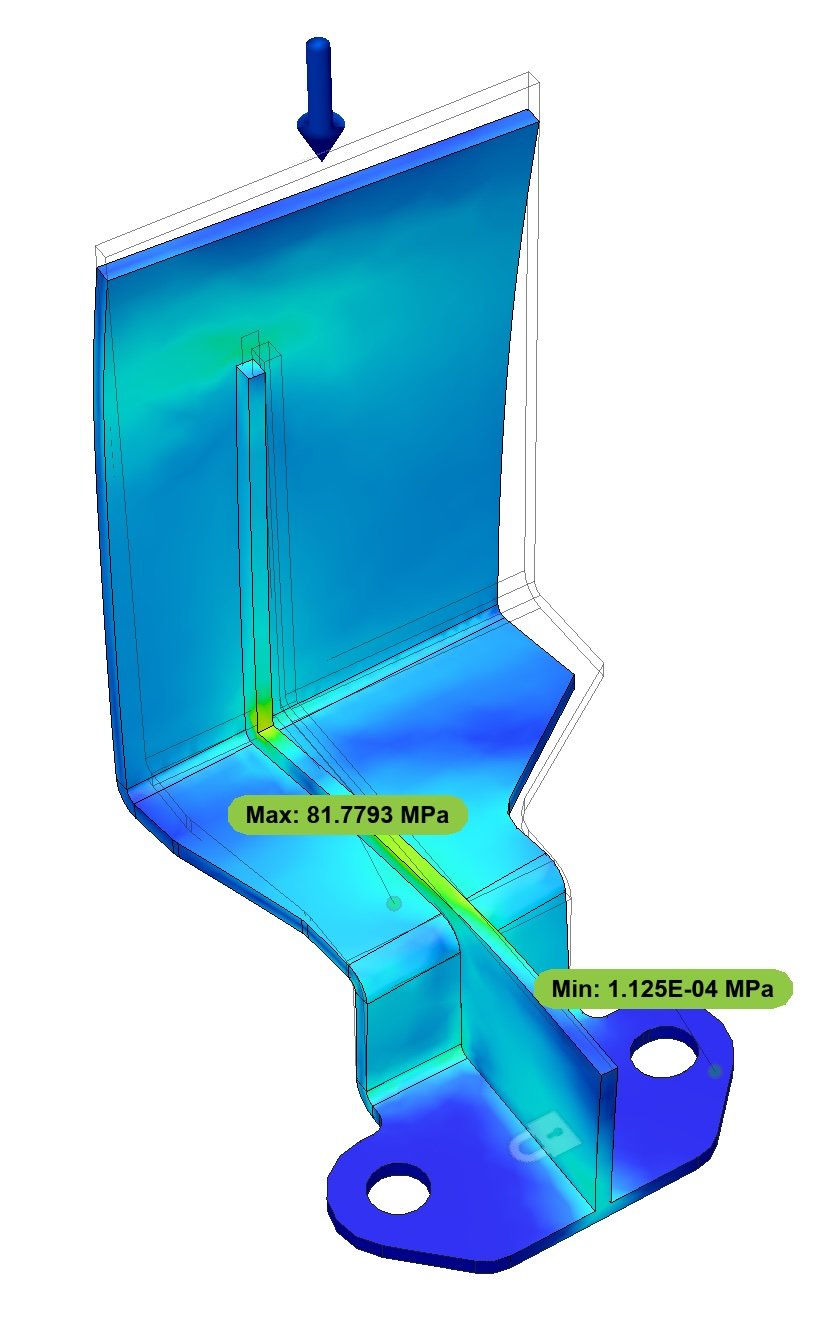

    I think it gets lost. I feel like I am pretty darn good at solid modeling and making my timeline bombproof. Change a feature early in the timeline and no red or yellow. But once I started introducing sheetmetal features... Chaos! For instance... I changed the height of a flange in an assembly a few steps back in the time line. Just the height! I didn't change the .... topology (?) of the part at all just a length. Fast forward to the end of the timeline and a later flange was inverted - "references could not be found" yeah because they were on the other side of the planet! WTF? Anyway, with any luck they'll keep improving it. Lol. When ever I get pissed at it tho, I remember I'm paying like $350 a year for it compared to the $25k seat with $1400/year maintenance I used to pay for my seat of PTC! Yuck! I will work around some bugs!
    Plus the simulation stuff is really frickin' cool - I can't believe it comes with the package. Played with it a little more for this cargo platform I'm making... so cool! new design 5x stiffer!stress.jpg

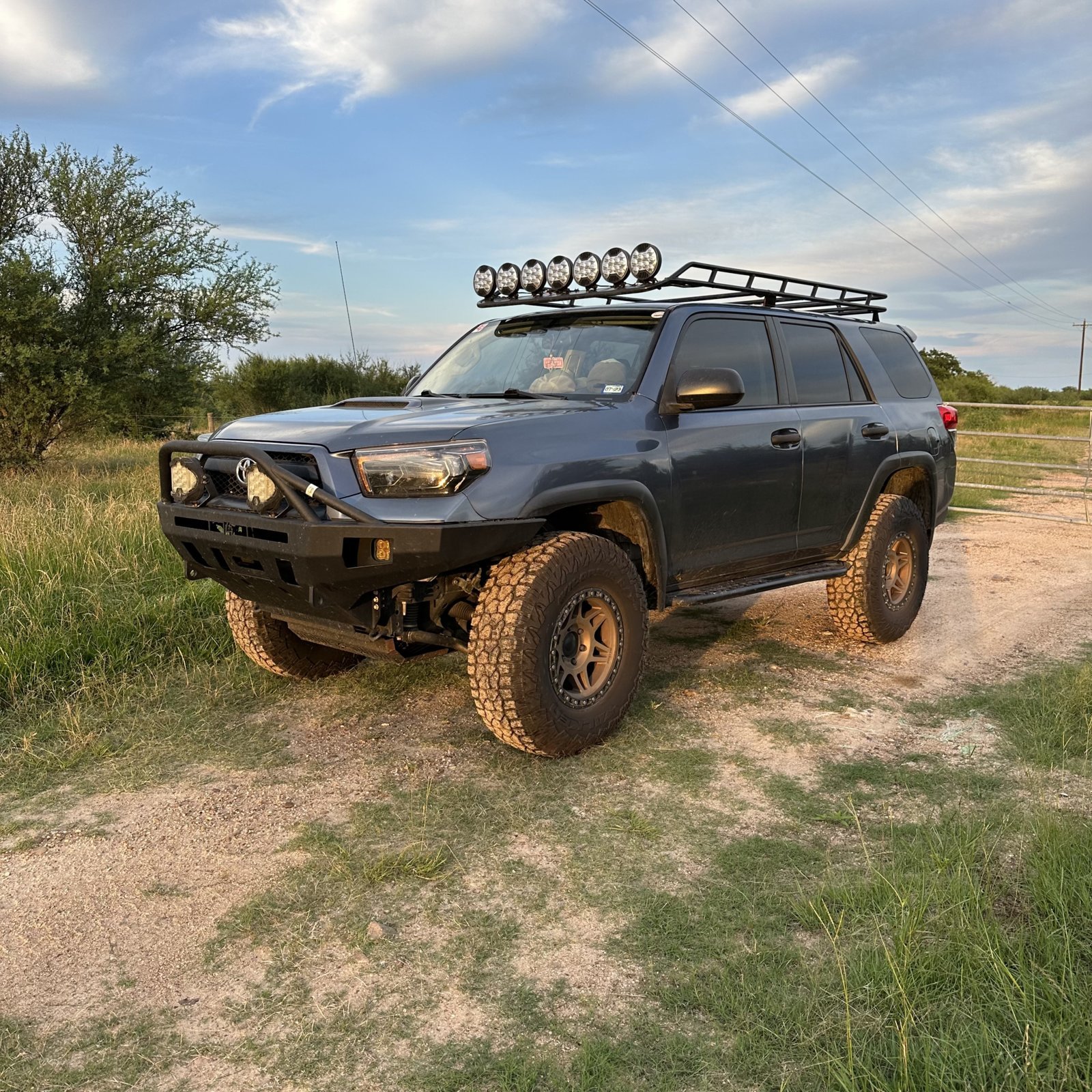

    4wd to 2wd conversion

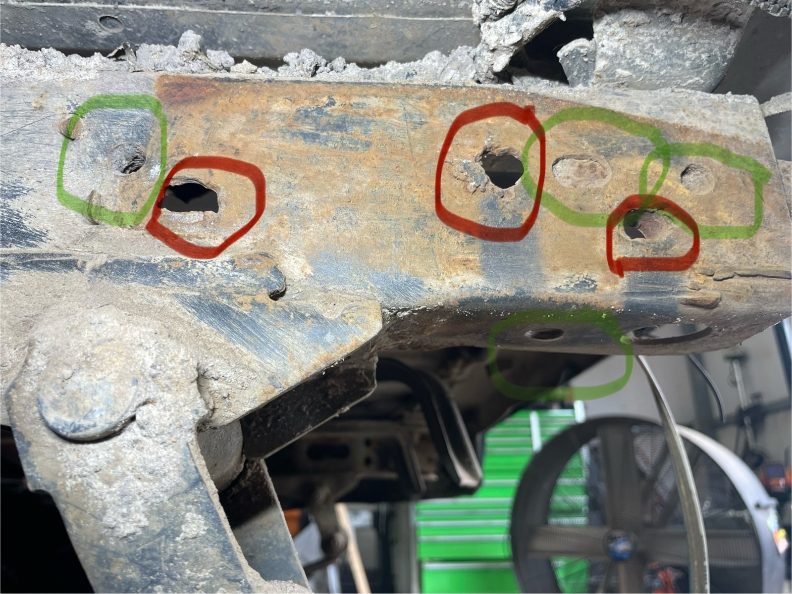

    Hopefully this picture is better with the bumper off. The holes circles in red are on the outside of the frame and are the holes that we blew into the frame to make the current bumper work. The ones in green are the original mounting locations. The second picture is the inside of the frame rail. I’m wanting to put a bumper on that has an integrated class III hitch and I’m worried the frame might be comprised from what I previously did.

    It's C channel as I recall correctly so why not box it in by putting plate on the inside?
    As for those holes...looks like someone took a chisel to a rock :rofl:
    I'd hit everything with an angle grinder (with a wire wheel) and reveal the good and bad. Plate what you need to reinforce.

    Putting plate on the inside was my initial thought but I was unsure of how thick of a plate I would need and what would be over kill….still learning.
    yeah, they’re terrible :rofl: oh the joys of redoing things your younger self didn’t think through haha!

    i would match the frame rail thickness, as that's going to be the maximum carrying load anyways.

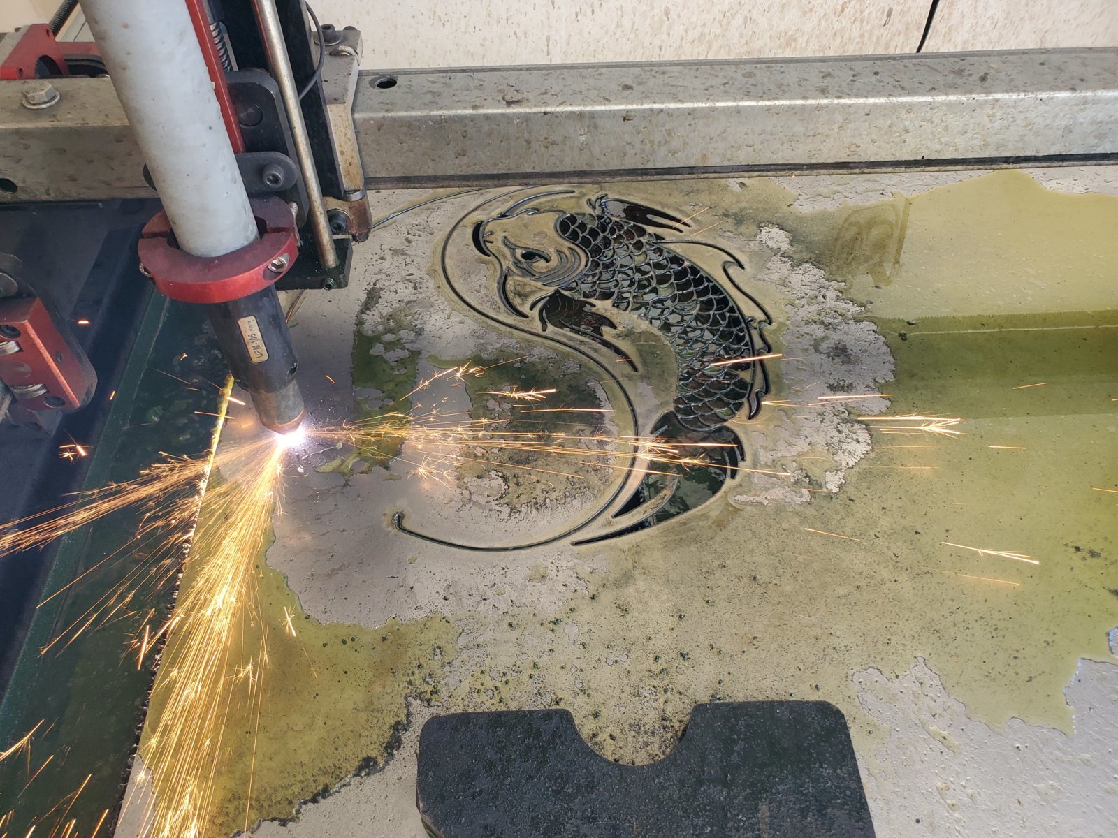

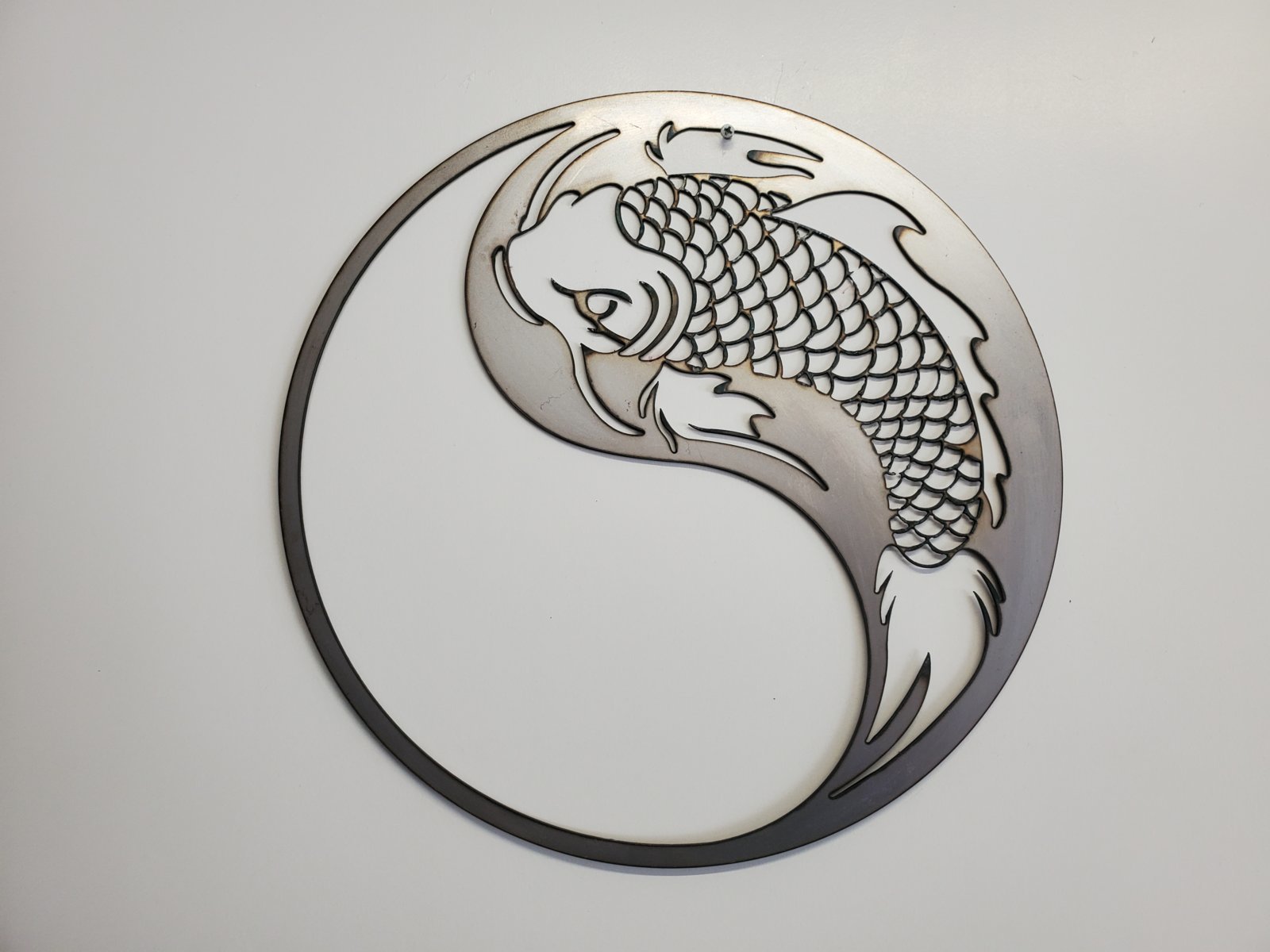

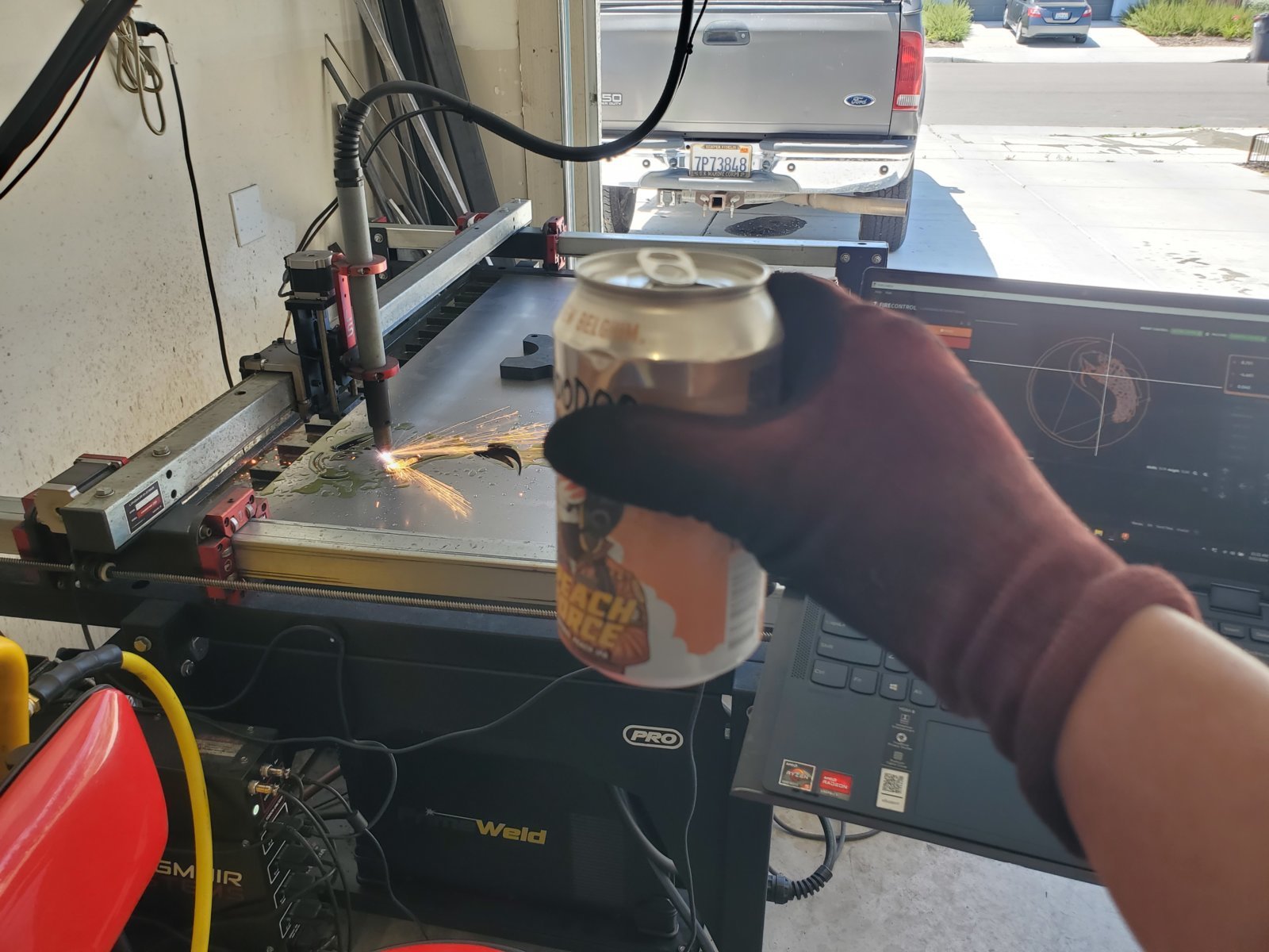

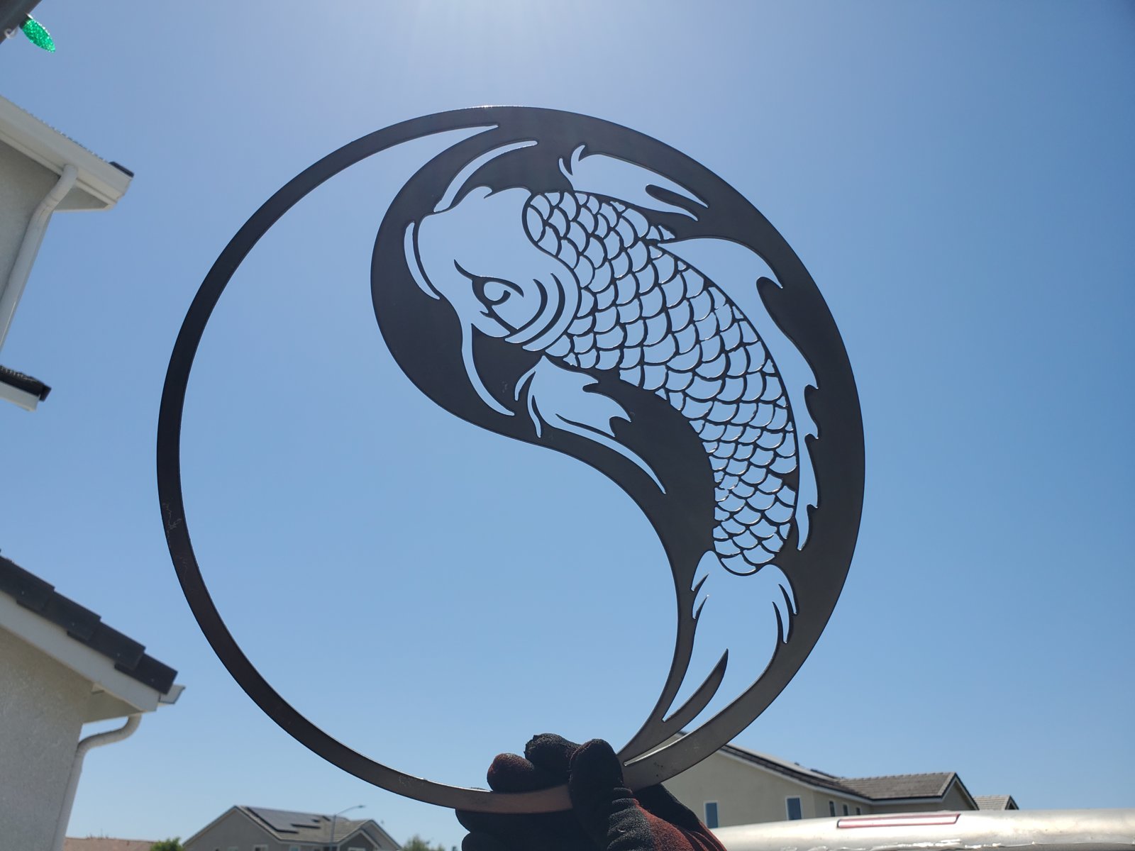

    Spent a little time in the office today
    Problem? I forgot to switch my nozzle (again) so the scales came out jagged
    It'll live in the garage and I'll just cut another one out
    Was supposed to be for my cousin who we're gonna see when we go up north this weekend; he's got a pond with koi fish
