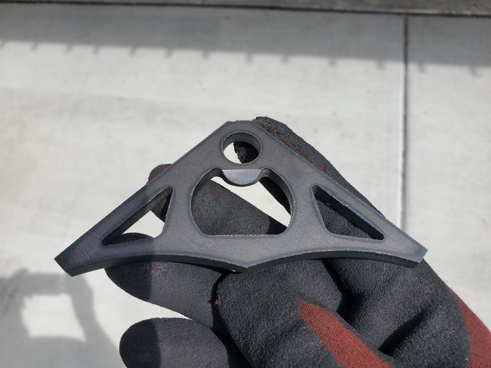

    I've seen those and actually welded some somewhere. I haven't figured out why A&A-mfg doesn't sell them. Or Toyota logo for that matter. Or the Chaos logo...now we're talking.

    Well, with the boom in "overlanding" a lot of people prefer this sort of stuff to be an add-on in the drop-down menu when ordering their $1,500 modular roof rack :rofl:
    That or using their REI titanium bottle opener.
    Since I'm poor and use plasma instead of laser, I can't see how I'd get a clean Toyota symbol in that 3" tall gusset. If I had a laser CNC setup though, easily!

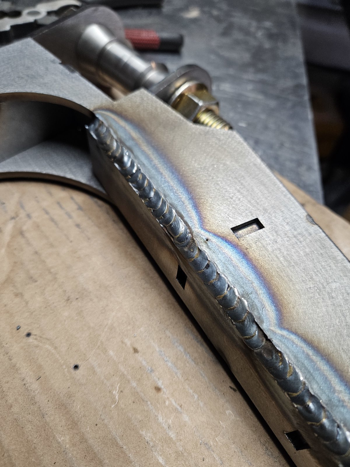

    For the seasoned welders out there, could someone provide some criticism on these welds just from a visual inspection? Looking to improve.

    I think they look great!
    My 1st impression is you might get a little better smoothness by going down a size in wire.
    If you wanted a rounder weld, you could incorporate a very small amount of weave, but seriously, that is just fine.
    I wouldn't have an issue seeing that type of weld on something I needed welded. I'm struggling to find anything wrong with it.

    Awesome! I appreciate the feedback. I'll give that a shot.

    overall looks good to me. the large spacing between puddles makes it appear that you're moving slightly faster than your wire speed setting, but the heat marks and and material edge indicate good material penetration with the correct voltage settings
    so you can either move the torch slower, or raise your wire speed slightly. you can also play with your technique more. from the bead profile, it looks like you're doing a straight back pass, move back half, pull back full, etc. right? i would try reducing the distance of each pass by about 1/3. but honestly, that's really only a final-look aesthetic alteration. for what i can see with the material thickness, i would absolutely trust that weld to outlast the metal it connected to in a failure.

    Thank you as well! Yeah, you are right; i was moving the torch forward and back. I will give those tips a try. Again, I appreciate it

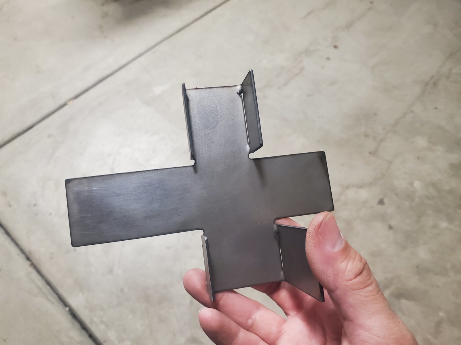

    Put the kid down for a nap earlier and knocked this out
    Using internet provided dimensions (not complete) I'm hoping this comes out real damn close which it should
    Worst case it becomes a mock-up and I do a small revision
