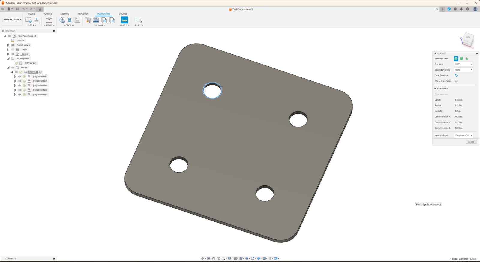

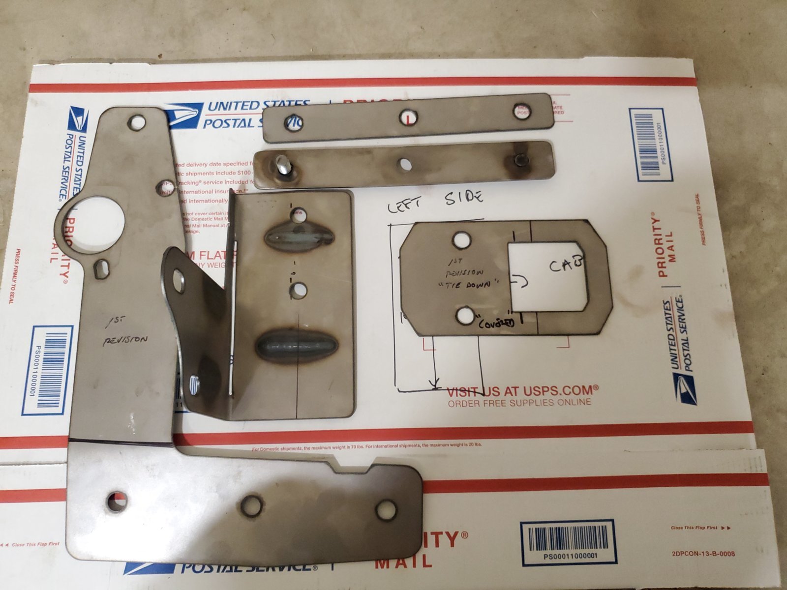

    Might not look like much but, took quite a bit to mock up actual physical dimensions

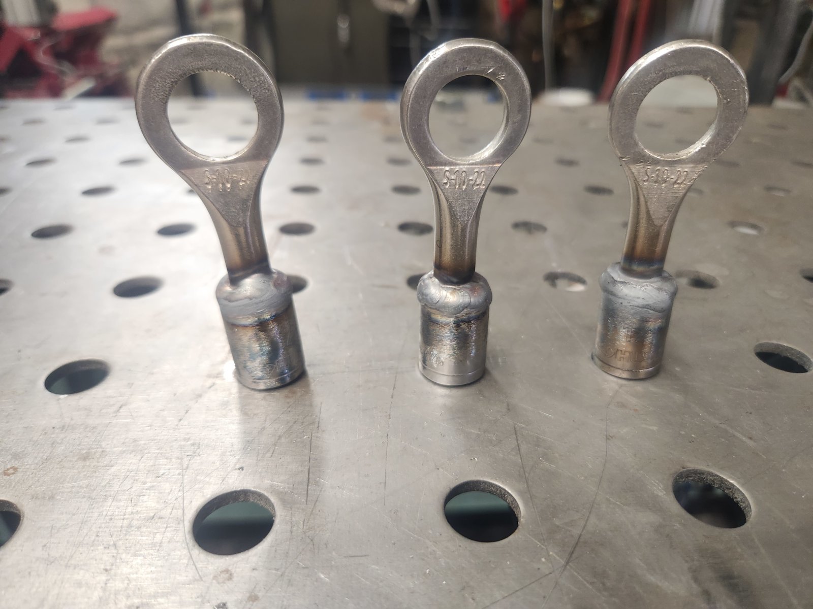

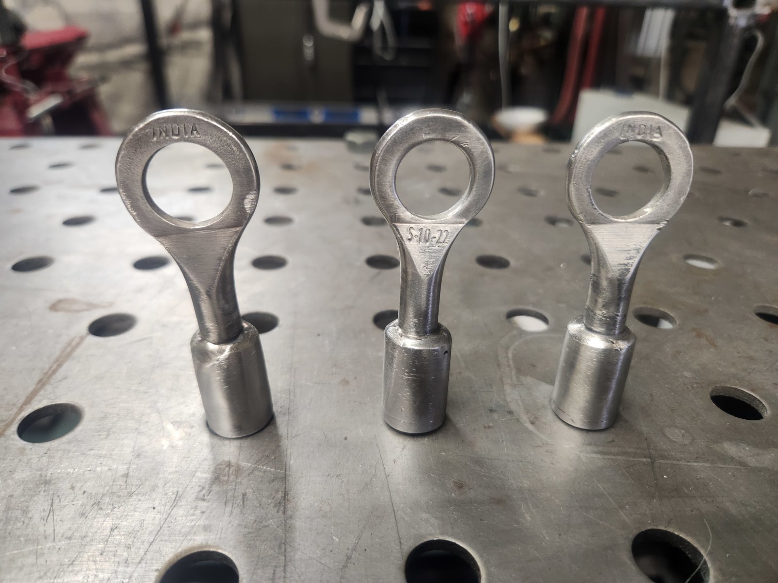

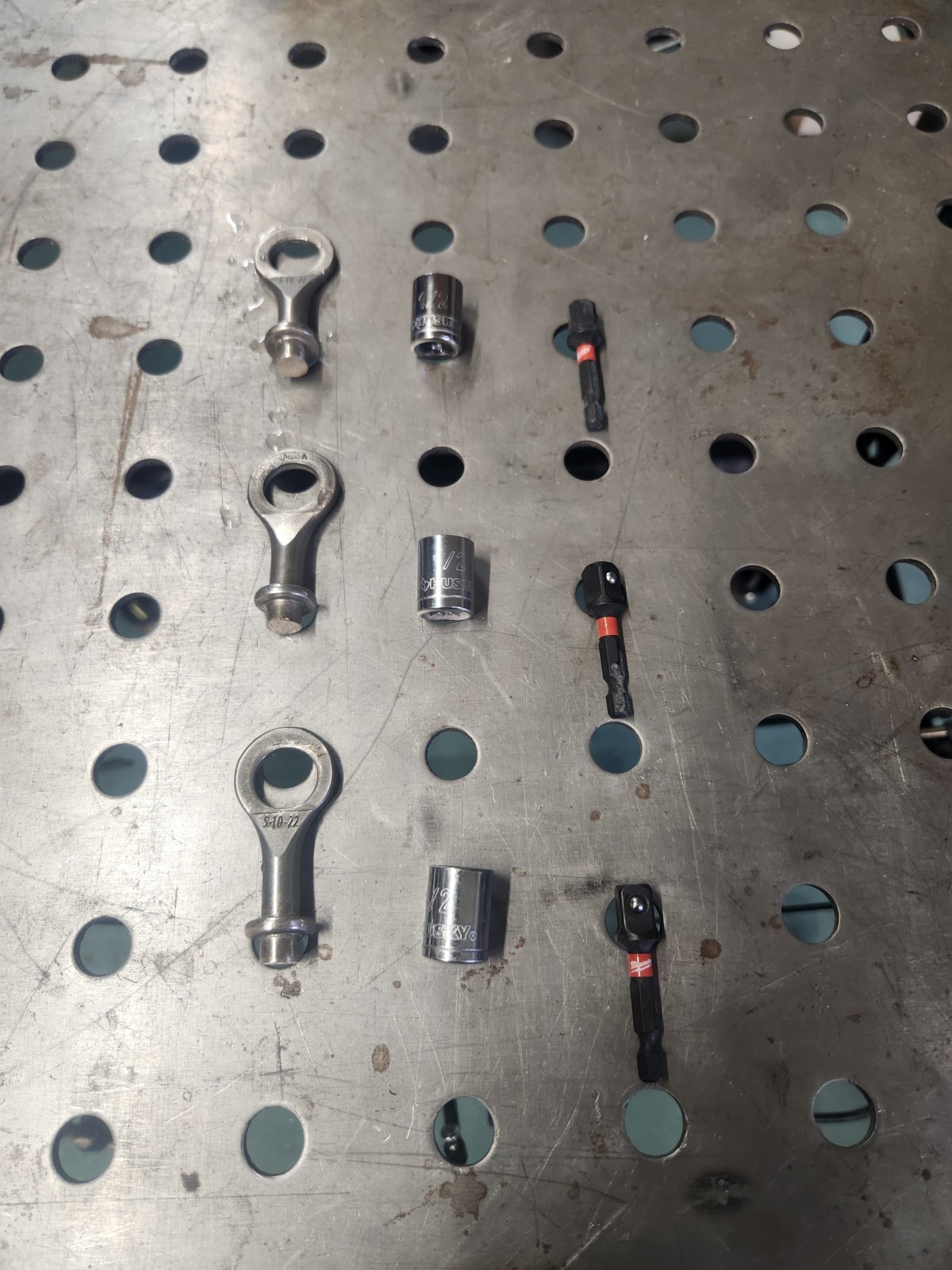

    A little custom tool I built for me an a couple coworkers..
    took part of a hotline clamp, the ring lets you use an 8 foot fiberglass stick to install and and remove the primary jumpers on overhead powerline. a 1/2" socket, along with an adaptor for the 1/4" impacts
    Did a fusion weld with the TIG
    Cleaned the weld up with the belt grinder

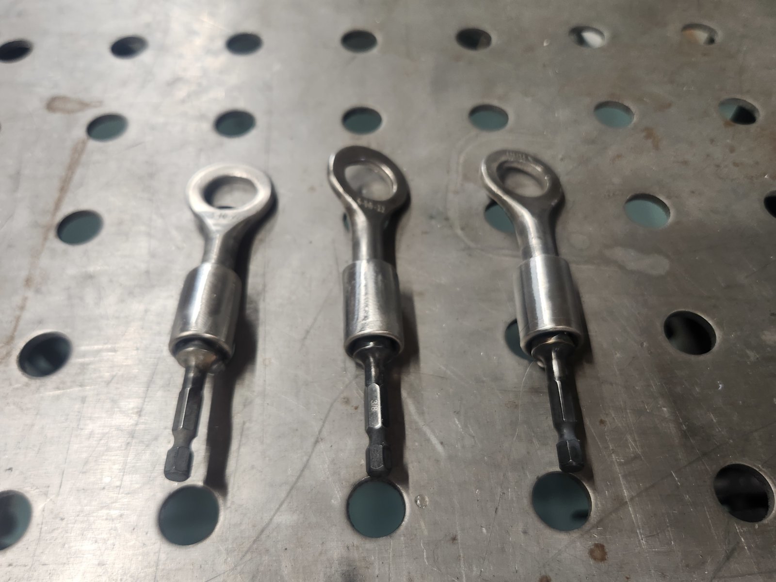

    Finished tool..

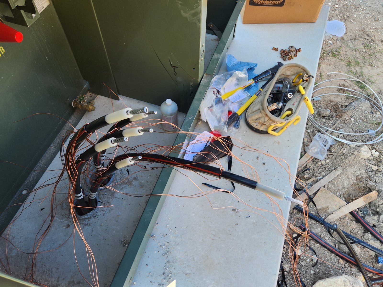

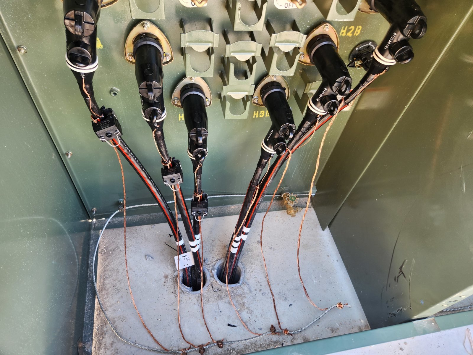

    This makes it a lot easier to twist the concentric neutral on underground cable
    all twisted up nice an neat..

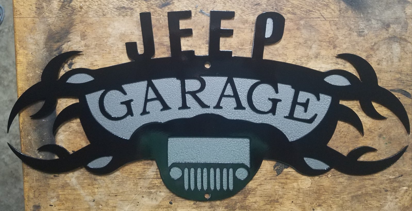

    Sold my Jeep last week to a very friendly Deputy who patrols my area. Going to surprise him with a wall hanger. Just got it painted yesterday: gloss back; with silver hammer tone background.
    I got the original image of the net and just redid the face of the Jeep. Those mounting holes are 7mm.

    Looks good!
    Yeah I don't follow any rules myself either; I find people often suggesting "RUN 50% SPEED FOR HOLES UNDER 1/2"
    Where I normally run the same speed or at 90% for holes that are .35 to .40
    The above test piece was just as a response to a request, and proving that the whole 50% speed recommendation isn't concrete but merely a suggestion.
    The end result was that he had has lead ins all messed up, wrong kerf, etc lol
    In other words, a linking constraint after I asked several times if he had any warnings and he never answered me.

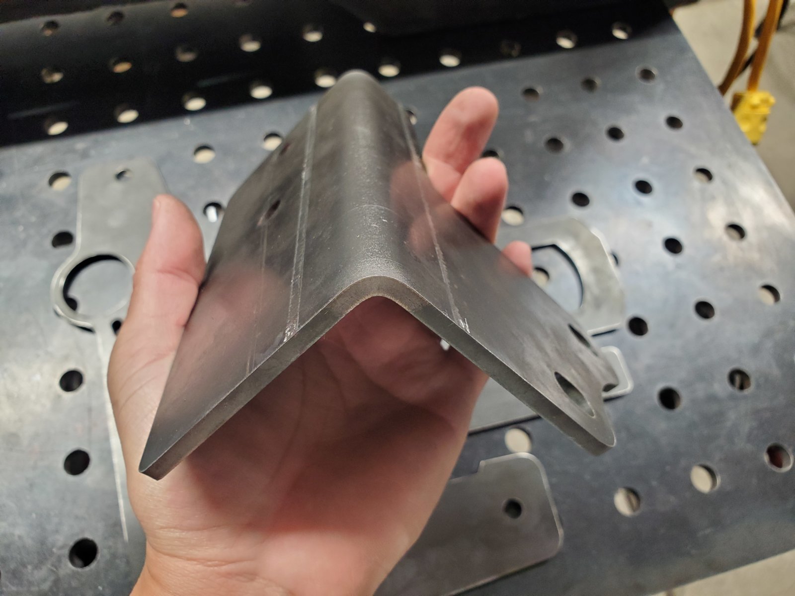

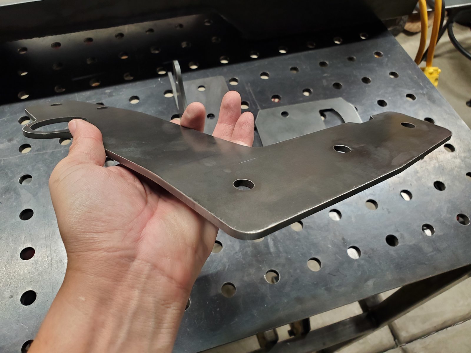

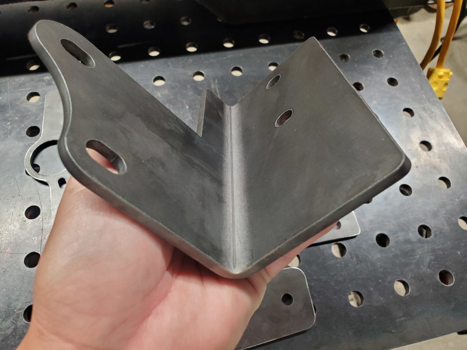

    Haven't posted here much but cut (and bent) these out today -
    Safe to say my table and settings are still working well for me.
