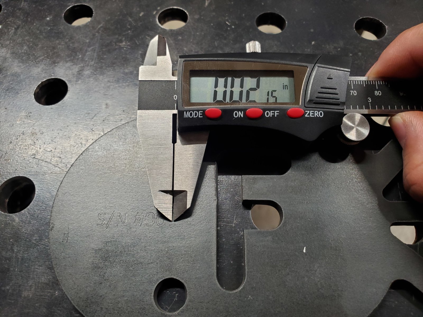

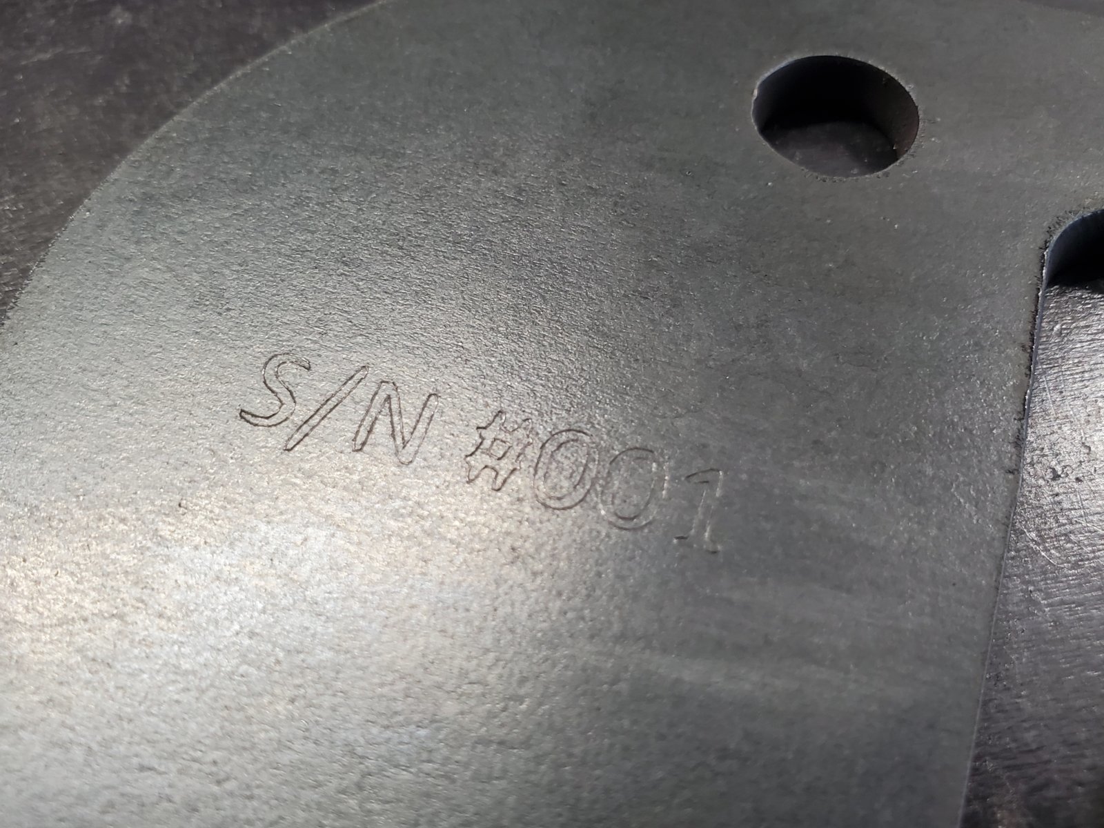

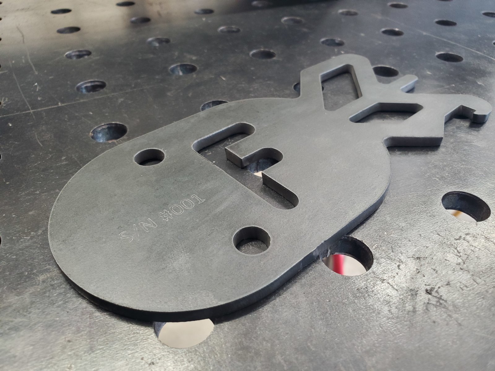

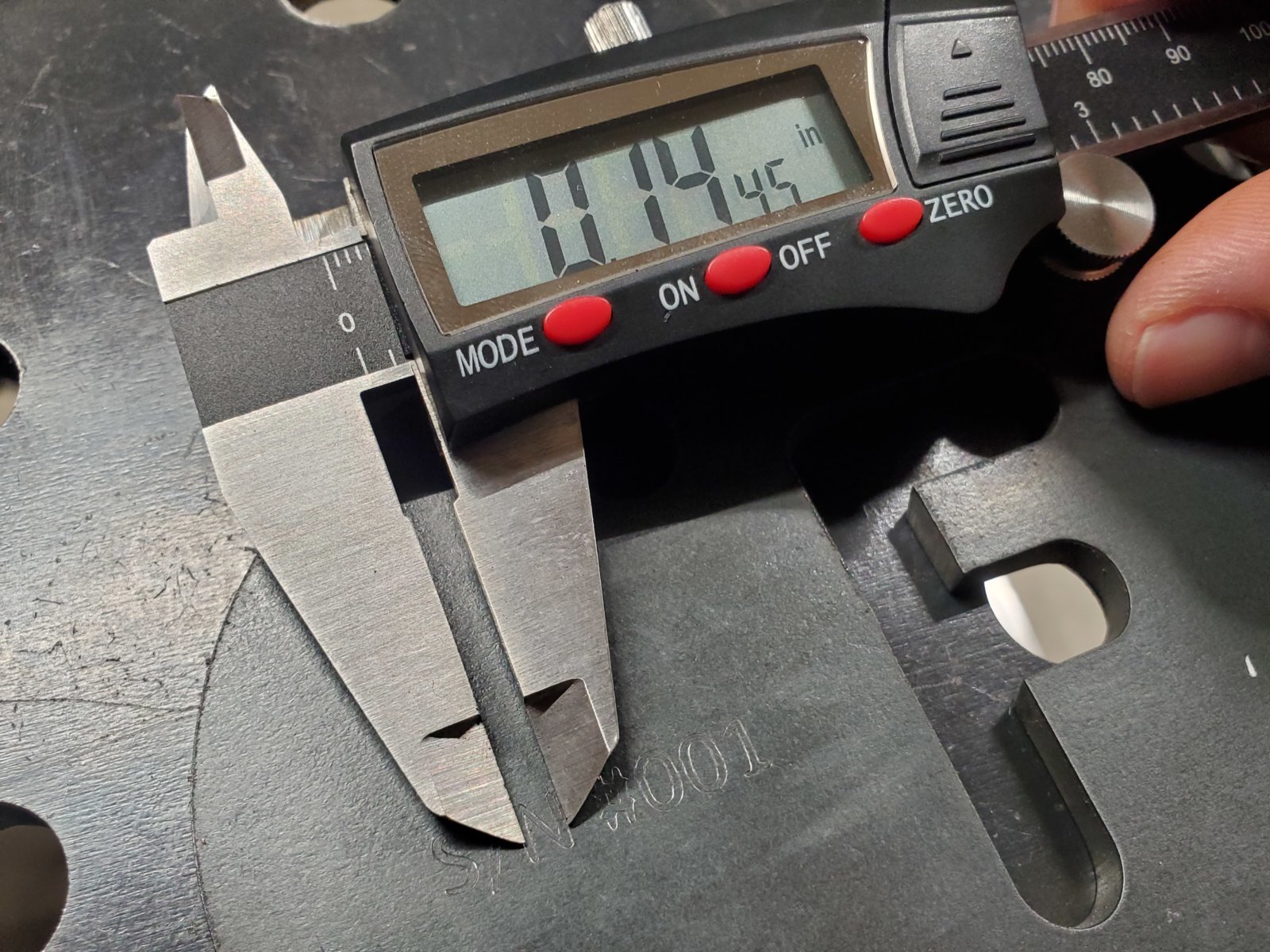

    For scribing something I'll cut out, I do two setups for a single drawing.
    First setup will consist of all my cutting done on plasma.
    My second setup will consist of the specific item(s) I want engraved, followed by a profile of the object itself.
    Reason why you need this is because you can move your torch where you need it, set an origin point, and your scribing will be done wherever you need it in relation to the item itself. Simply STOP the program once you're done scribing before it engraves the final outer profile.
    Once you're done scribing, load up the plasma cutting setup, swap in your consumables, fire up your plasma cutter (and THC) and let her rip.
    This is assuming of course that you didn't ZERO your torch at all and simply returned it back to 'work zero', the same spot where you initially were when you did your scribing.
    I went for a 0.2" letter height when I created my text in Fusion.
    This resulted in a width of only 0.14".
    And a spacing of only 0.02" between closed loops.
    The cut wasn't half bad either :laughing:
