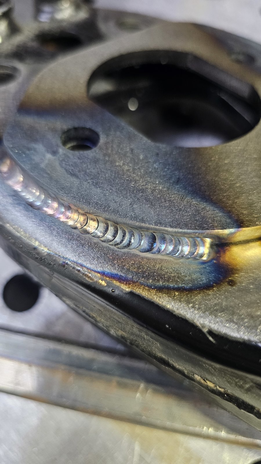

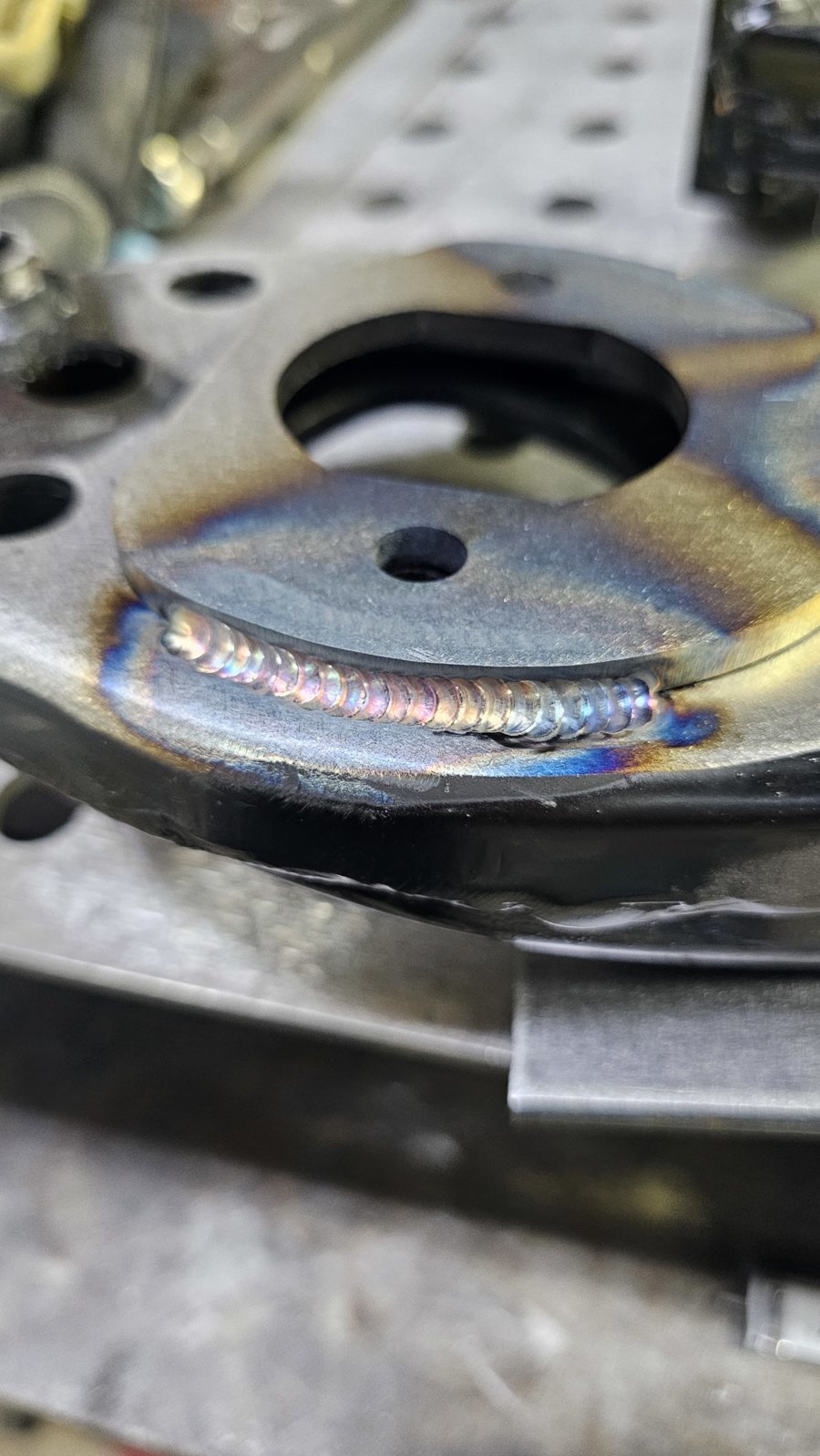

    1st of two sets of arms I'll be building today and tomorrow.

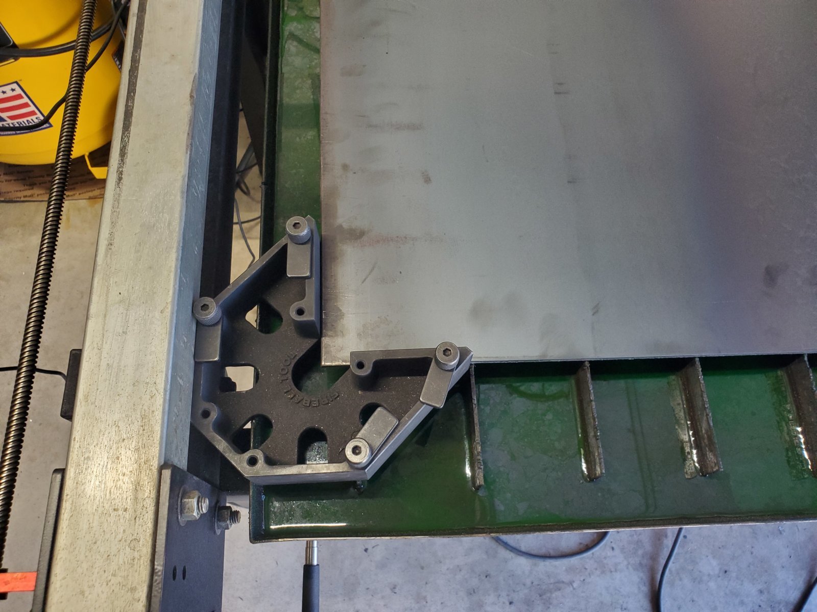

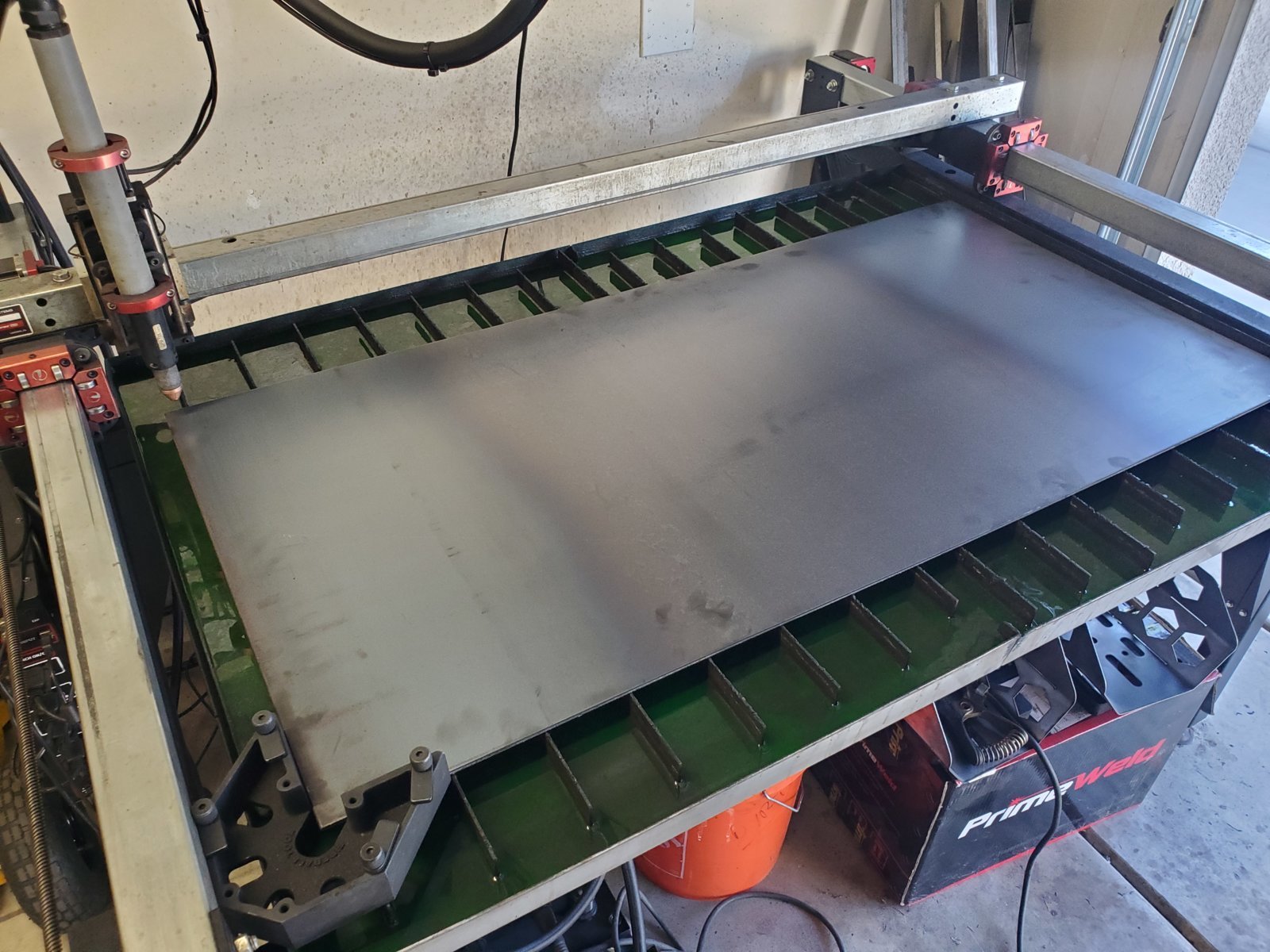

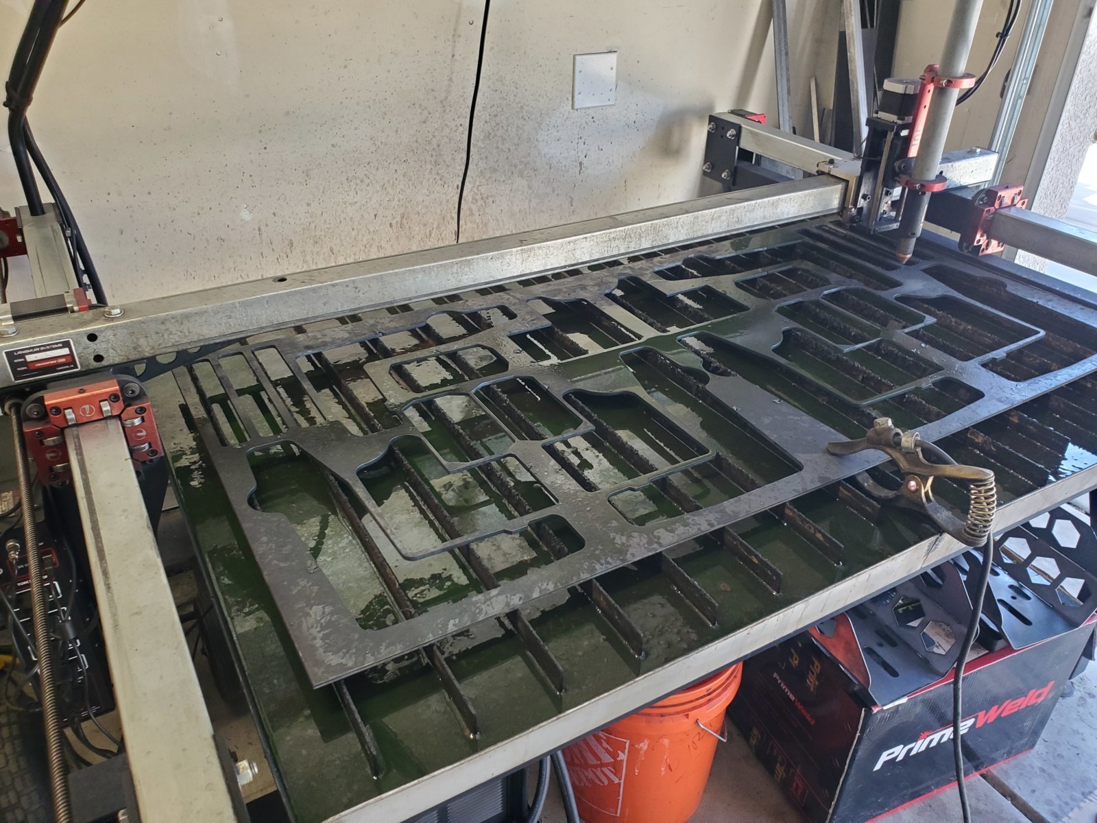

    Yesterday I realized that you can use a small fireball square tool to set the distance of a 4' sheet on your Crossfire Pro. It also helps you to square your sheet up as well.
    Pushing the sheet against the edge means you sets the sheet up in place to utilize the full 4' wide cutting area instead of having to go back and forth with adjusting your sheet and trying to zero it in.
    My cut area for this specific nesting was only 47.19" wide, so you can see the even spacing at each end of the sheet (done on purpose).

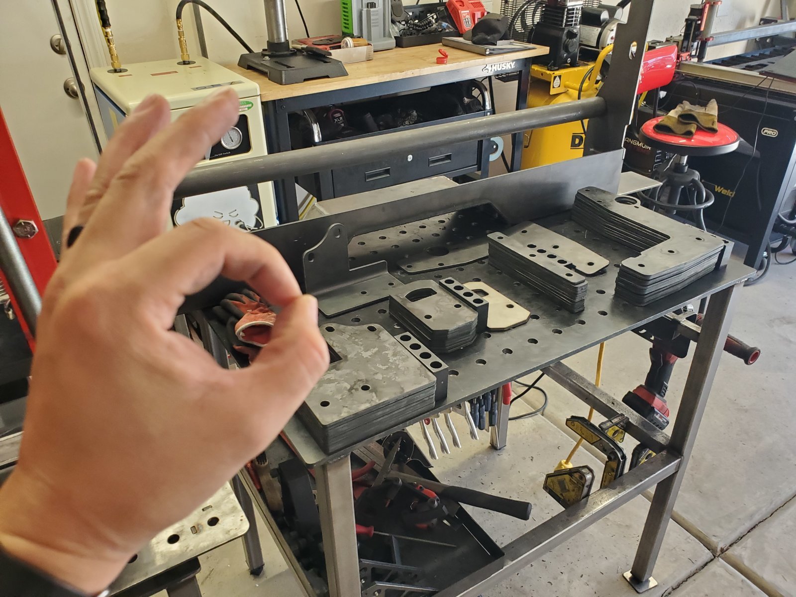

    Just a bunch of bending today.
    Tomorrow and the next day I'll weld some stuff.

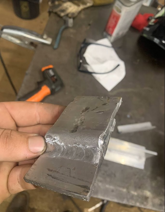

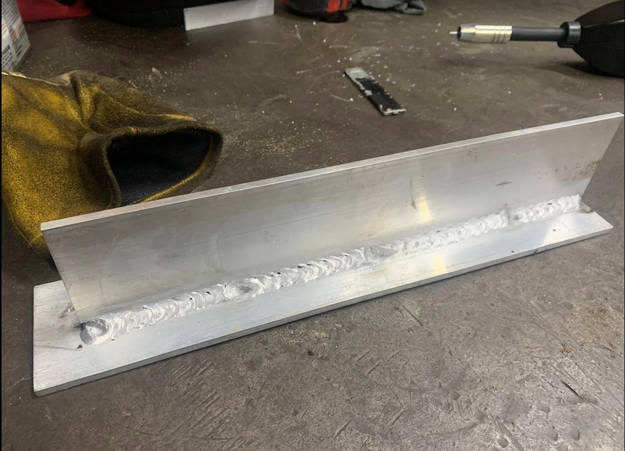

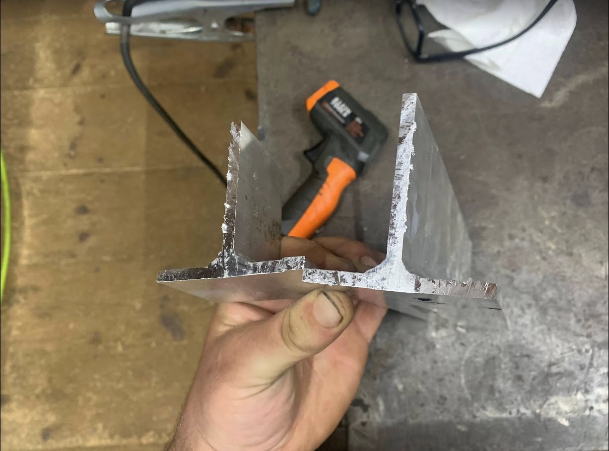

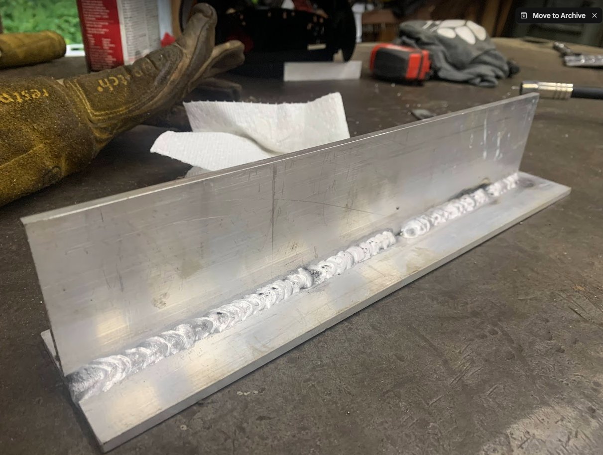

    I messed around with the spoolgun last night. I think it went pretty well for my first aluminum welds.

    That's the lovely thing about a spoolgun
    Once you find the right speed/amps, you run it like MIG and it's stupid easy
    Looks great

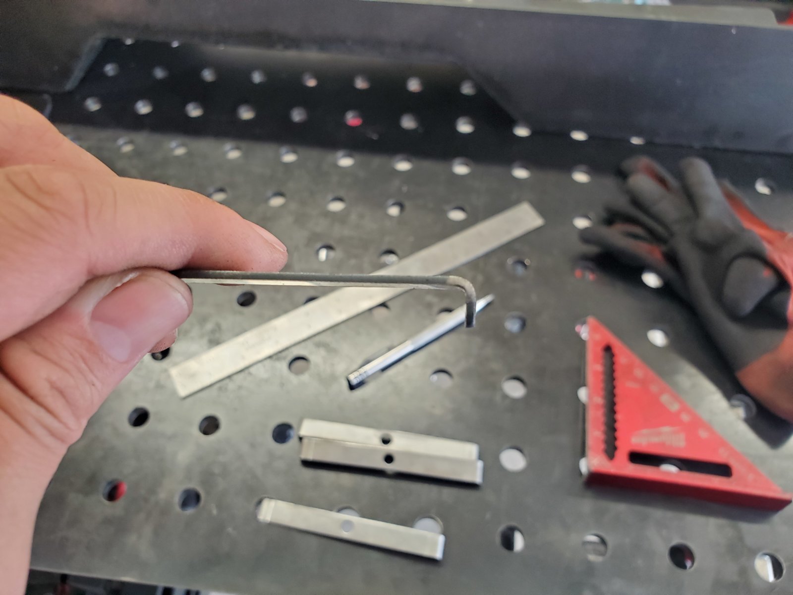

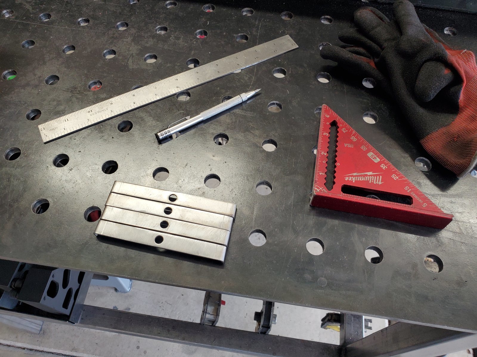

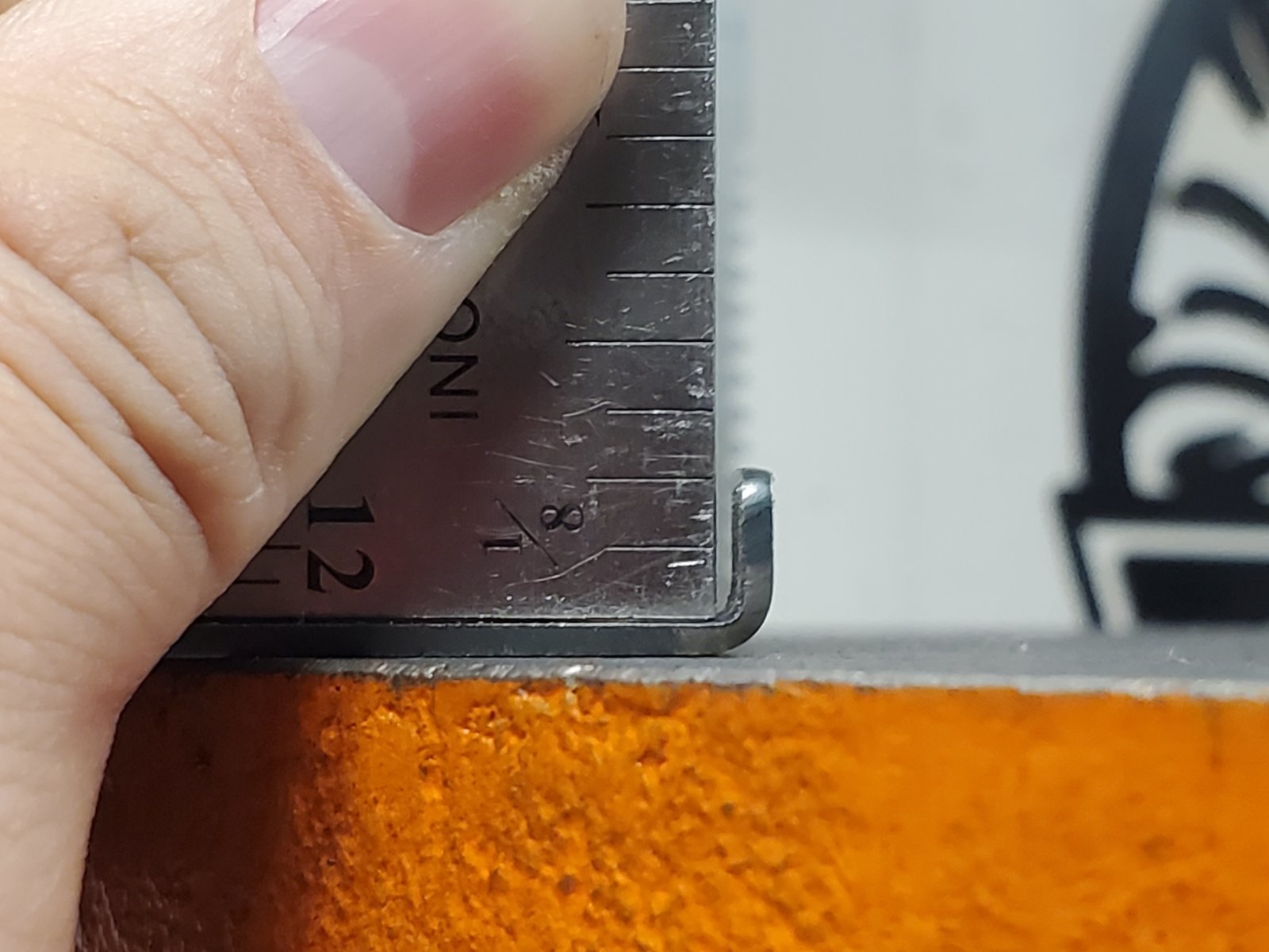

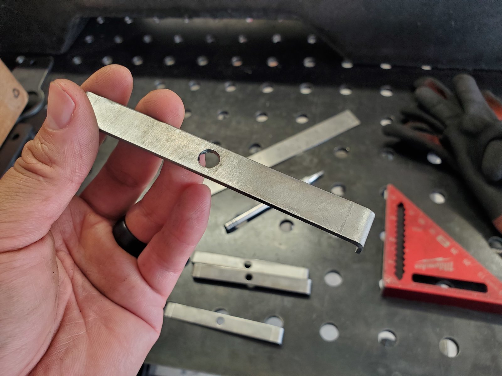

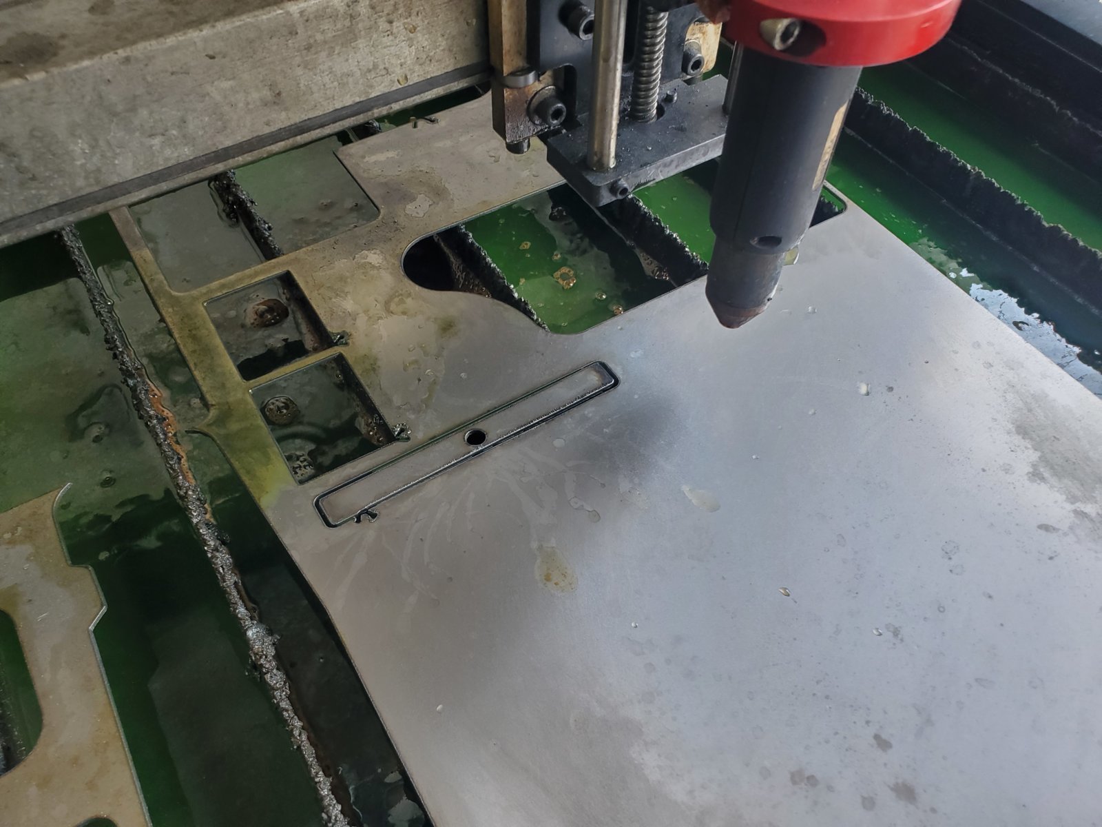

    Quick draw, cut, and bend job.
    For small stuff, I run the press brake manually instead of running it on air.

    Nice bend, the SWAG press brake would have trouble with that short bend.

    Thank you!
    But trouble would be an understatement :rofl:
