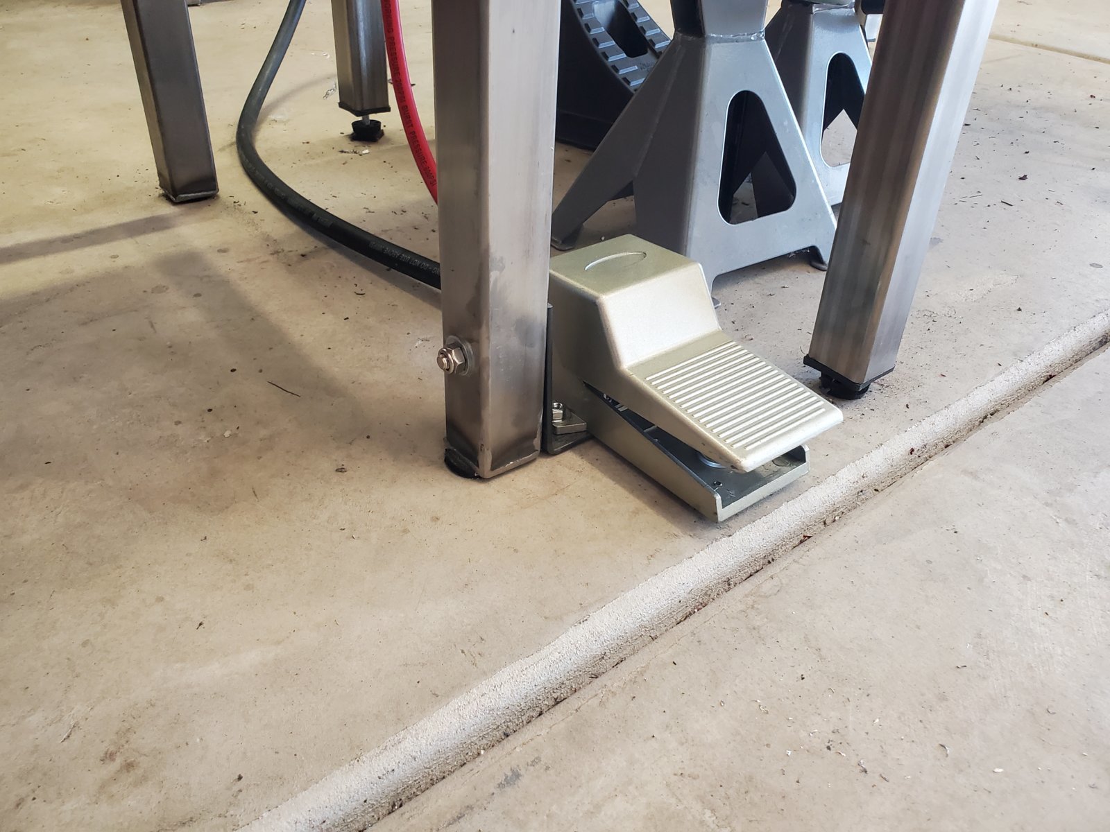

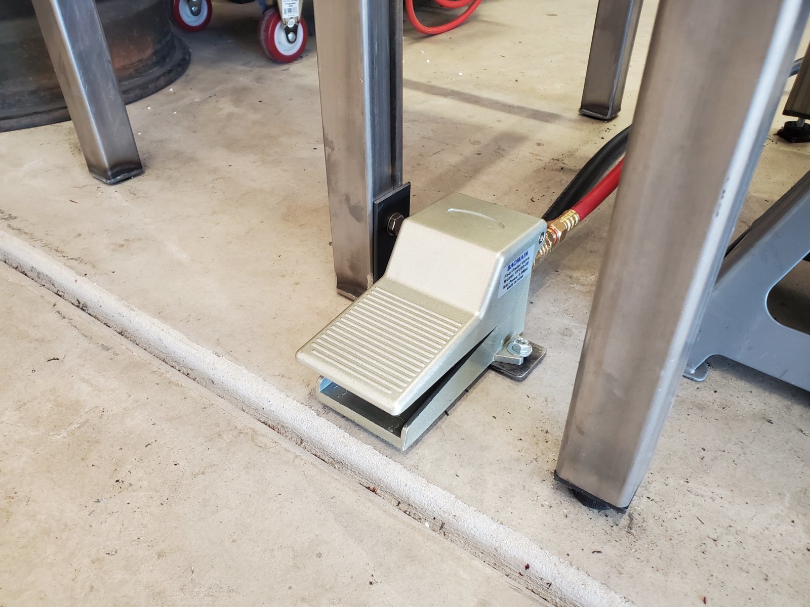

  8. Aug 5, 2024 at 1:49 PM
    Kwikvette
    Feb 27, 2019
    #284735
    81,737
    Fresno County
    4 run, 2 don't
    The littlest things offer the biggest convenience.
    Used some of my +3 year old flat stock to make a foot pedal mount.
    3 holes, 2 of which I used a countersink bit on, and a 90 degree bend.
    The M6 bolts sit flush with the metal bracket allowing the pedal and mount to lay flat.
