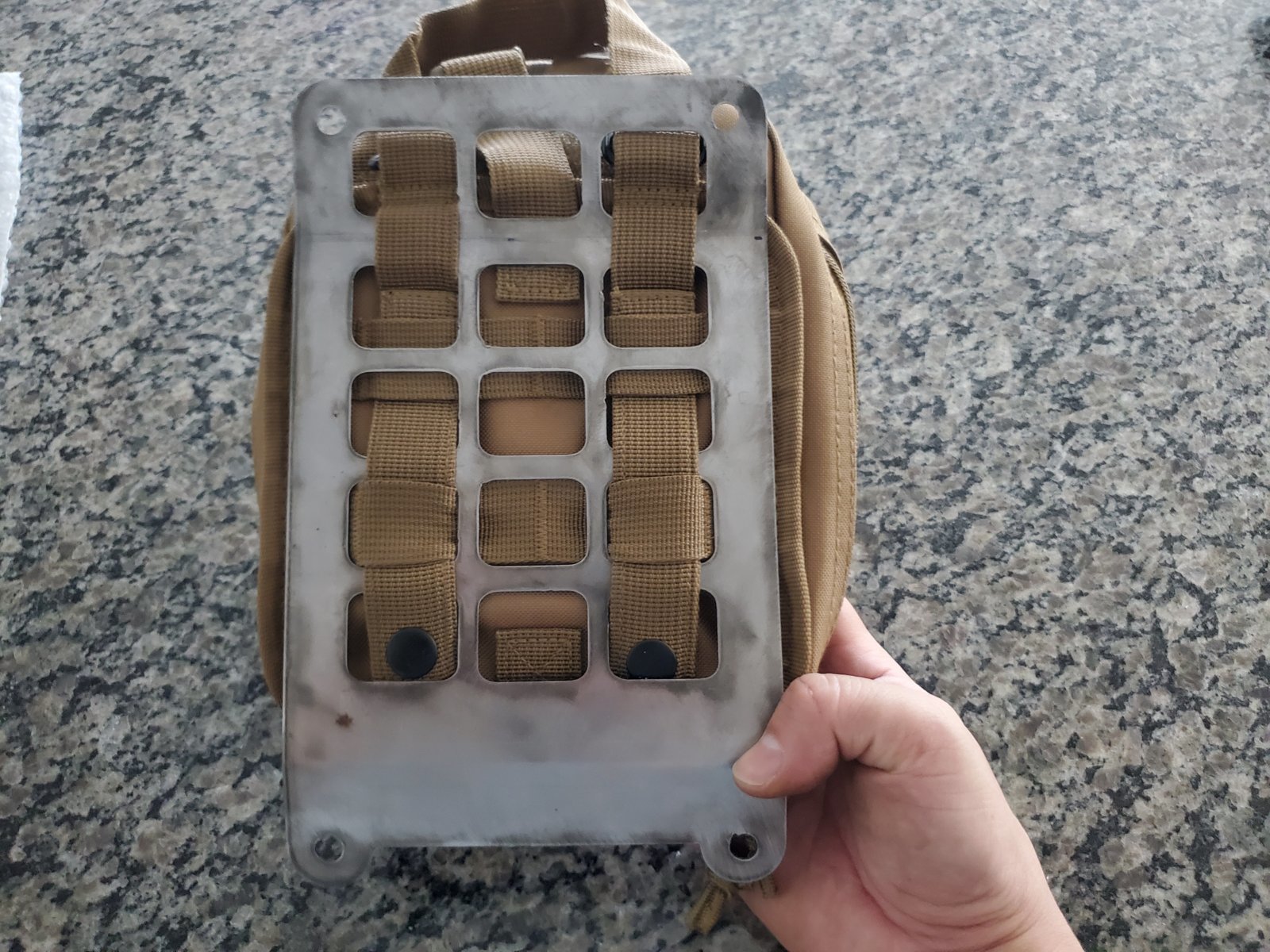

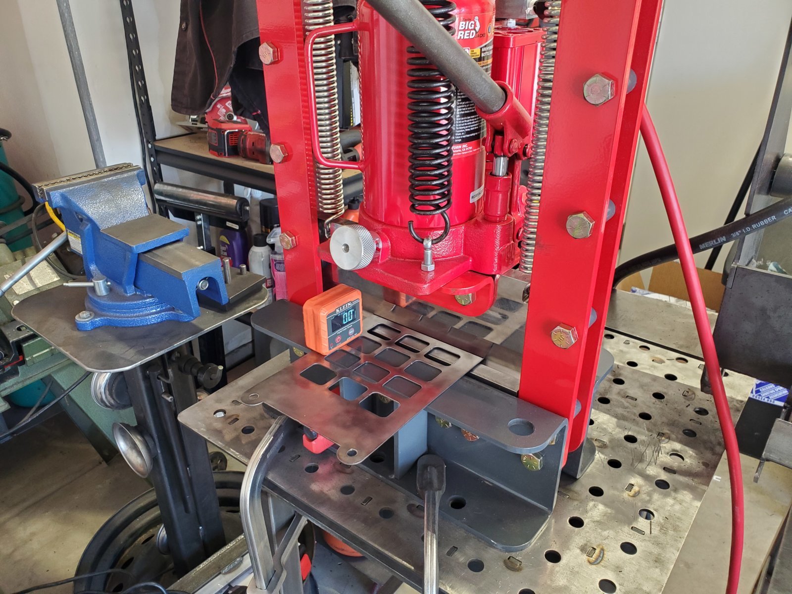

    Former member used to make these but then stopped, closed his website, and checked out of the forum so here's my attempt

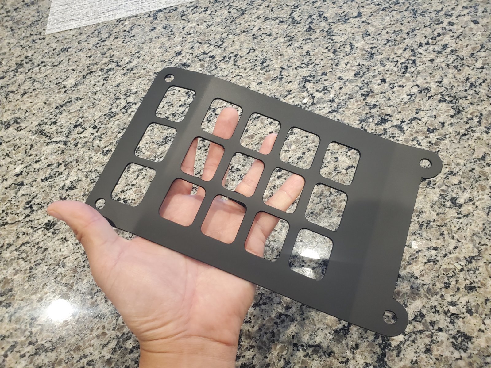

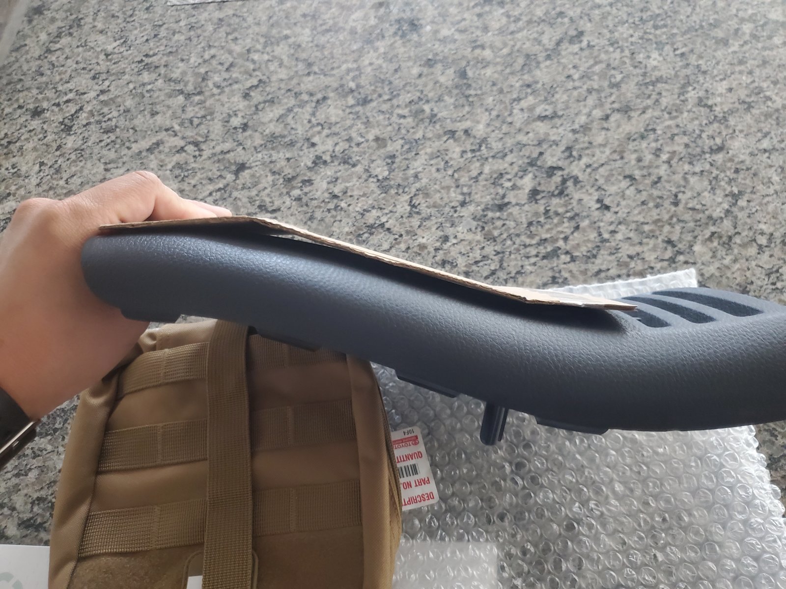

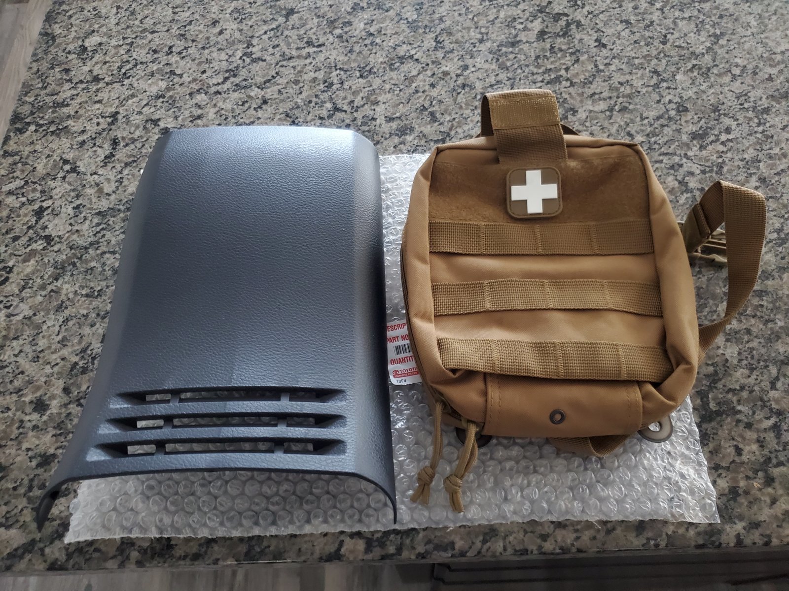

    3rd Gen center console cover (rear)

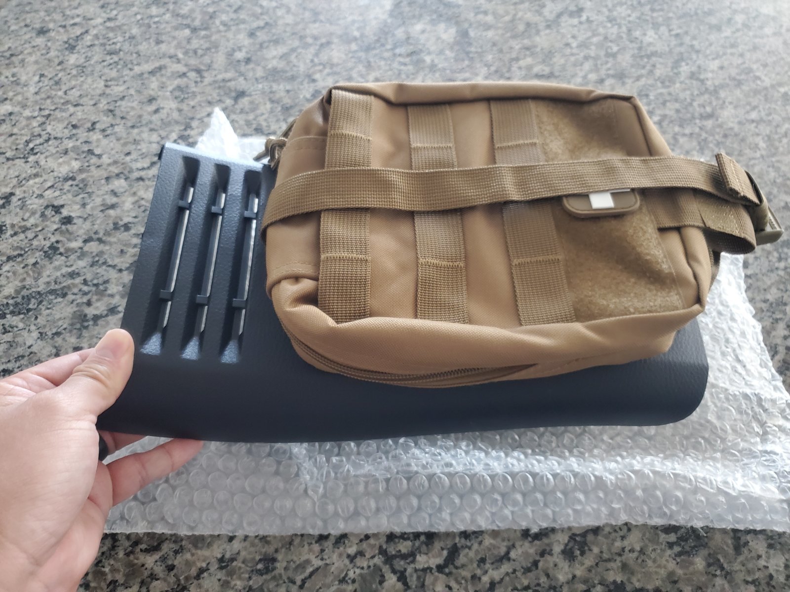

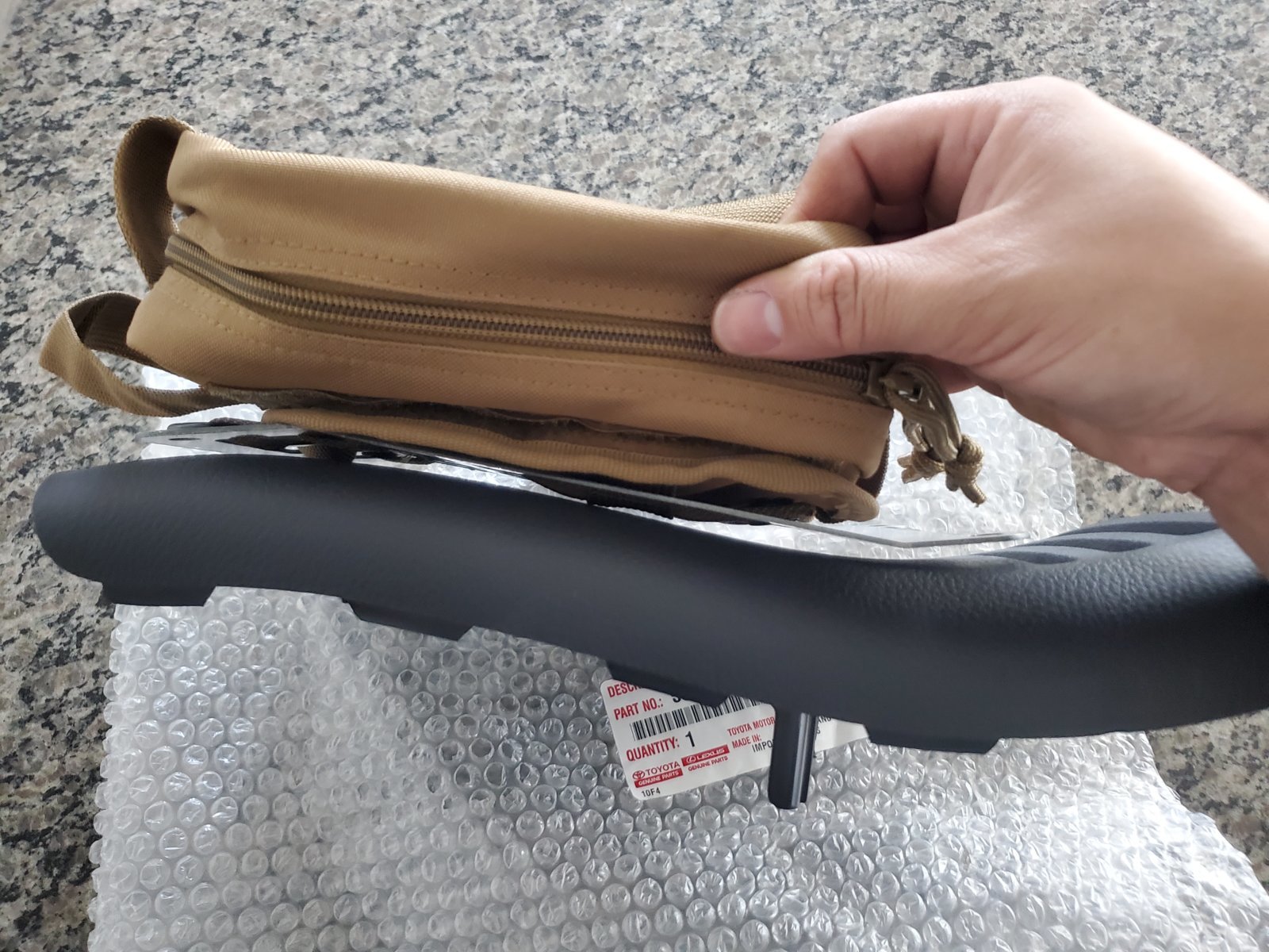

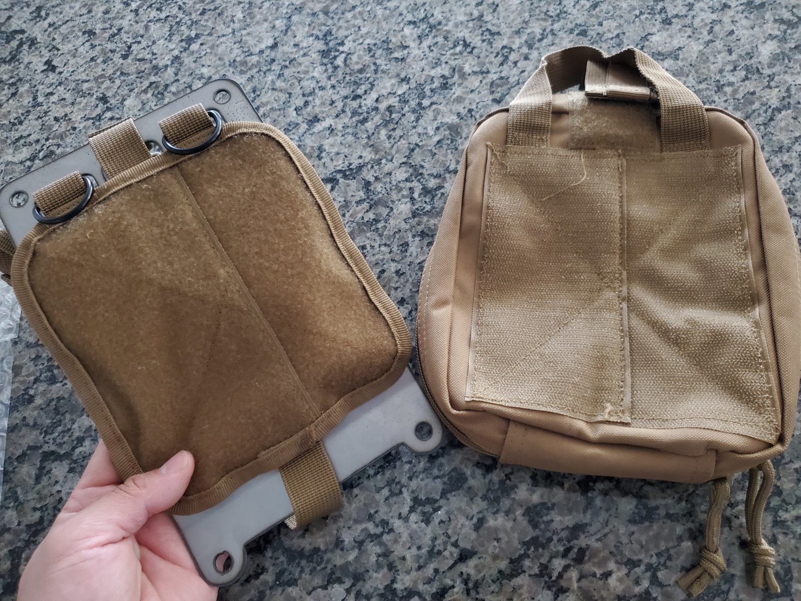

    It would only be appropriate if I purchased the recommended first aid pouch normally used; this is how it'll sit on the rear cover

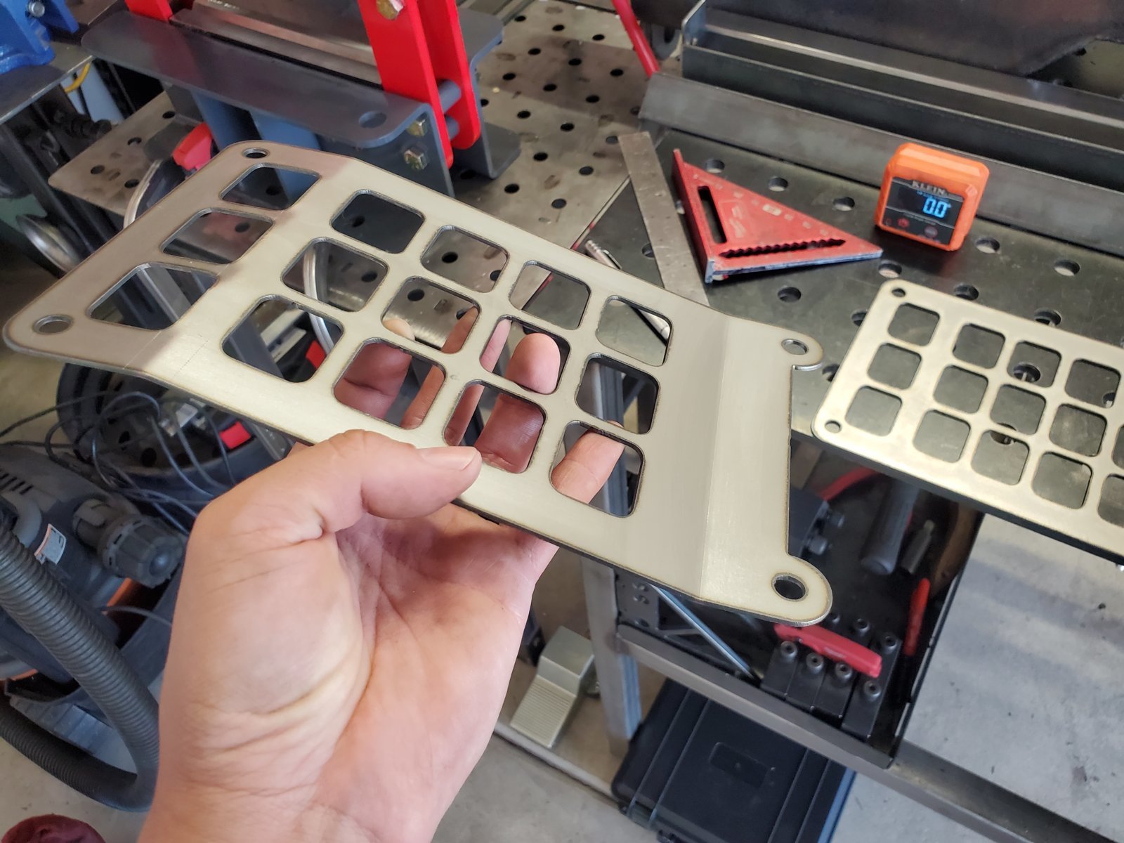

    Quick cardboard mock up

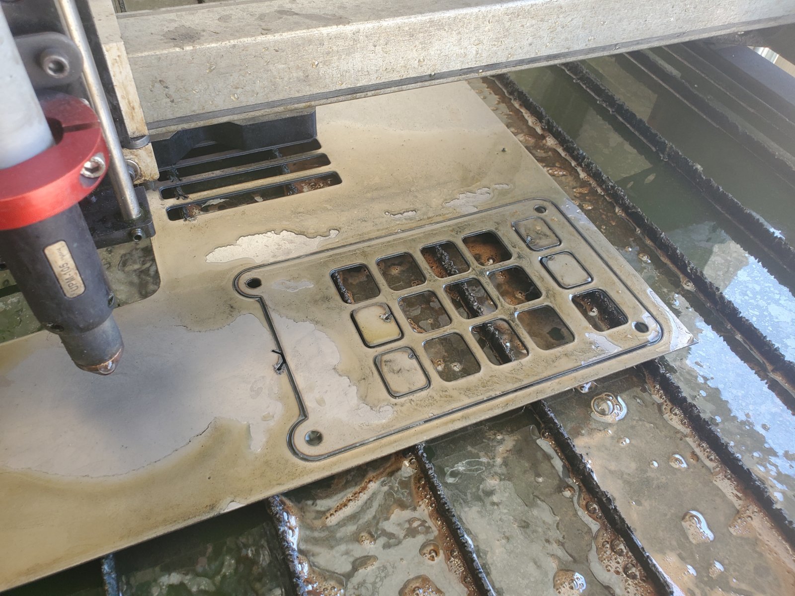

    Quick CAD work turned to quick cut work
    After two short bends on the press brake, I attached the rear panel to the new template
    Angles look to be damn near perfect; just need to remove 1 to 2 degrees from the bottom bend
    Tested the tear-away action of the pouch; held on strong
    I want to say not bad for a first attempt
    Even though this is just a prototype, and the size of this allows 16 gauge to be an acceptable solution, I may want to do this in 14 or 12 gauge
    Undecided as this gets mounted to the rear cover and I want as little excess weight as possible
    Thoughts?

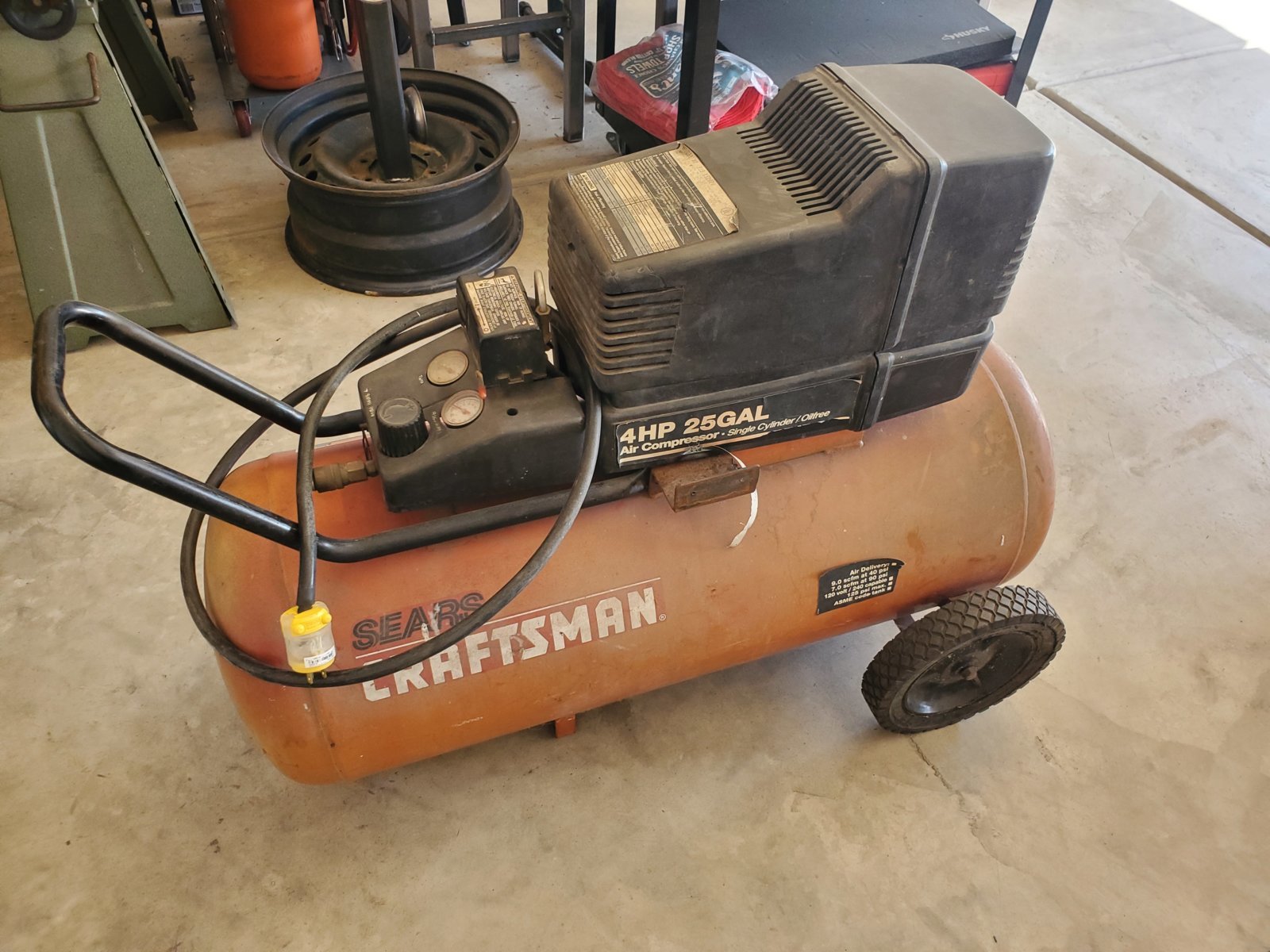

    I ran my plasma cutter for the longest time on an old 90's air compressor that was not only small, but under-powered per my plasma cutter's requirements; it still held its own whether I did cutting via hand torch or on CNC (which requires consistent air supply).
    So what I'm saying is, even an air compressor that's rated a bit lower than required can still work. The issues that stem from a smaller and weaker air compressor are -

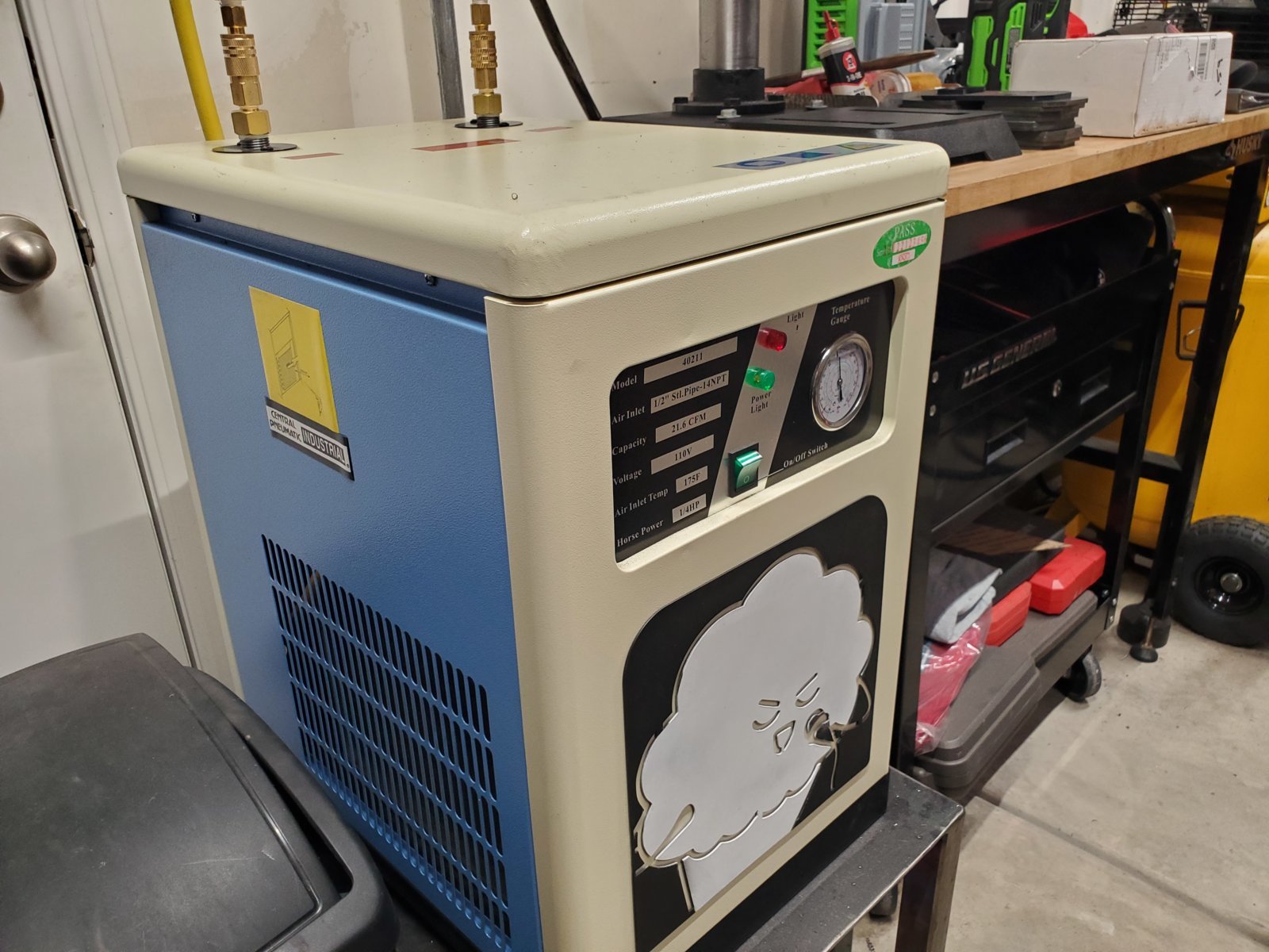

    Even then, I never had these issues and I cut a lot with just a hand torch. Since I do CNC work though, I am able to better track my consumable life and found it absolutely necessary to get my air as dry as possible so I added an air dryer.

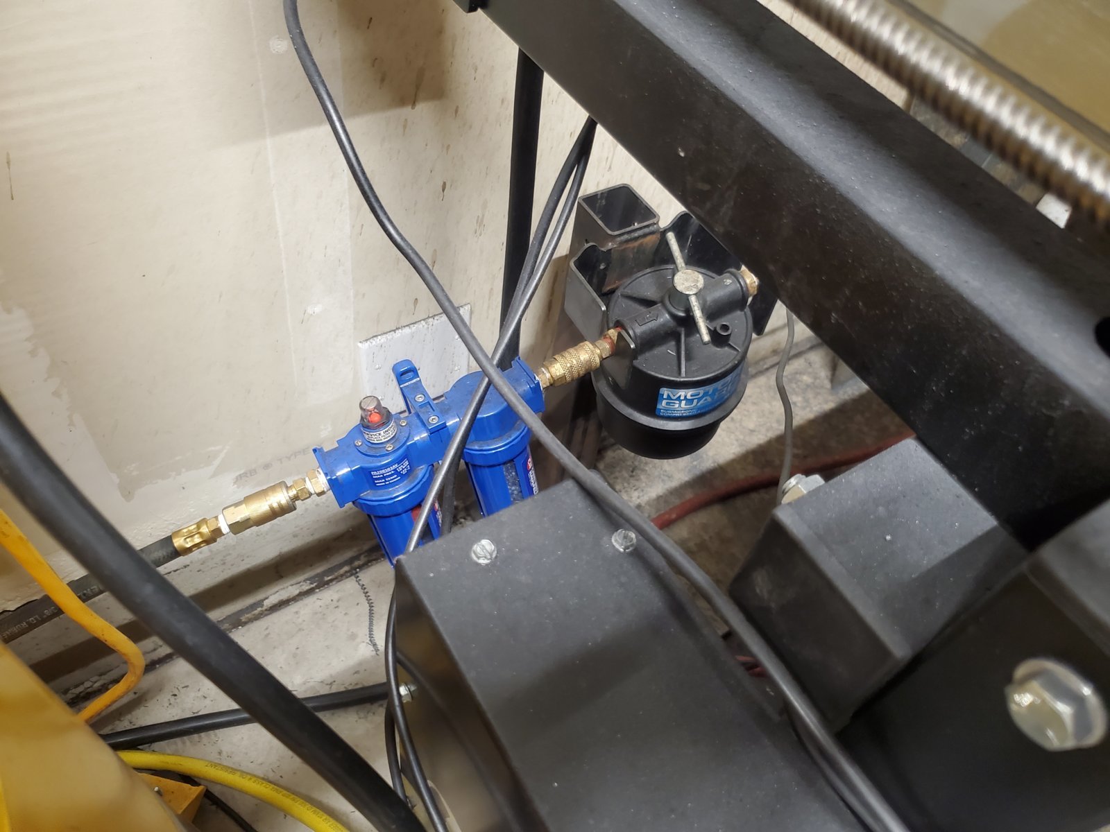

    Sure it's a bit costly for some, but it doesn't inhibit air supply as much as a custom setup with a long run of copper tubing. The copper tubing method works very well but it will severely choke your air supply.
    Here's an example of the moisture it's removed in just 2-3 months time.

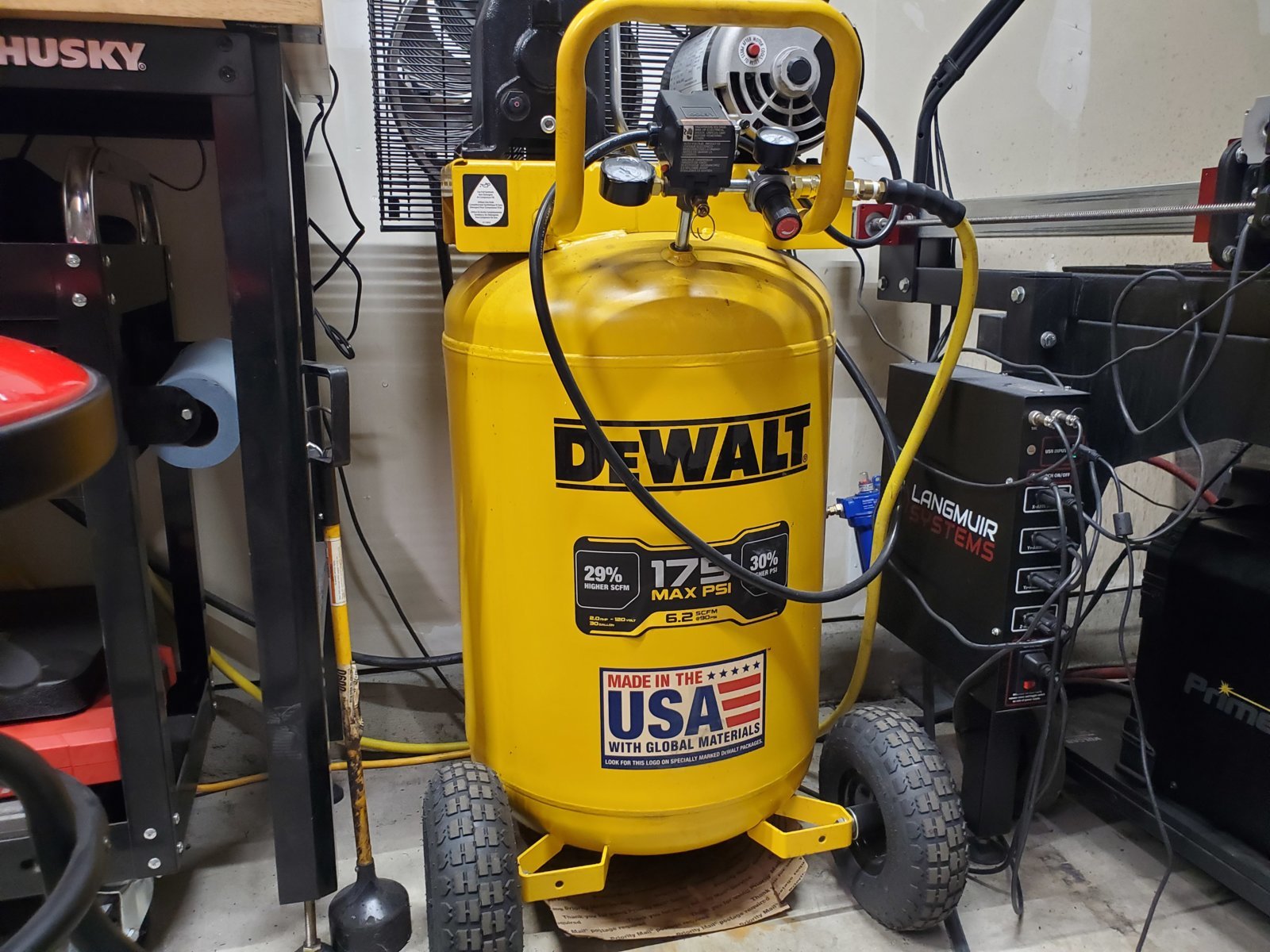

    I did upgrade my air compressor last year though, and even that thing barely meets the requirements of my plasma cutter but still works wonderfully well.
    But I do retain some extra filtering in place to help with moisture.
    So again, consider what your long term goal is and buy yourself the best air compressor you can get.
    If you have the wiring for it, you should opt for a 240 unit over 110 - at 240 it will run a lot cooler and you'll end up with a pump that'll easily push 8 - 12cfm versus a similarly priced 110 unit that only puts out 5 - 6cfm.
    Consider getting your air as dry as possible, and although you don't need to go as far as getting a refrigerated air dryer or something, the more you add the longer your consumables will last.

    @MagicToolbox
    @musicisevil

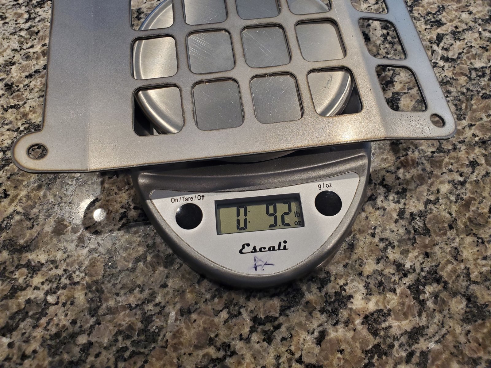

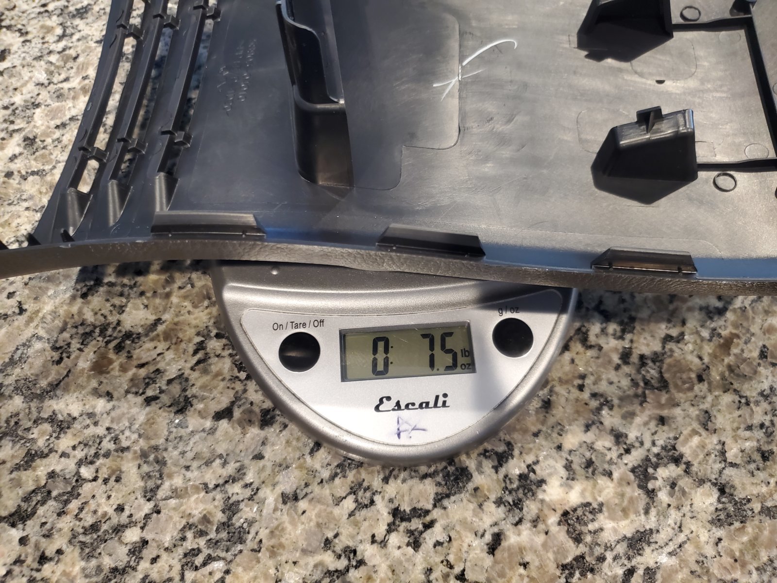

    More I mess with this, the more I consider 16 gauge an acceptable solution
    If you grab a 12" x 18" piece of 16 gauge, it'll have some flex but at this size it is absolutely rigid
    Not only that, it weighs more than the cover itself
    I'm confident that this thickness will suffice, easily

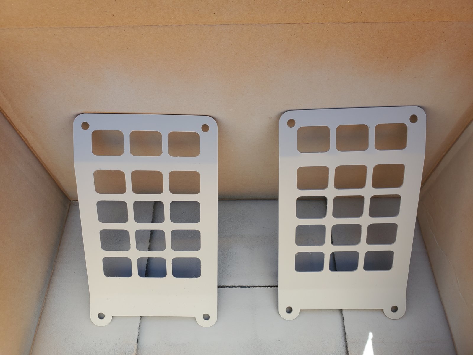

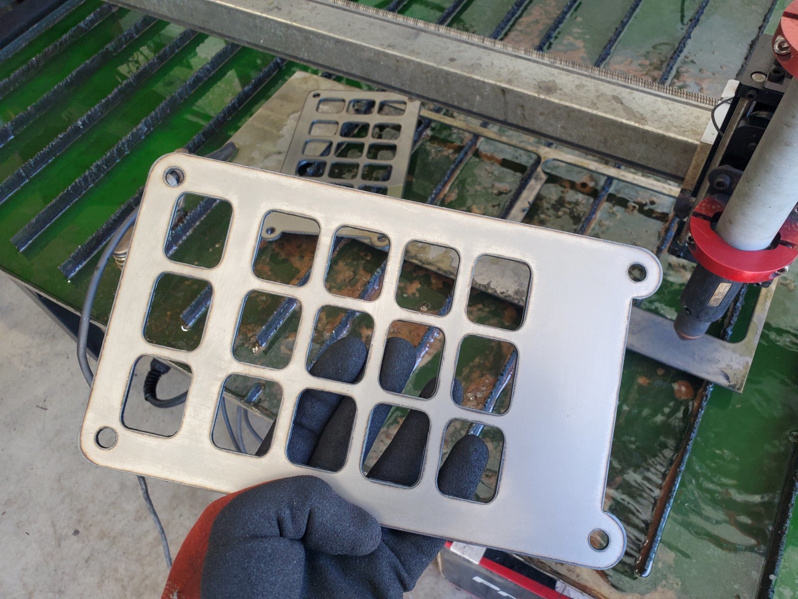

    Made two more, but that's all the 16 gauge I've got left.
    Now they're outside while the primer dries.

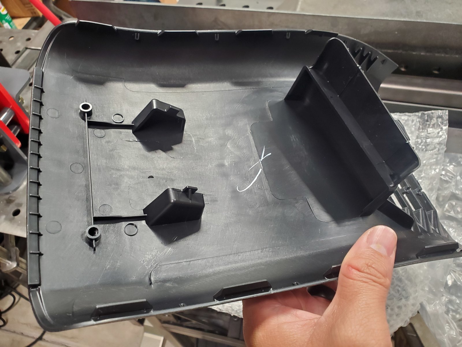

    Purchased Toyota Certified, with Vijay bumpers, additional lights, and Falken Wildpeaks on Fuel rims. Prev owner apparently painted the grill.

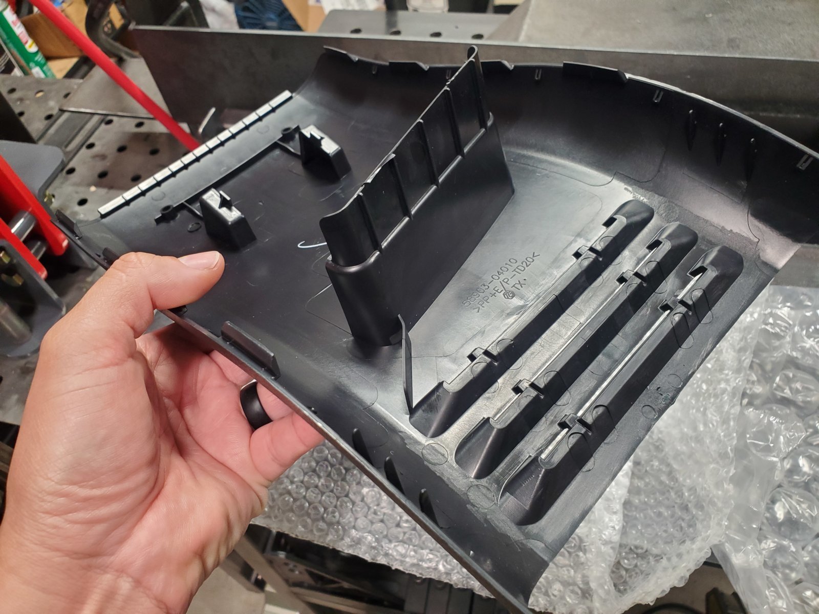

    Can you tell from the part you have if there are screws that hold that plastic back panel on? I'd like to pop it off, but I dunno if it is a pop off unit or if there are screws holding it on.
  16. Aug 17, 2024 at 2:29 PM
    Kwikvette
    Feb 27, 2019
    #284735
    82,912
    Fresno County
    4 run, 2 don't
    No screw holes or anything

    Naw just primer on the two.
    The black one you see there isn't painted, but instead I used a quick-drying sort of primer (rust inhibitor) since I'm keeping it for myself. It scratches easily unlike real primer.
    If I think I'll make more than 3 or 4 of anything for multiple people, I like to keep a "master" around. But if this was a one and done deal (for you and @MagicToolbox ) I wouldn't have decided to keep one for myself.
