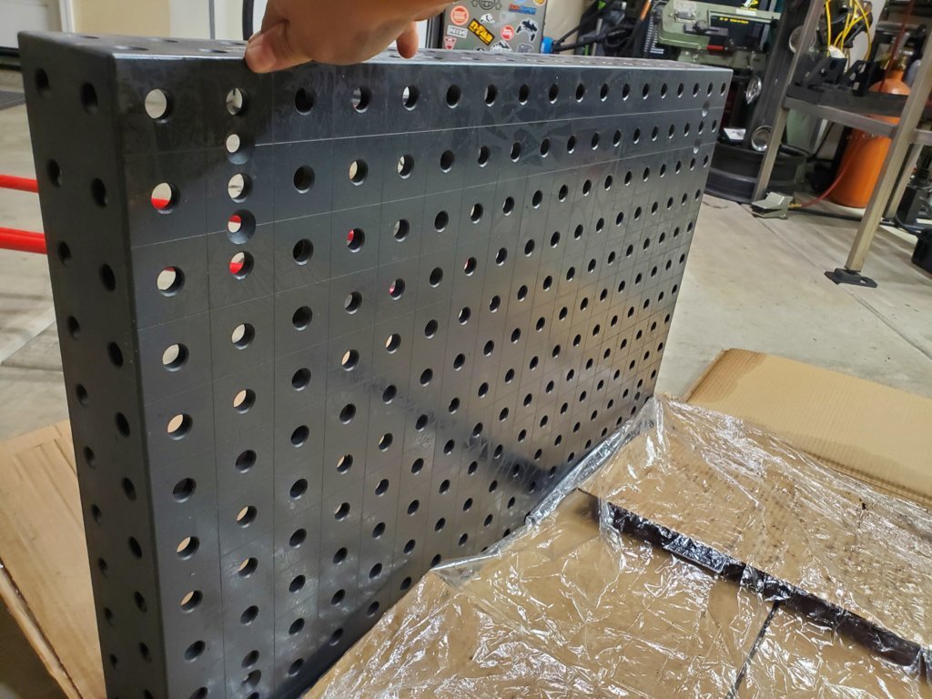

    Garage in shambles, reorganizing a few things, and new welding table just arrived
    Unfortunately the legs are delayed so hopefully they arrive tomorrow so I can get everything tidied up

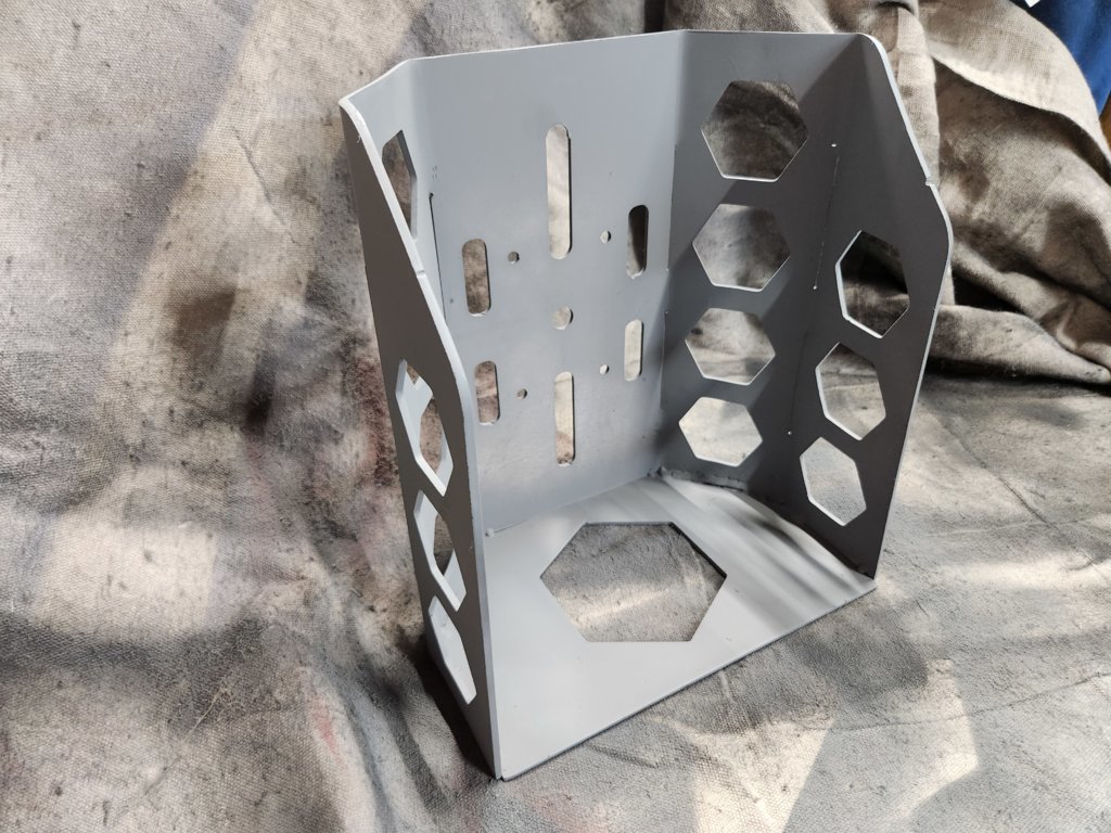

    Looked like what I was wanting so...I made one for myself out of 12g mild steel.

    Nice!
    She's cutting well ain't she?!

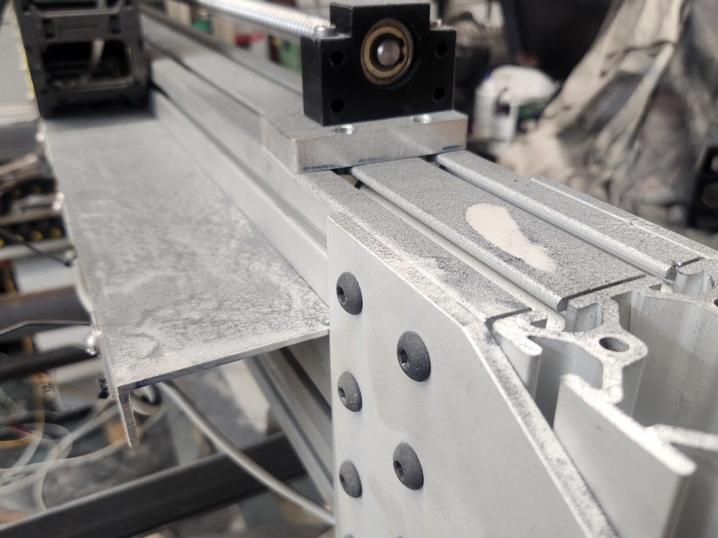

    I need filtration on my air though, I think I am getting some oil contamination. towards the end of the cutting I started to pick up a slight bevel, nothing that was a deal breaker for this part.

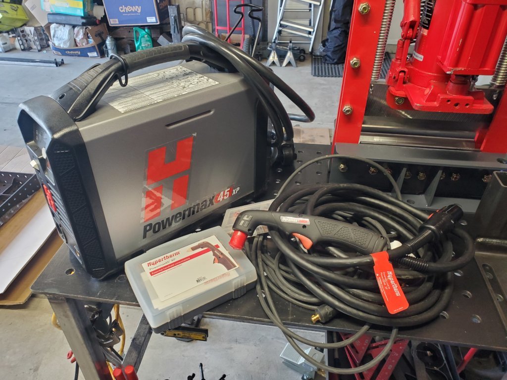

    New welding table who dis :anonymous:
    Cause it's only money right?
    Bought a new Hypertherm 45XP too :anonymous:

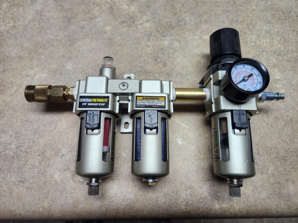

    What all do you run for filtration?
    My setup goes from air compressor -> refrigerated air dryer -> coalescing filter -> desiccant filter -> motor guard filter -> plasma cutter.
    Drainbung likes this.

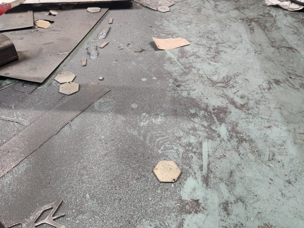

    Dust everywhere is an understatement. I am still working on my water table, as you can see it is very much needed.
    Drainbung and Kwikvette[QUOTED] like this.

    Yep!
    EVERYWHERE!

    3,000
    well, about that.... until now has been just the refrigerated air dryer. I knew running without would result in lower consumable life. but it was a case of bring over zealous an impatient. I have been working on this machine for several years an I wanted to see it cut something.
    This was something I picked up awhile back, I was originally going to use it on the powder coat gun. but I have not had a a need to use it in awhile now, at least for the small parts I am able to bake.
    been looking at the motor guard filters as well

    Definitely add a motor guard filter.
    You'll get crud and dust from the desiccant filter alone and you'll want to prevent it from reaching your plasma cutter.
    Drainbung and Pyrotech[QUOTED] like this.

    Just ordered the motor guard m26 filter
