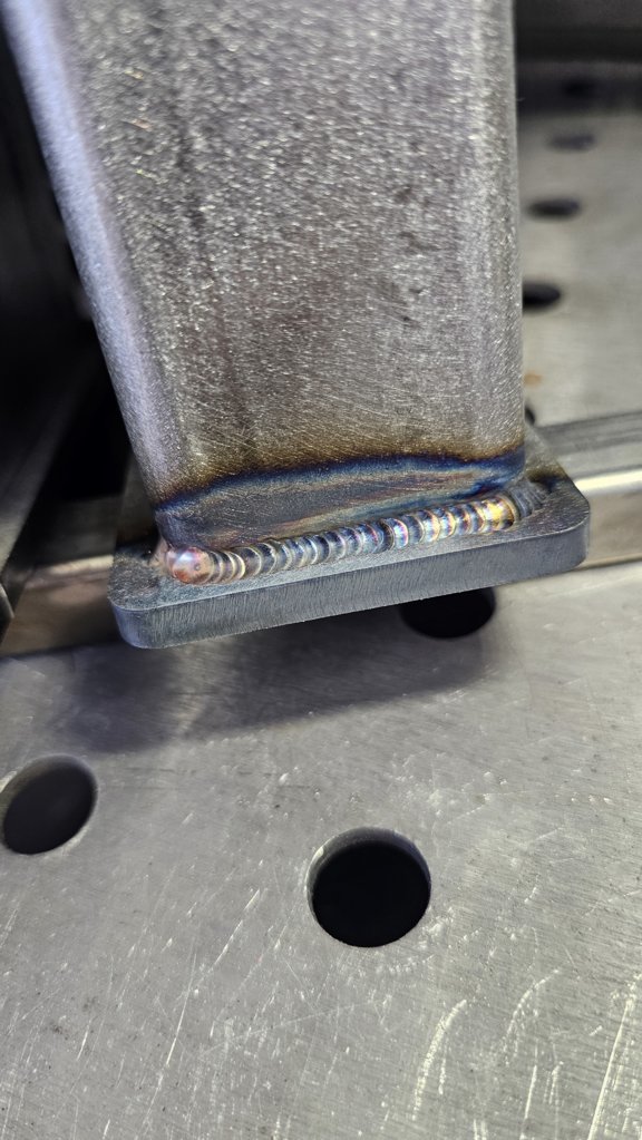

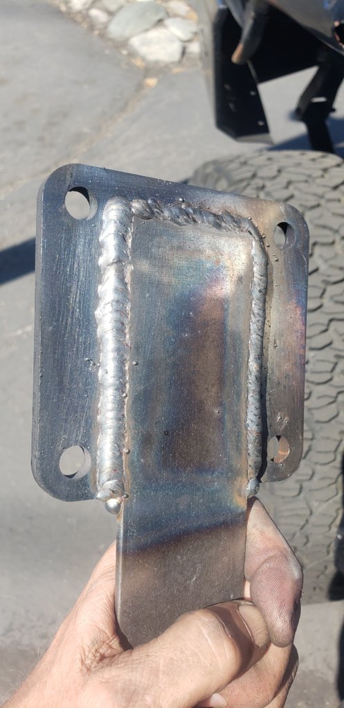

    Confident enough that I went for it all and made a pair of these for my rear JDFab Shock Towers. Ill have 1" square that will tie in both sides when done.
    This is the side I started with.. pulling the bead, I adjusted the gun angle for the rest after seeing the undercut or whatever its called
    Drainbung and Kwikvette[QUOTED] like this.
  5. Aug 27, 2024 at 2:47 PM
    Kwikvette
    Feb 27, 2019
    #284735
    82,868
    Fresno County
    4 run, 2 don't
    You know how to run the gun, looks good from a handling perspective.
    The bead is really cold though. You see how it sits like a caterpillar on top of the metal? Means no fusion.
    That's mainly because the heat wasn't enough to burn through the 3/16" or whatever it is and it acted as a heatsink to the 1/8" on top.
    Is that the hottest it can run?

    The machine can go hotter. The settings for that were set at 18.5v and a wire speed of 266.. on the Tititanium 180HD machine. Im done with that thickness, and everything else will be 1/8 with an occasional 3/16 here and there.

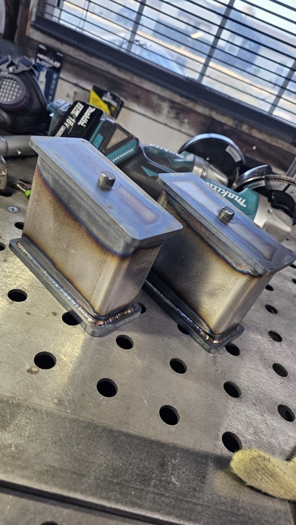

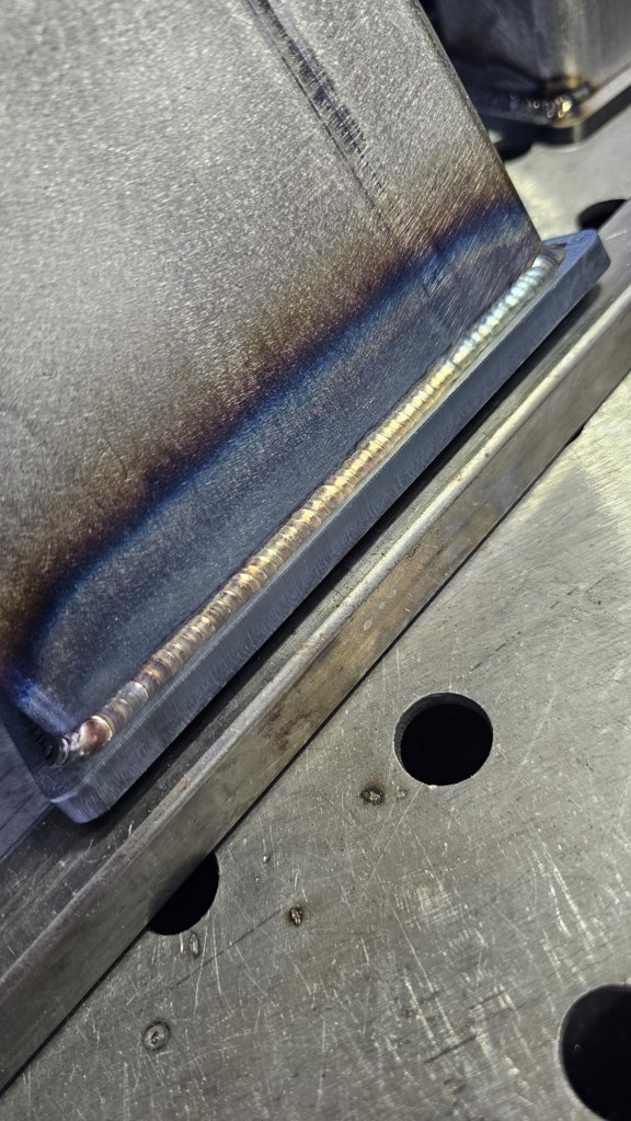

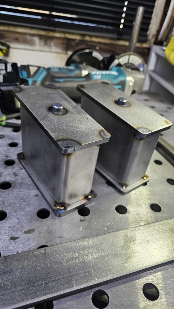

    Some welds from today's order.
    Zebinator, Jakerou, Drainbung and 3 others like this.
  10. Aug 27, 2024 at 7:35 PM
    koditten
    koditten Well-Known Member
    Sep 8, 2013
    #112077
    19,956
    Kirk
    Central Michigan
    04 trd x-cab 4 x 4 3.4l
    Reserected from the dead.
    It really is remarkable how much smoother the welds are as experience occurs.
    They are more uniform than when you posted the earlier versions 2 years ago?
    Unfortunately, they will go the other way as you age unless you do those welds regular.
    My welds when I was in the mid 30s look great. My welds in my mid 50s are close, but I don't see them ever improving.
    I'm not upset at all, 99% of the population could not tell the difference, but I know those regular peeps in this thread could see the difference.

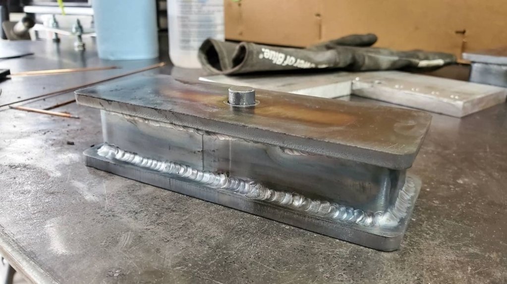

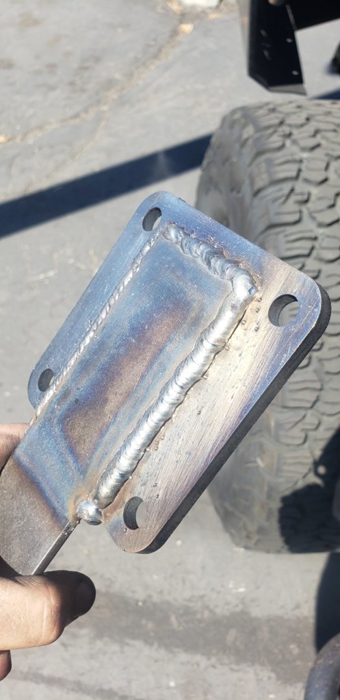

    Thanks man!
    These are my first ever tig welds February 2021.
    This is the first set of tig welded Blocks I ever made for my younger brother. April 2021.
    I wish I welded more consistently but the experience has definitely helped the welds. Currently I'm pretty much only welding when I get orders, which isn't all that often.

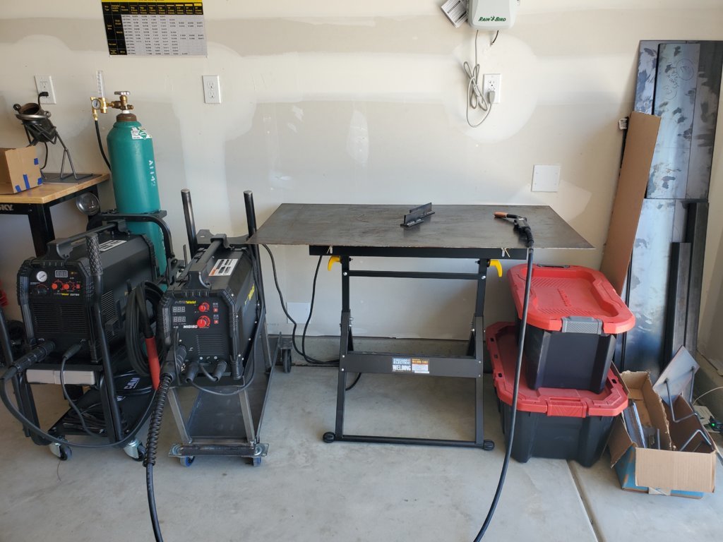

    There it is, my humble setup at home not long ago :laughing:
