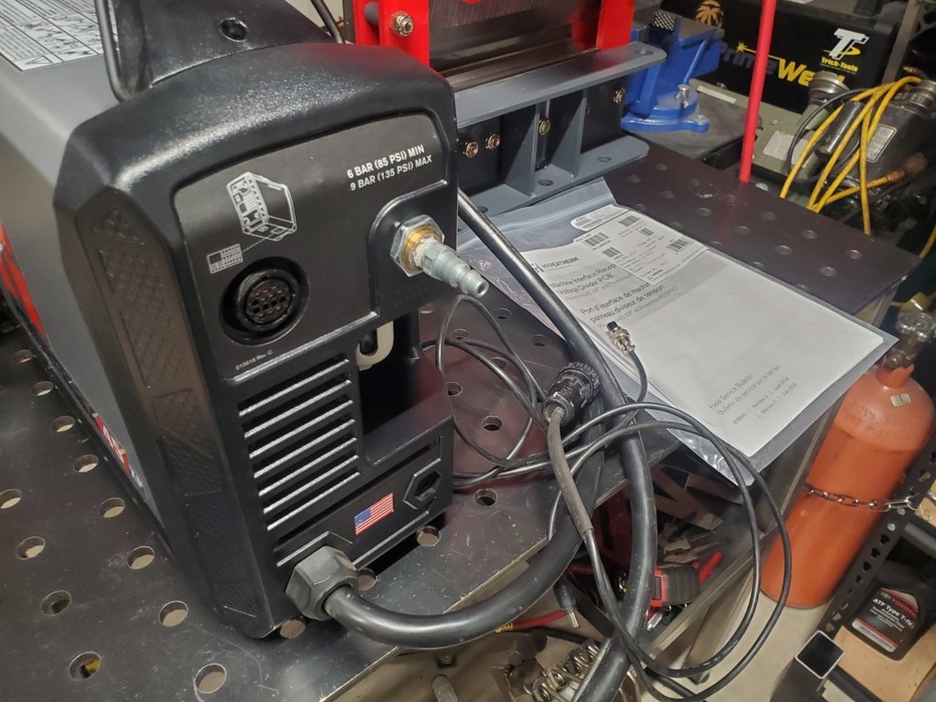

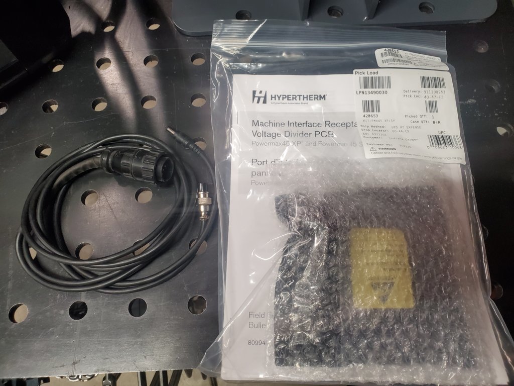

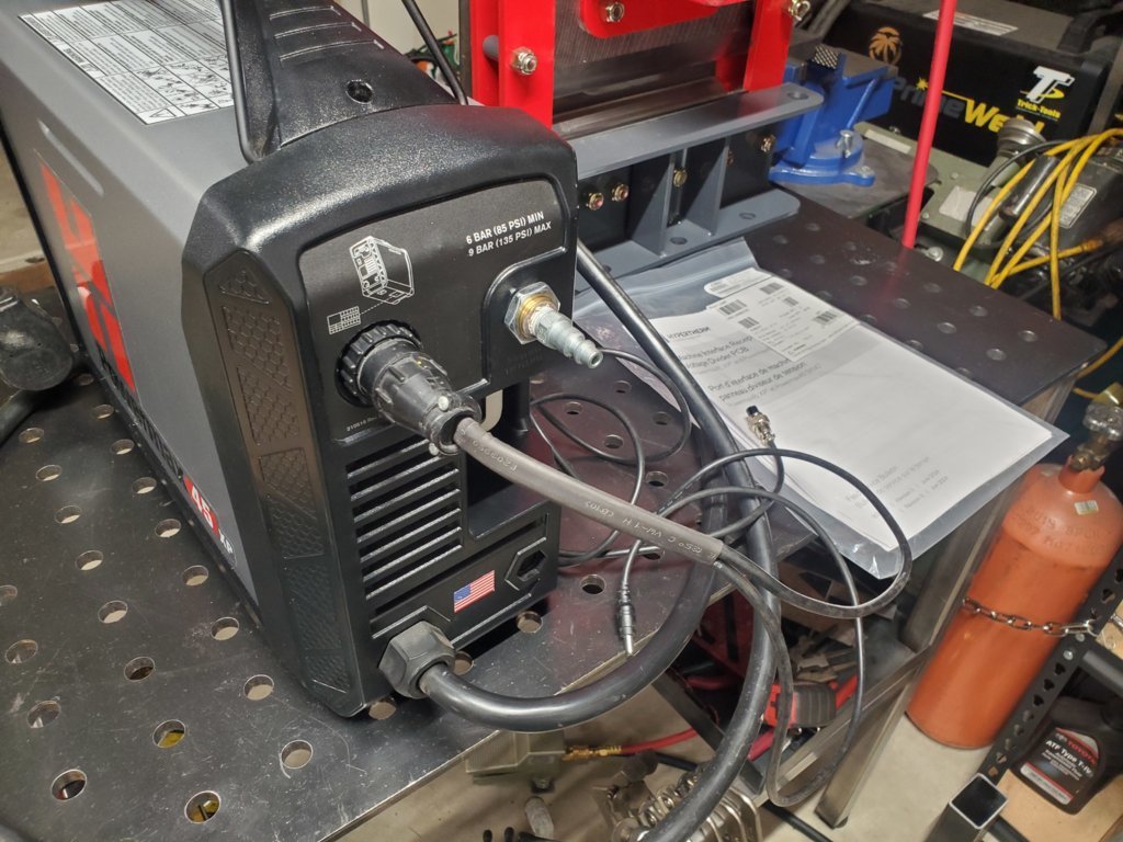

    CPC kit arrived 2 days early
    Along with a free CPC cable someone from the group hooked me up with so that's an easy $80-90 saved
    Installed and ready to go!
    Just need to buy a machine torch now

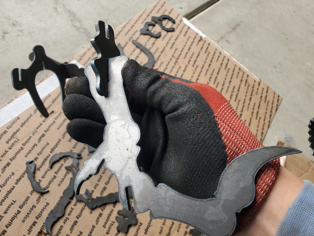

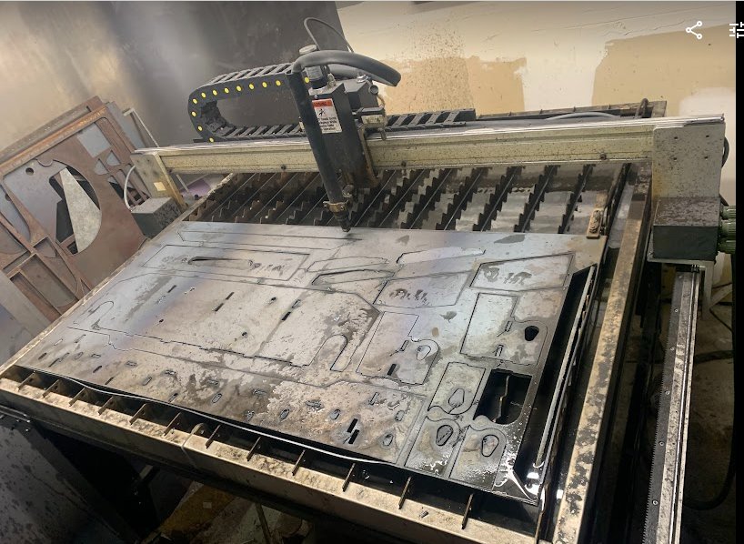

    So I did have a question or you and the other plasma table folks.
    How good of a cut quality can I expect in 1/4" plate? These pictures were brand new consumables and the guys settings he found best.
    He has the eastwood 4x4 table. In my uneducated opinion the hardware should be able to do much better if he took the time to dial everything in more.

    Dross just comes off, at least that should flick off easily with your fingers
    However, I will say I can cut 1/4" and have the whole part come out dross free
    The thicker the material, the less dross you should get

    Oh, Im not too concerned about the dross, I guess my main issue with these parts is the taper they have and how ugly the interior corners are. Causing fitment issues with my tabs

    4 run, 2 don't
    Especially on a more expensive table like that :rofl:
    Dude doesn't have it fully dialed in

    Thats what I figured, I will be getting a table next year and just wanted to make sure the ceiling for part quality wasnt that low. I havent seen many pictures of people cutting 1/4" in this thread

    I took this cause someone had asked me about fitment and all - these parts were right off the table without any clean up

    The one thing I find myself repeating more than anything in one of my groups is to "dial it in"
    New thread pops up asking how to fix this or that, and several regulars will tag me saying I'm about to come in and tell him/her to dial it in :rofl:
    Some people hate hearing it, only to learn at one point or another that it does indeed require time and work from the end user.
    I've seen some shit cuts on CNC plasma, and I've done plenty myself (not as sold work, as experimental), and its just like welding.
    When you see a defect, you learn what it is and how to correct it based on experience alone.
    Based on your pictures, I can say travel speed is too slow based on the bottom dross. The lead-in, especially on that big open circular cut, is way too short because you can see the "nub" due to the lead-in length and lack of radius to it. You can also assume that the torch height is either incorrect, or the torch is a tiny bit angled, or both in order to get some beveling on new consumables. Lastly, the feedrate was the same in those sharp corners (in the rectangular slots) as the rest of the piece hence why it didn't burn the metal completely out.
