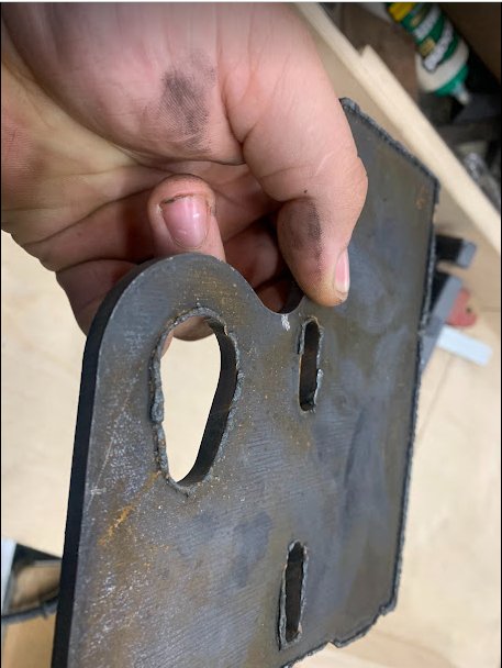

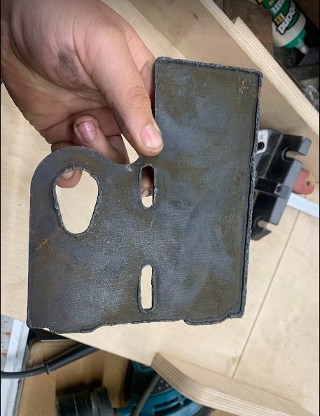

    Yep I understand that perfectly. I have cnc milling experience so its at least similar in that case but a little more mathematical
    I wish I could just dial it in for him but he thinks the quality is good enough. He compares to angle grinder cuts

    Yeah, there are people like that and maybe for what he does it is ok for him
    I'm both dreading but looking forward to dialing in my shit again :bananadead:

    I've seen (and used) worse on a hot humid day here. I'd guess a combination of slightly 'wet' air and running too fast for the amperage used.

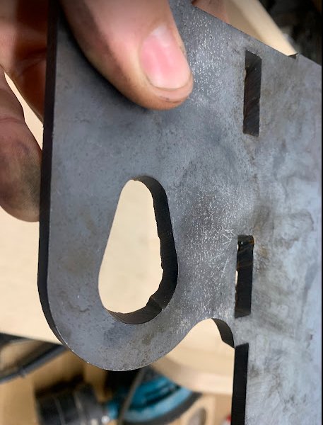

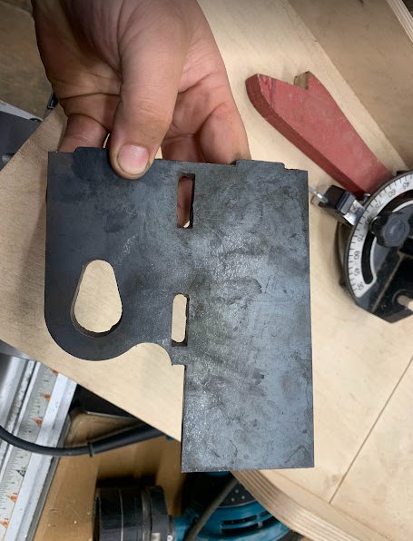

    his settings suck. far too much bevel. we've got 45A and 85A plasma's at work, and either will give me a smoother cut line ran by hand in mild steel.
    here's eastwoods own example cut:
    important to note, speaking as someone with an eastwood welder-- their stuff is what i'd call 'garage fab pretty', where the specs all line up, the form factor and parts look good, and the price is attractive, but after running them for a while, the fact that they're re-branding cheap knockoff brands starts to become somewhat evident.

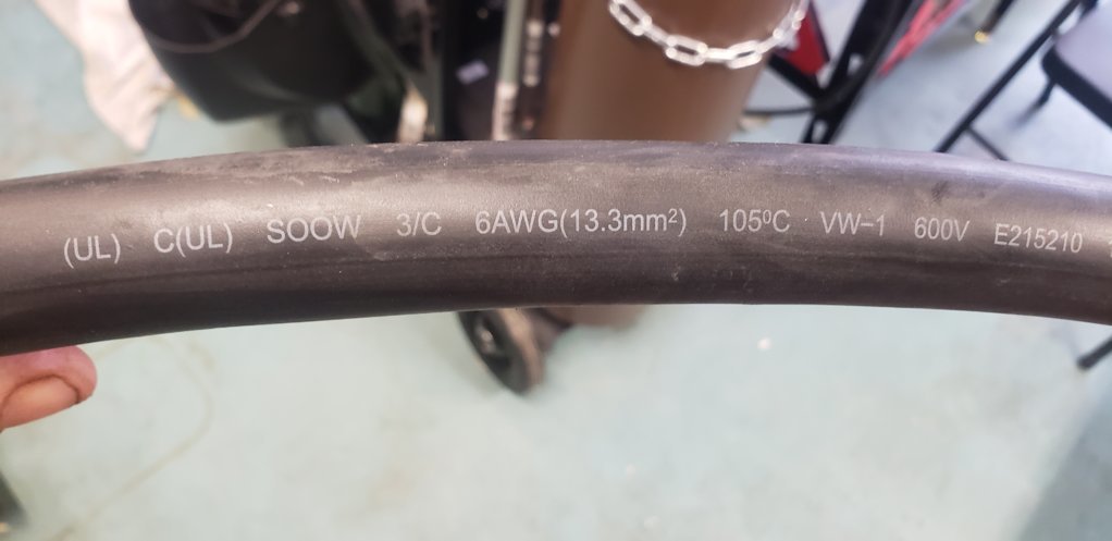

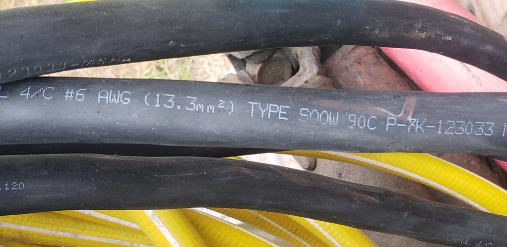

    I run all my 240v stuff off an extension cord. but that is because I do not have 240v in my garage. Years ago I installed a 50amp 240v RV outlet on the side of the house right under the main breaker panel.
    I then run off a super heavy duty 24 foot extension cord. not only is it #6 but it is also rated at 105C. I got it for a steal of a price since it was miscut, the sales rep let me have it for $15 since they wanted it out of inventory.
    here is a 125' or so of #6 but rated at 90C
    The 90c stuff was salvage from a high mast light that got a rewire. I can still get a couple nice extension cords from this last bit of cable.

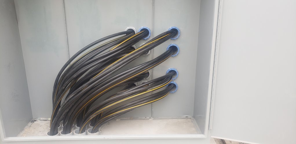

    How about 12 parallel runs of 750mcm with 500mcm neutral? This was from a 2500kva transformer that feed a water chiller.

    that was an absolute STEAL. scrap value is at least twice that.
