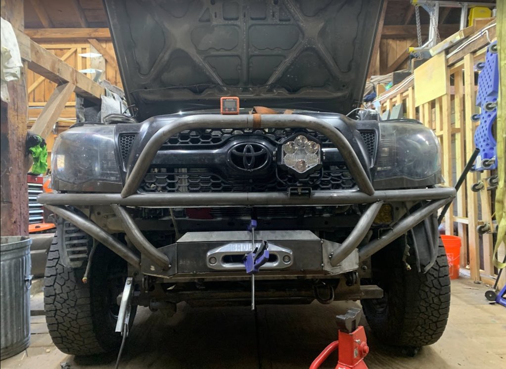

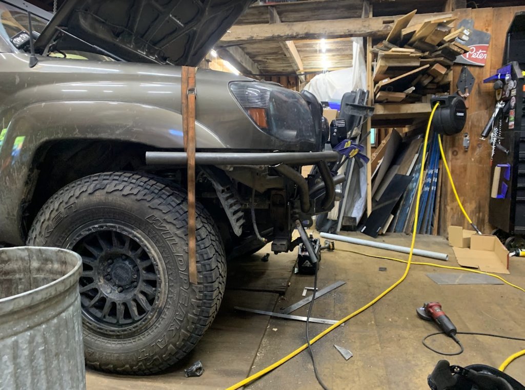

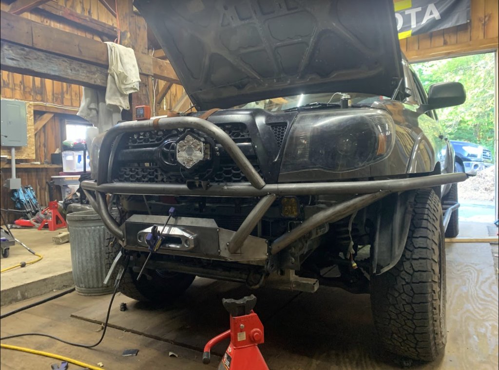

    Got this all tacked up this weekend. Cant wait to get it all finsh welded and on the truck.
    Its a little wild for my taste but I havent seen another like it.

    thats a good looking bumper!

    Drop bracket lift and booger welds
    High and tight and beefy as shit, I love it.

    Curious why you kept the lower stock bumper cross member? Or are you cutting that out after? I did a friends bumper and cut it off and rotated it 90* and rewelded it back between the frame rails.

    Thanks, the key is no straight tubes. Your build it looking sweet too
    73 lbs too without the bullbar, 80 with
    I will be doing that this winter, and doing 1/2" grade 8 bolts instead of the stock studs

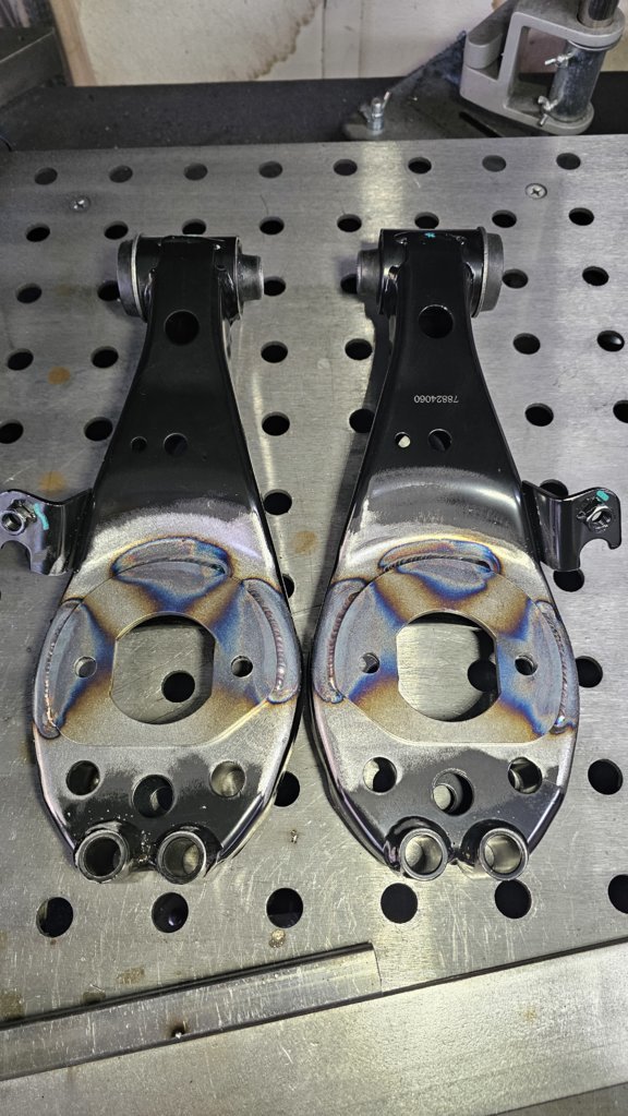

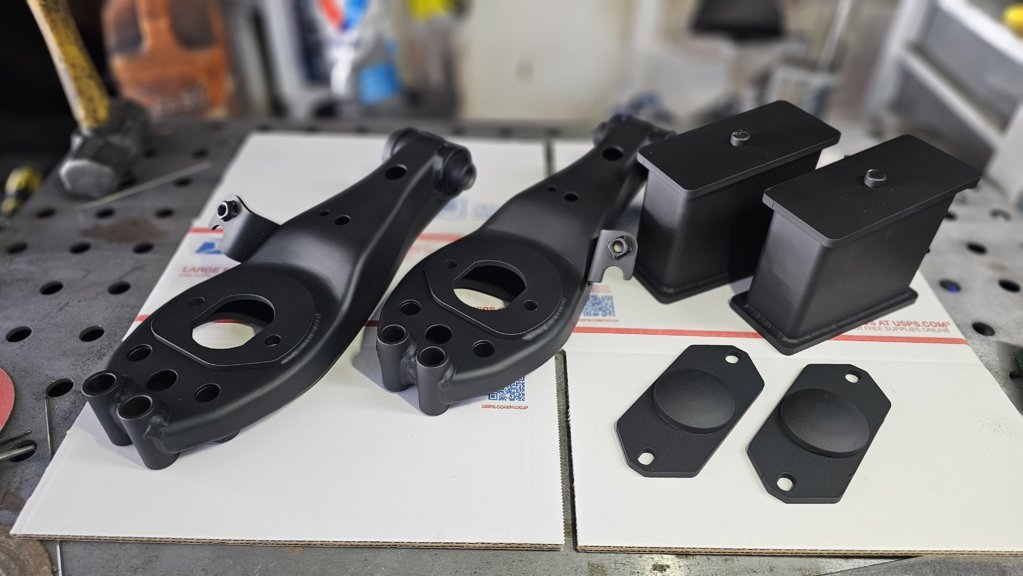

    Full order done and shipped out.
