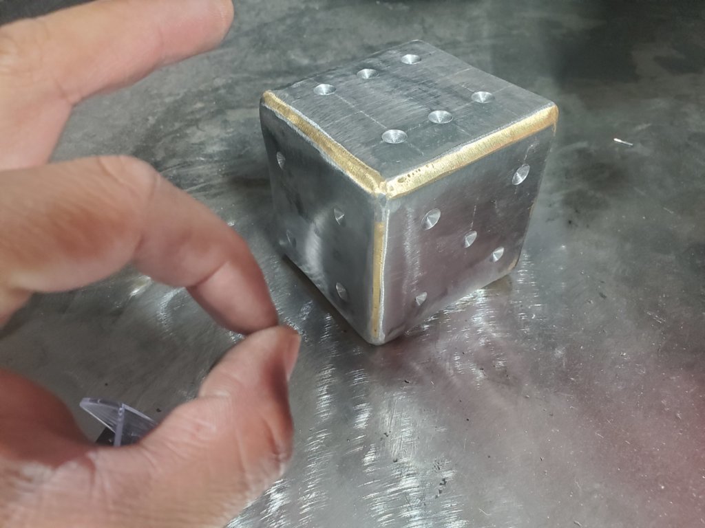

    Oxyacetylene welding is gross
    That is all

    Just torch and filler rod
    I’m not a fan of oxyacetylene welding but it’s in this class
    So here we are

    When you learn oxyfuel welding/brazing, you'll pick up TIG a lot easier

    That’s fair,
    I already tig well
    Oxy is just dirty tig
    But man, the whole getting the torch settings hot enough to keep it melting..
    These school rigs don’t maintain pressure well at all and I really should have purchased my own tip but 80$ tip for a total of 4 classes on it seemed lame

    If you're in school, they should be teaching you about oxidizing, carburizing, and neutral flames
    Acetylene goes on first, adjust, then oxygen

    The rigs leak and the tips are trashed ontop of dirty
    You are right on the mark with your observations.

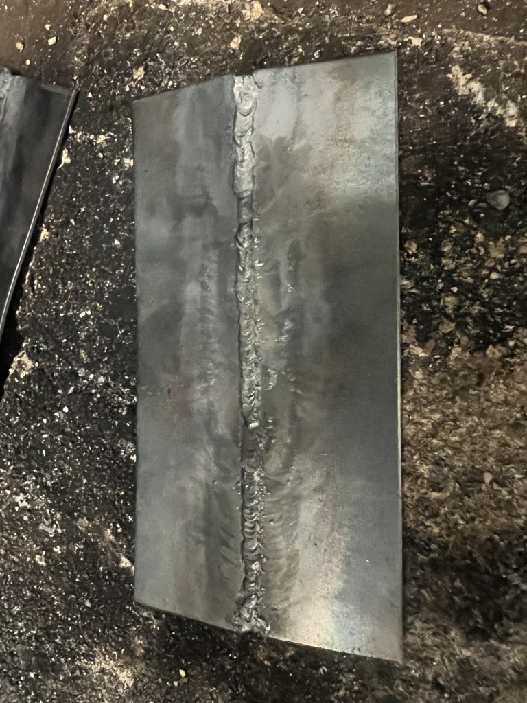

    that one weld pictured was only possible after cranking my pressures up above what The gage said was 5 and 50
    And borrowing my instructors tip.
    not sure if you have this issue but a whole room full of pops and hiss from other students smothering their flame doesn’t help much with making you a tiny bit jumpy :rofl::anonymous:

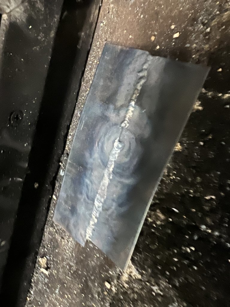

    Here’s a BAD one I did haha
    took so long with low pressures to get the metal to melt that by the time it got puddled it was already getting too hot

    My instructor is super good
    This will be my second school just to get access to different perspectives and more experience/seat time
    But this class has me excited cause my instructor is a CWI and his aluminum tig is WILDLY good.

    Yeah I remember all the popping now that you say that :rofl:
    Don't know how many times I've helped set the flame for others, constantly telling them what to look for
    I may just bring my own setup if I were you, if it's really that bad
    Brazing was fun though! My first project I did.

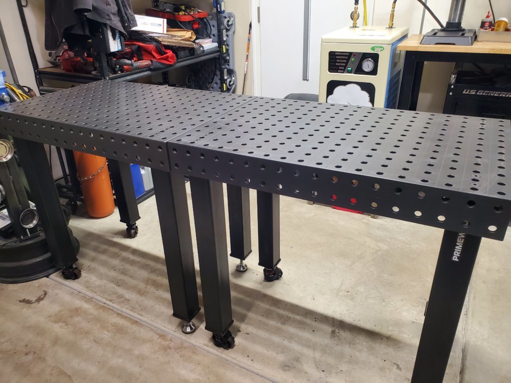

    Scotch brite pads and wd40 and she's looking 100 times better
    Since PrimeWeld had given me a partial refund on my table, I thought I'd spend some of that money on their bolt kit for putting the two fixtures together.
    Can't wait to do so, but even now I checked the flatness of the new table and the largest shim I can get underneath is .008"
