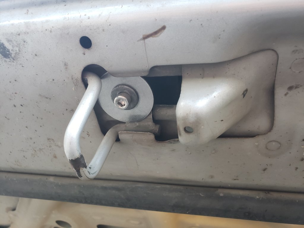

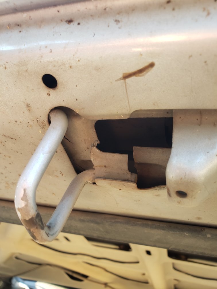

    I figured out why my hood seemed loose.
    Any recommendations on how to fix this?
    ... thinking I might have to cut out some of the lower sheet metal, to access the failed part inside the hood?

    super common problem with these trucks. To the point that there should be a sticky thread or two warning about it by now imo or even a recall originally(only rears it's head after a decent amount of mileage so that won't happen but should've). The aero of the stock hood combined with the flimsy core support causes the hoods to float around a bit at speed and on chattery roads till somethin gives.
    Easiest and better fix than fixing the hinge is to do hood pins to the core support out by where the headlights mount to the radiator core support. Then add some reinforcements to the core support there since it's a much easier area to get to than messing with the hinge and would need reinforcing to fix the root of the problem anyway. Good catch!! Coulda gotten worse fast

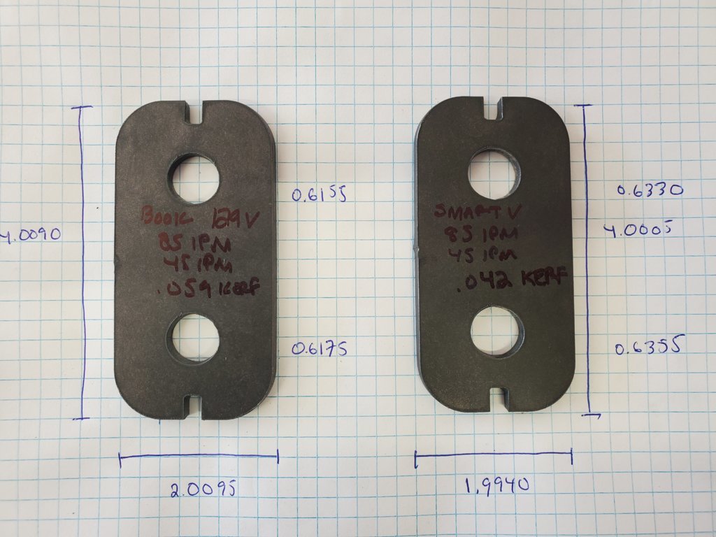

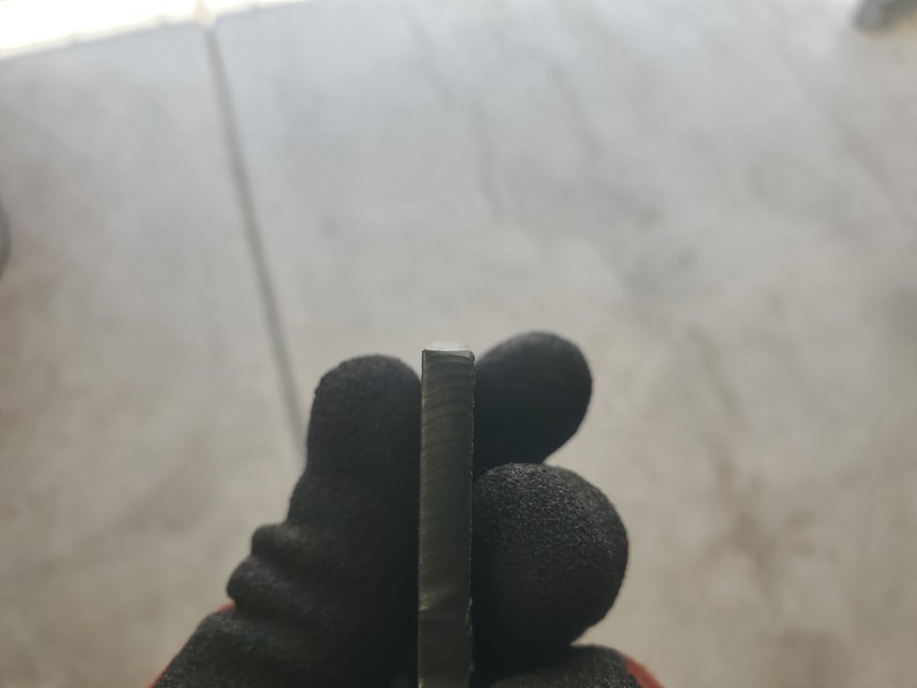

    Didn't have much time to do any real cutting today, maybe an hour tops.

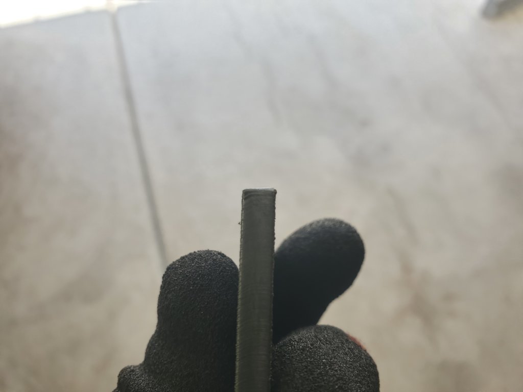

    As part of my test cuts, I didn't want material going to waste so I decided to draw and cut out a clamp holder for my fixture.
    On the left, I kept the item strictly at book settings.
    On the right, I used the recent settings I created with a small adjustment to kerf width for 0.042".
    Finding the average between all the measurements tells me my kerf should be at 0.045" which I'll adjust for tomorrow.
    The real reason for the test today was to figure out how consistent (or inconsistent) smart voltage is on my CNC table.
    Second, to see what my cut height is using the cut chart's nominal voltage.
    Book says to run 129v for nominal voltage - in doing so I found that it produced a cut height of 0.075".
    I opted to make a large adjustment, and run 119v for nominal voltage - this gave me a cut height of 0.035".
    I then ran smart voltage three different times on the same small piece of steel - the first reading was 130.1v, the second was 129.8v, and the third at 129.2v.
    As close as the cuts were from one another and being on the same plate, I would say this is as close as possible in creating the same environment for testing each and every cut.
    When I ran smart voltage, and achieved a reading of 130.1v, the cut height resulted in 0.080". From here, I can deduce that roughly 1v in adjustment will change my cut height by 0.005".
    Running a test at 126v proved that theory to be correct as I achieved a cut height of 0.06".
    Cutting was cut short, but here's a result of the test cut outs.

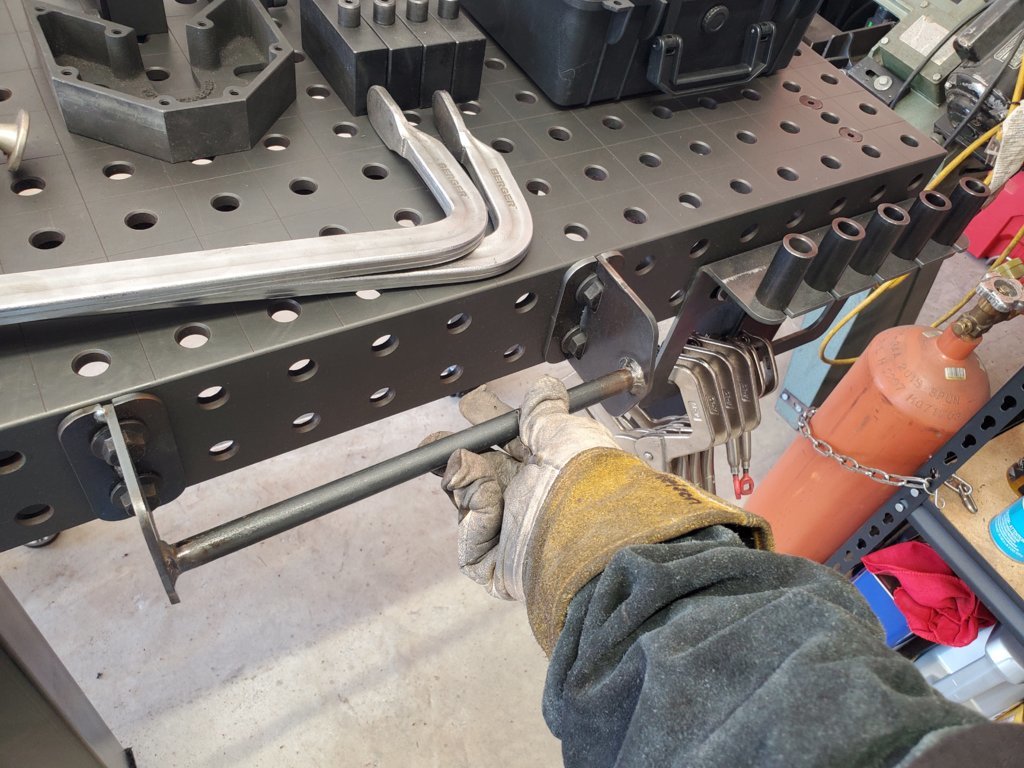

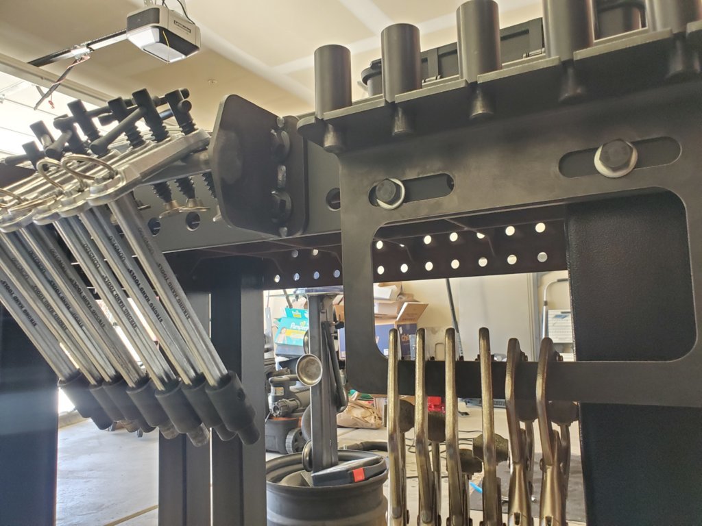

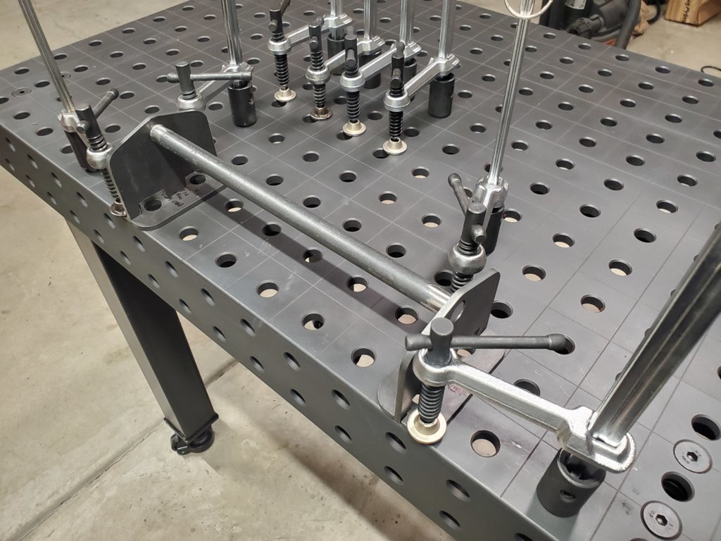

    I just so happen to have some solid round stock on hand which will act as my clamp holder. Once my M14 hardware arrives tomorrow, I will weld up the tabs and mount this to the face of my fixture table.
    Here's the other one bolted up; ignore the M12 hardware as it's only temporary.

    I was afraid of that... as if the snorkel wasn't pretentious enough. Hood pins on an obese worn-out pickup truck?
    I kind of clamped it in place for a 1200-mile camping trip last weekend, having discovered the damage with about 10 minutes to spare before hitting the road -- I lopped off a piece of aluminum bar and tapped a hole in it, so I could sandwich the severed end back in place somewhat with a washer. Got me through the trip, but now the whole latch hook is just jiggling around loose.
    Toyota definitely underengineered the front-end bodywork and core support on these trucks in terms of fatigue life, but to their credit, the hood latch design is doubly redundant -- at least for this failure mode.
    Of course there's the manual catch mechanism to prevent inadvertent disaster when you forget to slam the hood properly, or accidentally pull the hood release while driving. Don't think I've ever managed the latter, but there's a first time for everything... and I've definitely hit the road with my hood popped a few times because I forgot to do whatever caused me to pop the hood in the first place.
    But even if the hook loop completely severs from the hood while you're driving, as mine has since done... so long as the primary latch remains closed around the hook, then the hood's lower metalwork still retains the hook due to the specific shape of the cutout. As far as I can tell, this has been holding my hood shut for some time, rather than the manual latch.
    I guess I'll order some overpriced hood pins and NOS stickers, then.
    Still going to make it worse with a welder first, though. My right as a Free American.

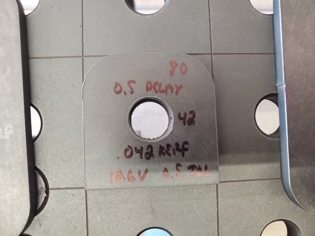

    Yesterday it was determined that 126v was my target nominal voltage for achieving 0.06" cut height.
    I performed a few more tests having altered my kerf width as well and well, the result of my testing -
    Before getting here, I had performed a test cut at 126v, 85ipm outside, and 45ipm inside with a kerf of 0.045".
    Results were better than yesterday, but there was still a bit of bevel and dimensions were still about .003" off.
    I noticed that my voltage monitoring was reading anywhere from 128-130 upon pierce, dropping to 126v, and fluctuating as it made its way around the radius at each outer corner.
    Firecontrol has a built-in tolerance for nominal voltage set at 1.5v by default.
    Decided to lower it to 0.5v, and to help with the fluctuating voltage around the radius, also slowed the entire program speed to 80ipm.
    The results were significantly better -
    I say this to the CNC groups I'm in often, and I'll say it here as well - DIAL IN YOUR SHIT.
    Even with a higher end plasma cutter like a Hypertherm, you still need to take the time to make those small adjustments for the best possible cut quality.

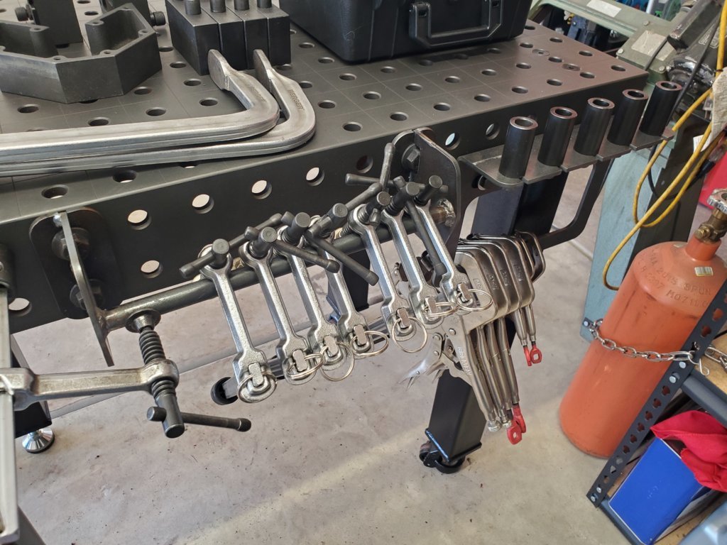

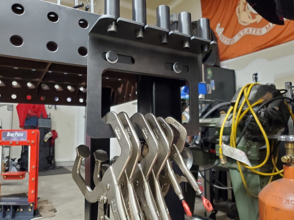

    Didn't take long to get there, so I had some time to weld this thing up.
    Received the wrong nuts (wrong pitch) so here's the clamp holder held in place temporarily.
    I'll have to order a few more M14 bolts for the other clamp holder.
    M14 seems to be the perfect size, and they're far cheaper than those ball lock pins that only work for specific sizes.

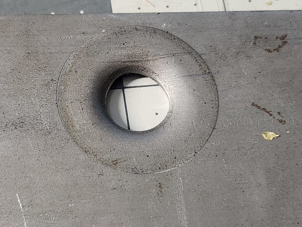

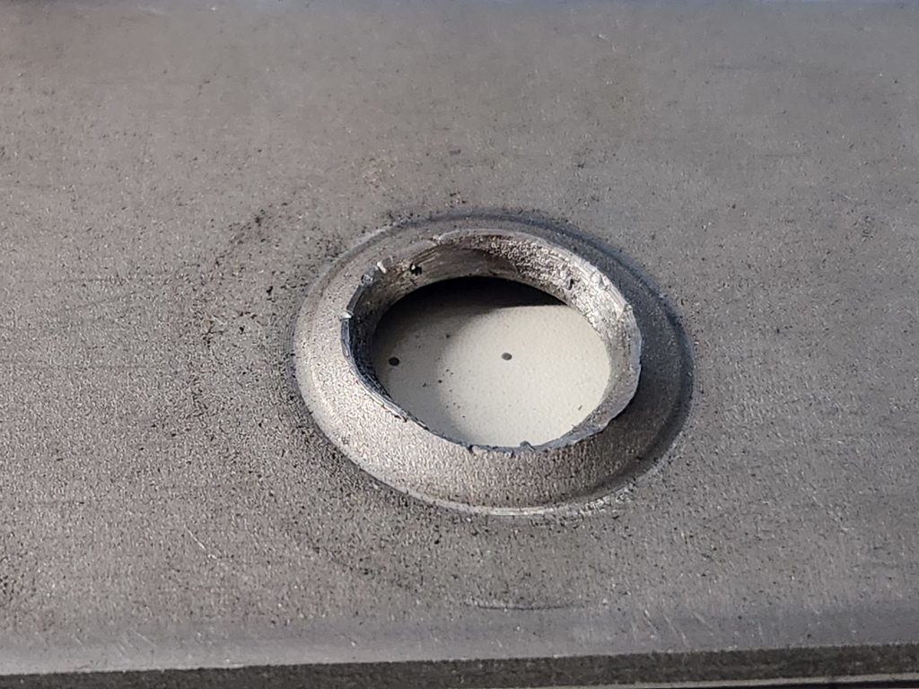

    The Dimple Dies showed earlier this week. I was trying out the 1/2" die mainly because I did not feel like cutting a bigger hole just yet..
    this is in 1/8" cold rolled mild steel. ignoring the crappy drilled hole with a cheap drill bit.. it did a pretty good. But I need to break down and pick up an air over hydraulic jack for the press

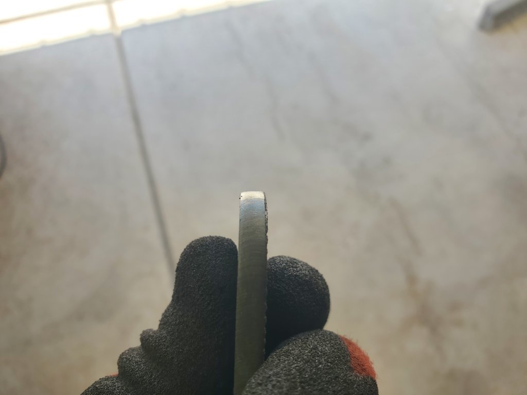

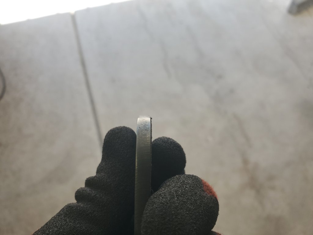

    Cut about $40 in steel in 3/16" just doing test cut after test cut after test cut.
    Yesterday's results were great, but I wanted to ensure I can reproduce said results on other cut outs.
    Long story short, I have a constant beveling issue on one edge (and slightly on another).
    One edge being beveled, would normally affect the edge across from it being on the same axis however it is perfectly square.
    Another edge is a tiny bit beveled with the side across from it also square.
    Having redone the bearings on the torch mount and adjusting the set screws multiple times does not change the beveling at all.
    I have yet to pull my consumables but at 100 pierces it should be far from "bad".
    About ready to strip the table down and put it all back together because none of my experienced troubleshooting is solving the issue :frusty:
    I had gone as far as ensuring the large gantry was square, measuring diagonally from corner to corner, as well as measuring lead screw length on each axis ensuring both sides were parallel with one another.
    zippsub9 and Drainbung like this.

    Pull the consumables. I would not assume that the life is the same between the two machines at least yet. Especially with all the test cuts easy steps first even if it seems too simple an impossible
  19. Sep 17, 2024 at 7:16 AM
    Kwikvette
    Feb 27, 2019
    #284735
    81,509
    Fresno County
    4 run, 2 don't
    You know I'm not new to this! :rofl:
    Already swapped them yesterday, and that's when I walked away but the consumable set had exactly 62 pierces.
    Tests don't start unless it's a brand new consumable set. Came from a brand new consumable pack.
    So by having swapped them yesterday I'm hoping they were somehow a fluke hence mentioning it. I'd be stoked actually even if I had to toss an expensive consumable set so early.
    Pyrotech[QUOTED] and Drainbung like this.
