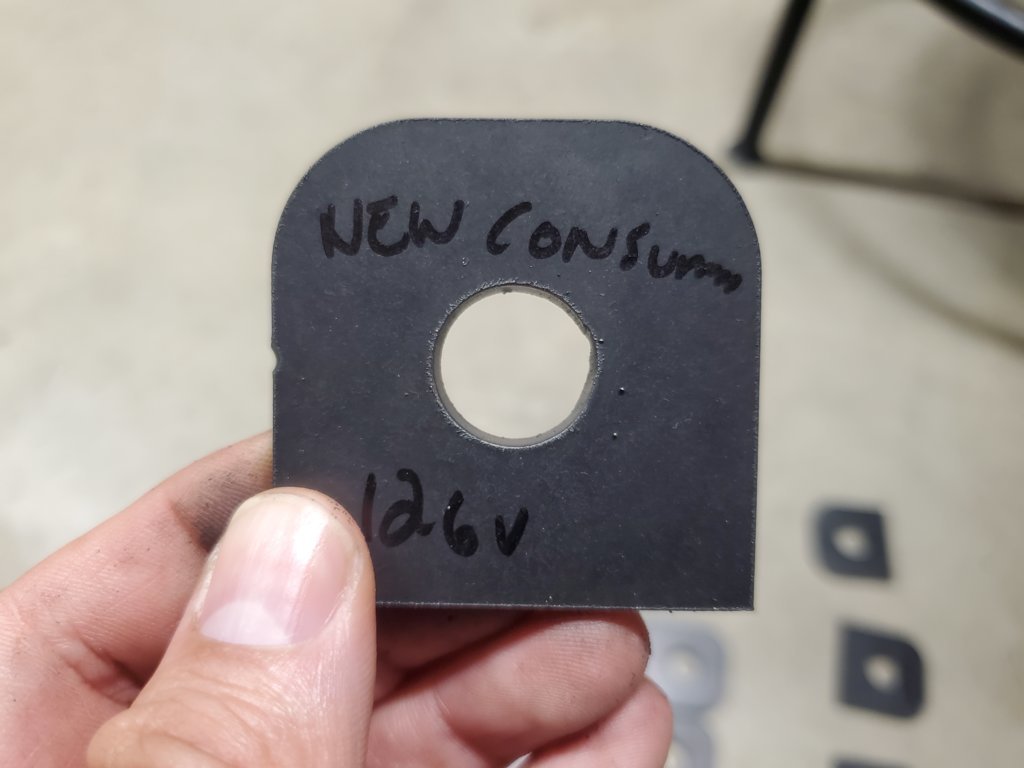

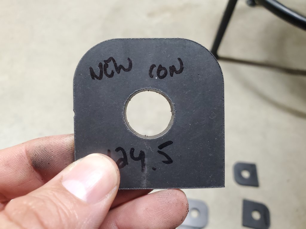

    So, I'm just adding as a filler here for anyone bored - not looking for help, suggestions, etc.
    Simply typing out the issue, what was done, and measurable differences (if applicable).

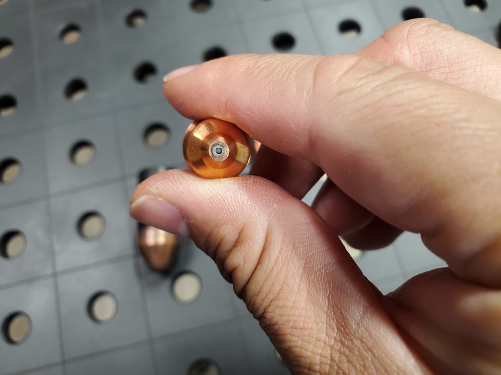

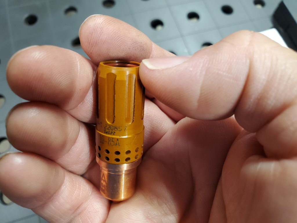

    Crossfire Pro
    Hypertherm 45XP
    Duramax machine torch

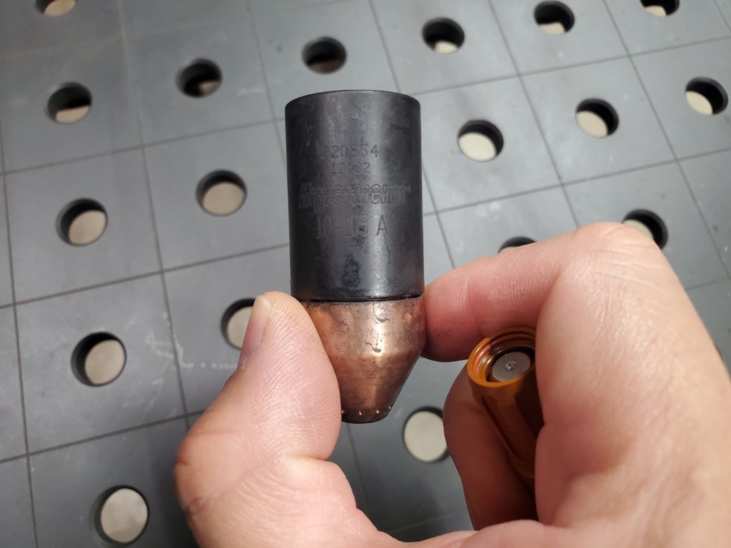

    45 amp mechanized consumables (genuine HT brand)

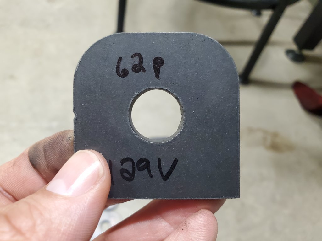

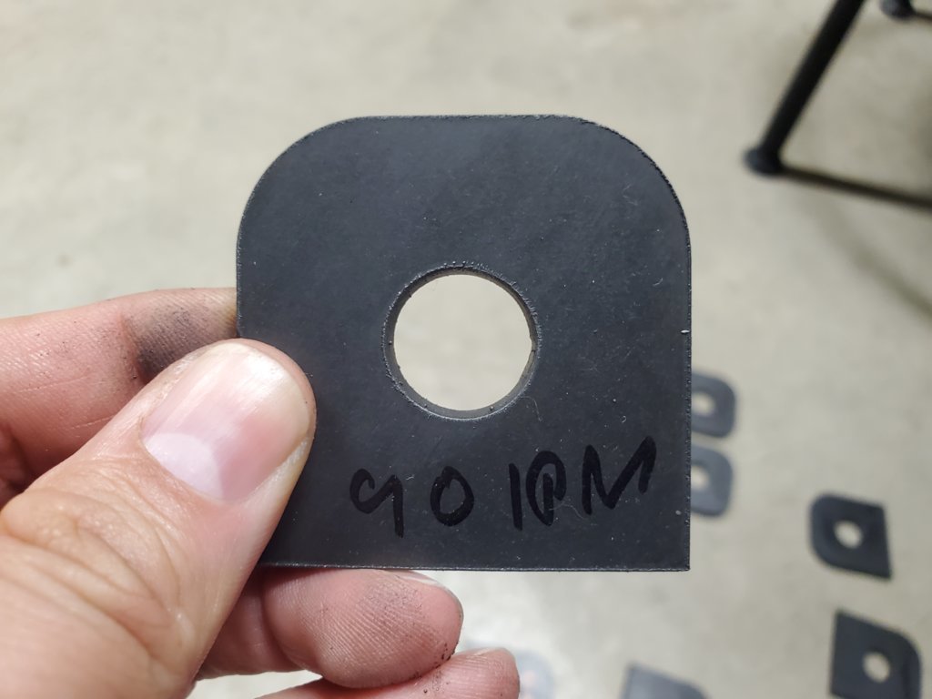

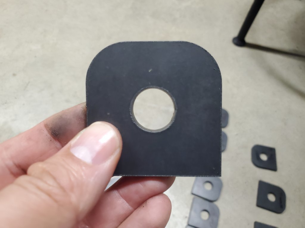

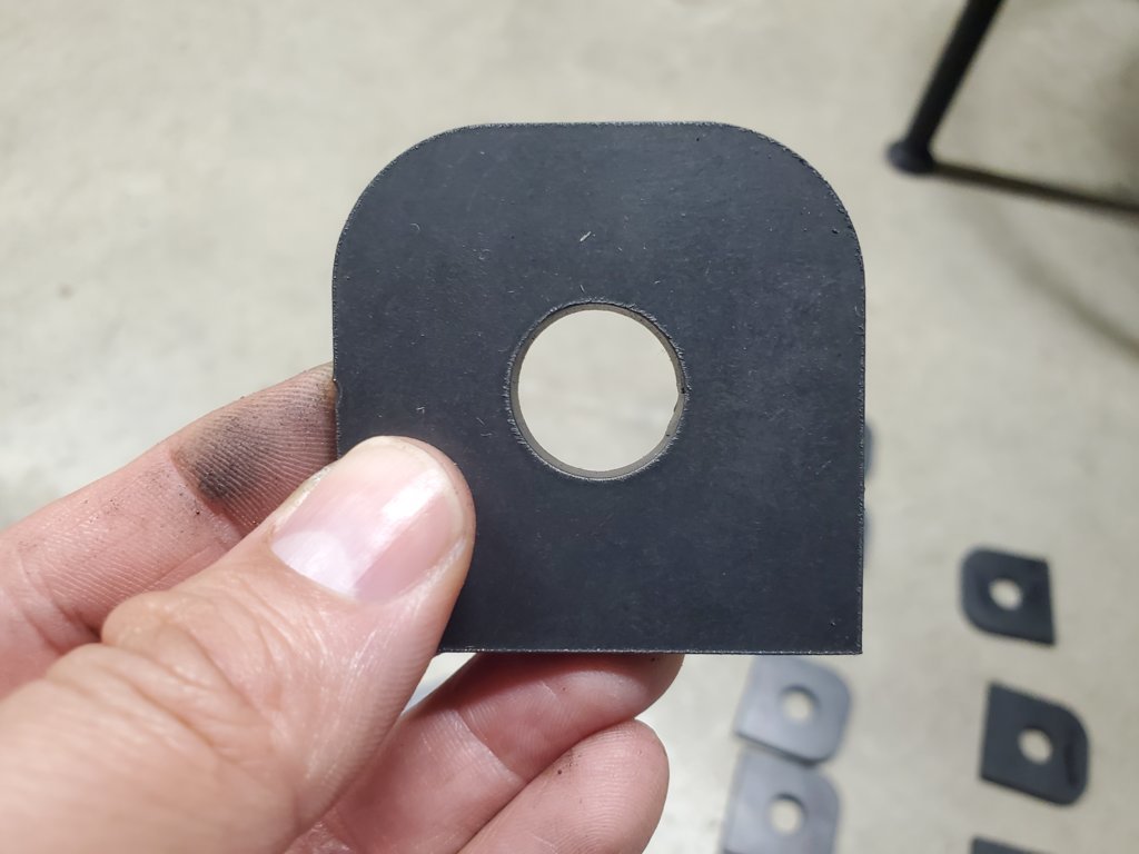

    Issue -
    *Pronounced bevel on the top edge of an item, X axis, but not the opposing side

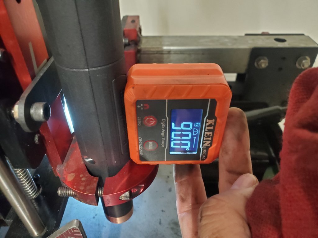

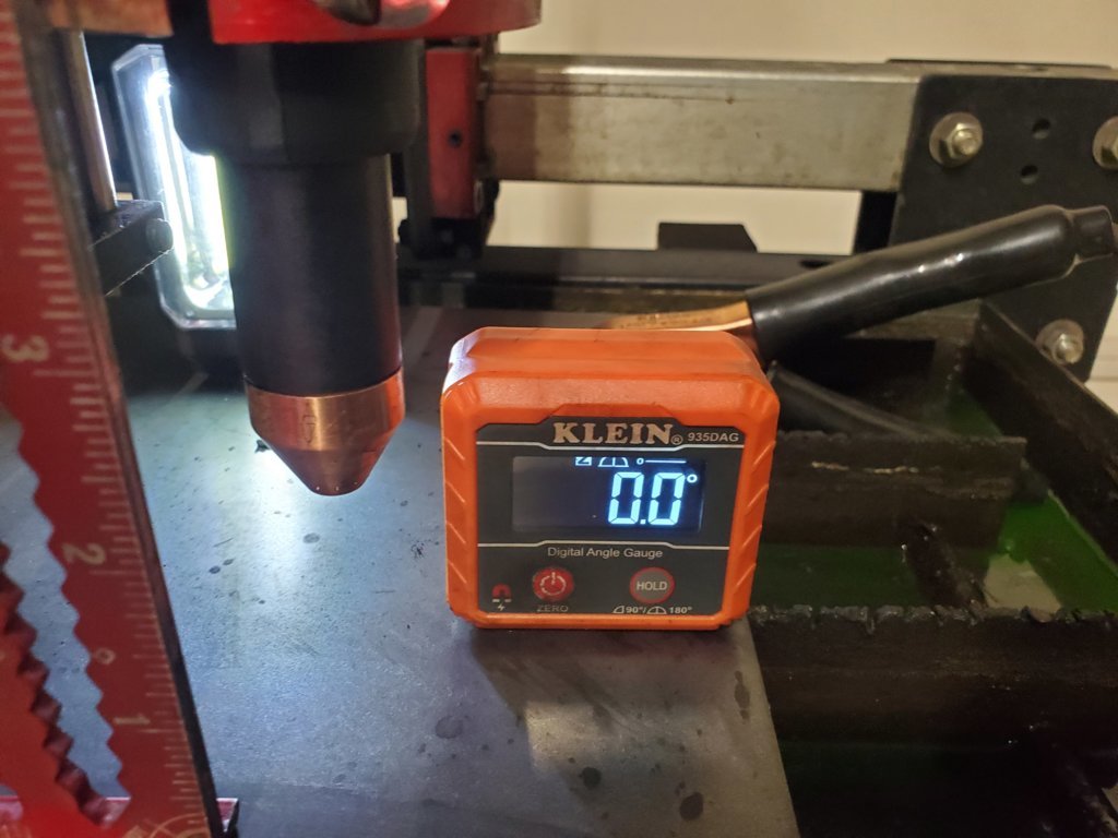

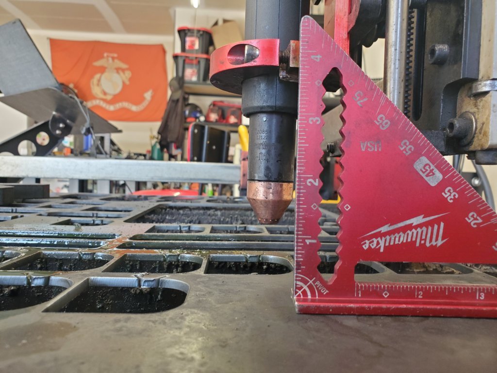

    Troubleshooting -

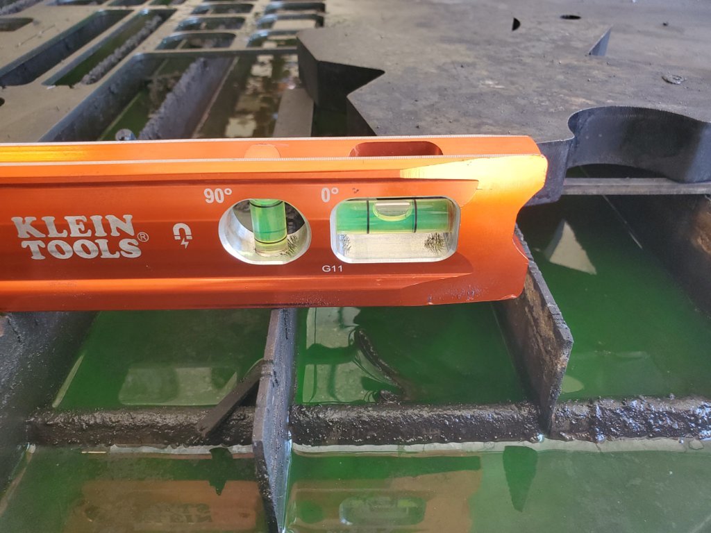

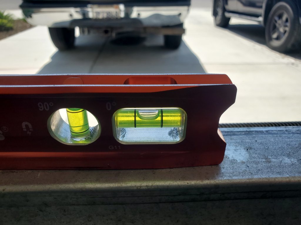

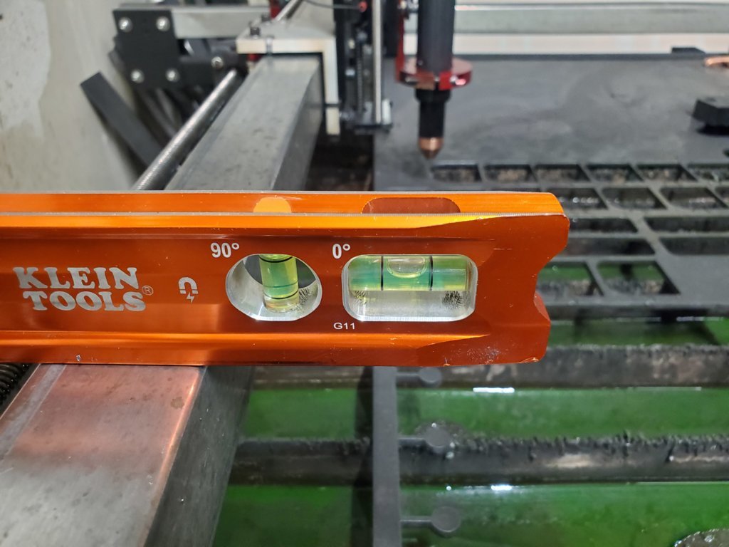

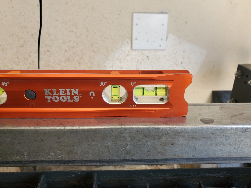

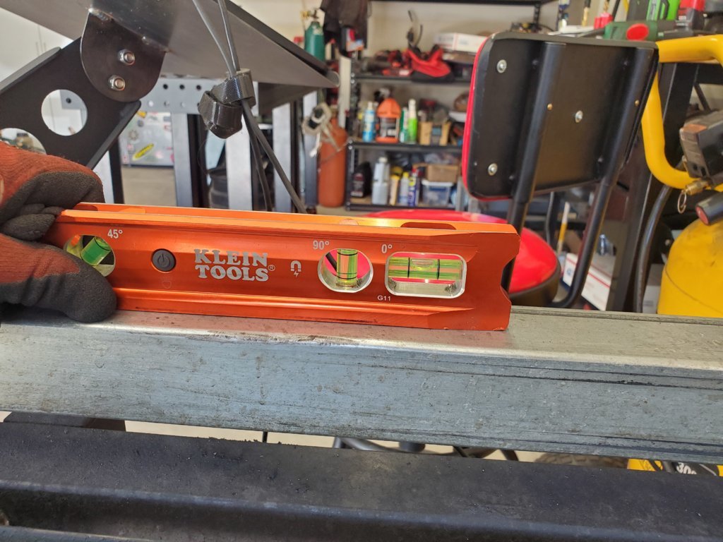

    *All gantry tubes ensured for level and square, placing a level even on a slat in the waterbed or the 3/16" plate sitting on the slats show it is flat and level with the table itself
    *Panning Y axis and measuring both lead screws ensuring even, parallel movement between both sides
    *Ensuring correct stepper movement, parts are accurate to within .005" of CAD
    *Machine torch was completely dismounted and remounted over 20+ different times including; completely resetting all set screws, undoing all carriage bearings, and tramming Z axis to square the torch mount to the gantry tube itself, and ensuring the torch mount holder and torch itself is perfectly 90 degrees perpendicular to the slats and/or metal being cut
    *Added shims to introduce artificial canting made little difference, as the pronounced bevel on the top edge remained
    *Rotating the torch itself within the torch mount, ensuring the torch itself isn't cutting at an angle

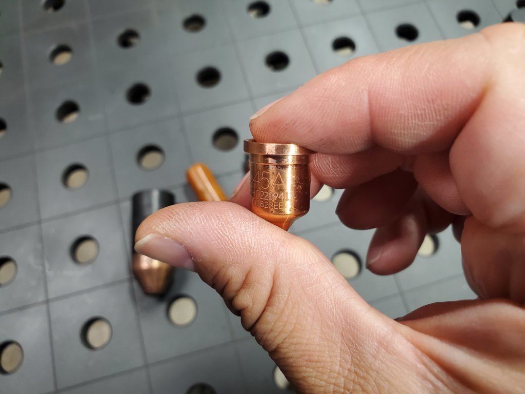

    *Swapping consumables again
    *Rotating the CAD design by 180 degrees, bevel still occurred on top edge
    *Running different air pressures
    *Running different torch speeds as low as 60ipm to as high as 90ipm
    *Running smartvoltage for a programmed height of .025" which equates to a physical cut height of .060"
    *Running nominal voltage at 123.5v, 124.5v, 125.5v, 126v, 129v (book), and 130v, which range from a physical cut height of .020" all the way up to 0.085" with no change to the excess top bevel, only affecting the sides slightly
    Running with torch height control completely off
    *Bypassing refrigerated air
    *Measuring the resistance from torch clamp tip to the dinse connector, ensuring less than 4ohms resistance
    *Providing Langmuir customer support a DXF file, having them post process through Sheetcam, and providing said cut files for me to test with various items changed at their discretion
    I know I mentioned bevel, and even a novice will say "oh bevel, either wrong torch height or canted torch mount" because really those are the two things to diagnose right away. Well the edge opposite of the bevel is completely square. In the event of a canted torch, the beveling on one side would be that of an / with the opposing side being that of a \.
    The fact that all of the above still produces one side beveled (outside of normal tolerances) while the opposite side is mostly square is what's so bizarre.
    I even cut one of those bed stiffener parts, and compared it with that of a set I have here already; the bevel is absolutely noticeable on just the top edge.
    The next troubleshooting steps for either tomorrow or the following days are, wait to see what Langmuir says when they call me after speaking to others more knowledgeable, and then having a go at running it with my Hypertherm hand torch to eliminate the machine torch from being faulty. Technically, we already ruled this out having rotated the torch within the mount itself but we'll see.
    And lastly, reinstalling the CUT60 and seeing how it performs.

    I don't know shit about your process, but I did think of a couple of questions:
    Does this happen everywhere on the table?
    Do internal cuts come out clean?
    Should I just STFU?

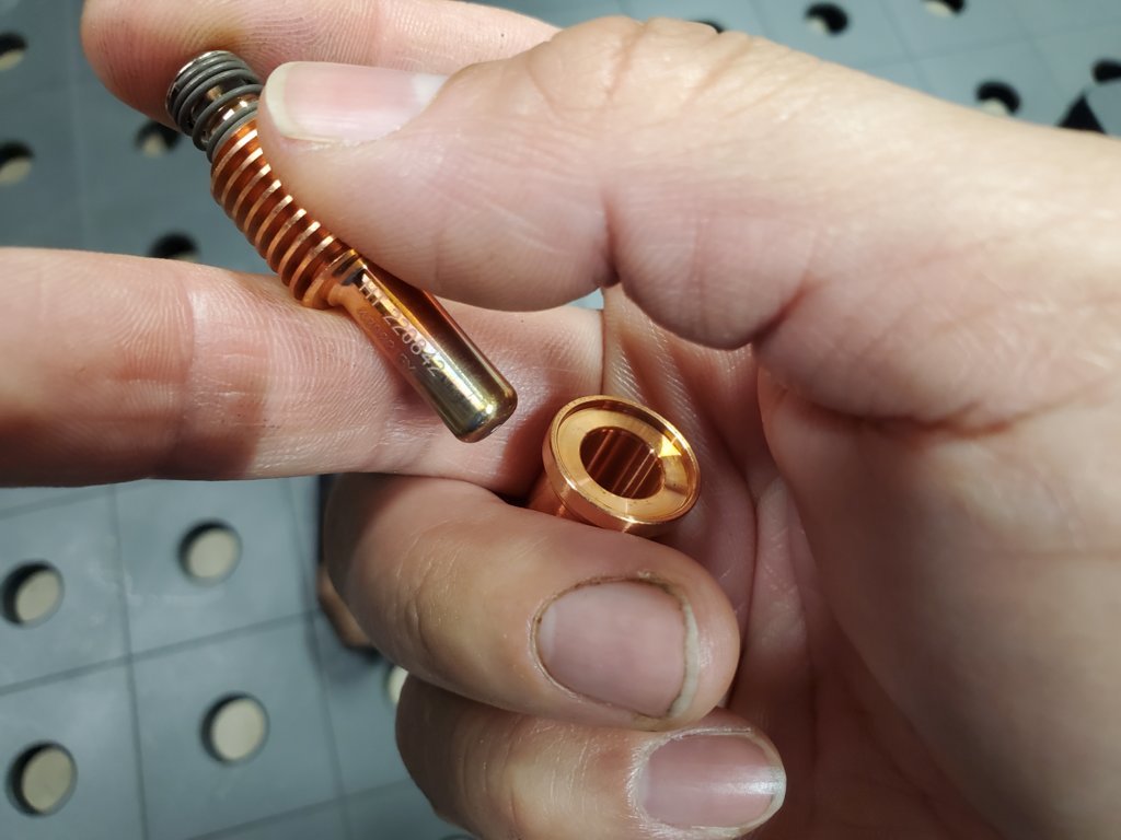

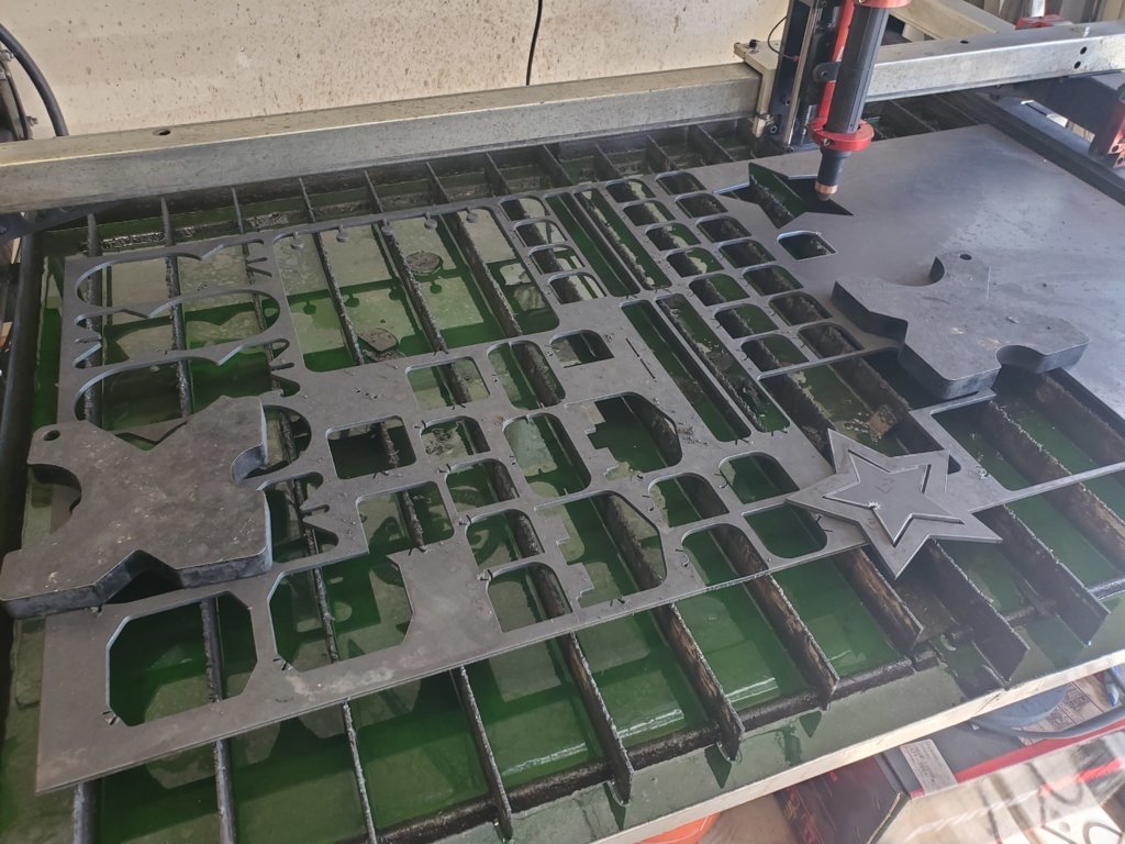

    Torch and mount
    X gantry
    Y gantry (both)
    Water bed/slat
    Many cutouts, which showcases the top edge bevel occurs the same on different areas of the table
    Today's consumables, all genuine like yesterday's set to showcase correct part numbers as well as the use of genuine parts

    Yes to the first question
    Yes to the second, you can pick up any random cut out on the floor and see a nice rounded circle which also is a result of X and Y both panning correctly
    Ignore any crud you see poking out from the backside; dross becomes more or less apparent as variables change in the cutting process
