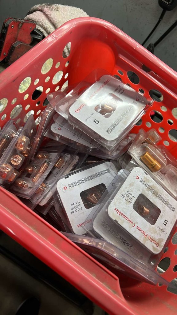

    Oh and to add to this, she uses cheap knock-off consumables she buys in bulk
    The other person's were better, but those are lost in conversation now as I was bouncing all of this off of him too :violent:

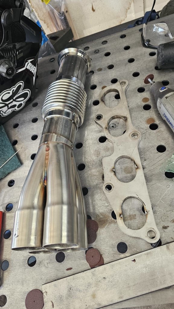

    Got the header apart gonna start welding it up tomorrow

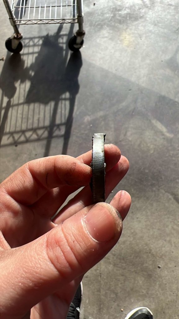

    So, I understand we have varying levels of experience in this group.
    I am not discounting any of the questions or comments mentioned here, but I also want to address the "bevel = normal" thing that's been mentioned a few times.
    1. Slight bevel/taper is normal, it happens, and it should be expected. I know this and I think I mentioned it already.
    2. Excessive bevel/taper is not normal, and it should go away when many different parameters are changed (including physical changes in the torch mounting, gantry squaring, etc).
    With that said, here are the edges of an item cut within days of adding the Hypertherm, but cut on my chinese plasma cutter with chinese torch and chinese consumables on the same 3/16" steel that I used to cut my test pieces for my Hypertherm -
    Let's not forget the above test piece (the small 2" square) that was cut on an identical machine and machine torch that provided results like my CUT60 does here.
    So again, slight taper is normal and expected.
    But excessive beveling is not.
