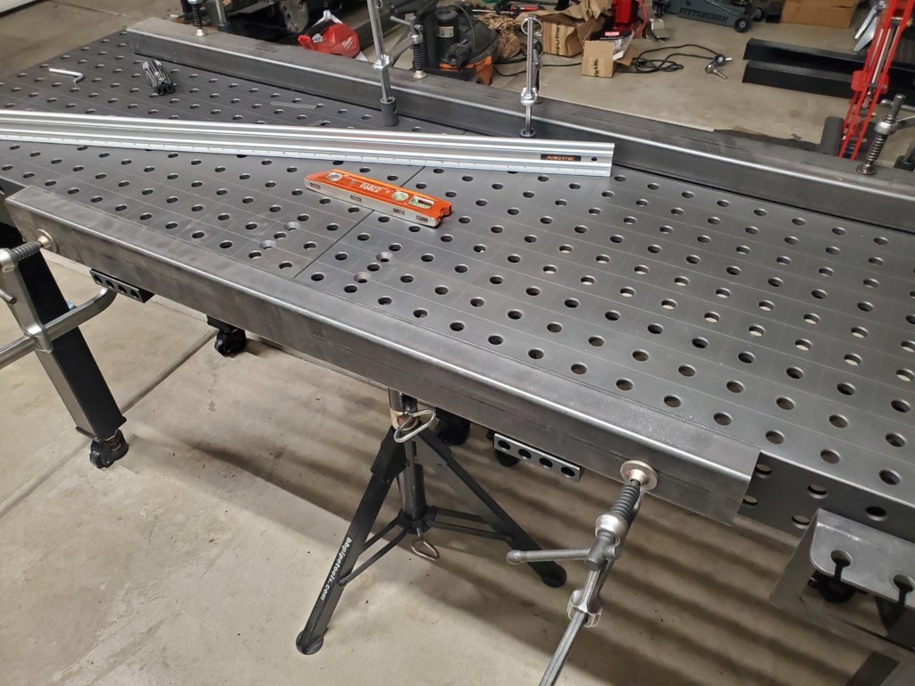

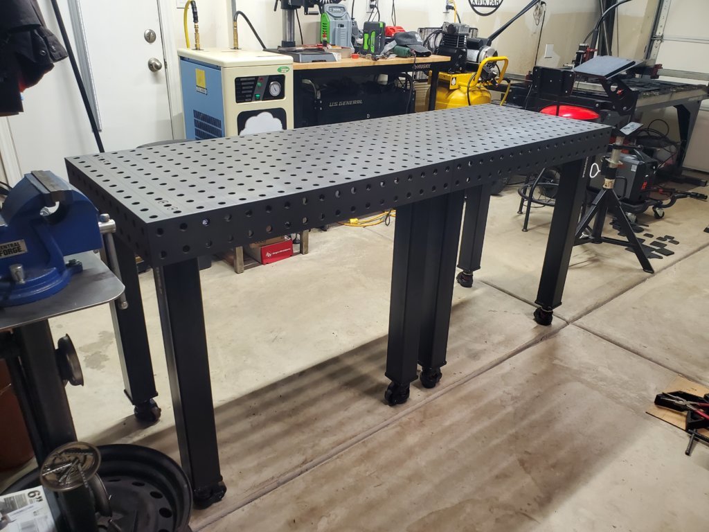

    Bolt kit arrived!
    I am in love with all the room I have underneath
    Contemplating almost removing the two center legs though
    Just need to bolt on some square tubing to flatten it out, level it, tighten the bolt kit, and unclamp the square tube

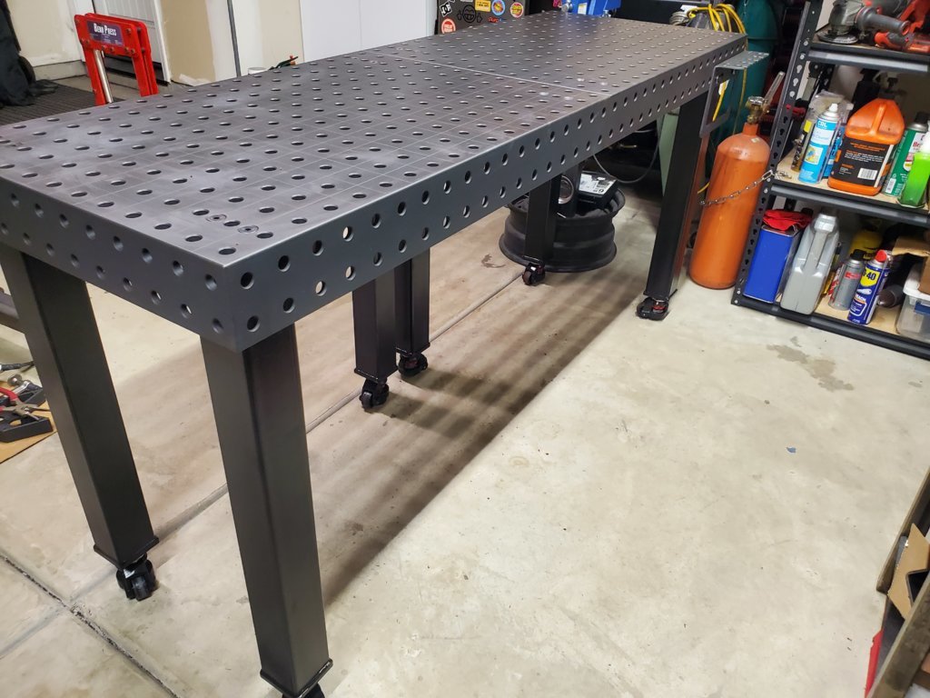

    That's a pretty long run. I'd leave the legs, but I'd move one of them to the opposite side.

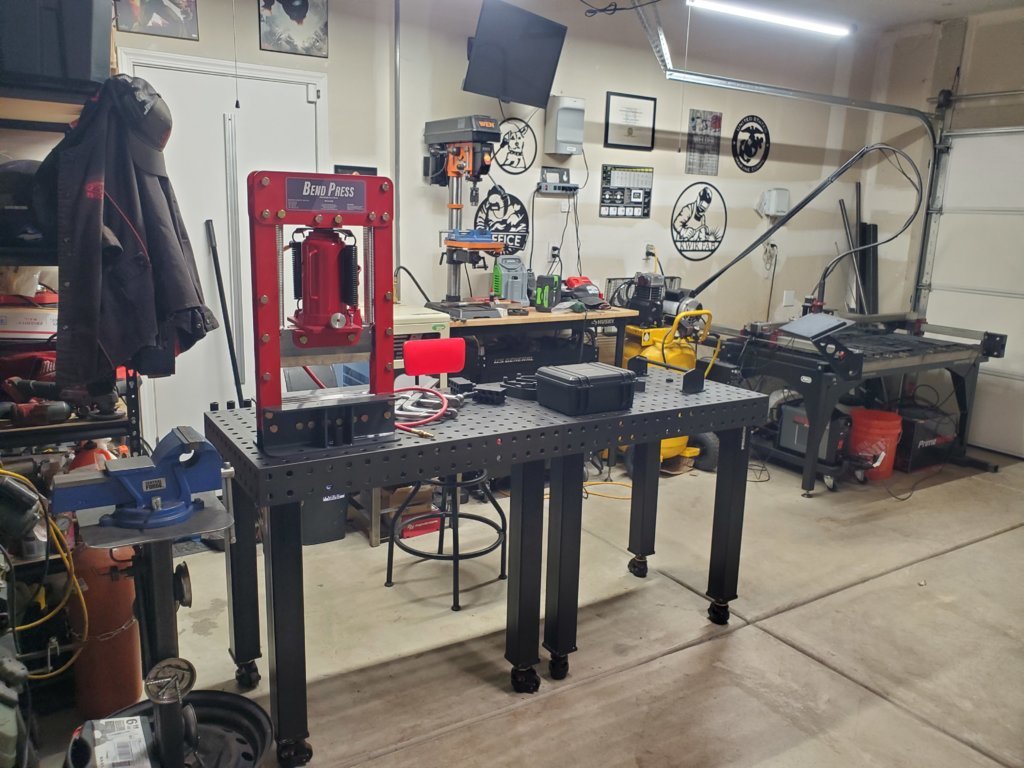

    In this configuration, I have a 2' x 6' table
    Yes it's rather lengthy, but it was done this way for three reasons
    1. It gives me a comfortable working space between the drill press and the table
    2. In keeping the above in mind, if I resort to pushing it towards the center of the garage, I give up comfortable working space for working on a vehicle
    3. I can handle overhang from a wide item with pipe jacks; if I run out of room length-wise I run the risk of the added leverage forcing someout out of square

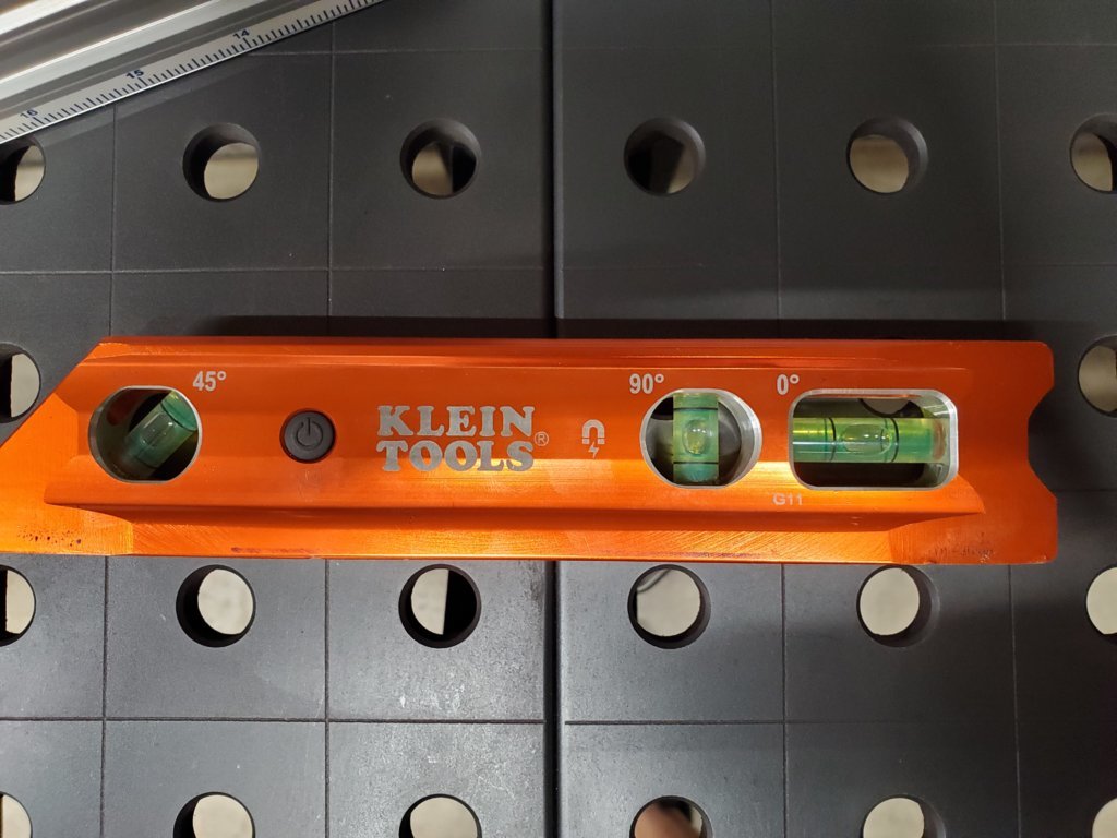

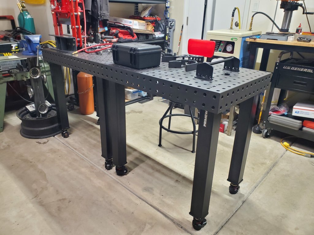

    Here I was just getting done unbolting my tubing
    Leveling was "good enough" for me, I don't own a machinist level
    Got the press brake off the floor finally, this is where it'll live
    Just need to make ways for storing my tools now
    But, you do make a good point about the length still. Ideally I'd rather run them side by side for a 4' x 3' configuration.

    Can you move the corner legs inboard and lose the center legs?

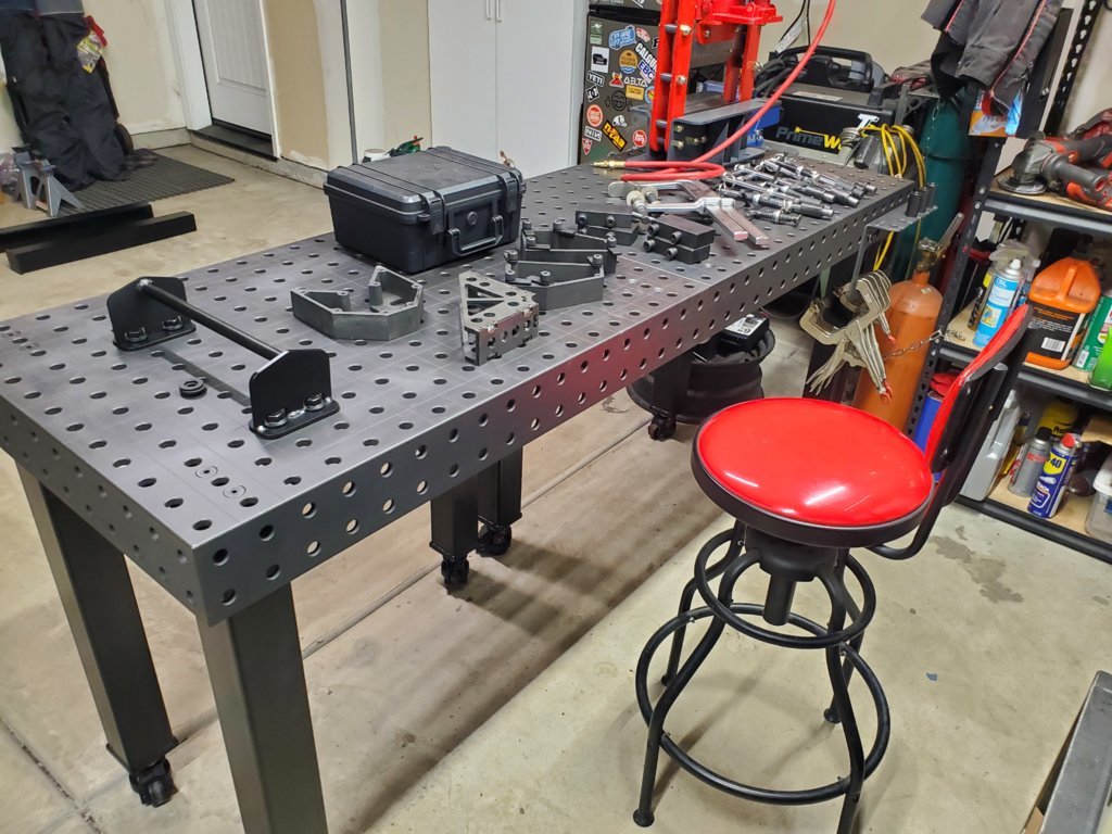

    The tables have countersunk holes for bolting the legs together
    They only bolt to each corner, which results in the legs in the center there as you see; they can be omitted completely but not placed anywhere else under each fixture
    An example of that (tables are stuck side by side in this pic)
    Otherwise you can use all of them
    Or, the way I did in my pics.

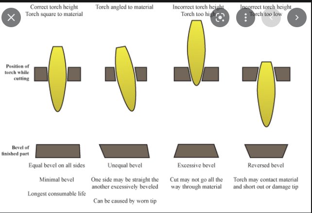

    For my own edification, does a plasma torch make a kind of conical cutting stream? Or is it a perfect cylinder? if it's a cone, what's a typical angle? Like, if everything was PERFECT, would you expect a consistent angle on the cut edges? A degree? More? and does the cone come to a point like a pencil or fan out like spray paint nozzle?

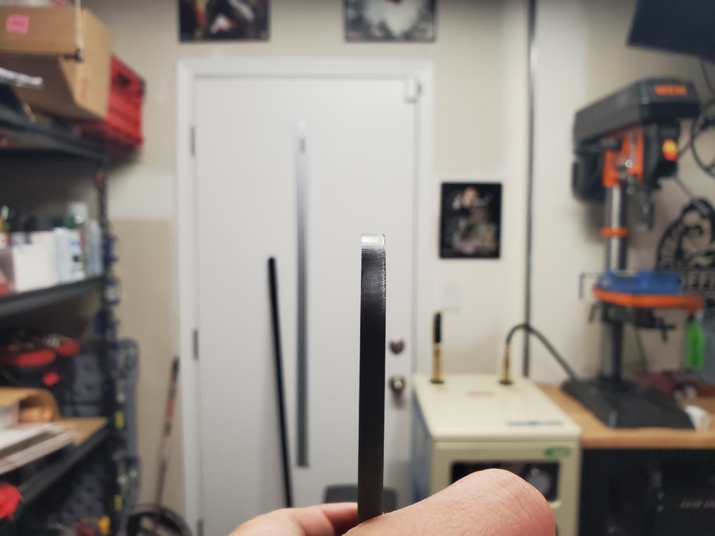

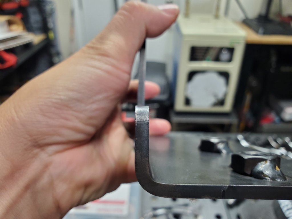

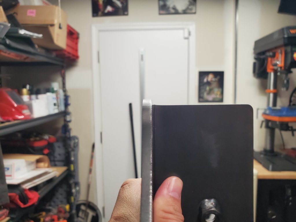

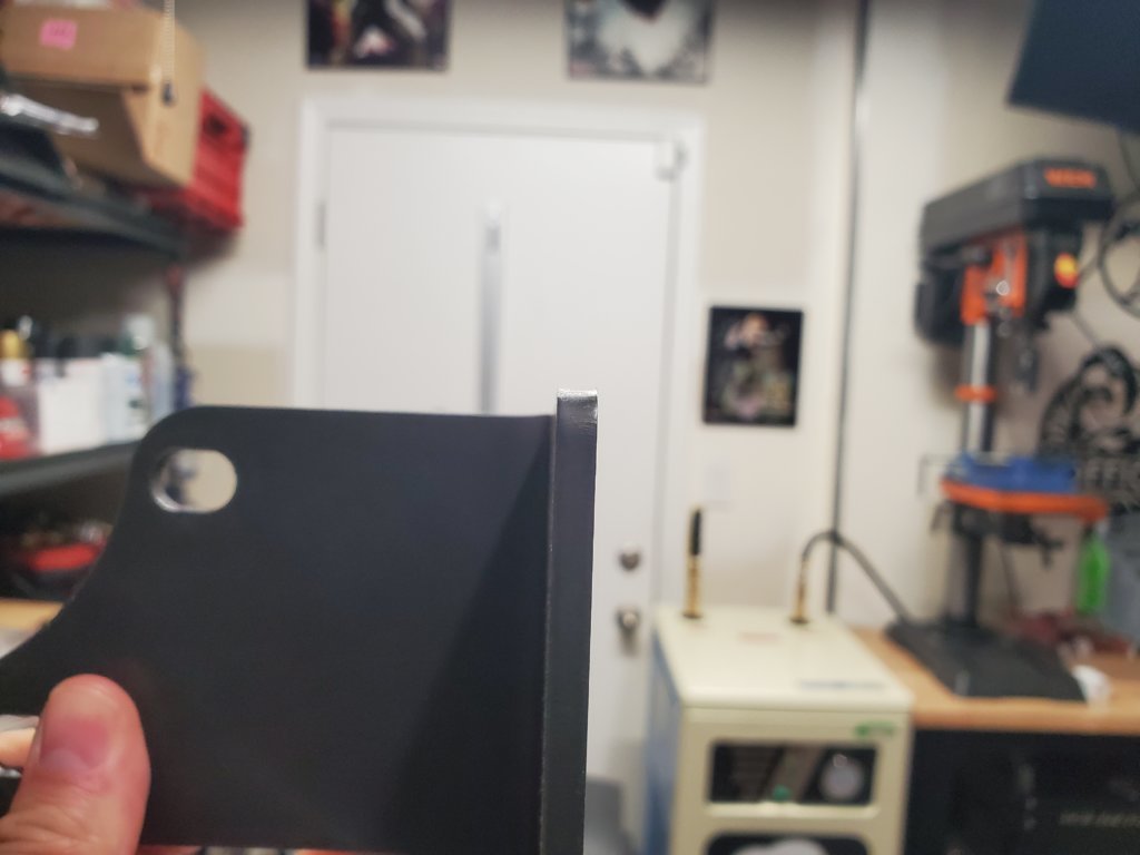

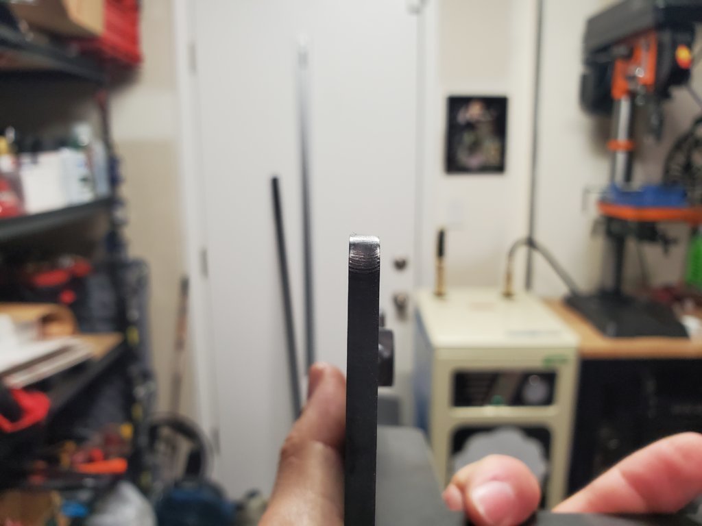

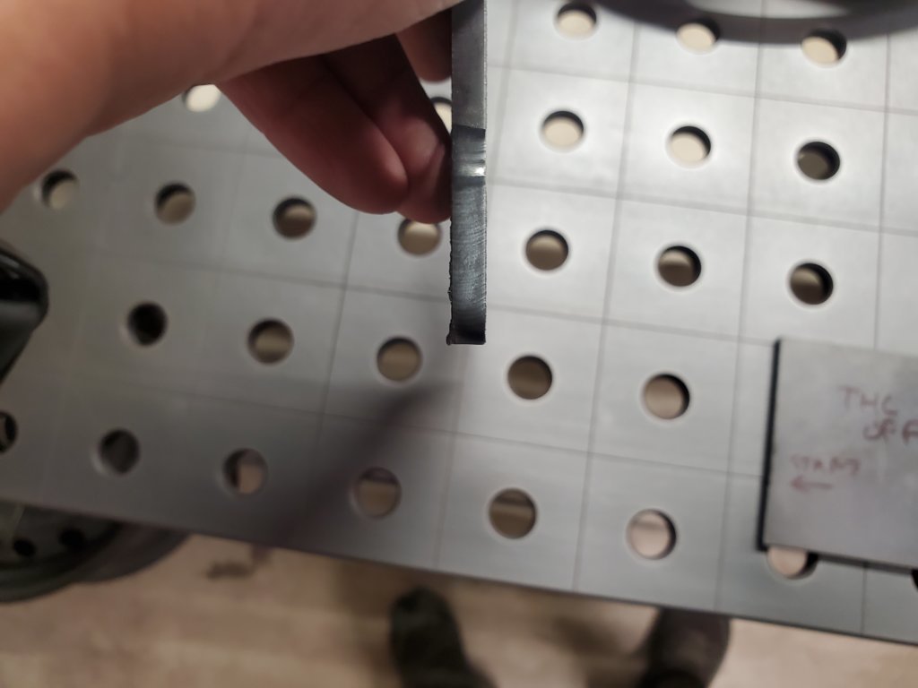

    Generally speaking, this -
    Again, not trying to simply dismiss questions or concerns shown especially since anyone offering suggestions has taken out of their day to help. But I'll use this as an example of expected bevel (and what occurs on a cheap plasma cutter) -
    The thing about Hypertherm though is that the output voltage is significantly higher which calls for a longer flame and less of a sudden "cone" as shown in the example.
    But cutting that same piece in my own quoted post, and using the Hypertherm, provides this along the entire top edge of this part or any other test I cut out -
    Yet provides the same square bottom -

    Yeah wow, that's a lot of bevel. And that diagram is super helpful! I always wondered how the torch made such a nice square cut (when it's working!) and now I get it.
    I was wondering if you had situation 2 in that diagram, where the torch head was tilted enough that your North side looked like shit, the South side looked perfect and the East and West sides looked 'nominal.' But that bevel looks like more than 2x the 'cone error,' or whatever that would be called. You would not need a level or a square to see something that out of whack!
    I know you're not really looking for help - I'm spitballing for my own sake as I imagine I'll be trying to figure this stuff out here shortly. It's helpful to think about the problem for my own learning.

    But let me add that those test cuts above were with torch height disabled; I have been disabling it for Hypertherm's requested test cuts, as well as the test cut files I received from my friend earlier, a Facebook acquaintance, as well as Langmuir - the test cuts performed all day yesterday and today were with THC off.
