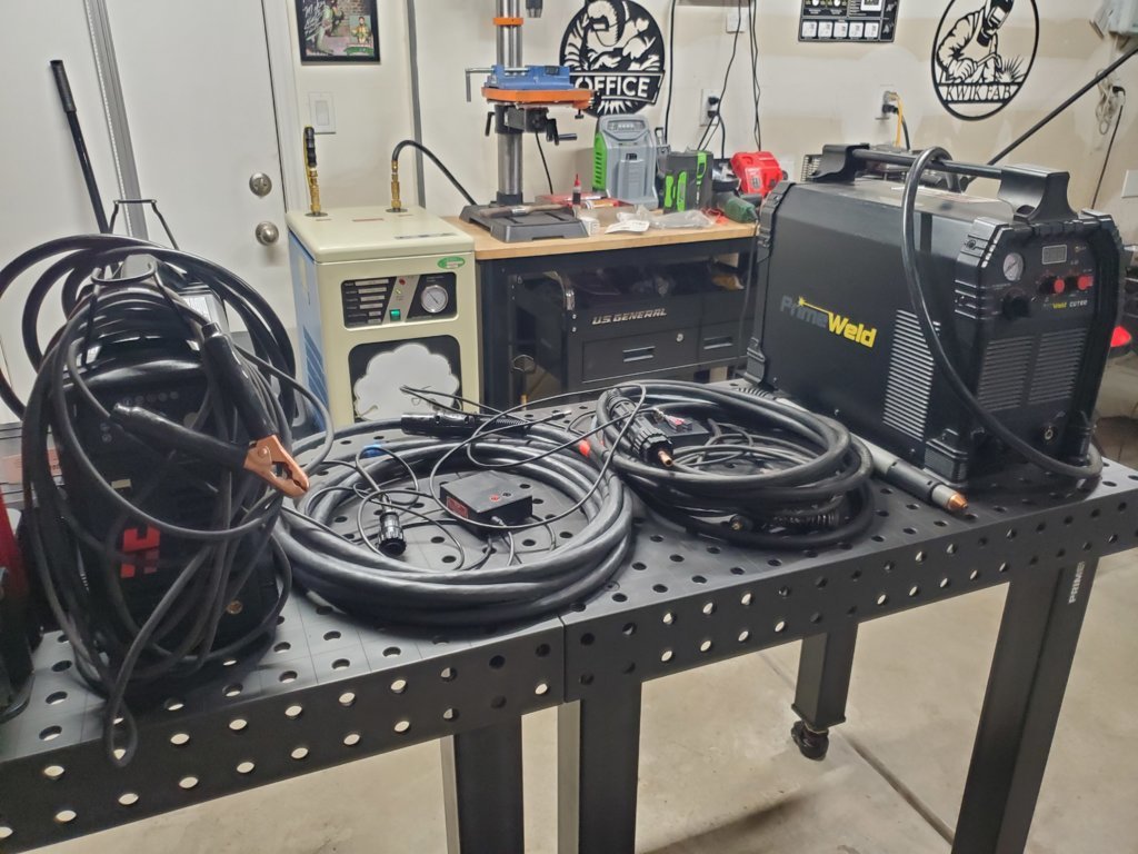

    M14 nuts arrived, so my second clamp holder is now attached
    Also said fuck depinning the hand torch, so I removed the Hypertherm entirely and I'm about to reinstall the PrimeWeld

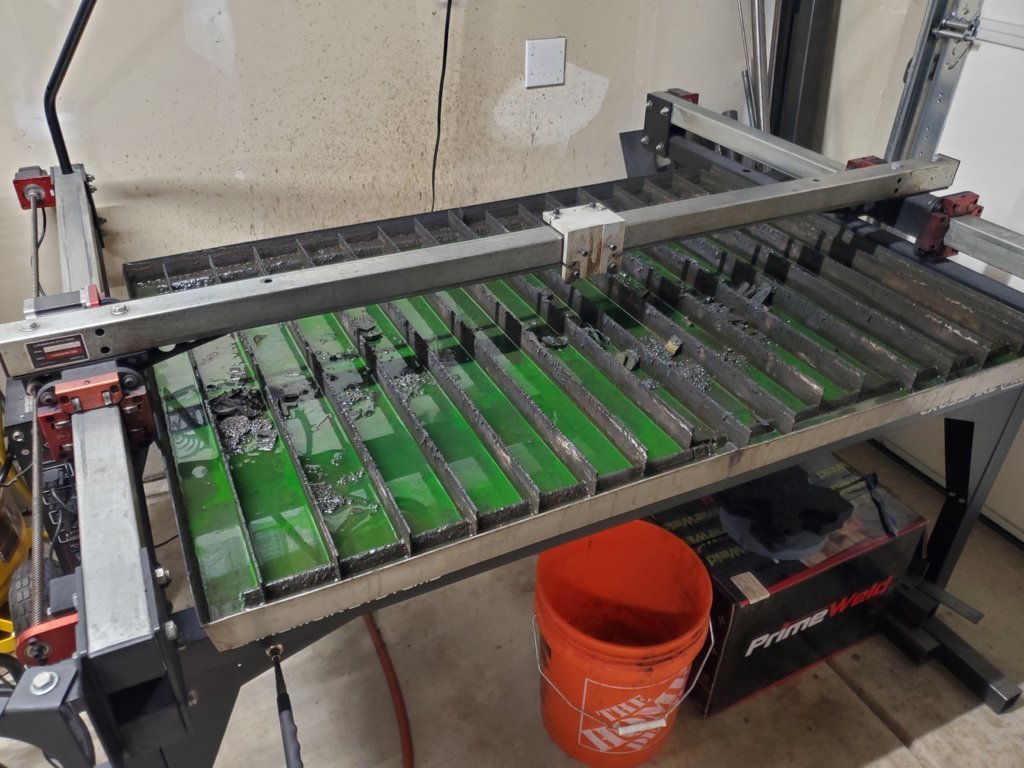

  5. Sep 20, 2024 at 12:20 PM
    Kwikvette
    Feb 27, 2019
    #284735
    82,840
    Fresno County
    4 run, 2 don't

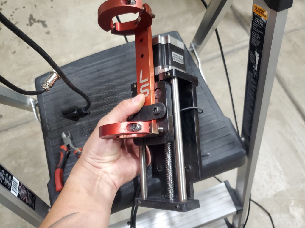

    Z axis and torch mount removed.
    Table unwired from any plasma cutter.
    Everything is benched for the while; hoping to start going over the table this weekend. If not the following weekend.

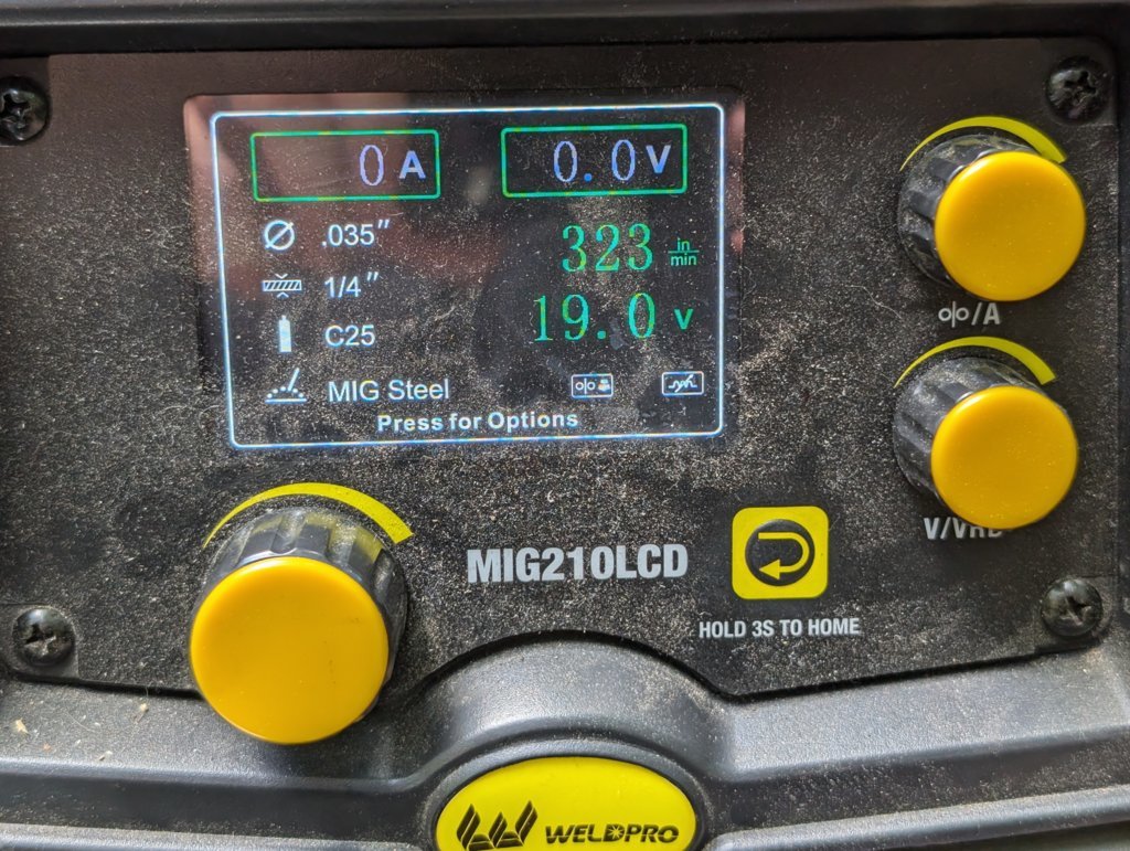

  6. Sep 20, 2024 at 5:51 PM
    soundman98
    soundman98 Well-Known Member
    May 31, 2021
    #367288
    6,359
    NW Indiana
    '18 Taco Sport, '14 Ranger
    what welder?
    a lot of guys say to turn down the heat(voltage), but i've found that turning up the wire speed tends to work better for me to keep similar weld penetration.
    on 1/4" plate, i'd be around 18-19v, and 300-325 on wire speed..
    also important, keep the tip as close to the weld as possible-- the further out the wire is from the tip, the higher the speed needs to be to compensate
    Drainbung and koditten like this.

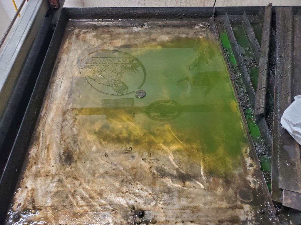

  8. Sep 21, 2024 at 10:25 AM
    Kwikvette
    Feb 27, 2019
    #284735
    82,840
    Fresno County
    4 run, 2 don't
    Removed the Y axis motors
    Now onto the hard part, cleaning out the water bed :bananadead:
    Mmmm metal soup
    Zebinator, Drainbung and 308savage like this.
  9. Sep 21, 2024 at 10:45 AM
    Sandman614
    Oct 26, 2010
    #45273
    36,065
    Tim
    Garner, NC/Boone, NC
    '06 SR5 Off Road
    Here's the 1/4" 035 preset
    Drainbung likes this.
  10. Sep 21, 2024 at 10:57 AM
    Kwikvette
    Feb 27, 2019
    #284735
    82,840
    Fresno County
    4 run, 2 don't
    Don't use presets, ever.

  11. Sep 21, 2024 at 11:06 AM
    Kwikvette
    Feb 27, 2019
    #284735
    82,840
    Fresno County
    4 run, 2 don't
    Half-way done
    Gotta run errands, then after we get back I've gotta see if I have the right bags so I can use my wet/dry shop vac to empty out the pan
    Then move onto the second half of the water bed
  12. Sep 21, 2024 at 11:32 AM
    Sandman614
    Oct 26, 2010
    #45273
    36,065
    Tim
    '06 SR5 Off Road
    Sure let me manually set it to what he said above. *turns knob

  14. Sep 21, 2024 at 11:41 AM
    Sandman614
    Oct 26, 2010
    #45273
    36,065
    Tim
    '06 SR5 Off Road
    Very informative. The preset on my machine (which I can infinitely tweak by turning the knobs) for 3/16" is 18v/280in. I've been bumping settings around and some welds are good and some are awful, likely due to my technique.
  15. Sep 21, 2024 at 11:55 AM
    Kwikvette
    Feb 27, 2019
    #284735
    82,840
    Fresno County
    4 run, 2 don't
    Welding always requires manual adjustment and fine tuning
    There are no perfect settings that work for every individual even on the same thickness material
    Torch speed, technique, etc are all contributing factors and even on the "correct" preset, one's technique can create weld defects
    allenfab, soundman98 and Drainbung like this.
  16. Sep 21, 2024 at 12:37 PM
    allenfab

  17. Sep 21, 2024 at 12:44 PM
    soundman98
    May 31, 2021
    #367288
    6,359
    NW Indiana
    the terminology still confuses me, when it deviates from the actual settings available on the welders...
    nah, presets are a great starting point. when everything starts going wrong, i return to the presets to reset myself all the time. most times, it's something i'm doing that's screwing something up. a big thing is that it's a consistent result. it might not be perfect for my use or my rhythm, but it's ideal for troubleshooting to understand where i deviated, and how those deviations effected the weld.
    in this case, i'd play with bumping up higher still to 330-350, or, if you can get the welder closer than you were running, get the tip half the distance as before, but maintain the same settings.
    308savage and spencermarkd like this.

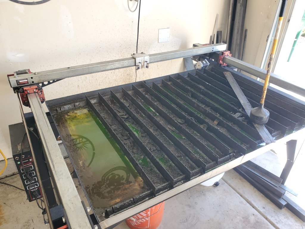

  20. Sep 21, 2024 at 2:13 PM
    Kwikvette
    Feb 27, 2019
    #284735
    82,840
    Fresno County
    4 run, 2 don't
    I'm old, my back hurts, so 3 hours of work is enough for me on any given day.
    Water bed is 98% done.
    I'll head out to Home Depot tomorrow morning for shop vac stuff and I'll finish cleaning out my water bed tomorrow.
    Thinking I'll have to pull it, but we'll see if there's any "wiggle" room once I start loosening the frame.
    I won't have to completely disassemble anything, more like loosen things up enough to ensure it is fully square again (if it was ever out of square).
    I'll be reaching out to Langmuir to see if they offer bearing blocks in small, mini-assemblies before I decide to tackle rebuilding the majority of them.
