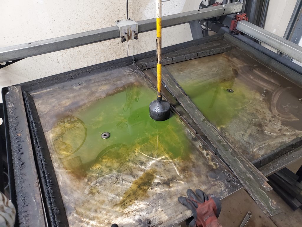

    I'm emptying it as if I'm doing routine maintenance (removing all the crud and drops in the waterbed) but also because I'm not going to remove a water bed with a ton of weight

    There's so much crud and build up that the build-up on the edges is so thick, the slats cut into it like a knife through a fudge brownie

    I’ve seen several different table setups where they drain and refill them. I wanted to do one in the beginning but it evaporates out of my table so fast in the summer it’s not worth it. Would make it easier to clean though. Mine just has a drain that I dump into several buckets

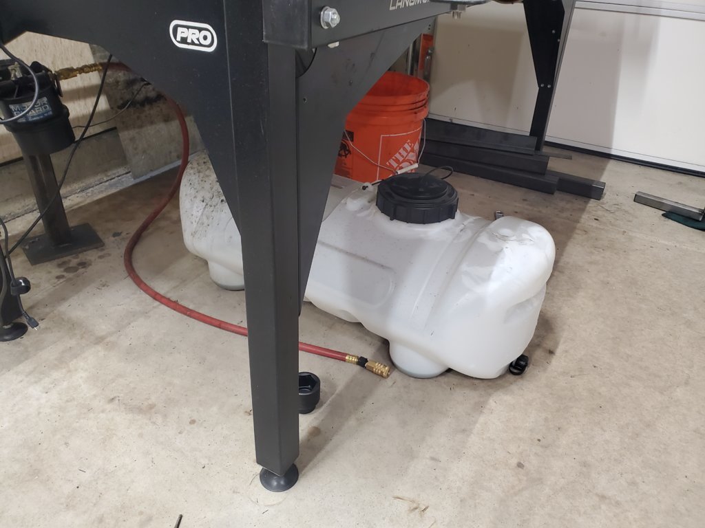

    I've got a reservoir sitting underneath the table that I've yet to plumb to the table.
    Really I never got to it because I didn't want to go through the hassle of draining the table, cleaning it out, and putting a new drain with pipe but now I feel like I can do that.
    That and I'll need to buy a pump to refill the table with from the reservoir.

    I welded in a bung in the bottom my water pan. Screwed in a garden hose valve. I attach a short length of garden hose to it and drain it on the lawn. Nothing toxic is present and the grass doesn't seem to mind the extra iron.
    I rinse the pan with the garden hose from the house.

    Here's my tank
    Meant to hold the contents of my table for a quick drain and fill, but I got right to cutting before I ever ran pipe to it
    Think it's 15 or 17 gallons?

    @Zebinator Since you're getting a table, you should consider getting a small system built up and worked out for a drain and refill.
    Some people just use pressurized air to refill their table from their under-the-table reservoir. I'll be using an electric pump.

    Yesterday I was simply using my magnet to pull big clumps of water soaked metal dust and crud
    Today, I ran my shop vac to get the remainder out
    It was disgustingly filthy and that was with only 10 months since the last thorough cleaning
    This stuff here was just the tiny bit I had left in the table last night, the bulk was far worse
    To prevent from such an undertaking, just drain your table every 4 months
    Clean up the crud on the table surface, then proceed to refill
    Your fluid will remain much cleaner for a lot longer

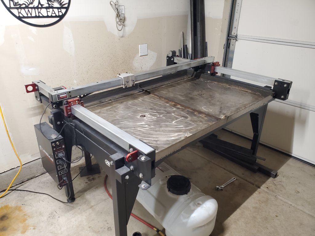

    Also, got the Y axis screws removed so now to pan the gantry
    Movement is absolutely fluid so that tells me it's nice and square....

    Well, after removing the axis screws and panning fully back and forth, she glides smoothly telling me it is square like I assumed
    So I scrubbed each tube and loosened up every bearing block as if I'm doing a new assembly
