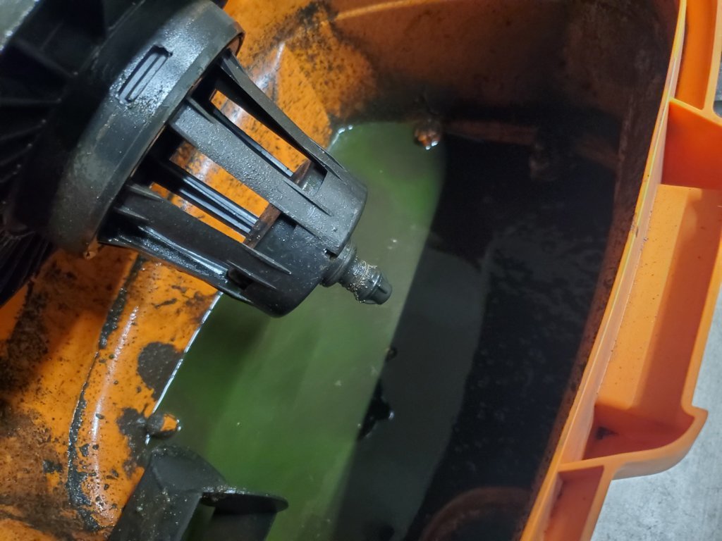

    It can’t be much worse than the gunk the cnc sump grows.
    I’m in my third attempt to complete the titan assembly - keep having to get missing parts sent out. “Some assembly required” got to a new level tho:

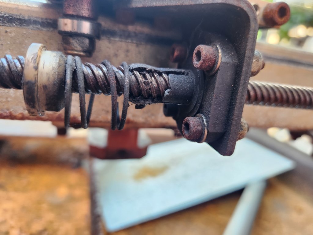

    Thanks for the tips. Much appreciated as I haven't mess with anything yet beside getting the machine to run on mach3 and test cuts.
    But my machine cut odd shapes holes and I took a look at my table earlier and saw the leadscrew spring loose on both axis. Not much pressure and it came apart. I think there maybe play in the screw and ordered 2 new ones and slats. Not sure if they just sell the plastic pieces. Didn't op to order the thc yet but that will be my next move once I get more run time.
    Once the parts get in hopefully I got the time to take it apart and install the XL kit at the same time.

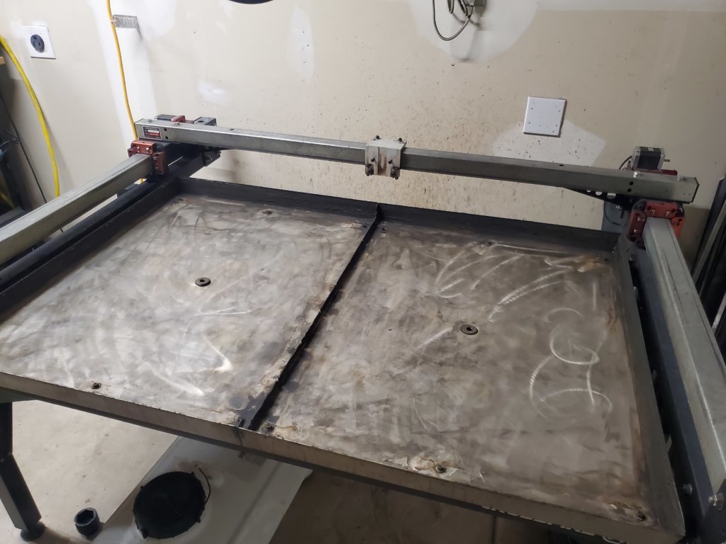

    My flanges arrive today along with the gaskets. I plan to drill holes and mount them in place and mock up for PVC in the next few days.
    On the plus side, I noticed my table out of square by almost 1/8" and have brought it to within less than 1/32" now.
    Not that my pieces ever cut out of square, but I'm looking at every possible opportunity to make sure my table is as perfect as I can get it.

    Since ensuring Y is square within 1/32", my X is now square even tighter than that
    Used 1" machined, magnetic shims to rest both sets of bearings and they're both equal
    Still need to go back and adjust the bearing blocks some more; I'm not exactly sure how "free rolling" it should be but it does roll a bit when I push it
    Could be a combination of tension on the bearing blocks along with dirty bearings

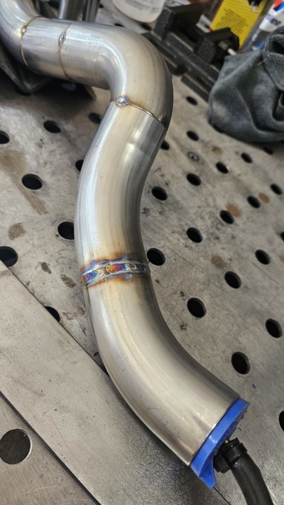

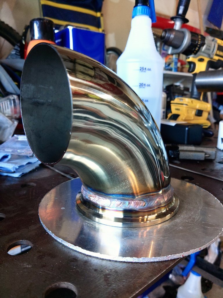

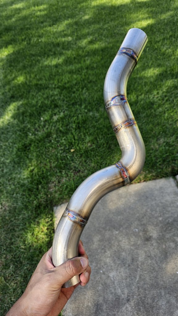

    Little bit of stainless practice before I weld up that header.

    Looks great!
    What color and size tungsten did you use? I'm going to be making a stainless snorkel in the near future. All I had to weld up my stainless exhaust was 3/32 red. I feel like it was too big for the relatively thin wall tubing. Ended up with a fat bead no matter what I tried.

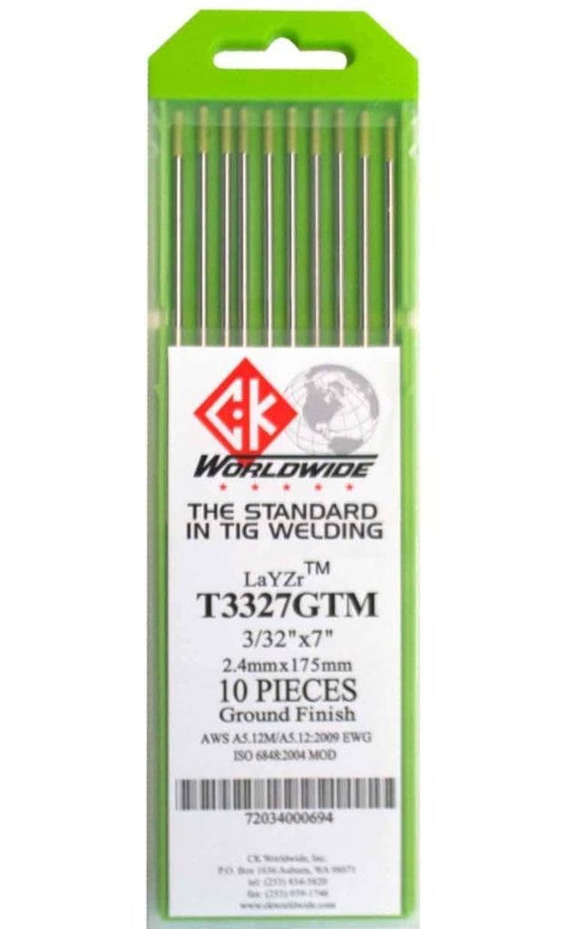

    Thanks man! I used 3/32 laYZr tungsten and .035 309L filler. Mfurik BBL cup.

    Thanks, I'll give them a shot. Only like two away from having all the colors of the tungsten rainbow at this point.

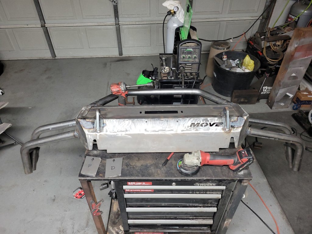

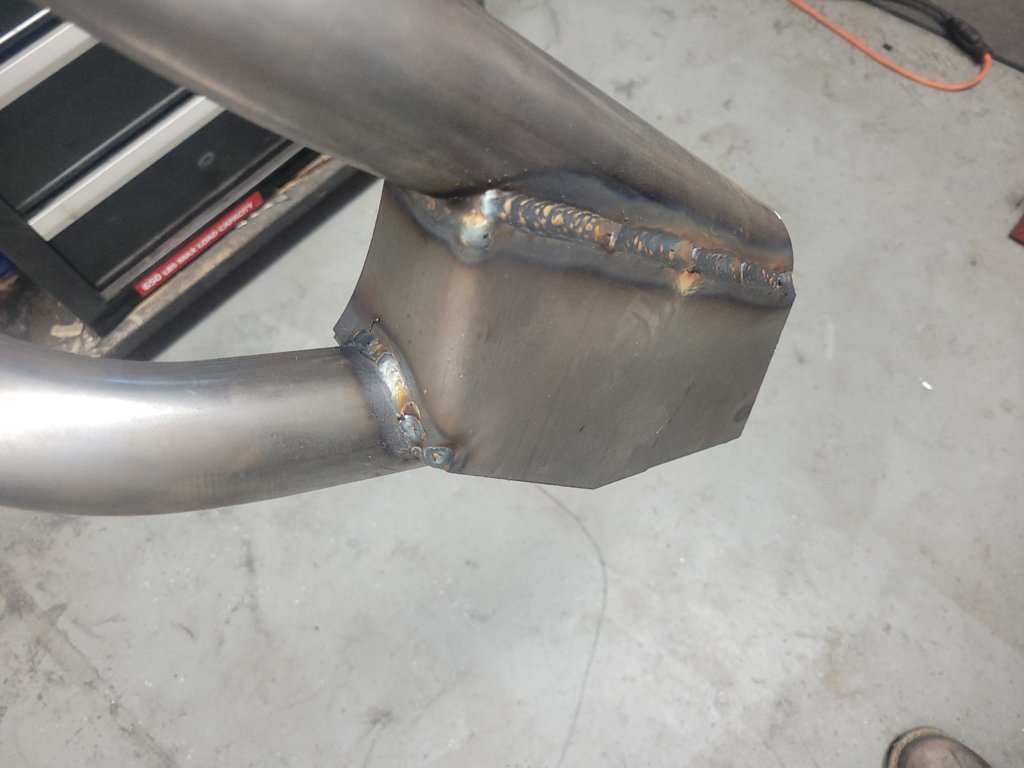

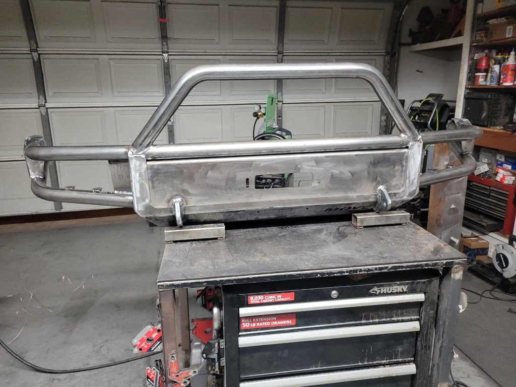

    More pics of the bumper build.
    20240922_172506.jpg 20240923_205516.jpg 20240924_163921.jpg 20240924_163915.jpg
    Aaaand... ready for paint. (Raptorliner)

    That's turning out pretty awesome. Good work!
