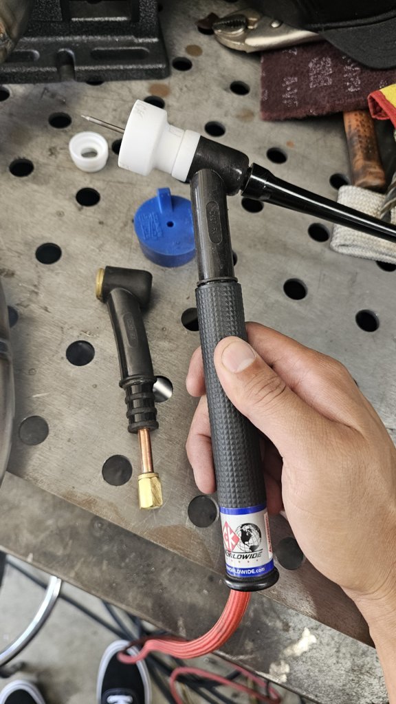

    Nothing like a freshie after one too many bends on the flex head!
    Pro tip (from experience) If you order 3 spares to keep on hand, it will make the current torch invincible, rendering the spares a waste of money and space.
    Pro tip #2 - move to the southeast and weld in an unconditioned space and you'll sweat enough to be your own coolant line.

    Hahaha luckily they had it on Amazon and it got delivered the next day. I'll order another to keep on hand for sure though lol. Think this one lasted 3 years so not too bad.
    I also tend to stay my ass inside when it's too hot out lol my garage has a insulation and I gotta keep the door closed when welding so it gets wayyyy too hot in there lol

    My first flex head lasted about 4 months. When I ordered the replacement, I got a few extras, assuming 4 months would be a repeat thing. Now I'm about in line with you. Going on about 3 years with the same torch, and some spares collecting dust.
    I also have the same tig lead as you. Absolutely love how light weight and flexible it is!

    Yeah definitely way lighter and way easier to move around. Noticed it big time when I switched over to the factory torch. Way heavier and a rigid head definitely didn't like it lol. Guess I'm spoiled now

    Have to remember, only flex the head when it's warmed up from welding
    Flexing/bending the head while cold could fuck it up

    I'm telling you, with these spares in the toolbox it's like the opposite of Murphy's law. I could put the head in the freezer for a day, take it out and tie it in a knot and it wouldn't break.

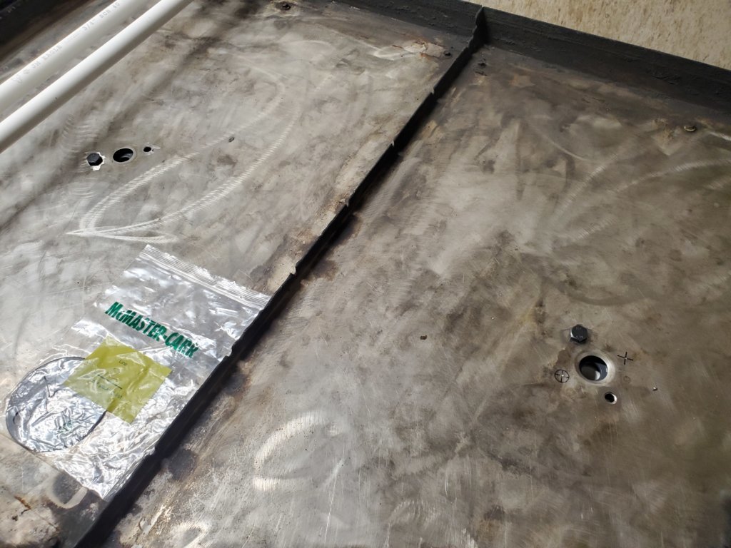

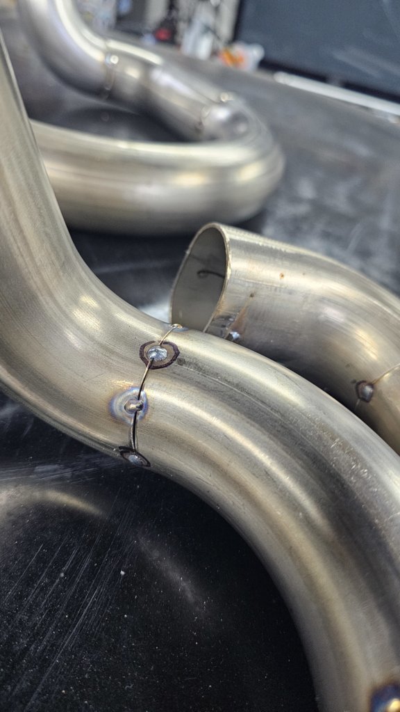

    Retacked the runners, now to grind down all the mig tacks my buddy made.

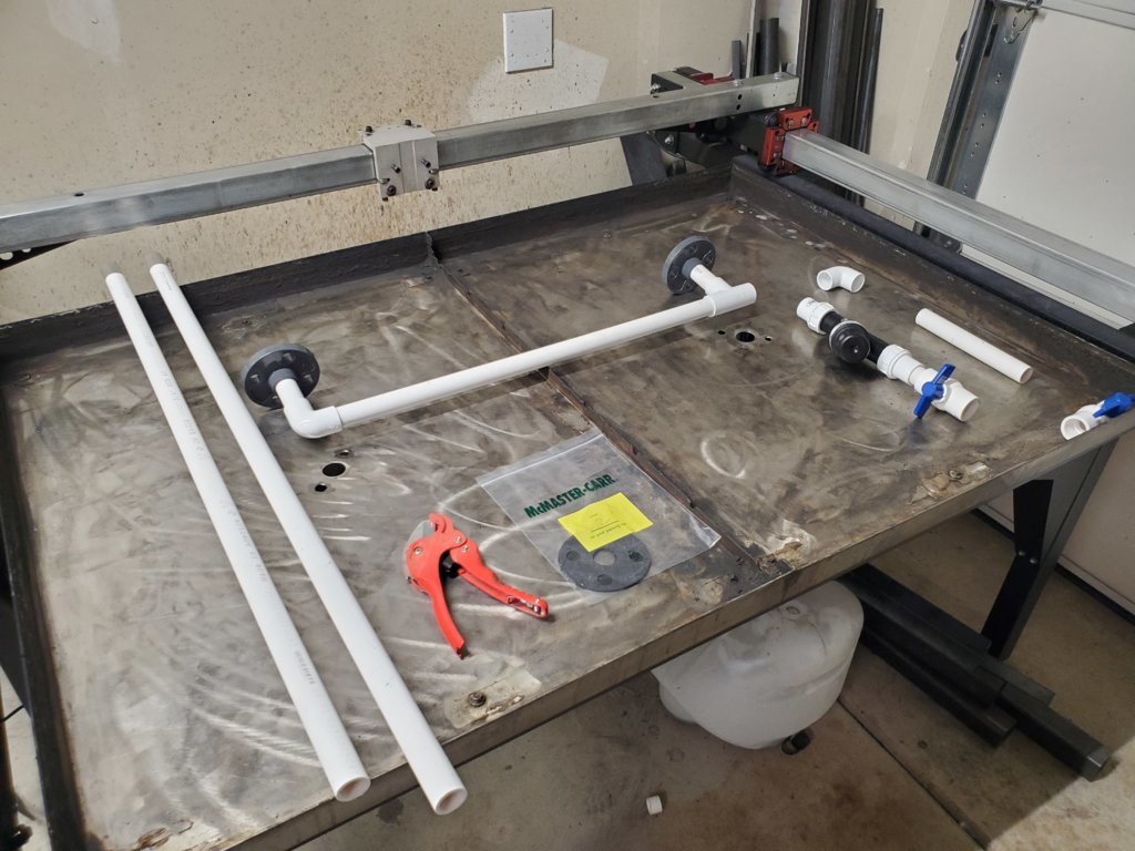

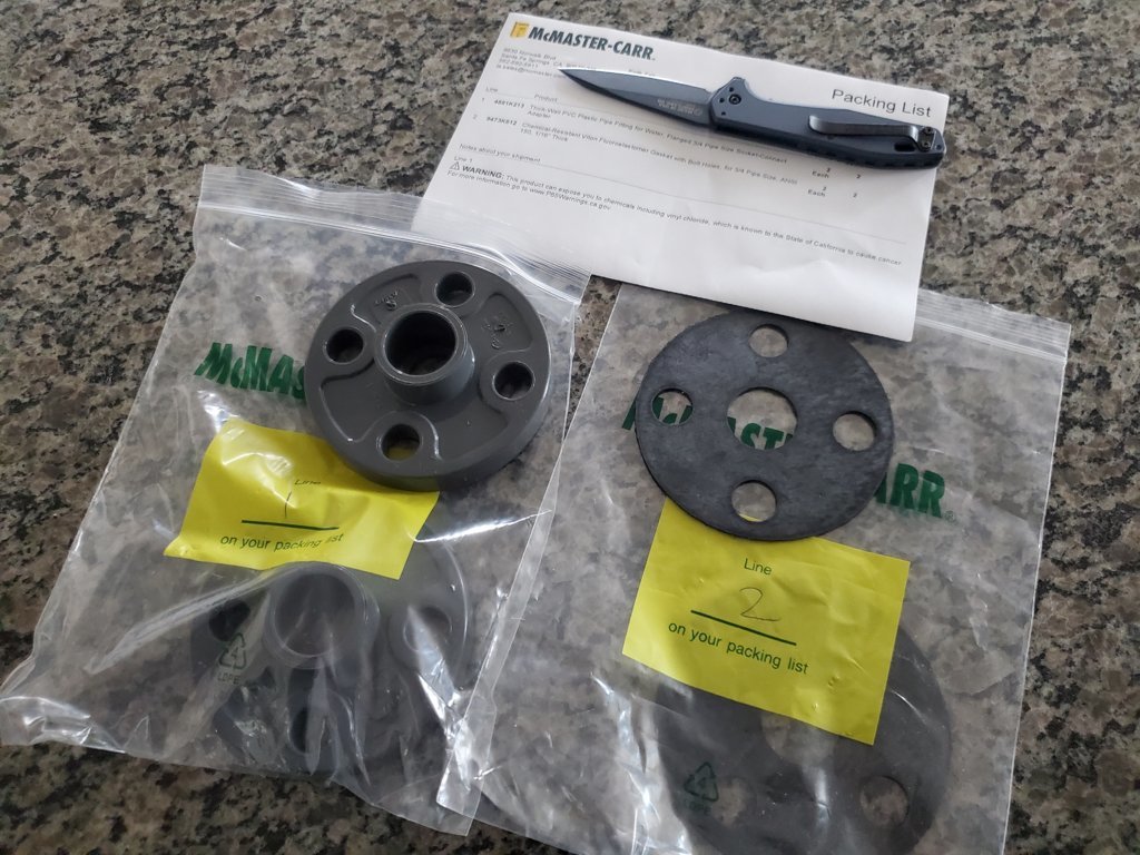

    @Pyrotech
    Few goodies arrived, not to mention a quick trip to Home Depot
    I need to buy a T and maybe 2 more fittings
    Got plenty of PVC left though
    That and decide how I will run my means of transferring fluid from the reservoir to the bed
    If the cap on my tank uses an NPT fitting, I can simply use that to connect to a pump, haven't tested the threads though

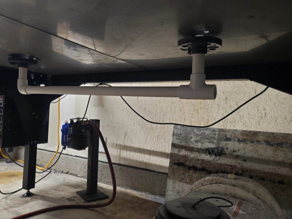

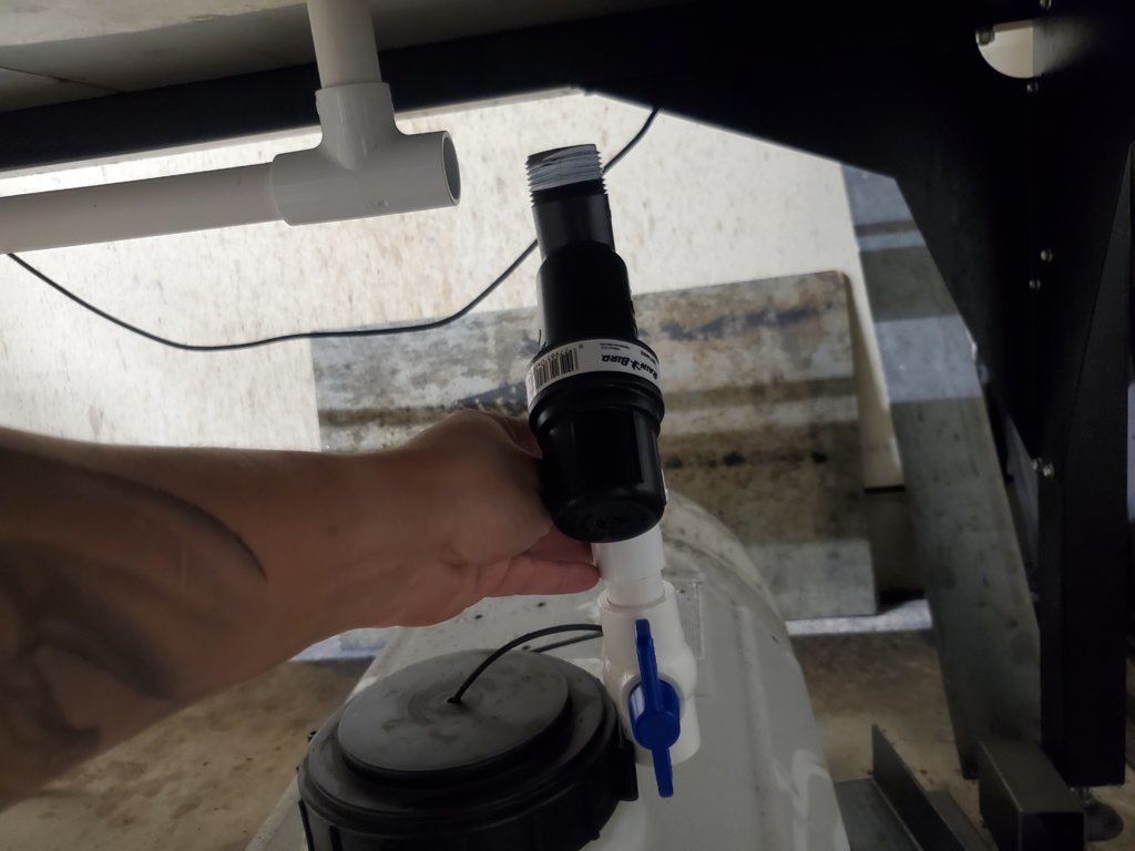

    So this is just a mock up, but I've got some stainless steel bolts along with bonded washers that'll attach the flanges to the table like so
    This is how it'll look underneath; thinking I'll shorten the straight pieces a bit to bring them up higher
    Ignore my filter stand in the back corner; that's maybe +3 years old and was used for something else
    The drain will dump into the tank through the lid, but I may just opt for a different solution due to the height of the setup versus the length of the filter
    This will be the feed line, that'll utilize the same pipe as the drain for a means of refilling
    If this drain is an NPT fitting, it'll be perfect for attaching a line to and running to a transfer pump that'll connect to the refill line

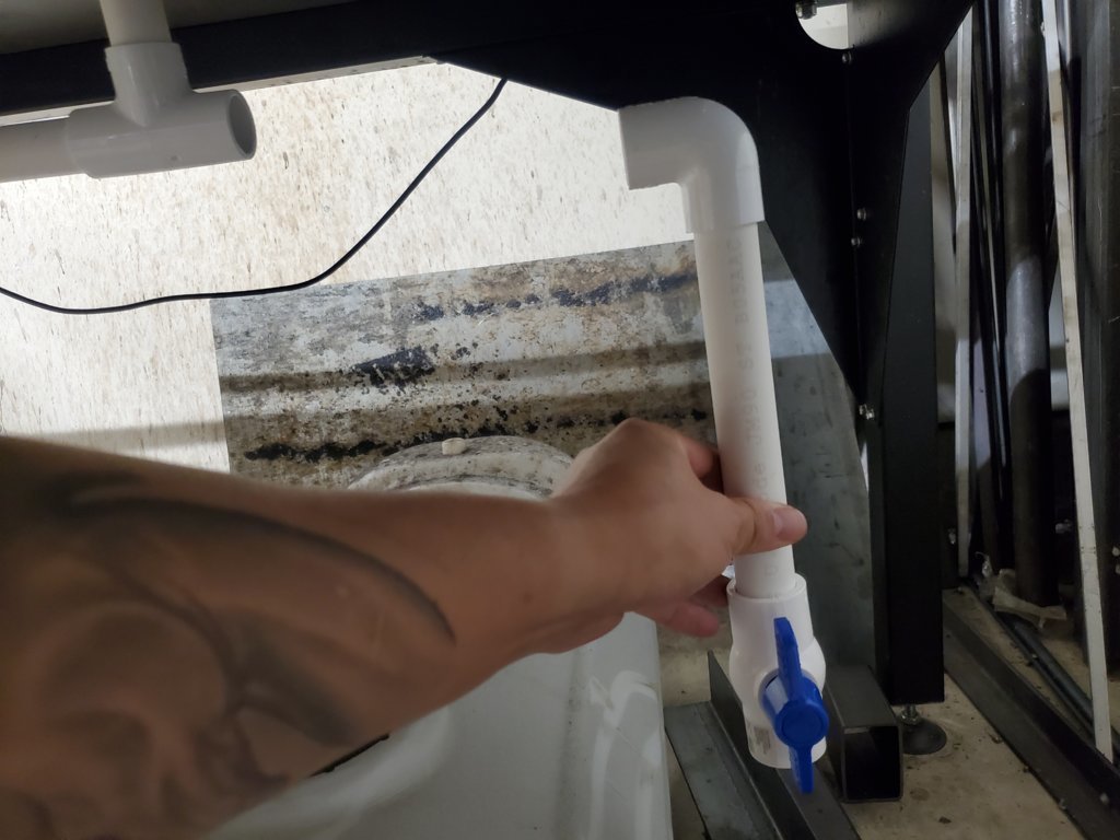

    @soundman98
    I just realized my mock up photo is backwards lol the ball valve is indeed supposed to sit above the filter
    It's how I mocked it up while at Home Depot - reason being so I can stop the flow if I need to pull off the filter so ignore the picture
    soundman98 likes this.

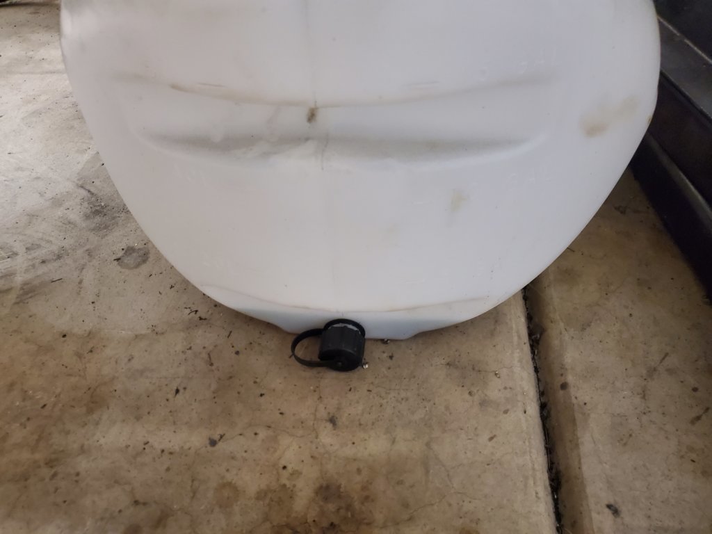

    #284735
    81,827
    Fresno County
    4 run, 2 don't
    Meant to go like this
    I have a 110v transfer tank (small one) in my cart and wondering if I should just use a soft line (barbed end) to make it easier to run a line
    Would be nice to mount said pump on the flat surface of the reservoir
