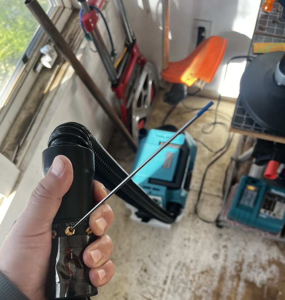

    Simple question - do you guys cut your fill rods before welding? I assume so, since yielding a 3 foot long rod seems uncontrollable. How short do you cut them? And, why do they come 3 feet long?

    Even at work, I kept them full length. They're really lignt and make no difference as long as you have a good grip when feeding.
    Practice feeding techniques with uncooked spaghetti strands.
    Just make sure to wipe them down before you use them (the filler rod that is).

    for gunsmithing, it'll be rare that you have to make a long weld that consumes a lot of filler, so cutting them down does make sense to give you a bit more control. over time you'll get the feel for how much filler a given weld will consume, and therefore how short to trim it. until then, just practice and see how long you're comfortable with. unless starting and stopping a weld that should be one continuous bead occurs, there really is no wrong answer.

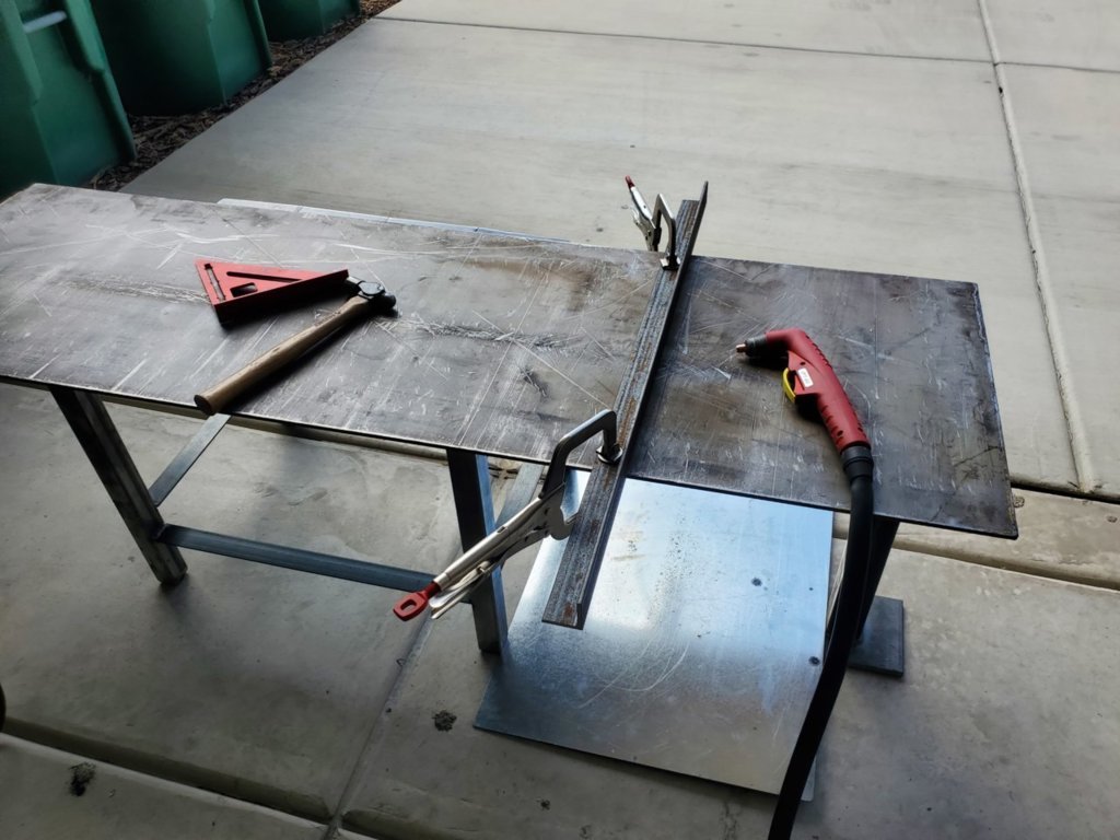

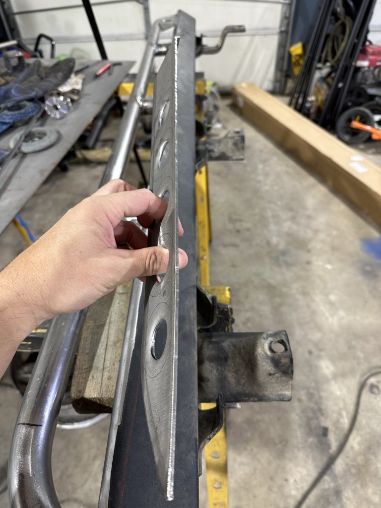

    Hand plasma question for us plebs without a table, how do you evenly clean up serration marks from inconsistent movement with the torch on long planes? Like my curves I can clean on my benchtop belt sander but a long straight is harder to clean up.

    It should cut really clean, worst case is you get some dross on the underside but it normally flicks off with your finger or you can use a chipping hammer to scrape it off.
    The thicker the steel, the less dross you should get.

    Top and bottom is not the issue, the edge is.

    I try to clamp a straight edge and clean with a flap disc

    That's a good idea, I tried to clean one up with the flap and saw some variance which totally negated the straight cut. Straight edge is smart.

    Edge should be the cleanest; look for any "lines"
    This will tell you if you're moving too fast or too slow; was trying to look through old pics and this is the "closest" pics I can find
    3/16" all cut with a hand torch
    These are farther away, but 1/4" that ended up really clean

    I kept snagging on the guide I was using which is what caused the lines because i was essentially using two guides and I think I had them too close together.
    I wonder if I didn't use the drag guide I could have gotten smoother parts. Dross has been a non issue really usually.

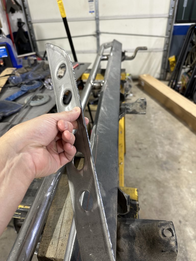

    The minor imperfections from snagging.

    Yeah see, they're clean as hell
    But it's "catching', hence the imperfections otherwise it's good to go
    You're using the stand-off you said along with what else? I've just always used angle iron as my straight edge and go from there
    I don't even use the stand-off

    i usually just cut a healthy 1/8-1/4" in front of the finish piece, using a 1/8" piece of flat stock and use a 36-60 grit flap disc to bring the edge to finish-quality. that also allows me to make a smooth radiused edge..
    i've also found dragging the gun towards myself instead of pushing it also offers a smoother edge.
