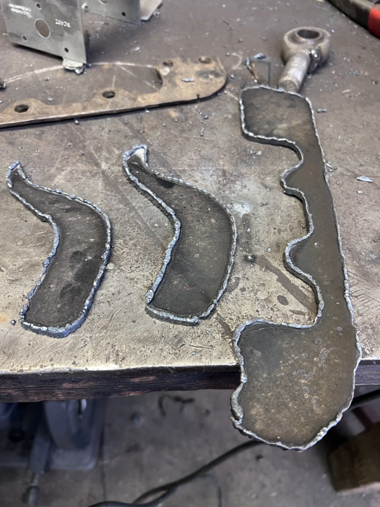

    Plasma cutting advice needed. I picked up the Cut-50 on Prime day for $99.99 as it's been in my cart forever. First time cutting with it, 1/8" steel, air at 30psi, amps at 30 then 35. I didn't know which way to adjust and the machine didn't come with any instructions. After looking at some charts my air was ok but amps should have been lower (20 amps). Does this sound about right? I just unboxed it and started cutting. I'll take advise here and play with it more after I know which direction to go. Thanks all.
  3. Oct 14, 2024 at 9:57 AM
    Kwikvette
    Feb 27, 2019
    #284735
    81,815
    Fresno County
    4 run, 2 don't
    Well, that's the thing about plasma cutting.
    You kind of have to practice a bit to find out the right travel speed as well as amp setting.
    Bottom dross usually means moving too slow, but one thing that stands out right away is your air pressure.
    You want about 80-100psi going into the thing, and maybe some 55-65psi on the plasma cutter's regulator itself.

    copy, way too low psi. i will adjust air pressures, retry moving faster and practice. I'm going to run out of scrap metal before this is done. lol
