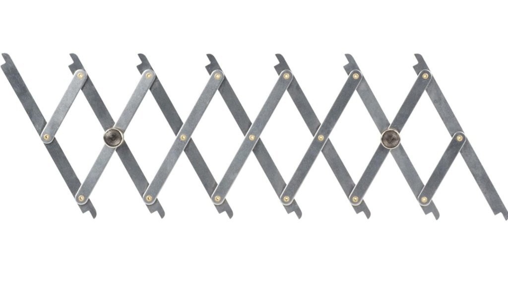

    I just use a ruler but some people find these useful for stitch welds.
    And depending on the direction you go, you can move it over to mark your "tack" for each length of weld.

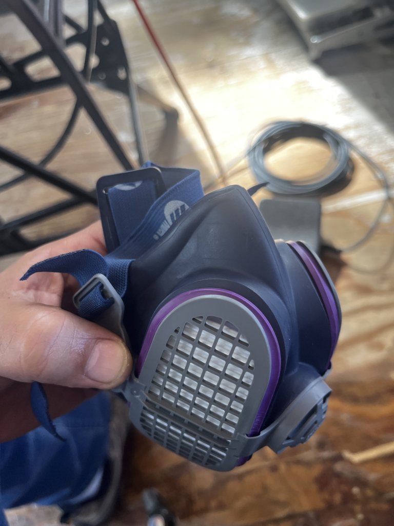

    Decided today was the day. Very nice Miller breathing apparatus. Good stuff.

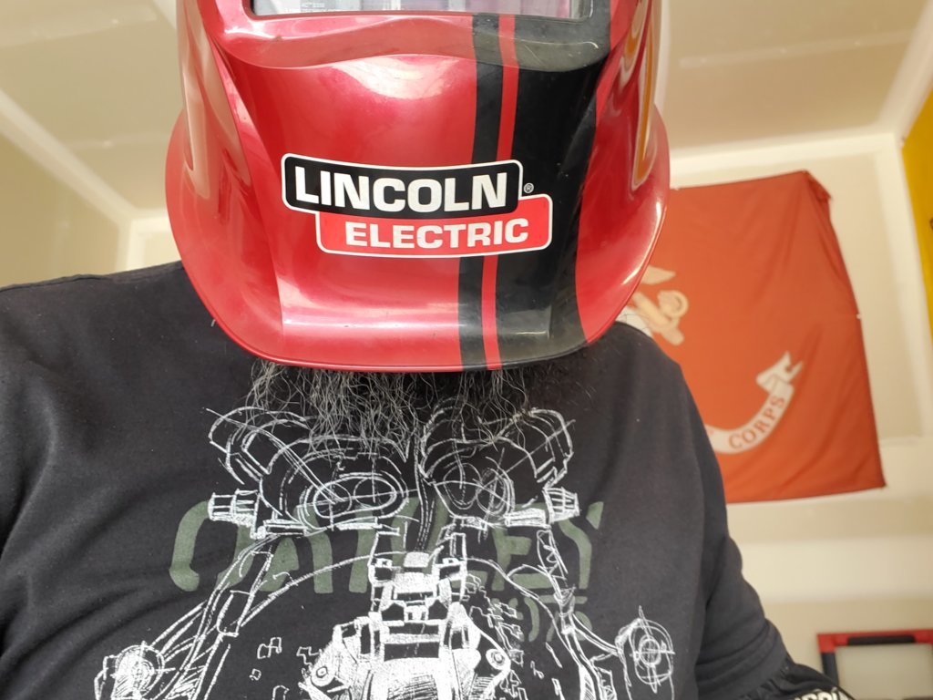

    That one is great, just sucks if you have facial hair
    My beard extends passed my welding hood :anonymous:

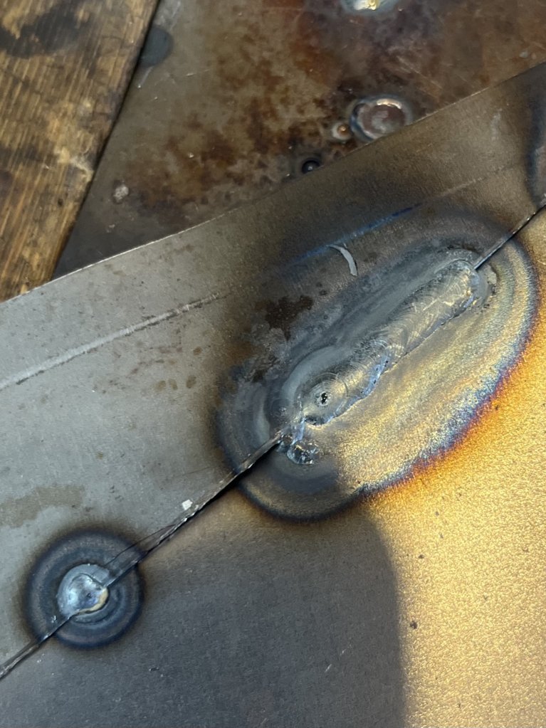

    True true, but I just tightened up the bottom straps and it ain’t so bad now.
    Learning the CK Worldwide MT200. I’ll just say the first CK arc was bliss. Very nice stability.
    22g and dipped .045 just to be on the safe side as I didn’t want to blow through while learning how to use this machine. Bad practice in my book.

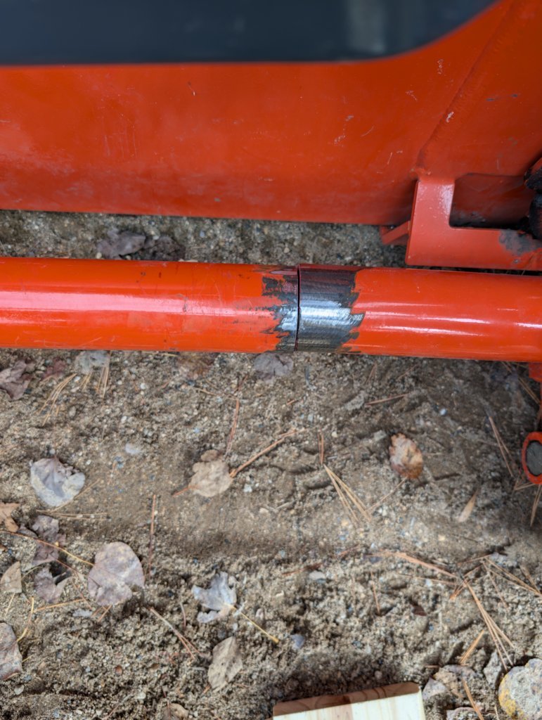

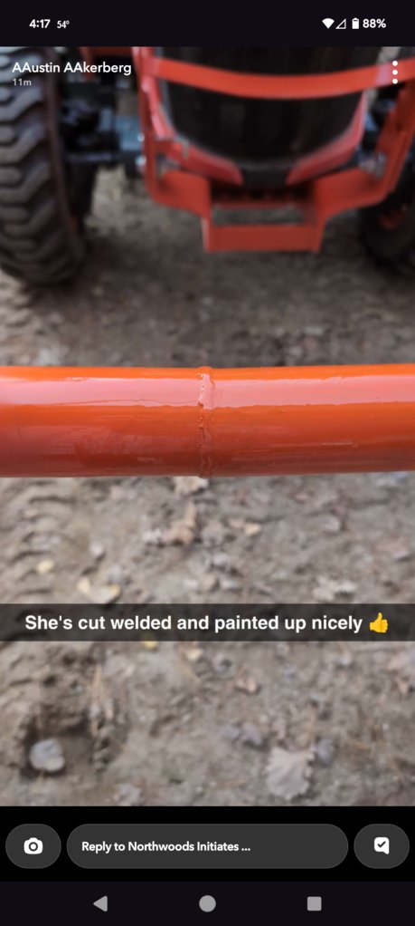

    Would like to thank everyone again on the guidance for the primeweld welder. Spend the past few days getting her set up, practicing voltage and feed speeds, getting comfortable with it before tackling the tractor.
    Had to cut the torque bar and re-align the plates, which threw the bar about an inch out of alignment. We threw it onto a chain tied around a stump and pulled it back nearly perfect which is the first pic. Welded her up and covered it up with paint! Pretty happy with it, now looking for other excuses to use a welder besides practicing beads on mild steel!

    No worries, just a helpful tip maybe, or not
    When blue prints called for say, 3" centers on 2" beads, out comes the ruler and sharpie
    But those help to mark where you want your beads and keeps them evenly spaced (for aesthetic reasons while still providing strength)

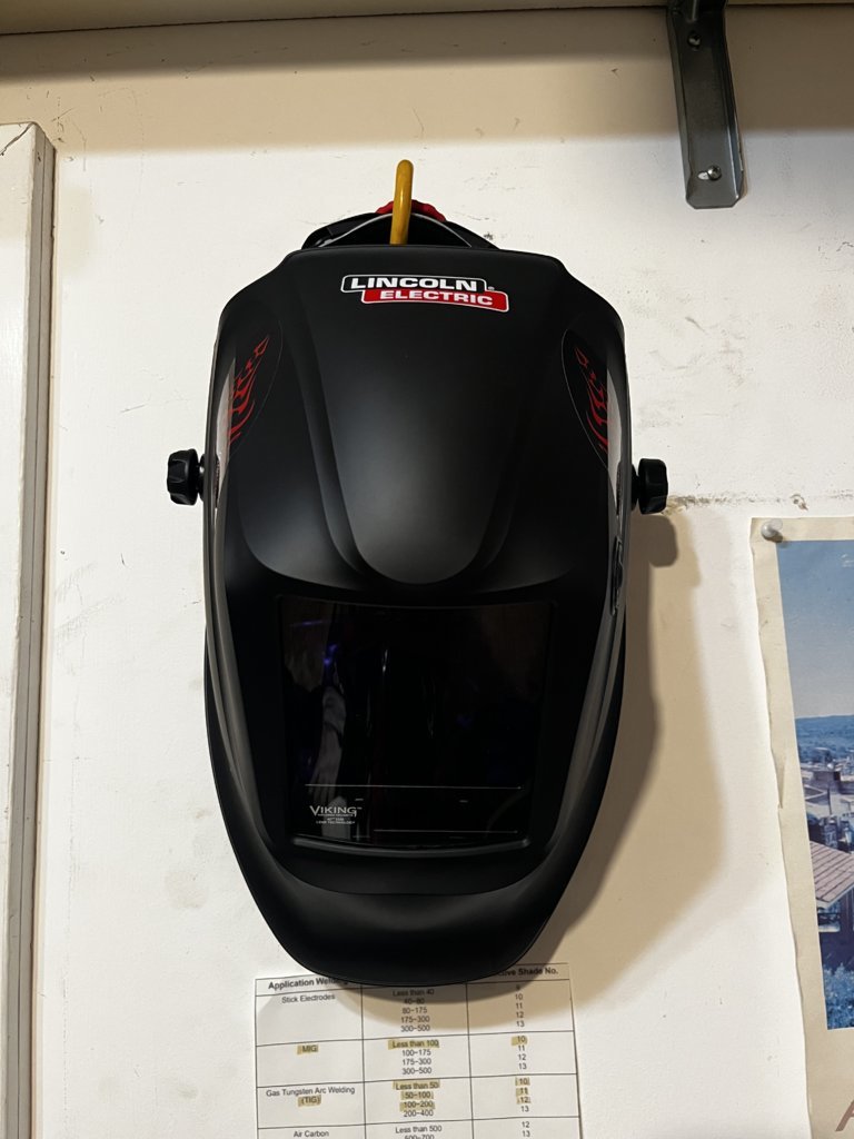

    Alls I can say is WOW. The 4C technology is bad ass. So feliz I picked up the 3350. Good Stuff from Lincoln Electric. Can’t wait for the Husky sticker to arrive.

    Welcome to having a nice hood :rofl:

    Hard to beat the Ultra Shades for their days technology, so na bra, not my first good hood. Unfortunately Miller dropped the ball!
    Miller, ala F1, should go poach some of Lincoln Electrics personnel from the lense department :D

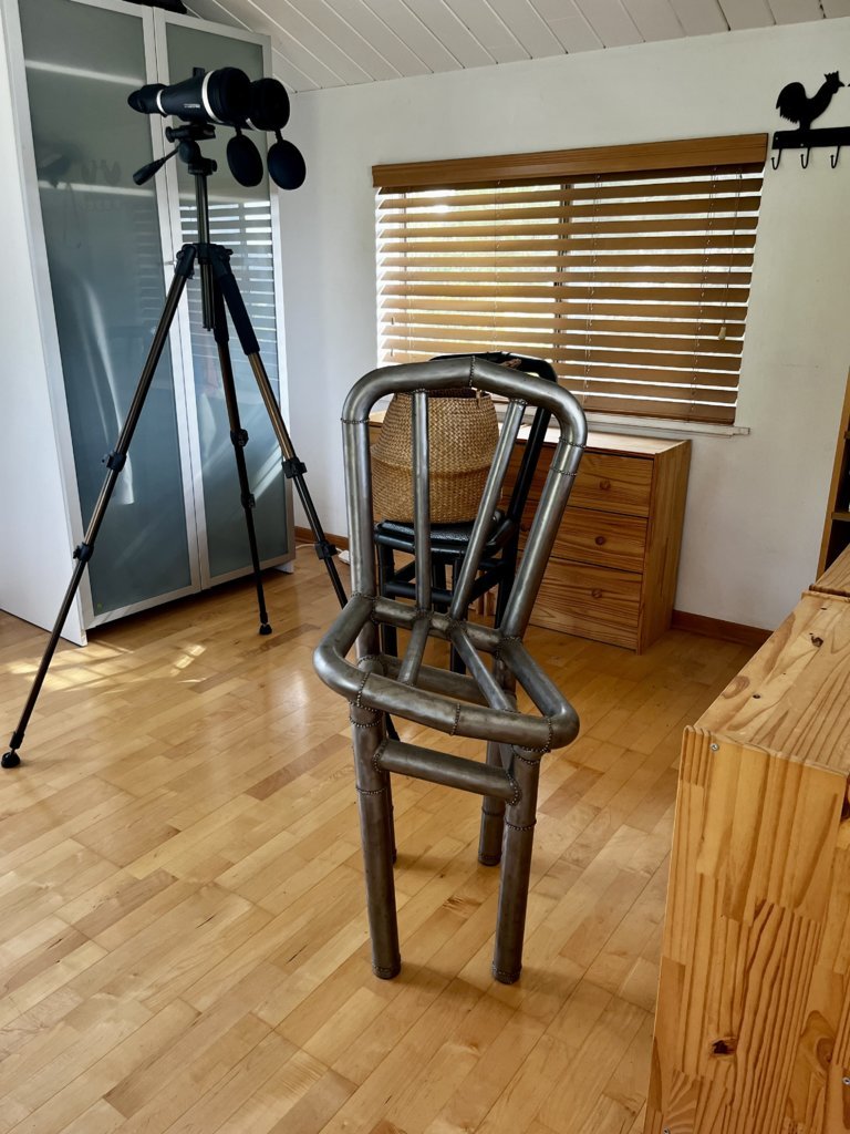

    First thing I ever built from scratch having just learned how to weld so many moons ago. Kicker, I used flux core :welder:
