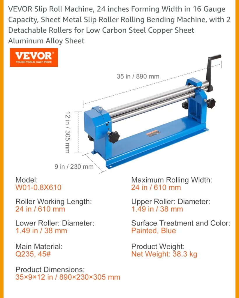

    I'm not a professional fabricator. I do this for fun so I cant justify spending a lot of money on it . Would something like this be a waste of money at $224
    https://a.co/d/0o6XZFT

    For what purpose?

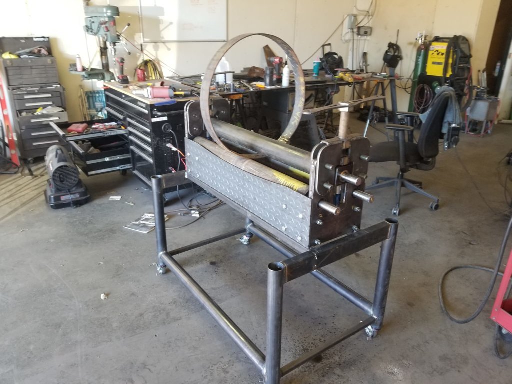

    You're better off getting some plans and making your own, making adjustments as you see fit.
    Here's one that a member of my CNC group made using an Etsy file set.
    Fortunately plans are cheap - the real cost would be your source for the plate and rod used.

    You are not gonna roll a piece of stainless to patch that exhaust. It's a bubble with tight radius. You are better with a piece of 22ga low carbon steel, beat with a plastic hammer on a shot bag.
    It doesn't take many hits for stainless to get work hardened.
    You can tig weld carbon steel to stainless using 312 rod.

    I bet it can be done using stainless with a small “wooden dowel,” (same size as that area) and a whole lotta patience. The patch is not that large. Perhaps a part of a tube cut with a grinder can accomplish the radius(?)

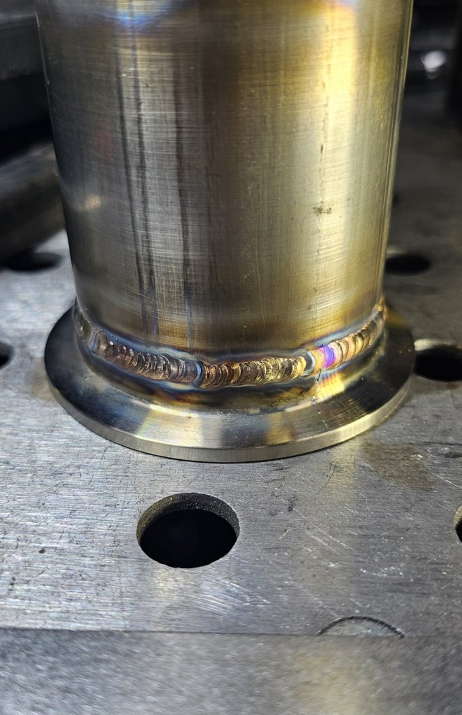

    First time tig welding stainless vbands. Turned out decent.

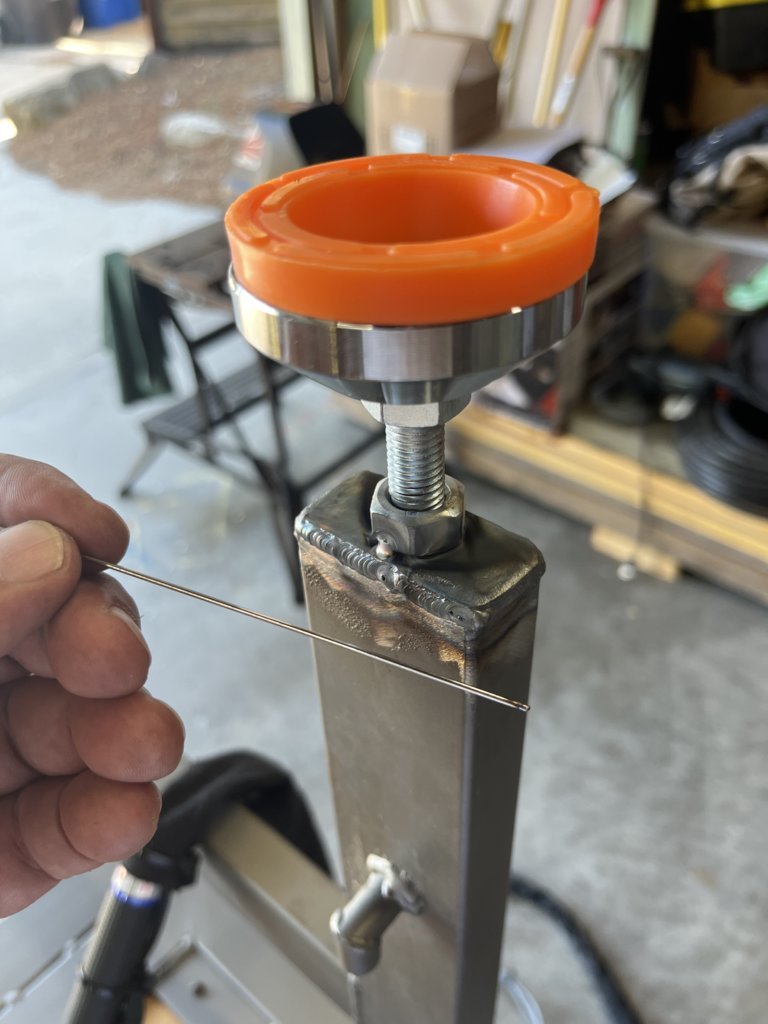

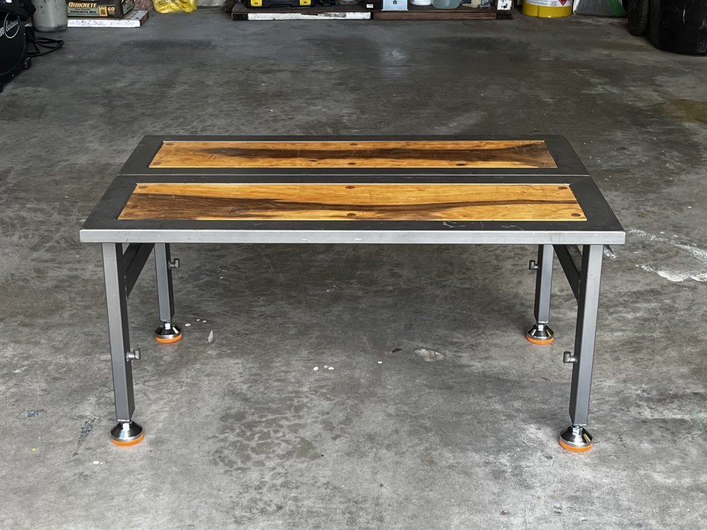

    TIG Friday! :yes:
    Old table I’m resurrecting. 309 to the rescue for dissimilar metals FTW.

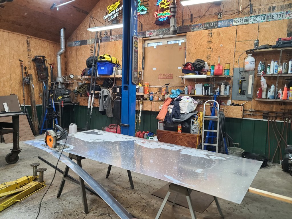

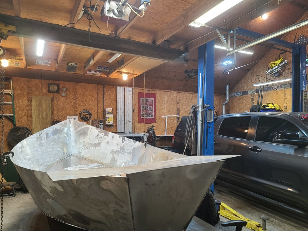

    Reserected from the dead.
    My Friday MIG project.

    That build is cool. I bet the fun times peg is maxed or broken :hattip:
    I have found a very nice pattern to weave while MIG welding. I can’t wait to try it again. Good stuff fellas.

    You are correct!
    The only issue is running 15 foot of weld kicks your ass. Doing it 4 times drives you in the dirt!
    Aluminum MIG welding is 100% duty cycle. You run until the spool gun empties or you empty.
    My back is killing me tonight, but the worse part is over. It's small welds from now on.

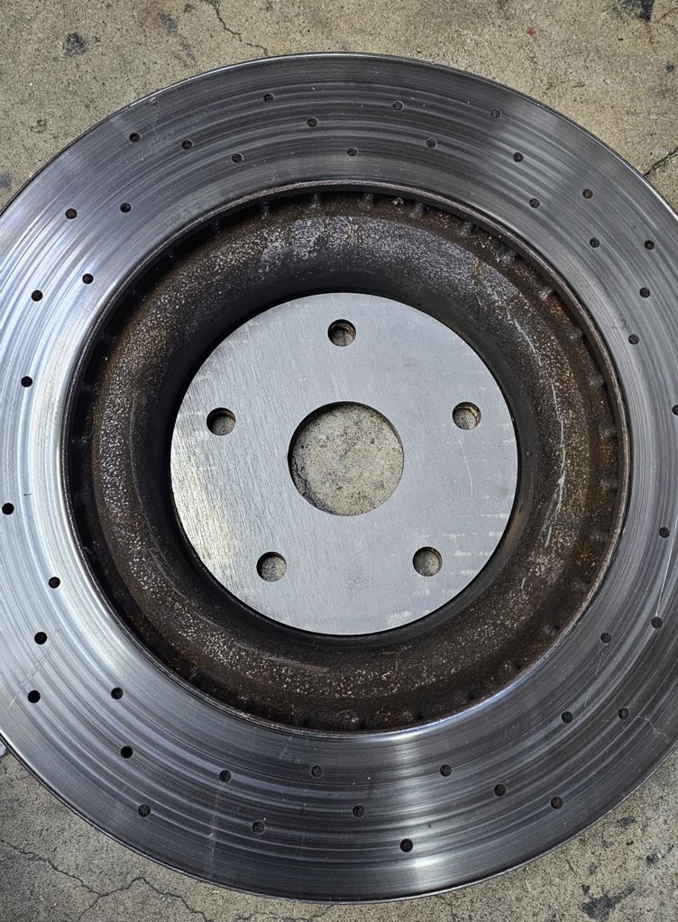

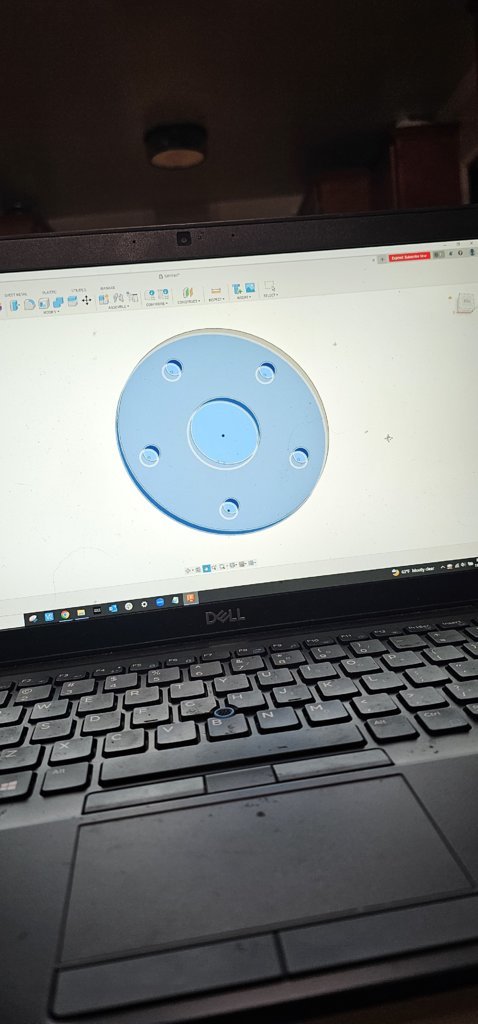

    The start of an arm rest project I'm making for one of my best friends who is a tattoo artist. Wanted it to be able to be disassembled so I made this base that I'll bolt to the rotor using lug nuts. Building the rest off of this starting point. Repurposing the rotors off my old STI as the base.
