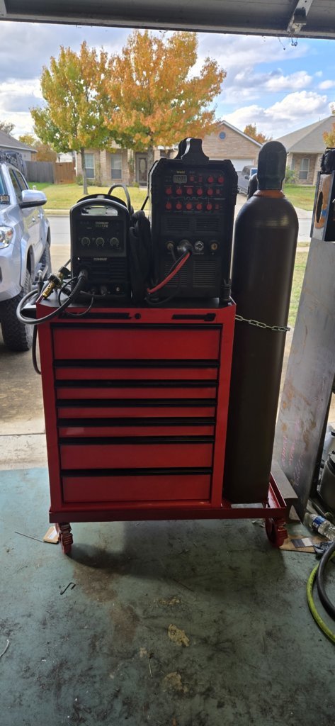

    I welded up the base frame for the tool chest today.
    I used the tool chest as a jig to get everything tacked together,
    Swivel casters with locks on all 4 corners. I am hoping tomorrow I can paint the base, and get this sitting upright on the casters. I still need to cut the top bottle bracket, and figure out something for cable management

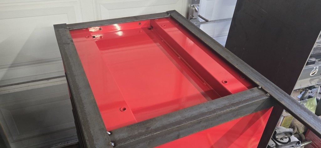

    Frame base is painted.
    I am pretty happy how it turned out, I may not even cut the bottle bracket like I had originally planned, I may just use the chains like I have it now. I still need to fill in the tray where the bottles sit, the current design allows for a bit more rocking then I want to see.
    I am going to rob the the cable racks off of the old Vulcan carts and add them to this, they worked fairly well, an all I will need to do is add some nutserts to bolt them up to the tool chest.

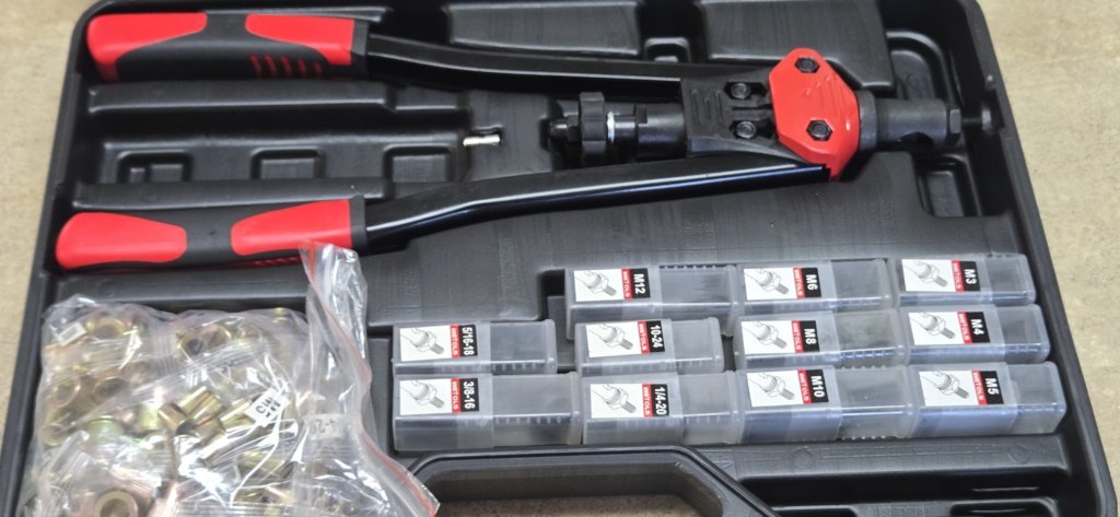

    I picked up a new tool to help finish building the welding tool cart.
    It came with a decent selection of anvils for it, an a small starter selection of rivnuts to go with it.

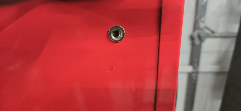

    M6 Rivnuts where installed, I was a bit concerned that they would hit the drawers when closed, but it worked out that the location I used cleared the drawers.
    First of two sets that will get installed,
    going to be a good thing this is on 4 swivel castors.

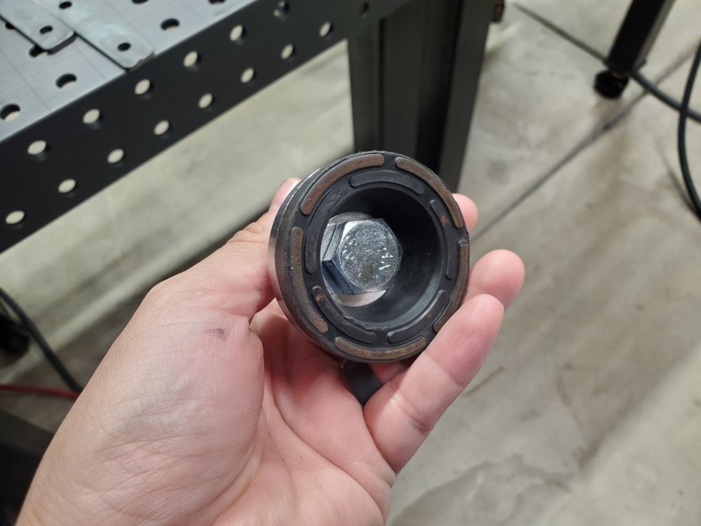

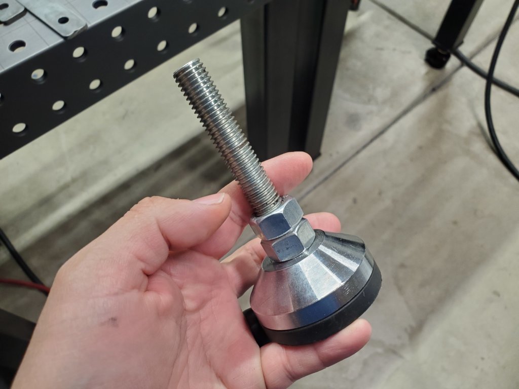

    PrimeWeld fixture tables.
    Got pretty hooked up but even at retail they're worth it.
    I have leveling casters on each leg but they come with beefy, adjustable feet at no extra cost. Casters are $25/ea?

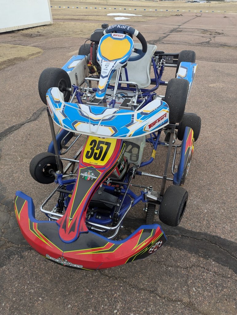

    I finally finished my kart stand. Normally people have trouble carrying karts in all but the largest trucks. My 5' Tacoma bed can now carry 2 and be loaded with 1 person.

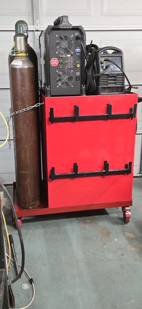

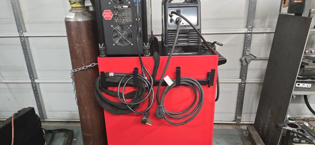

    The second cable rack has been added.
    When I went to cut a piece of steel for the tank floor, I noticed what I planned on using was going to be too narrow due to a previous cutout, So I decided to use part of the old welding cart.
    I was able to save the decal, that should create some confusion to those who see it later and do not know the details of the cart.
    I ran out of rivet nuts before I could get the bottom safety chains added, but the cart is useable as is.
