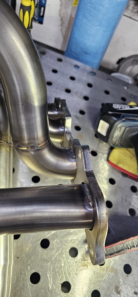

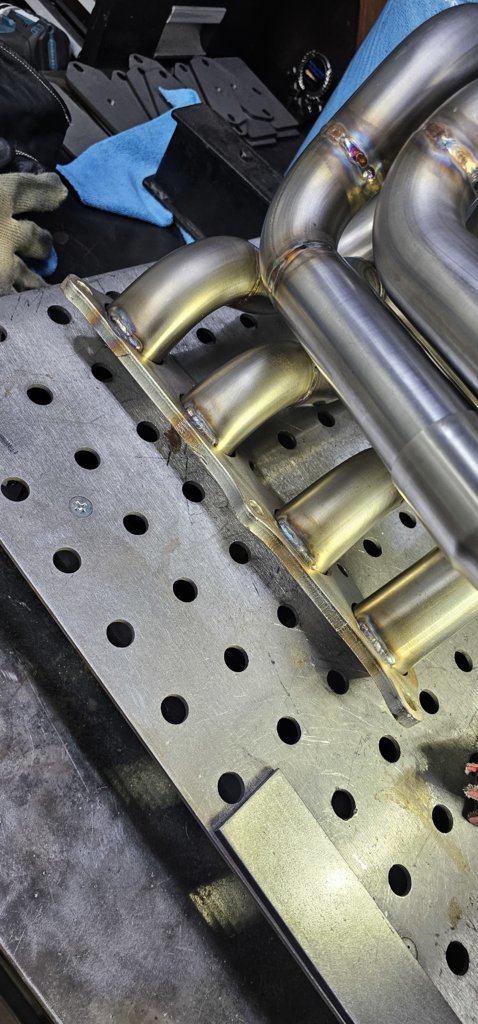

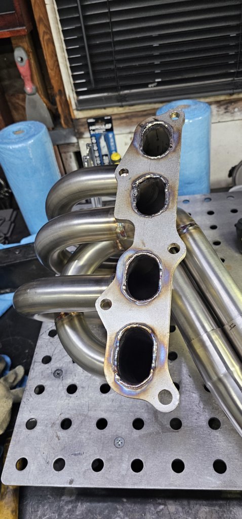

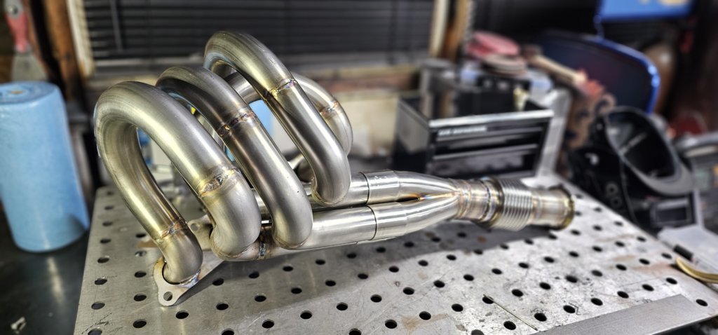

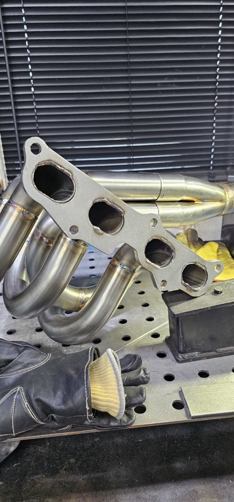

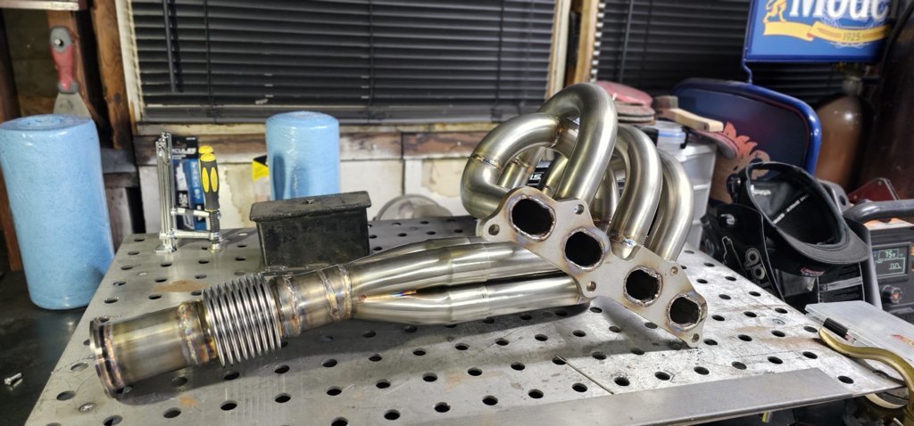

    Well the header is done minutes the spring retainers on the collector. Had to shape the runners to the head flange, which was a pain in the ass, So I could weld them from the inside. My buddy is gonna clean up the flange and welds when he gets it back. I'll weld on the retainers when he gets back into town so he can pick where he wants them placed.

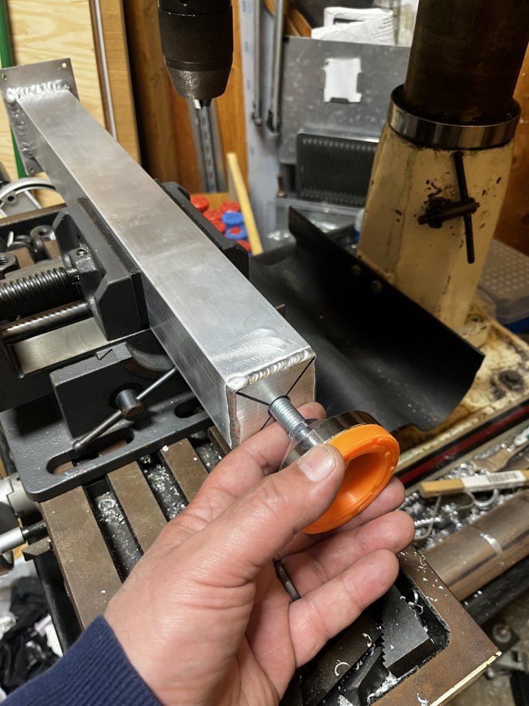

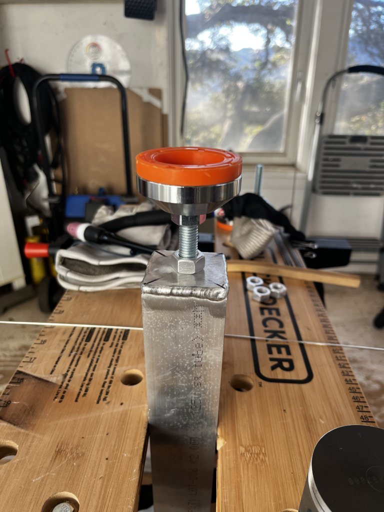

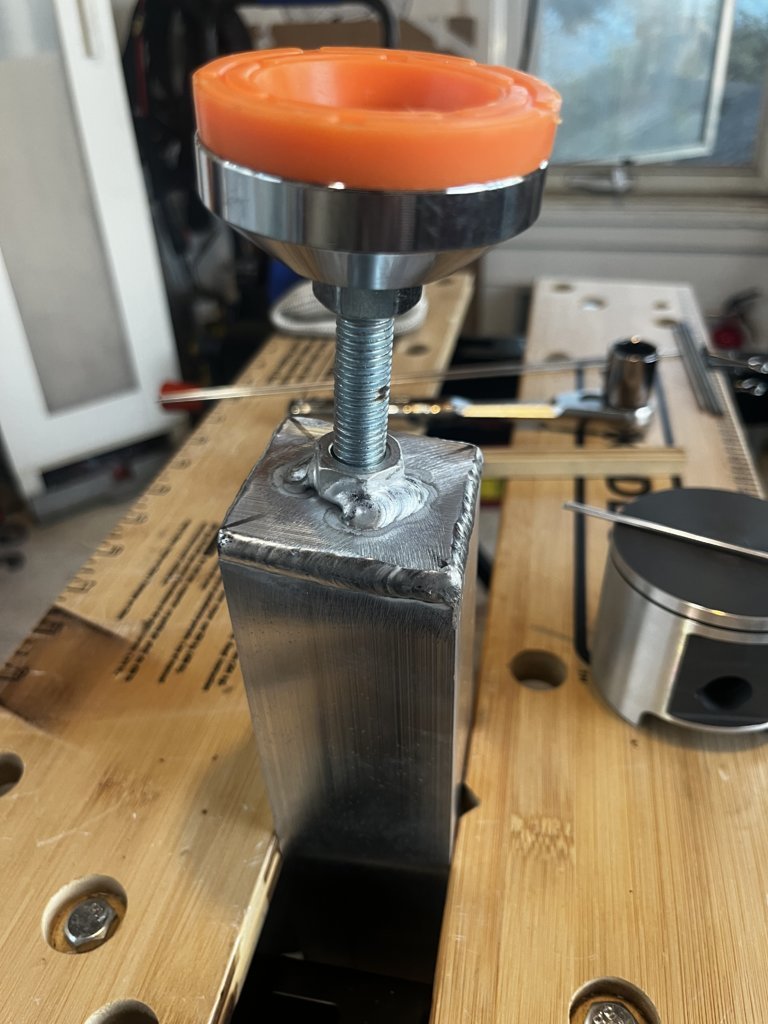

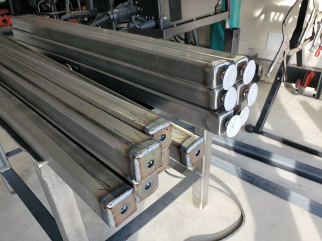

    I've been known to weld the nut to the plate before welding the plate to the tube, so I can hide the nut.

    Just gotta be sure of your welds.
    That nut breaks the welds, you got a mess to deal with.

    edit: At the same time, if you're using a nut on the outside to 'lock' the foot, you've kinda got it covered.

    Pic from a few years ago, but I've totally welded nuts on the inside and they're still holding strong now.
    There's hardware made specifically for welding and it's what I use for adjustable feet/casters.

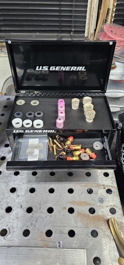

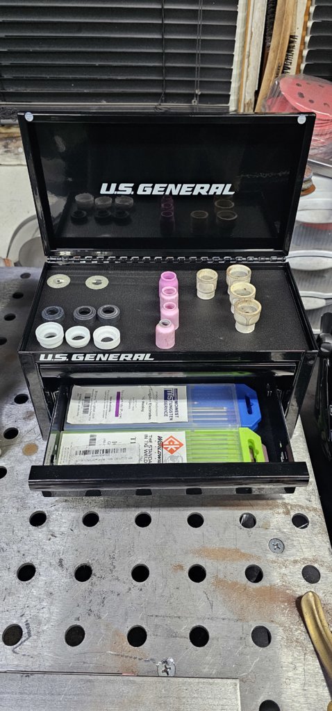

    My brother bought me one of the mini harbor freight tool boxes. My local stores haven't gotten them since they've come out but one near him had them in stock. Been wanting one to put my tig consumables in. Gonna leave it on top of the fixture table.
