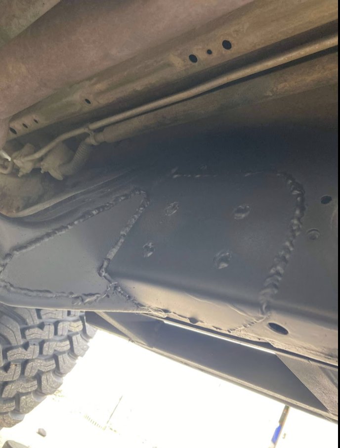

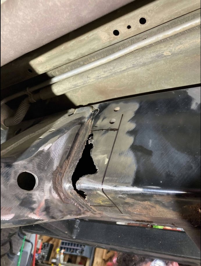

    I did a similar repair on a friends gx470, I cut out the crusty section then put a big fish plate over the top. Welds turned out like kaka but itll hold. I think this was pre good hood.

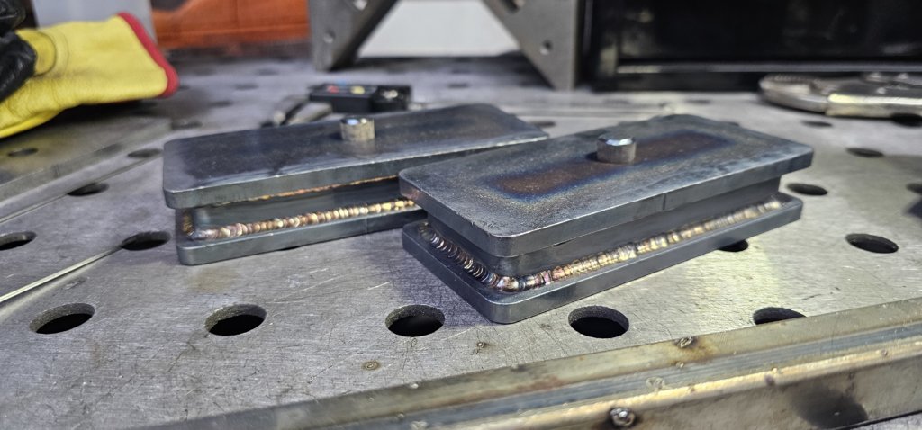

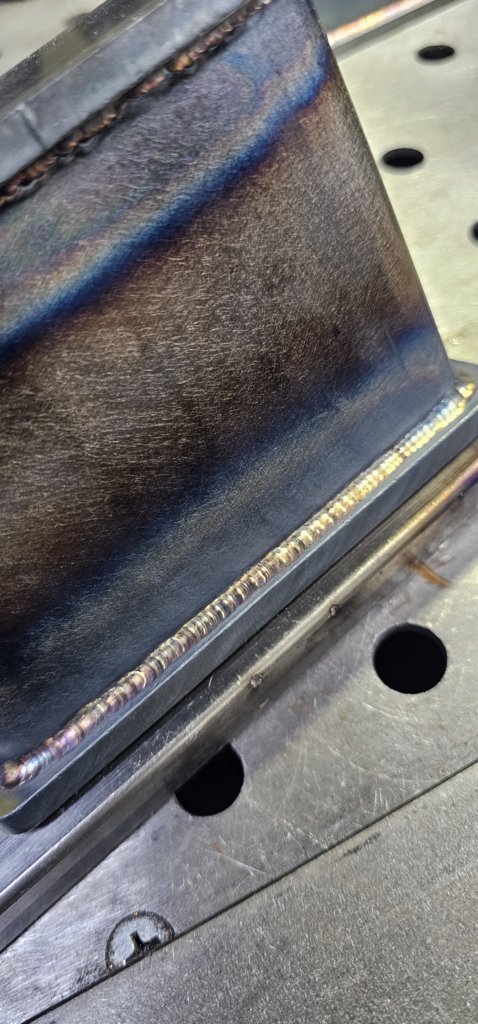

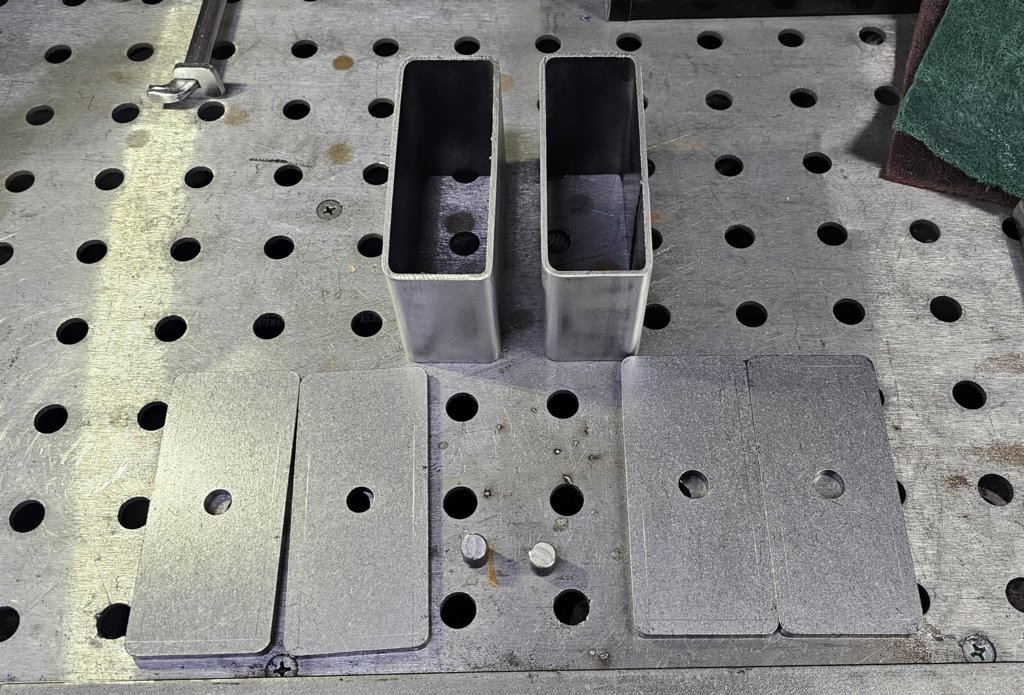

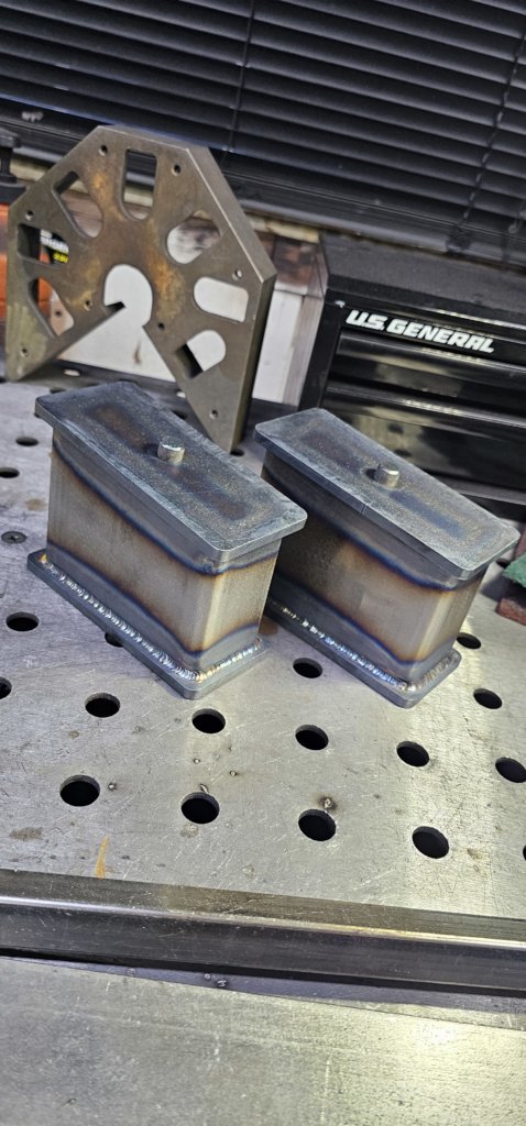

    Smallest set of blocks I've made. Theyre more of a pain in the ass to weld than the bigger ones.

    They look smaller...is it because it's wintertime?

    "It's cold outside"

    They're growers not show-ers.

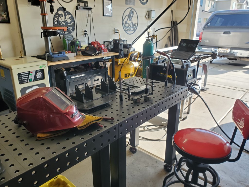

    Easy Saturday morning earlier today

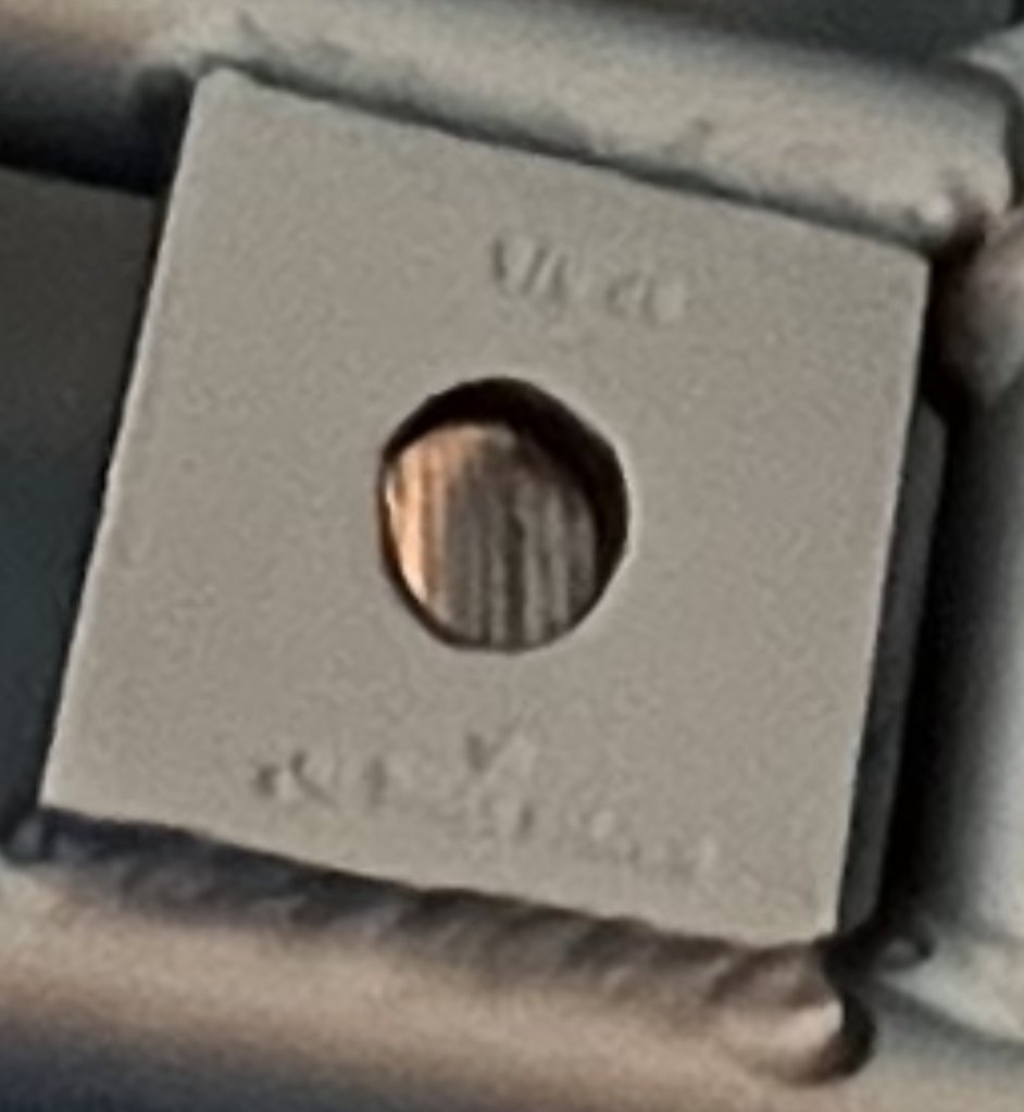

    "draw up whatcha need", this, but not fucked. And yes to those with eagle eyes, those are Simpson washers. Didn't realize that until I took the skid plate frame off 22 years later.

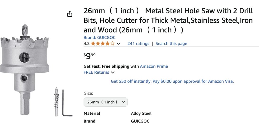

    Like this... $10 bucks for three holes seems reasonable...

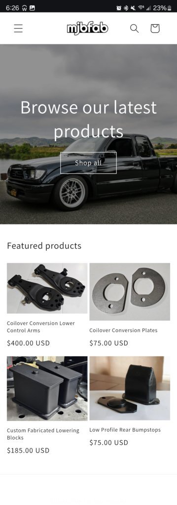

    Launched my website today and got my first order. Finished it up and will be shipping tomorrow.

    Sweet!! Congrats!

    Congrats and good luck on expanding your venture!

    Thanks guys! Hoping it expands the customer base a little bit.

    i don't entirely follow what needs to be done. just beware that fresh weld tends to work-harden the metal, so sometimes, it's not possible to drill through it.
    if those bits would work for the size you need, be sure to get two. the carbide is cheap and brittle. they're extremely easy to break. and when they break, they tend to knock all the teeth off at the same time.
    i used a similar bit for drilling the 8 holes for my trailers suspension mounts. i got through 3 holes before the first bit imploded, but then the second bit lasted through the rest of the holes without an issue.
    idealy, you'll want to use a quality name brand carbide-- the greenlee or dewalt versions do actually cut better and last longer, but they're typically closer to $30-50/ea and the cost doesn't always work out for many projects.

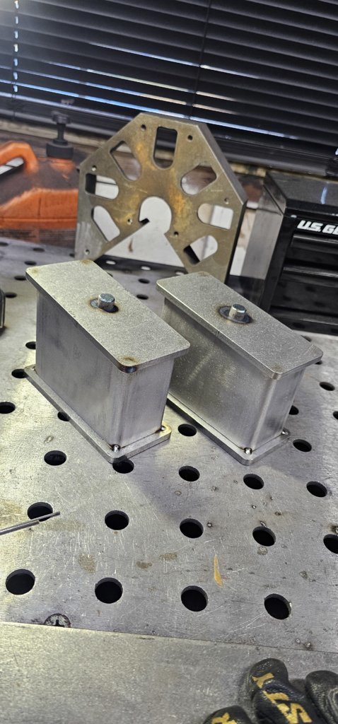

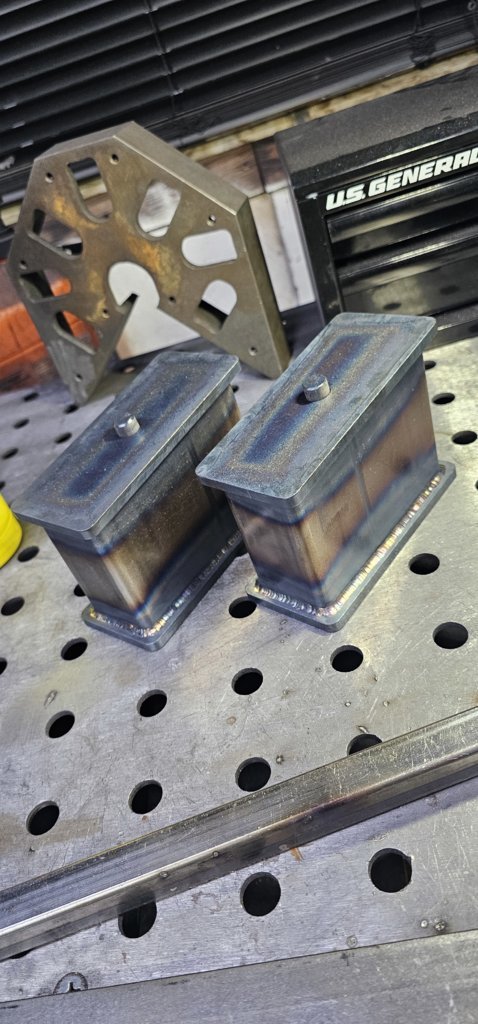

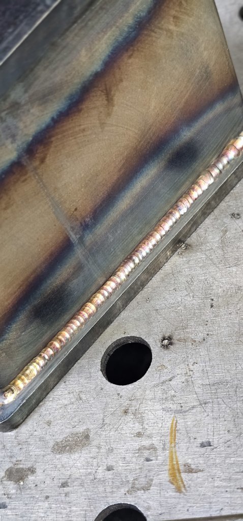

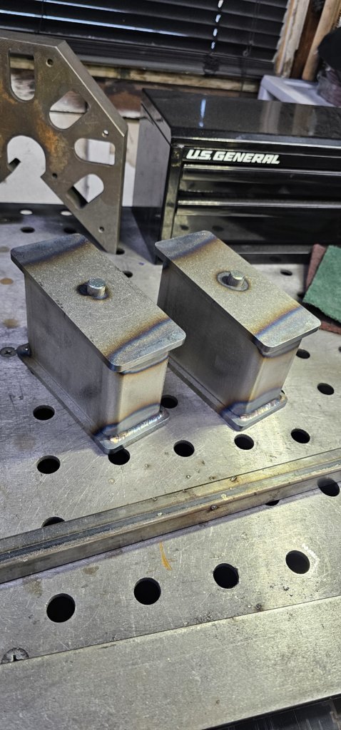

    Made some big boy blocks today.
