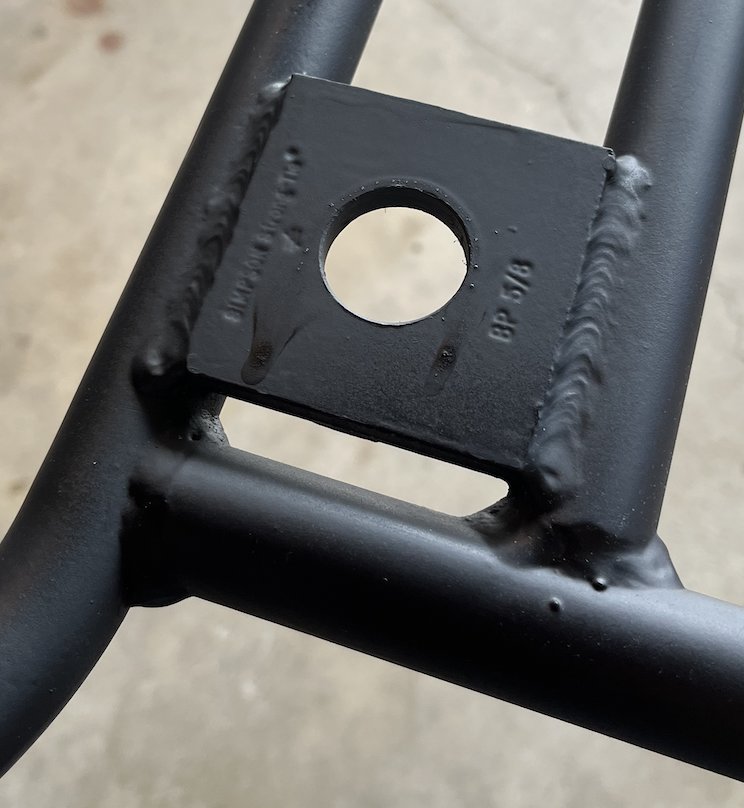

    Those cheap Amazon/Chinese metal hole saws did exactly what I was after. I first cut a hole into a scrap piece using the drill press, and then clamped that piece to the skid plate to enlarge/reposition the existing hole. Once it was clamped I was able to use my dewalt drill to cut the bigger hole into the skid plate. I kinda knew that I needed to drill the holes more towards the wheels so using the guide hole, I was able to get the extra space I need to make this old flawed skid plate fit more easily. After the battle I had with it the first time (20 years ago) I swore never to take it off the truck, but time was not kind to the rattle can paint job, and it was well over due to clean it up...
    I did have to custom make some 1/4" "washers" to make up the gap between the mount and the bolt head, and I had to use longer diff bolts, but those were small potatoes, and already had a good 14mm drill bit, and the right grade 8 bolts on hand (from a long removed diff drop).
    20 year skid plate maintenance, check.
    The hole saw did leave a burr on the top and bottom of the hole, and I ended up using a diamond cone (I had for tile) bit on the angle grinder to knock the burr down.

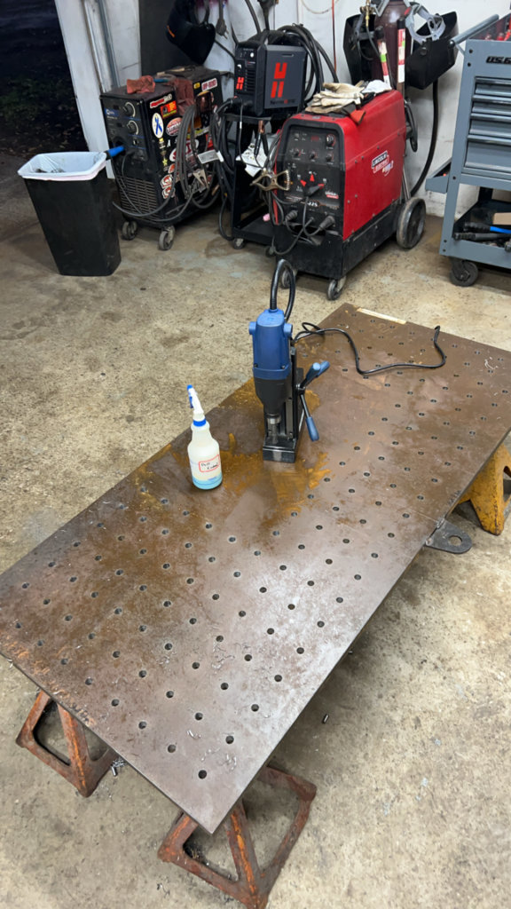

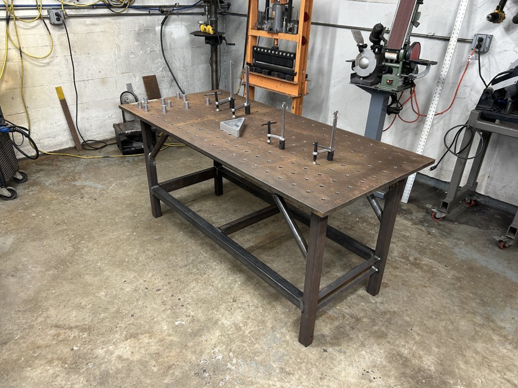

    Been wanting a fixture table for a while and was able to get a 30”x65” piece of 3/4” carbon plate for $65. Spent another $44 on some scraps and $65 on adjustable feet and this is where I am. Shelf being added to the bottom with some other things and then the frame gets painted.

    How long did it take to do all the holes?

    Around 5 hours to drill 189 holes. Maybe an hour for layout.

    My friend did that as well a couple of years ago but went with 4" centers
    He said he's been meaning to add some 2" center holes but it was a bitch and a half drilling all of those holes with his mag drill
    I remember him telling me he hated the mess it created more than anything

    It certainly wasn’t fun lol. I went with 3” centers to cut down on number of holes drilled. Definitely not a fan of the oil and shavings slung everywhere but I’ll take that for saving a couple thou on a table

    The holes done on a mag drill are crazy nice too; are you gonna go through and chamfer them? Would look way better if you did!
    When I plasma cut one out, I had to run a reamer cause I intentionally undersized them by about 0.1". That in itself was a pain in the ass as well.

    I hit both top and bottom of all the holes with a countersink bit to chamfer them ever so slightly, hard to see in the pics

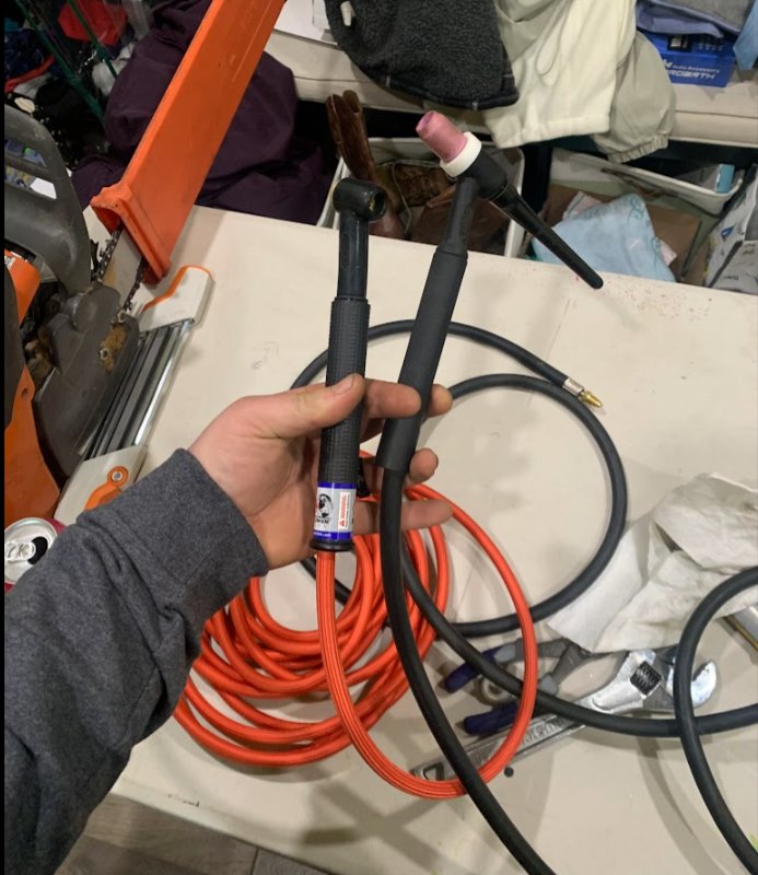

    Finally isnt 15 degrees in the shop so I gave this a try. Never thought a tig lead could make welding so much more enjoyable and fun.
    This and the Lincoln 3350 are the best two things I've gotten so far.
