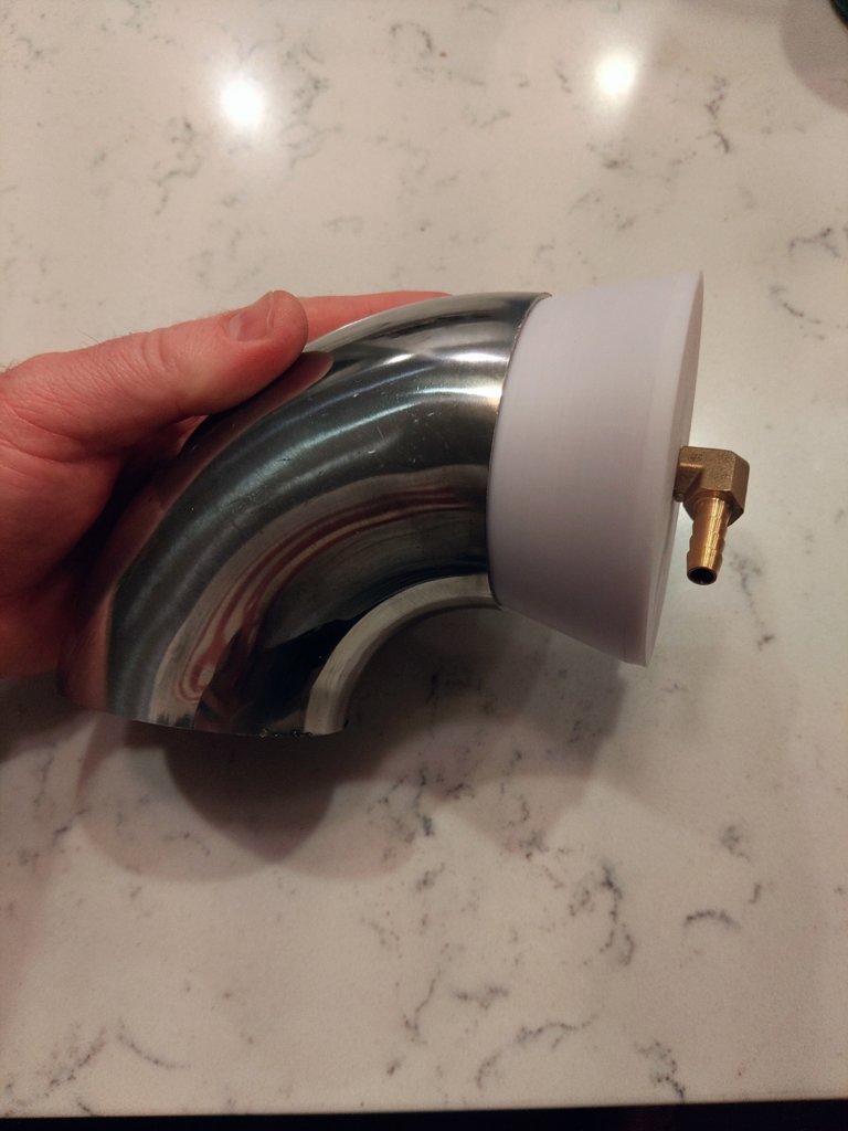

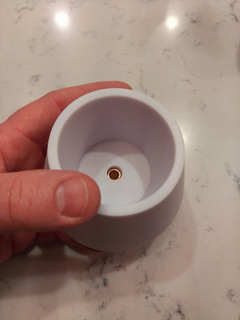

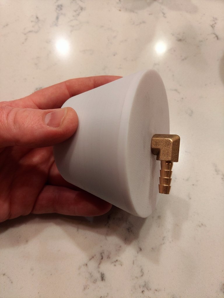

    Got some stainless tube welding coming up, and am tired us using aluminum foil to purge. $30-60 for a purge plug though....
    How about $2 of 3d printer filament and about 10 minutes in CAD!
    Tested it out on a couple scrap pieces and it worked great, so I'm going to print another for the vent side.

    I have always just used AL foil.

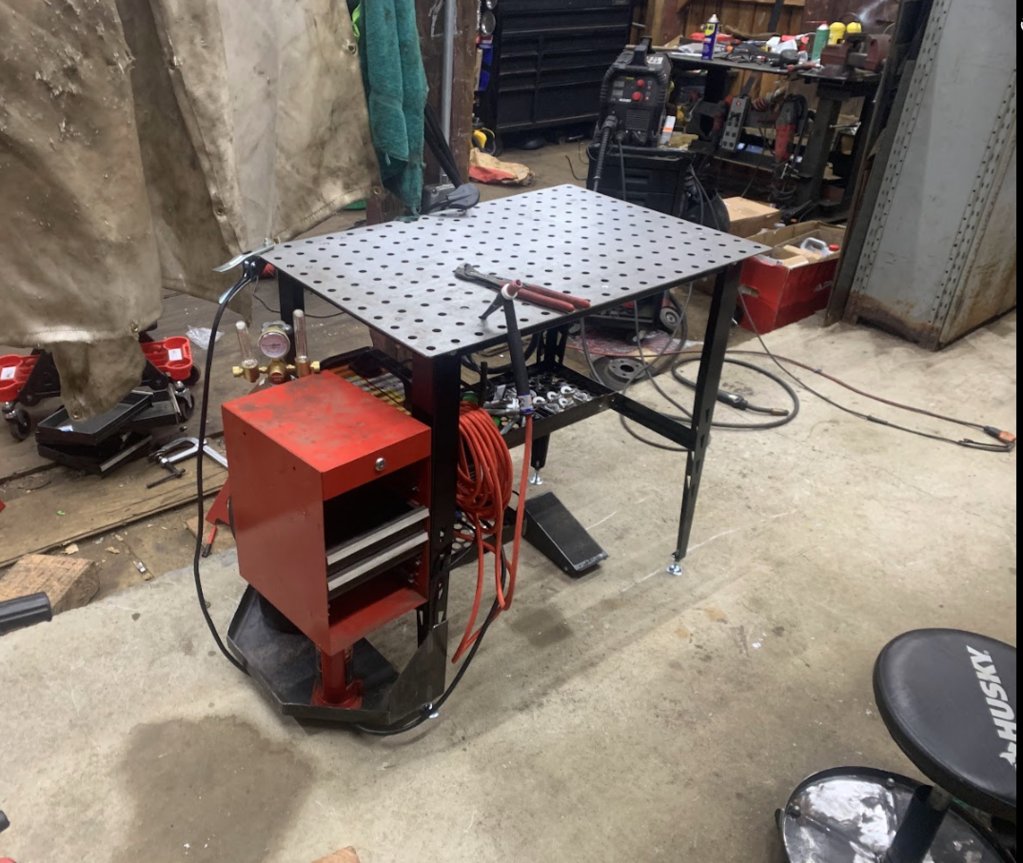

    Got the HF welding table and immediately started cutting it apart. A shelf for the welder and and one for the tooling and I think thisll be a nice little setup.
    More solid then I thought it would be but I wouldnt want it to be my primary bench for beating stuff on. Not bad for $150

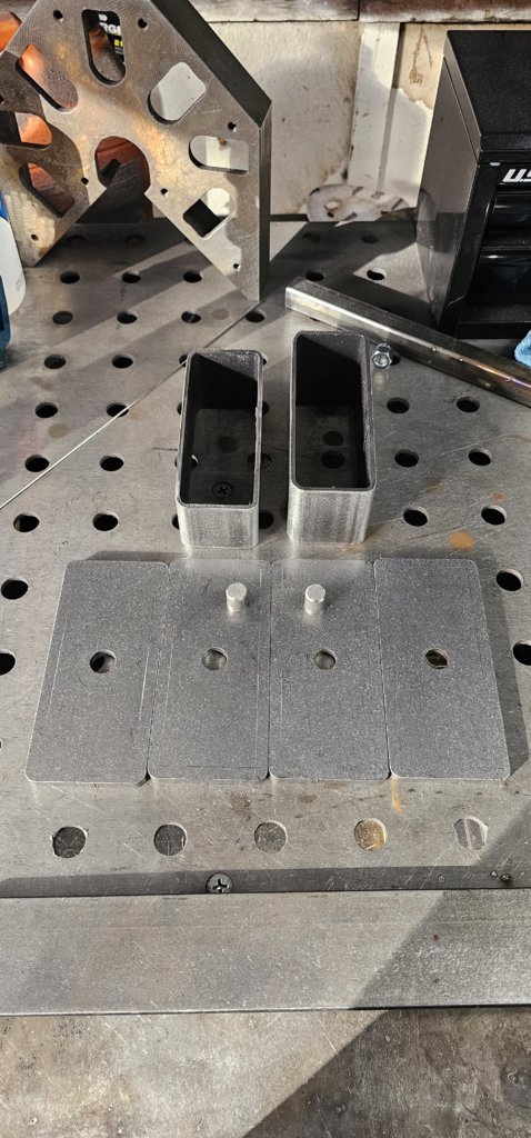

    Blocks again

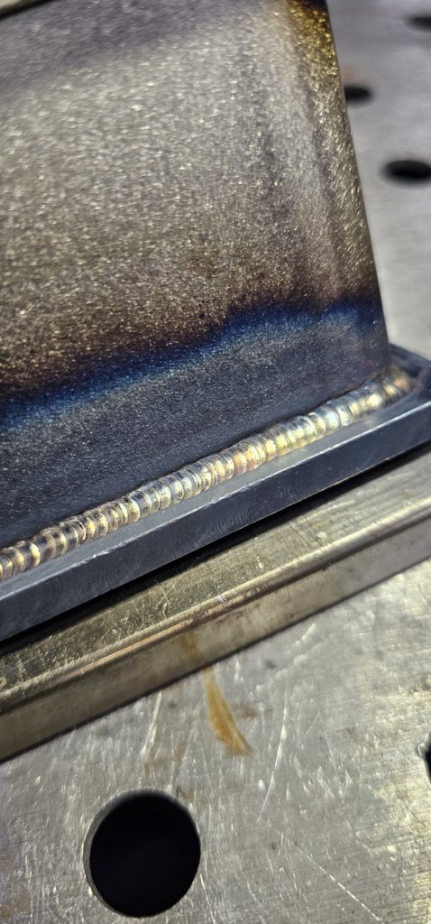

    For steel that thick and a suspension part you should probably feather those and run a second pass. Come back through with thin filler like .045 and pulse with the pedal. It'll look even better and be a lot stronger too

    Are you left handed?

    Nope lol

    ah shit, put my brain on backwards this morning. for some reason i was thinking the bead was stacked backwards. must be the pretty colors distracting me.

    The colors get me sometimes too lol
