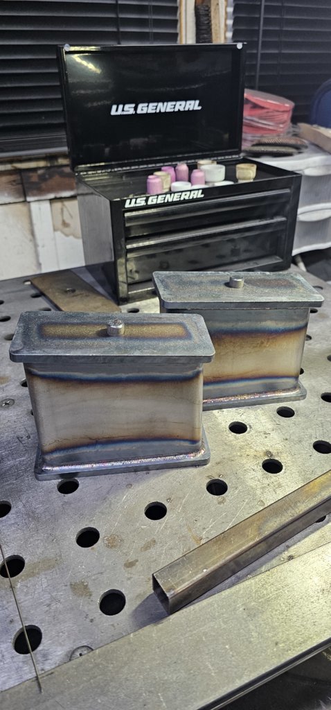

    3am welds today lol

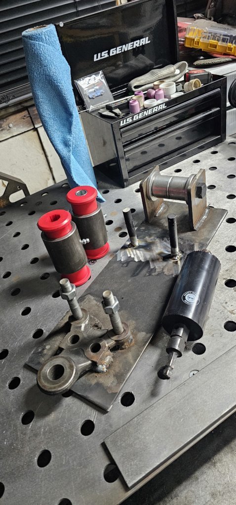

    Modified my arm jig a little to better locate it after cutting the bushings out. (Added the two small posts) Gonna modify a friends arms tomorrow.

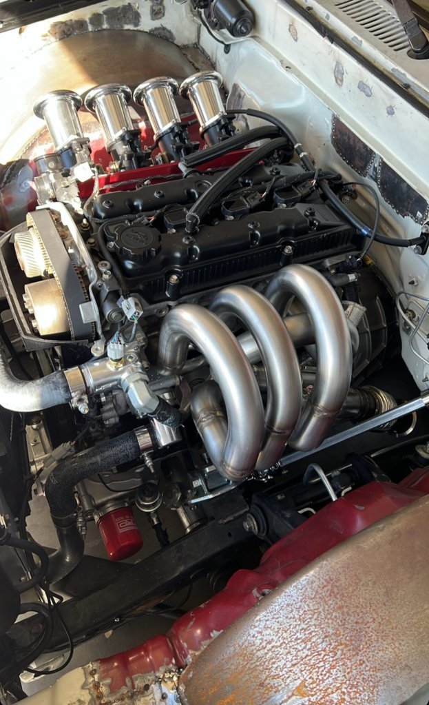

    Here's the finished header I welded up installed in the truck.

    That looks really nice!

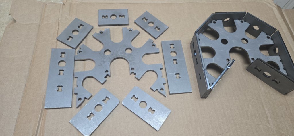

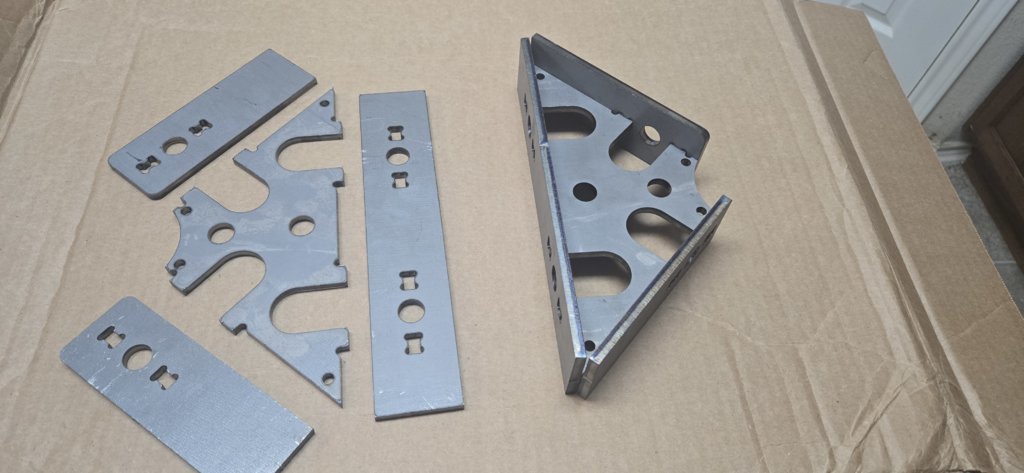

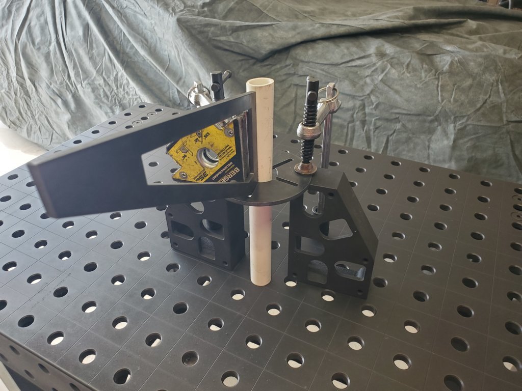

    A couple of fun projects for welding table.

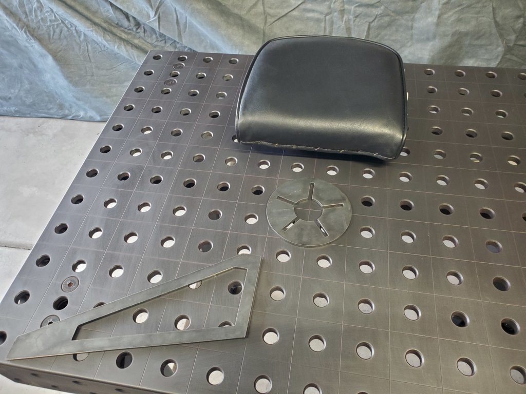

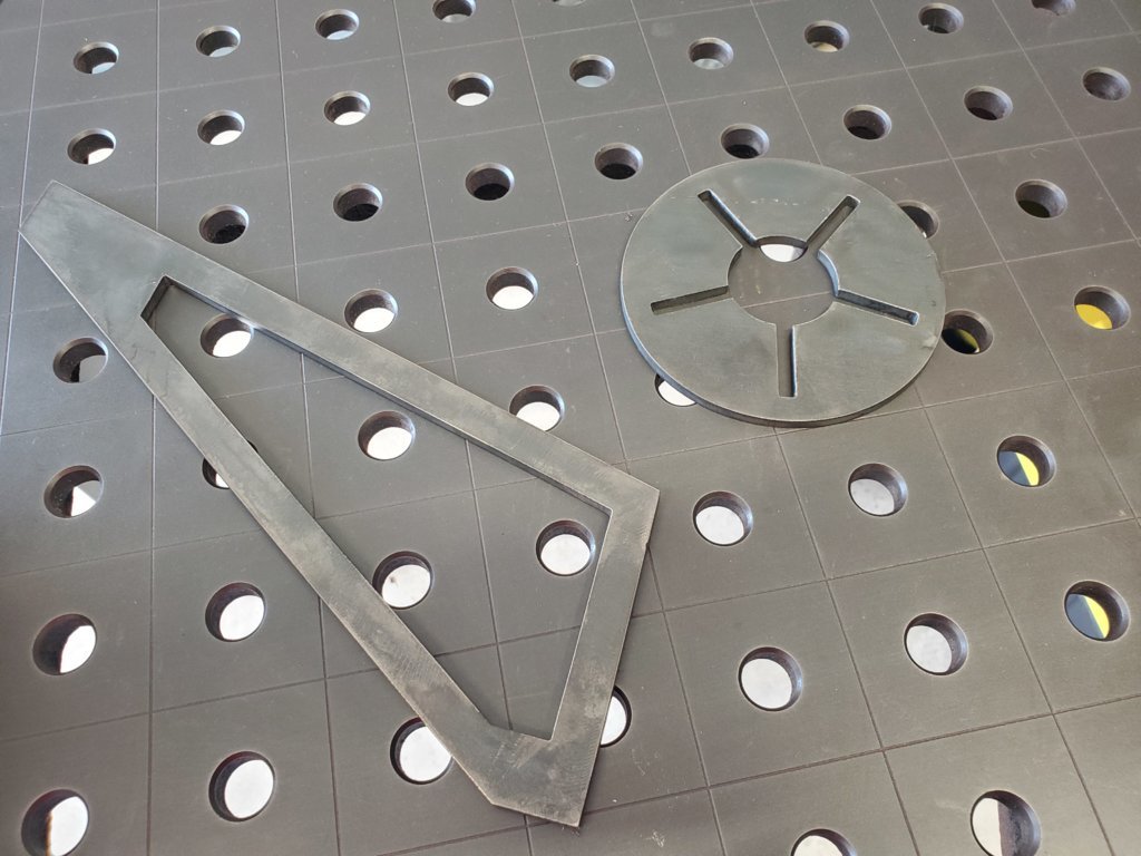

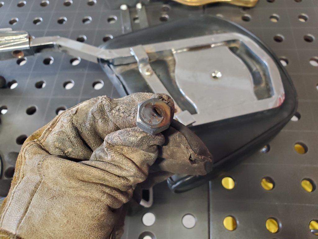

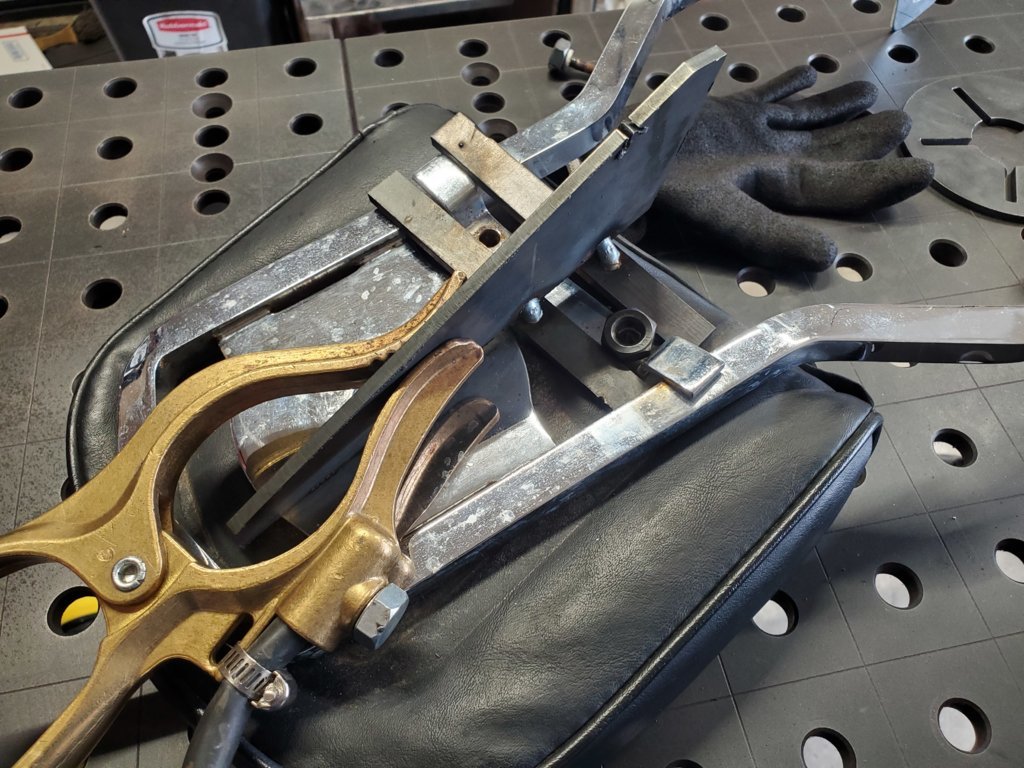

    Started my own project today
    Had to improvise in getting these out; completely seized and stripped phillips head bolts
    Unfortunately, UPS is delayed so the parts that were supposed to arrive today won't show up until tomorrow

    @Kwikvette you ride or project being done for someone else? Asking because it is a motorcycle passenger backrest but not sure for what brand. Im thinking Harley or Yamaha.

    Yep, project for myself.
    Sissy bar from a 2013 soft tail, good eye!
    I'm using it because I wanted something comfortable, but durable more than anything else and being real leather helps a lot. Just using the backrest portion though, the frame is getting tossed.
    I'm actually making my own "Vyper" style chair. And the parts that were supposed to arrive are my 2' long acme screw, and 2 nuts.
    Acme lead screws (1" diameter) are way stronger, and more precisely cut than all thread so I went with that.
    Just need to buy some round tube for the center, and cut out the remainder parts.
    That and figure out a good bottom cushion solution.

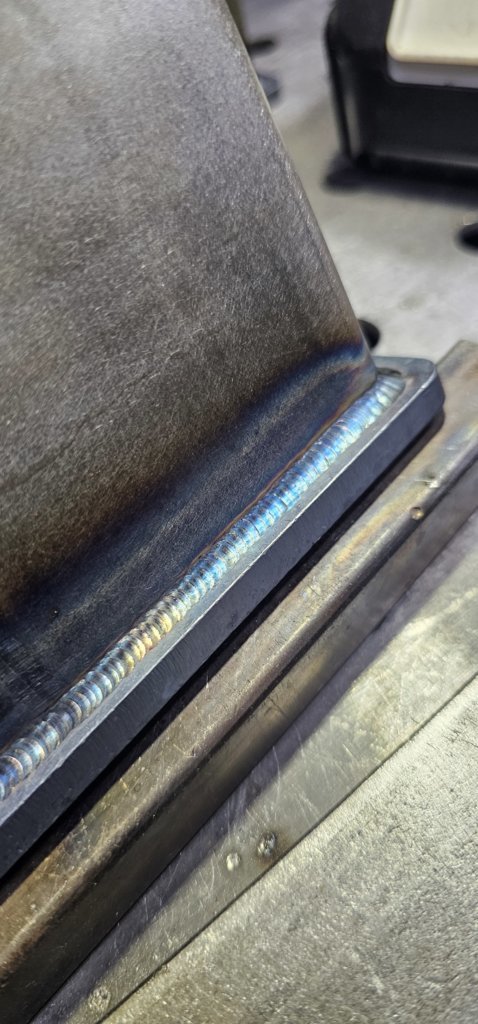

    The weld no one ever sees lol

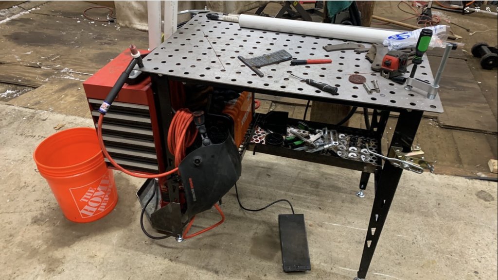

    Nope still rockin my cheap HF unit. With a new ck17 it works great. This whole setup is probably around $500(not including the 3350). Will get a 225X one day but funds need to go elsewhere.
    Having access to TIG MIG and stick is so helpful.
