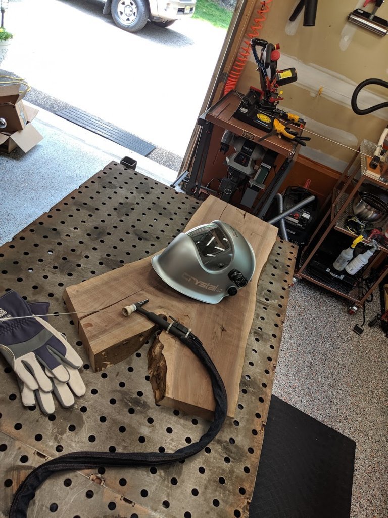

    Found some walnut filler rod, about to lay a bead to fill this crack.

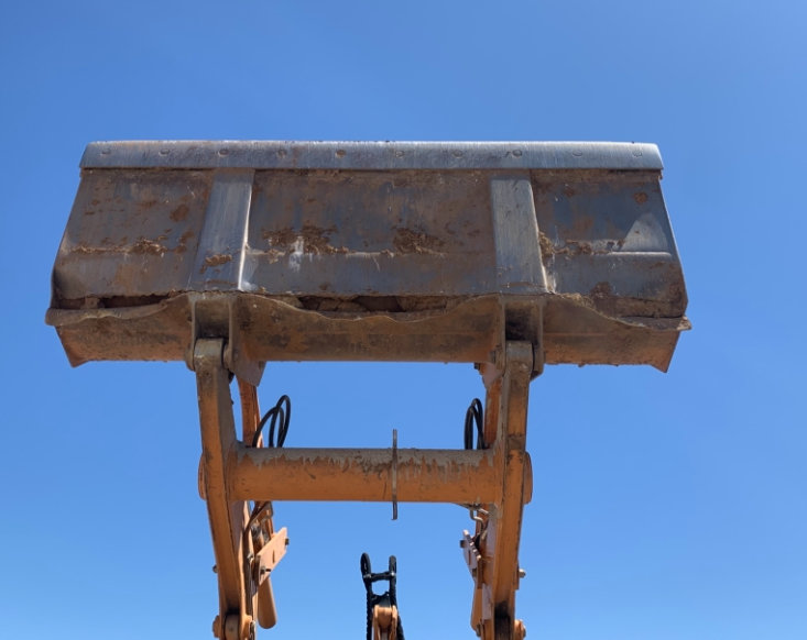

    This is the underside of our Case 580 bucket at work. You guys think it’s repairable? We were quoted $2500 for a used replacement.

    Repairable? Yes. As long as there's steel there to weld to, it's possible to repair.
    Repairable for less than $2500? Probably not. 1/2" or thicker steel sheet isn't cheap. Nor is the labor to make it into a repaired bucket.

    Most likely it's AR plate as well.
    The abrasion resistant iron is spendy.
    Frankly, I'm amazed that bucket is so worn. The chassis has got to be pretty loose and ready for scrap as well.

    I should add we have all the tools, materials and welders on hand. We just haven’t had to repair a bucket before.

    The loader is in great shape otherwise. This damage is from the operators always trying to use it like a road grader, I think.

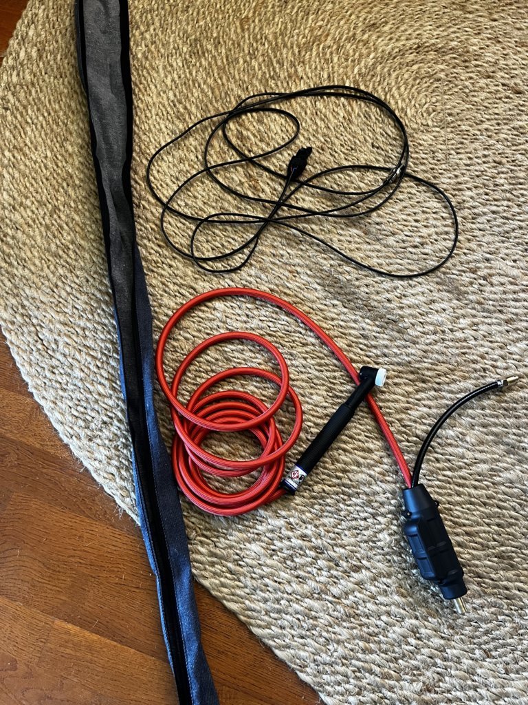

    Setting up the CK Dub 17 Flex with a switch. The SPOT feature on the 200P is the kind!

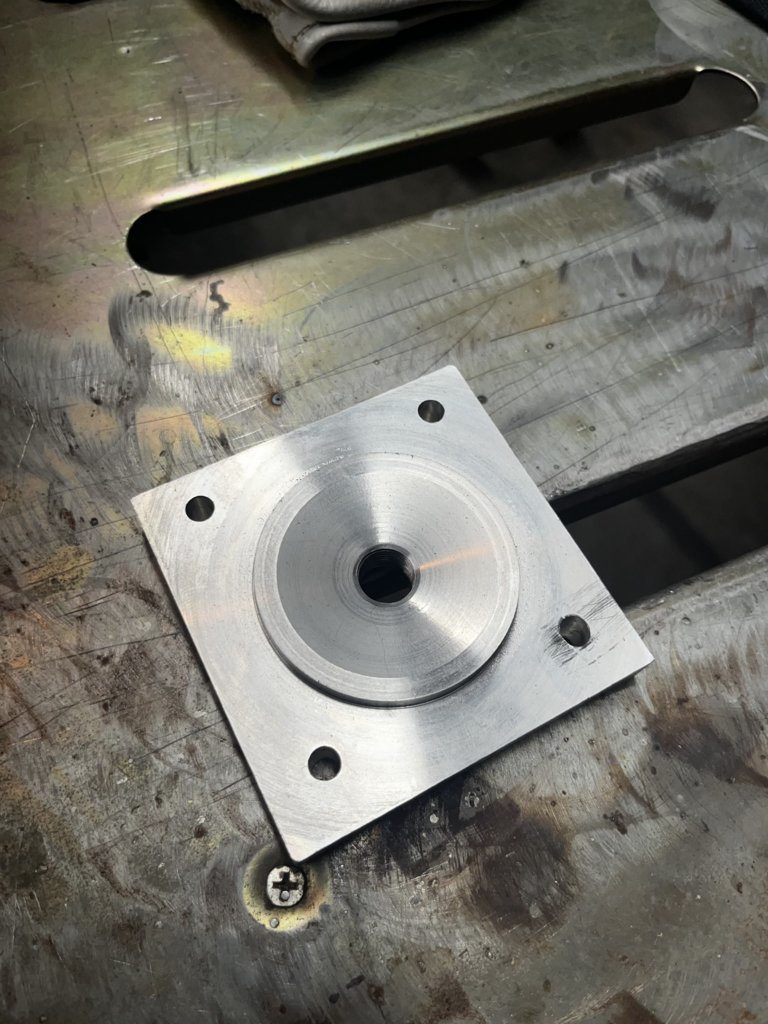

    Next project. Add some filler to the cylinder head. I sent the cylinders to Kustom Kraft for boring/plating. So I have to add filler for the 2mm bore. Then off to Dr. Lathe.

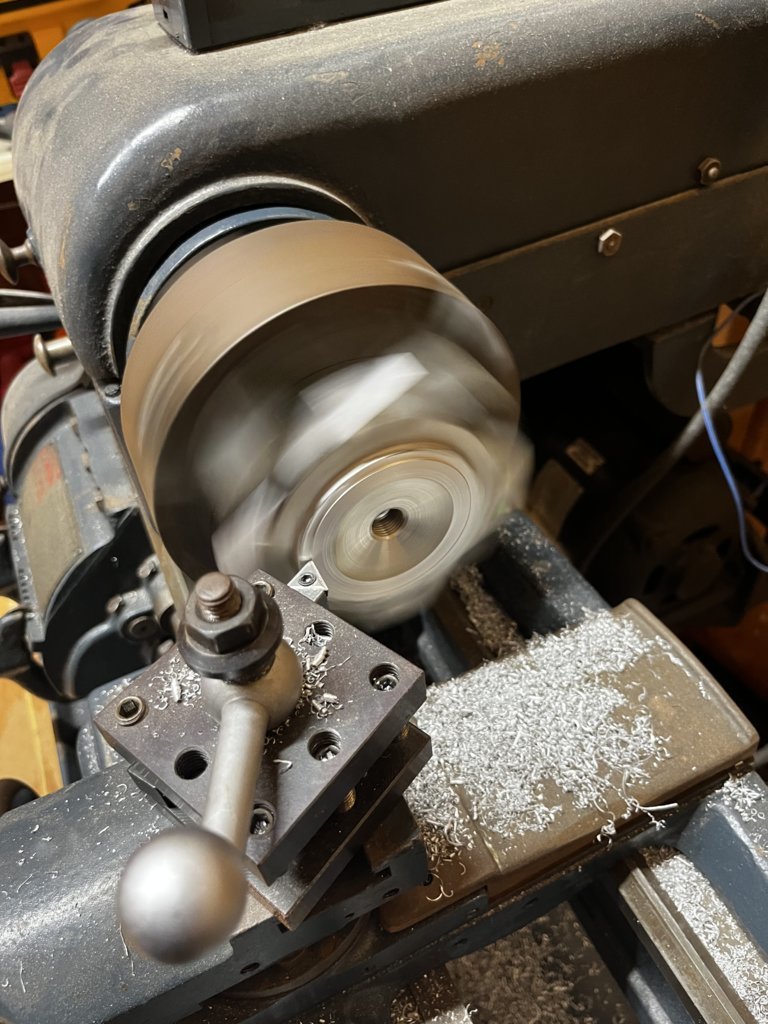

    Dr. Lathe and Dr. TIG working together to get the job done :hattip:

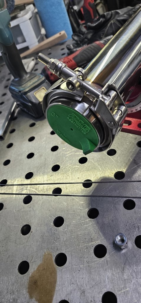

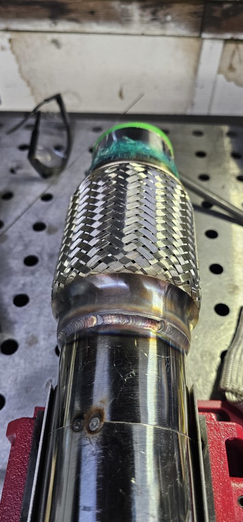

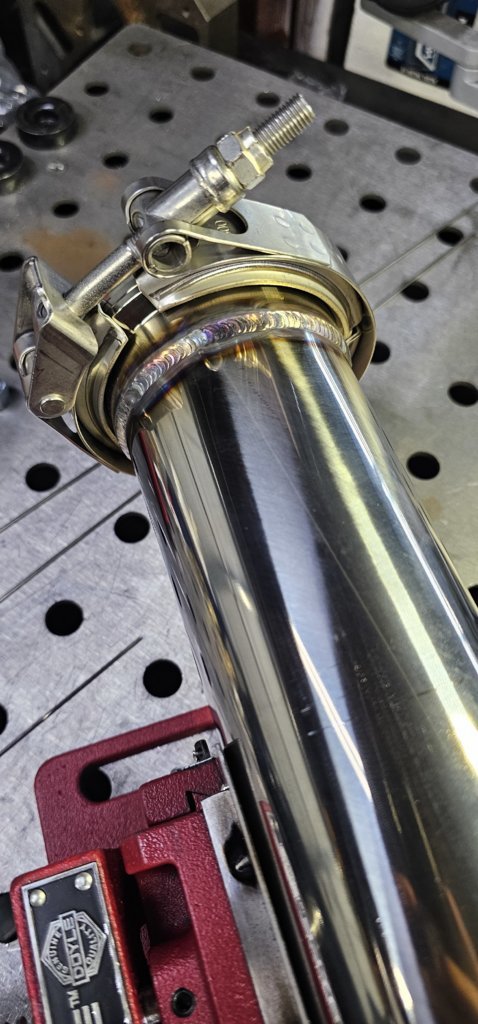

    PERFORMANCE Custom Turbo Setup FRONT SUSPENSION Drop Spindles by Aaron Carswell 01-04 Swaybar Endlinks Energy Suspension Endlink Bushings Cando Upper Control arms QA1 coilovers with 8" spring Custom 4 pot Brembo BBK Modified lower control arms with mjbfab qa1 mounting plates and Poly bushing sleeves REAR SUSPENSION Chasis Tech drop leafs QA1 adjustable shocks weld in drop notch Gas tank cross member bridge 3" angled blocks 2013 Double Cab Short Bed TRD Sport Eibach Pro Truck Shocks front and rear Lifted to the 3rd setting on the front shocks

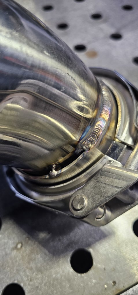

    Making progress on my stainless exhaust!

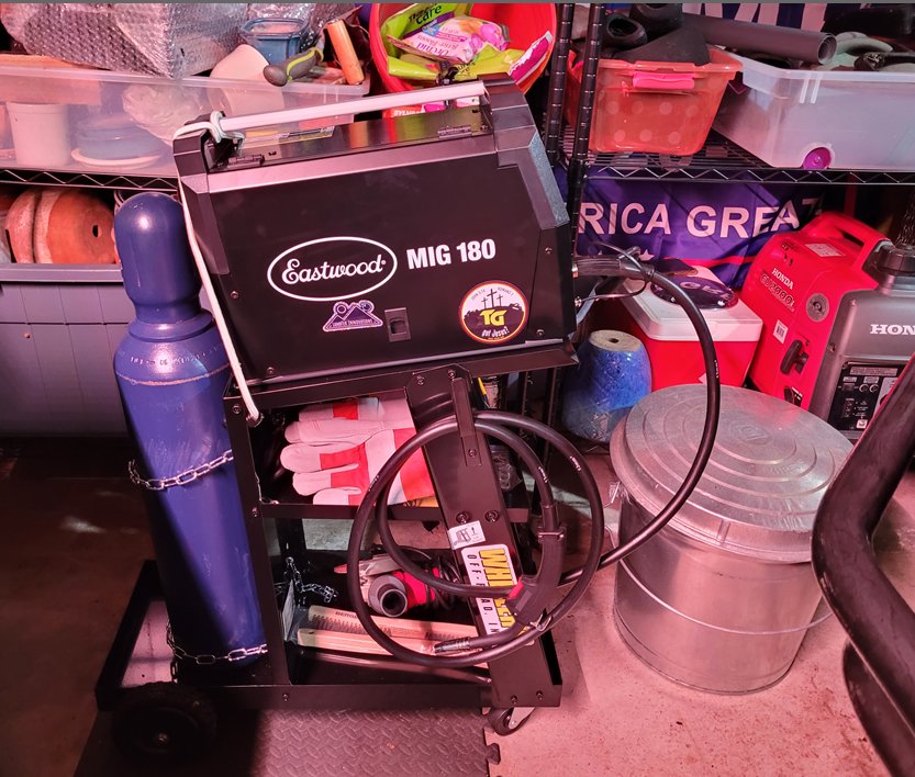

    can anyone help me answer this?
    thank you

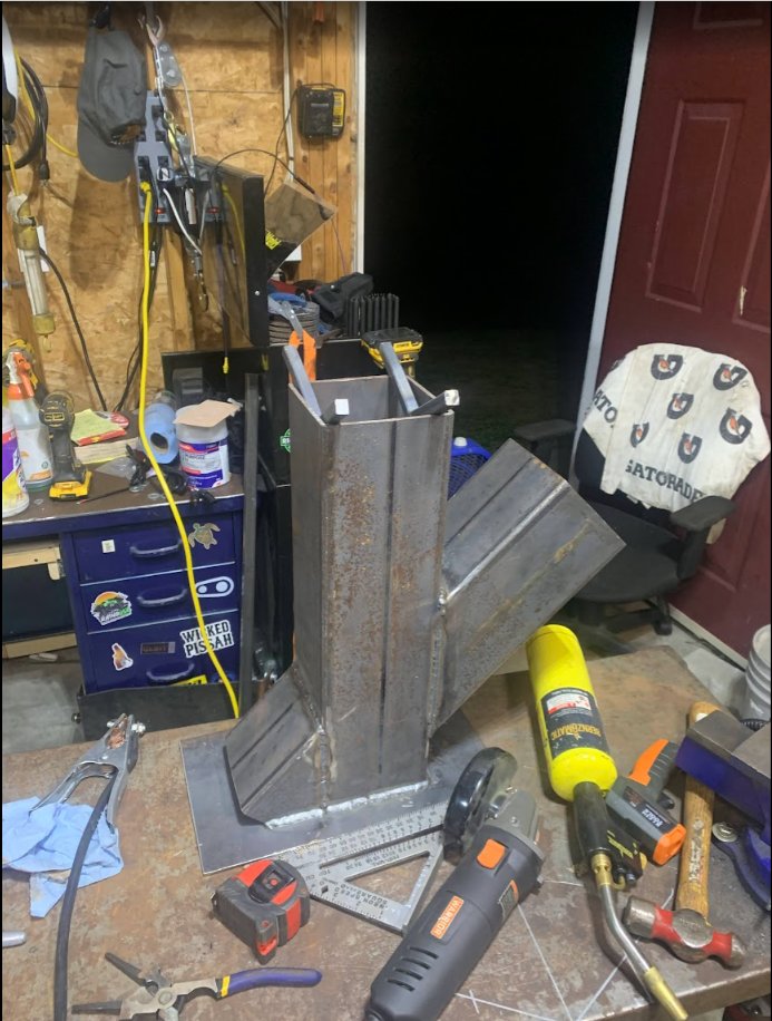

    Yes you can weld on 110 to get started. I did for a few months but moving to 220 makes the whole experience a lot better.
    Made this summer of 2022 as one of my first welding projects on my mig 180. I think this was with gas

    neat rocket stove! did you cut the large angles yourself?
    also thanks for the tips, i thought about having electrician work a 220 outlet to my garage (i had them do it for the dryer and i have room on panel i think) but i wouldnt mind 110 welding, with gas, but i dont want to be popping 20amp breaker all the time...do you think for a lot of welding 110 mig i could do it without tripping the circuit?
    maybe this will turn into an electrician project soon...but considering i have no welding project currently, never welded before ever, and the fact that it very quickly climbed towards $1k, maybe ill put this on pause for a bit and play around with it/pop breakers perhaps haha
    heres a pic i took last night, i have to figure out how to safely rig the regulator and gas line, never even removed safety cap from a cyl like this before, brought it home in baby seat in my cab haha

    Drainbung likes this.

    Yep, just cut everything with an angle grinder. Yeah just play around with it. I think youd be fine welding 1/8" stuff. Its been a while sense I've used 110 it wont hurt anything to pop the breaker a few times to learn its limits
    Beware $1000 aint much with this type of thing. I thought by $500 welder was expensive then 3 years later I'm placing orders for $1500 in steel and aluminum for various projects.

    thats awesome, maybe ill put together a little rocket stove sometime for a learning project

    You can do a lot of welding on a 20a circuit. It's the really long welds that cause breakers to pop.
    Most MIG welds are around 4". It's when you carry a bead for 12" or more that the resistance builds up and trips the breaker.
