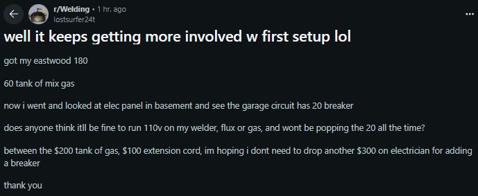

    appreciate that - noted and reassuring. i will be grabbing the thicker extension cord, 25ft, because i only have a male 220 plug off the machine 2', then a oem adapter for 110 plug, so i need to run a 25' out the garage to the driveway - as i dont intend on throwing a lot of sparks in garage, connected to the house
    but i think with a new decent 25' cord, thicker gauge than I have at home now, and ill be okay on thinner metal
    appreciate the input - maybe flux on some scrap soon (gotta flux before cracking gas...and im nervous about rigging up that gas tank haha)

    Sounds like you already have the solution you're looking for ^
    Just switch the plug on the welder to match whatever your drier has. It should have something like a 30amp plug and breaker on 220v and the plug can be purchased anywhere that sells them. Not much of a hassle to unplug the drier each time you go to use the welder. Also leaves any extra breaker spots for other stuff

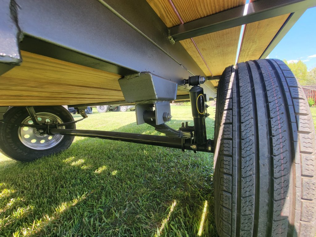

    you're going to want to eventually add a 220v line in the garage.
    that said, i'm working with an eastwood mig90. i've ran about 20-2 pound spools through it at this point, and am on my 3rd tank of gas(i started off with a tank the next size up from the one you got, and then upgraded one size up every time i exchanged it. the gas/exchange is only around $50-60, but the tank upfront cost is the obscene part).
    https://www.tacomaworld.com/threads...a-non-titled-homebuilt-trailer-thread.821530/
    i've been really happy with this welder overall. it's got some weird quirks-- many times i need to double-tap the trigger to get it to feed out, almost like it missed the trigger signal to start. the 2 pound spool limit is really annoying on my larger project. and the short lead length starts to really get in the way, it's either far too close and i can't move, or too far away.
    like they said, running more than a few inches of weld, especially .030 or 0.35, and in 1/8" or thicker materials is nearly impossible. on 120v, i would really suggest running .023 wire(not available in flux core though), and keeping to around 1/16" thick material if possible.
    i've already changed my setup to run on a 30A 120v breaker, because the 20A breaker popping all the time was infuriating. i added a 30A rv plug just off the panel to the outside of the house, then use a 30A-to-20A adapter, and then run a 12ga 50' extension cord to the garage for the welder. all in, i was around $200 in materials for the 30A addition. the last BOM i built up for running 220 to the garage had me around $1500 in materials, not including a new $1500 welder.
    don't be too afraid of hooking up the gas. it's actually far easier to learn with shielding gas than it is to learn the techniques with flux core(flux core also runs reversed polarity from standard mig wire). i like to run my regulator around 10-15 pounds output, which is always a balance between using up gas, and maximizing the life of the tank-- it's also why most of my welding is done inside my garage--to limit/control airflow. done in the open yard, wind is a much larger problem, and you might need to run higher gas pressure as a workaround.

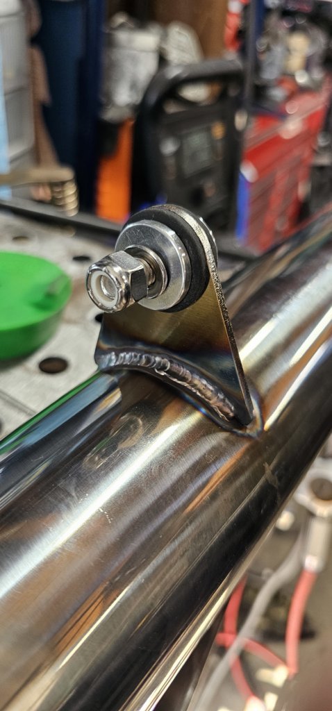

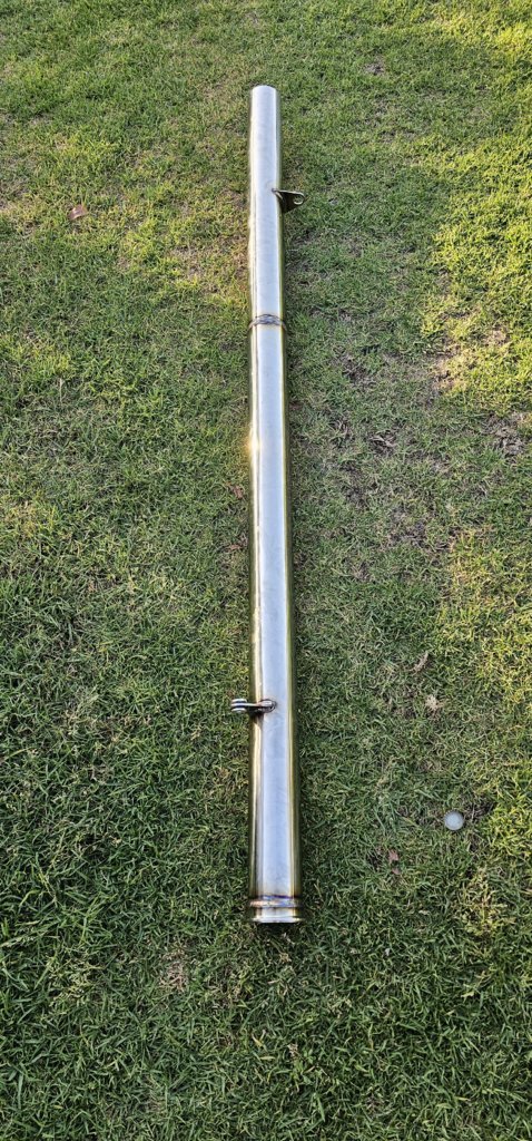

    Some more progress on the exhaust

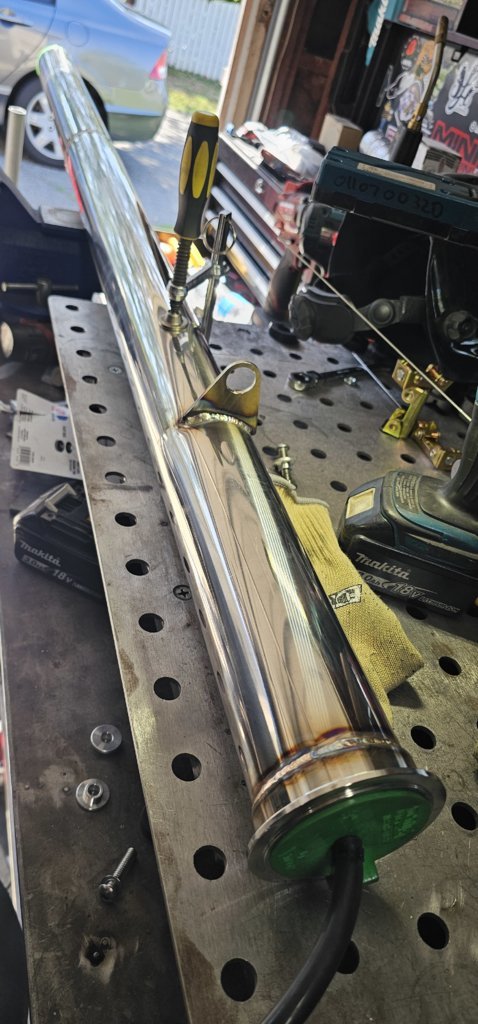

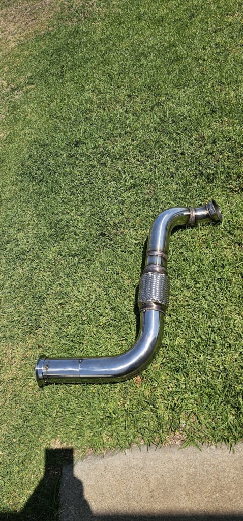

    Downpipe just about done. Just waiting on some more vbands to use as a heat sink while welding the vband on the downpipe. Then I'll throw the muffler on and build the rear section of the exhaust that goes over the axel.

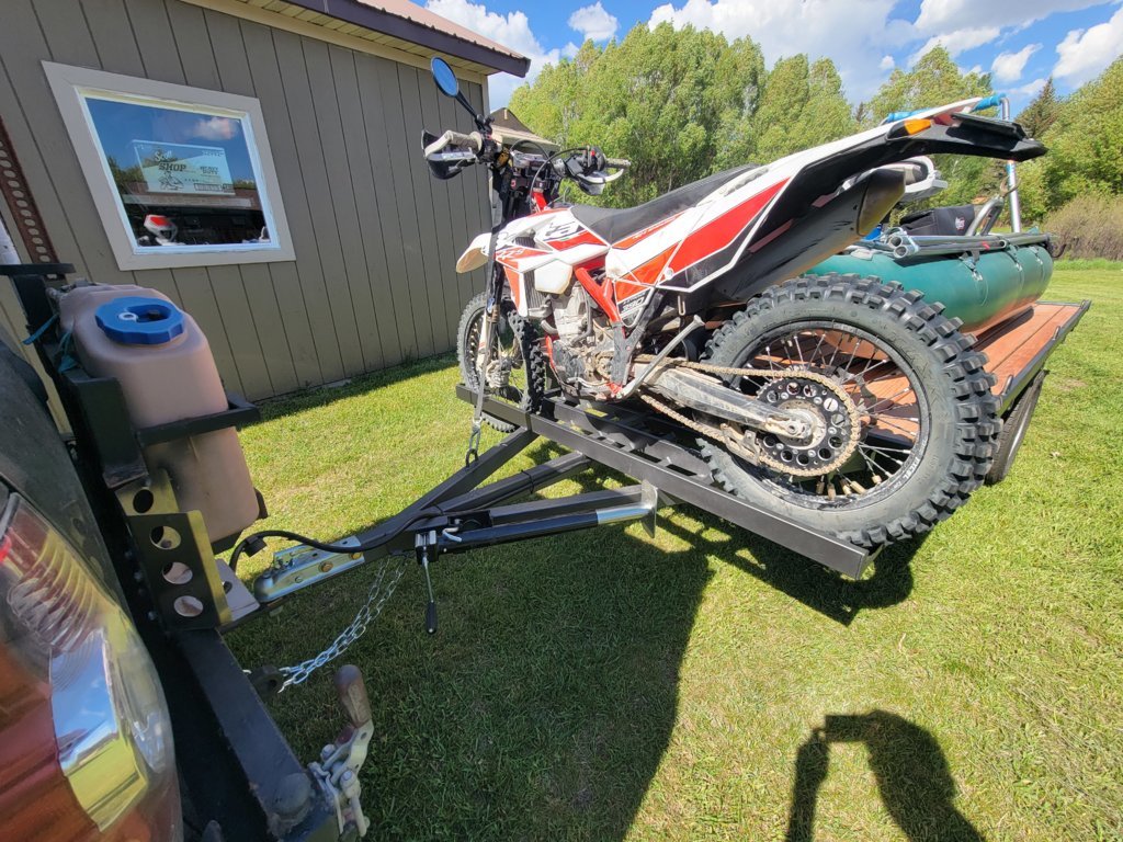

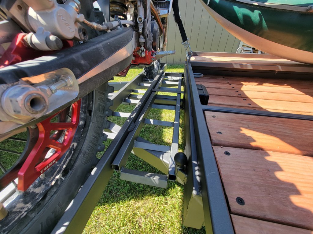

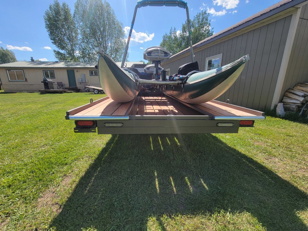

    And done. Probably should've just bought the one I took inspiration from, but mine's nicer. :D

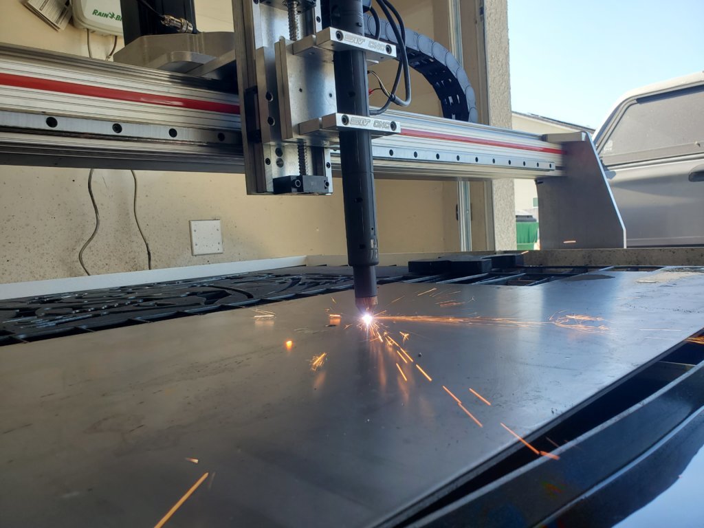

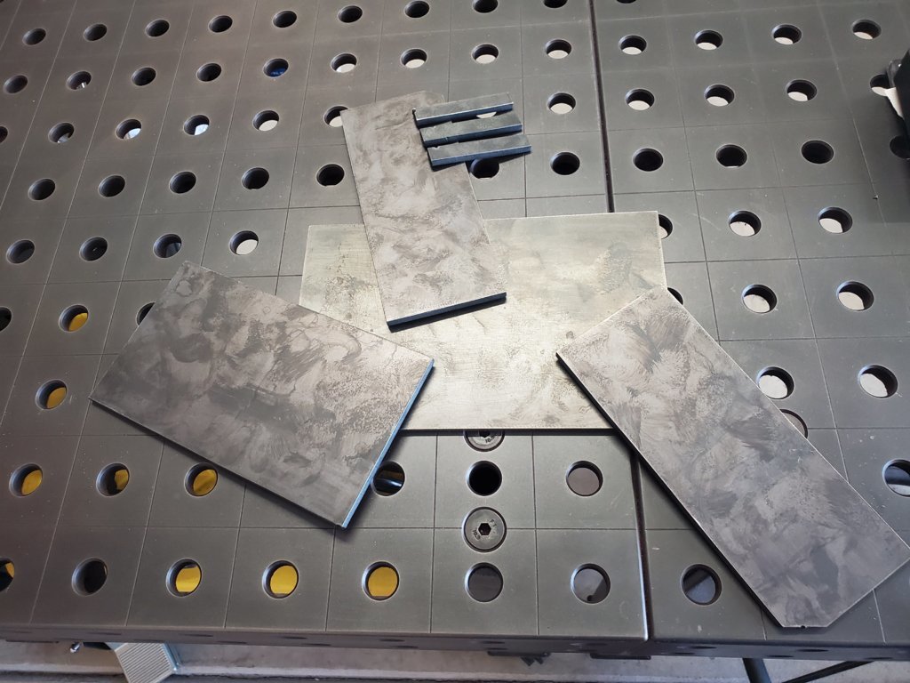

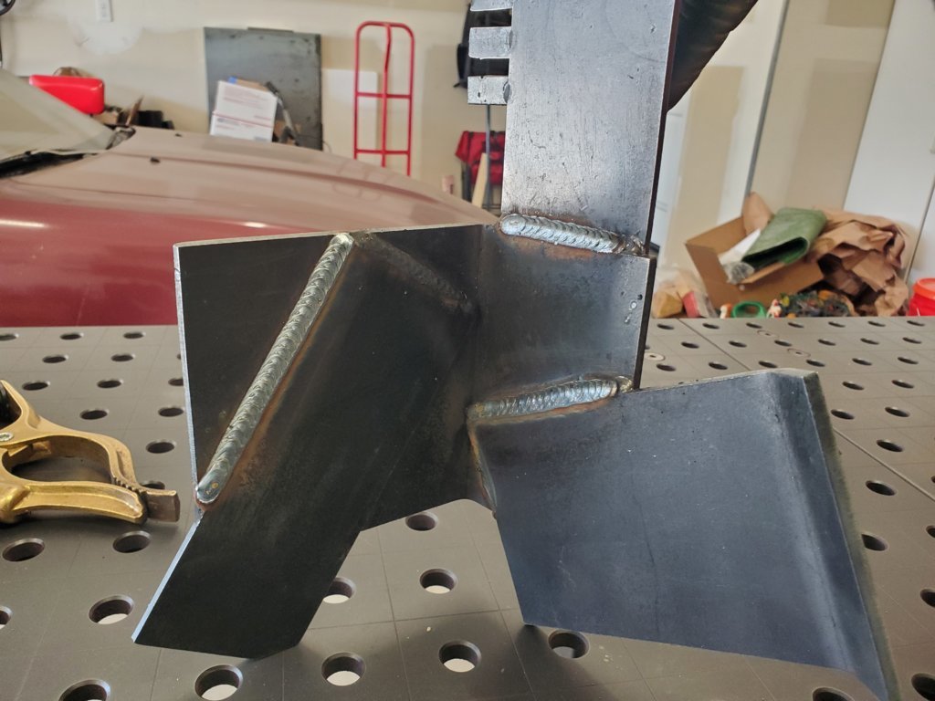

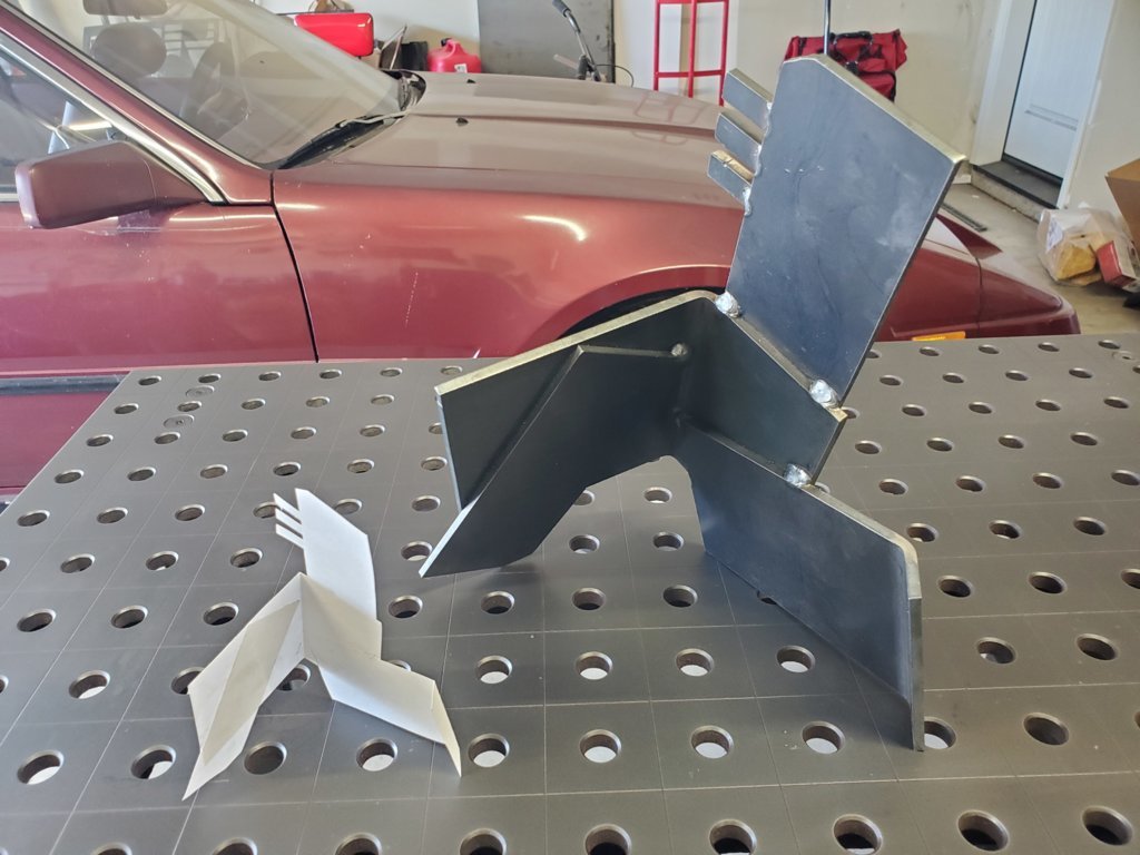

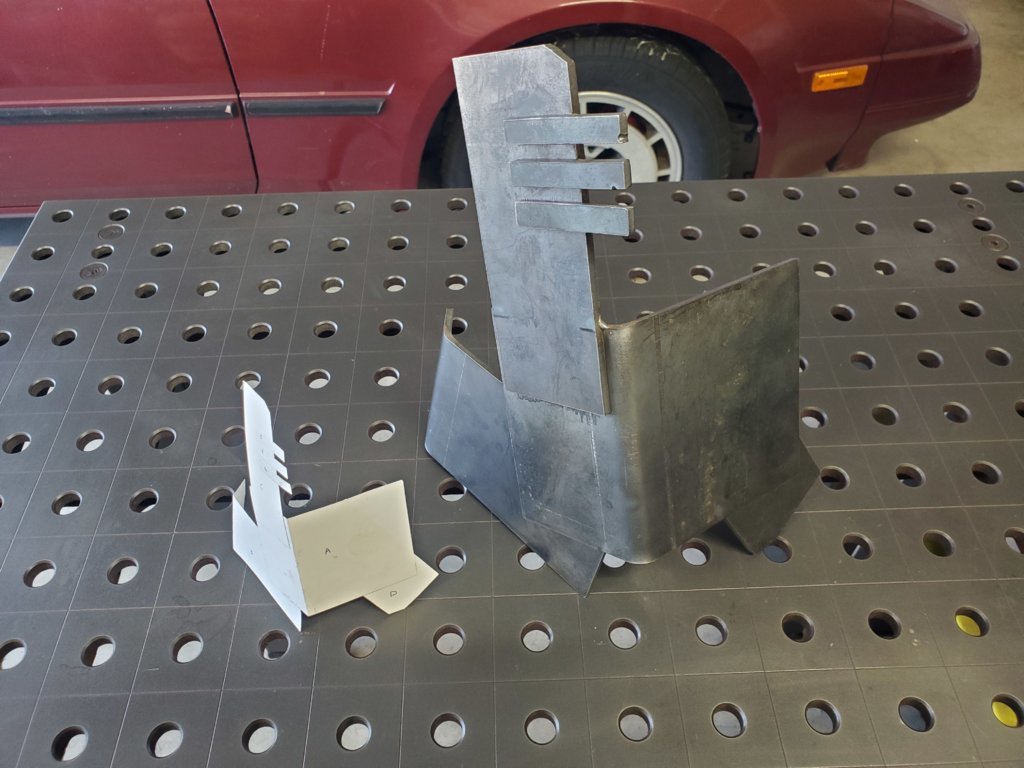

    Cut this out on the new CNC table.Got it bent, all welded up, and it's all ready to go.
    It's a metal recreation of the small paper art sculpture provided.

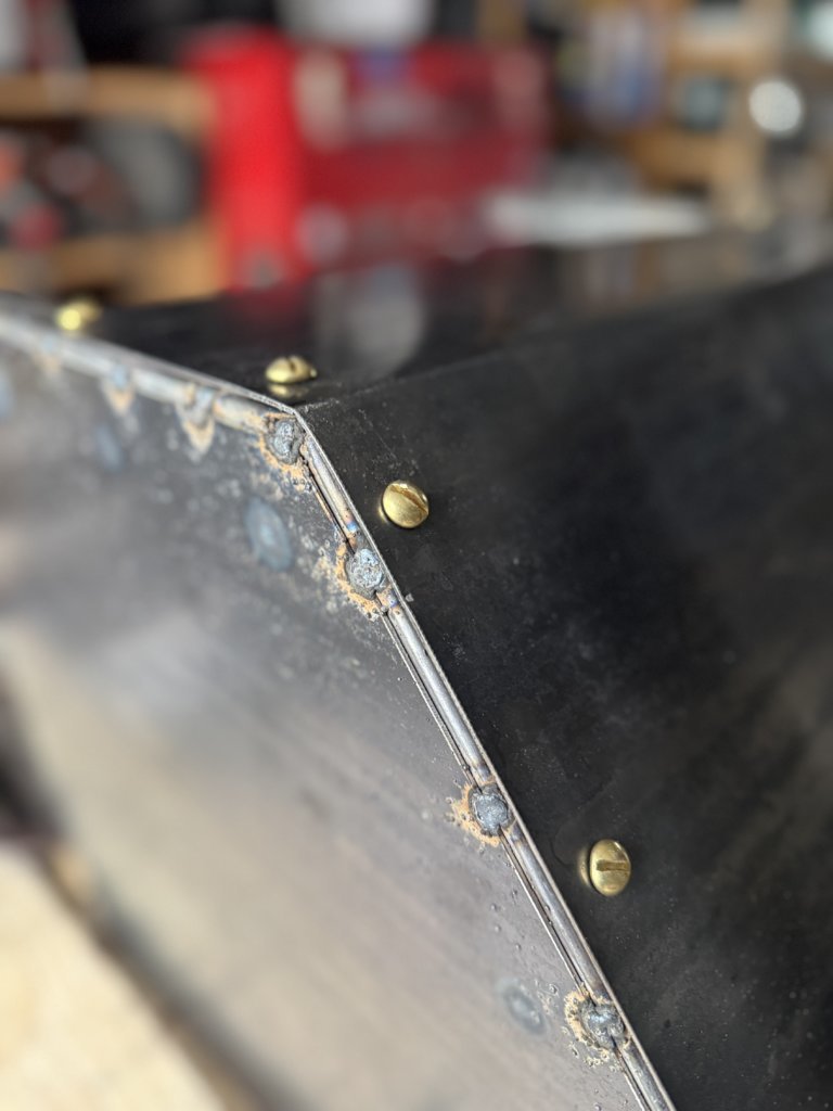

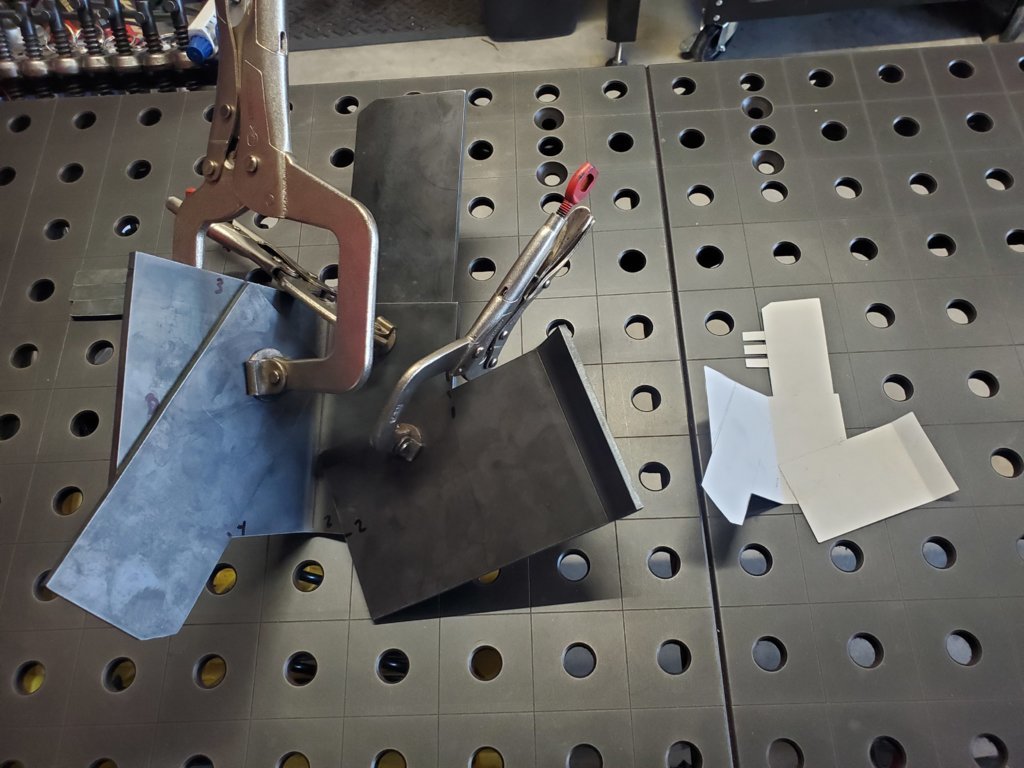

    Update - welded
    I made the mistake of not asking and just assuming tacks would be ok. Mainly because beads would distract from the design or so I thought :rofl::bananadead:

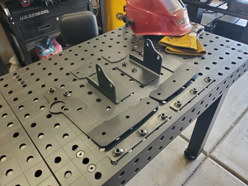

    Cut and welded a set of parts; first set done on the new table.

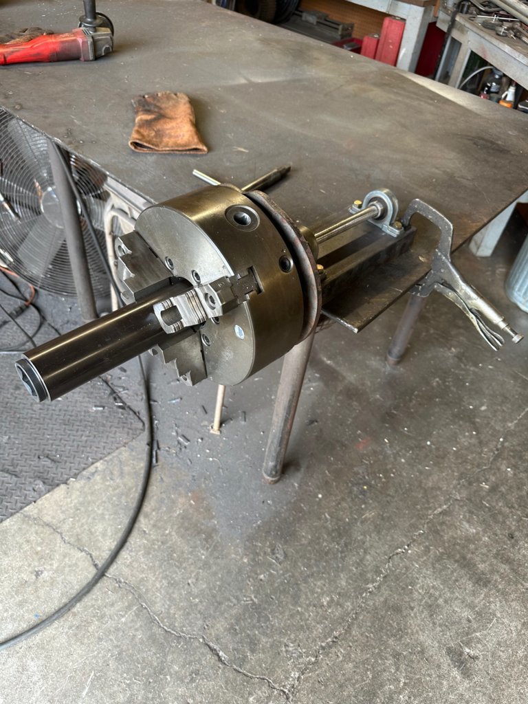

    Saw a chuck mounted to a guys welding table the other day and since I have 40 sockets to weld in some tubing and an old lathe chuck, some bearings, and scrap laying around, figured why not.

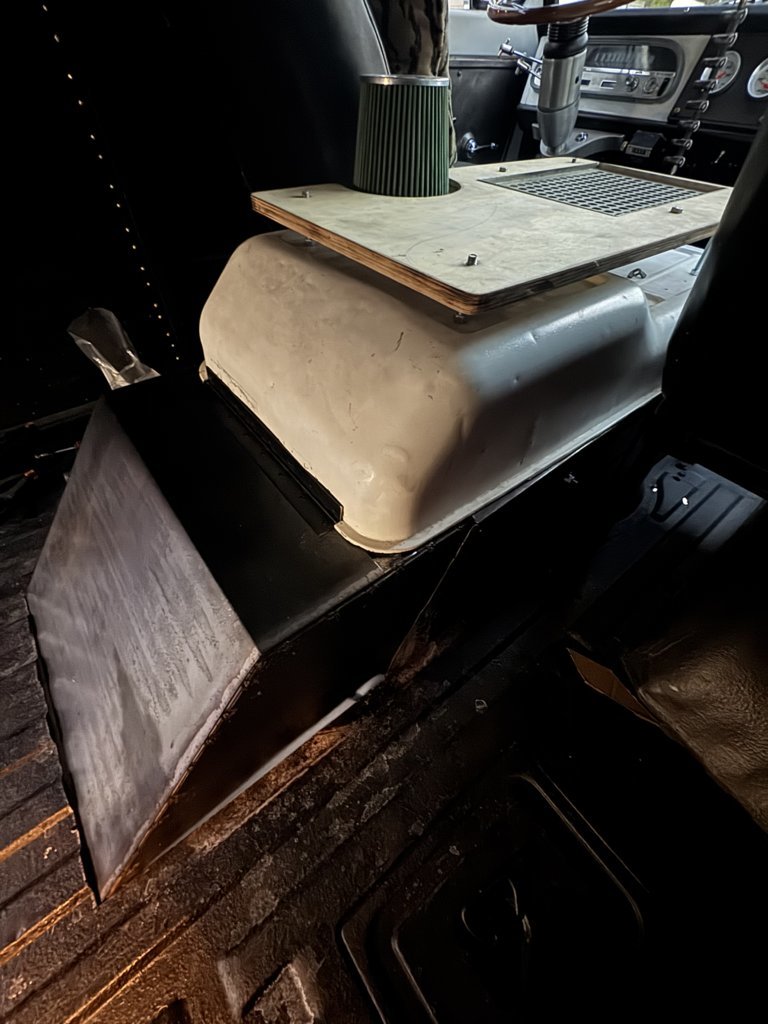

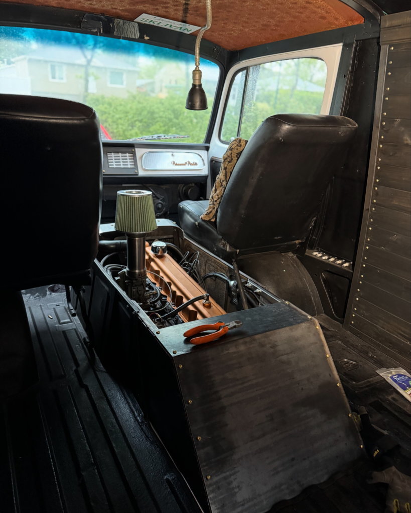

    1st time welder here... Just a 300$ mig welder.
    PROJECT: 1965 GMC G10 Van doghouse fix'n rebuild extension.
    Motor housing was too tight to fit an automatic transmission swap from 3 on the tree manual.
    Built this extension from 1" tube steel and 16g sheet steel. just tack welds for now cause I suck... lol
