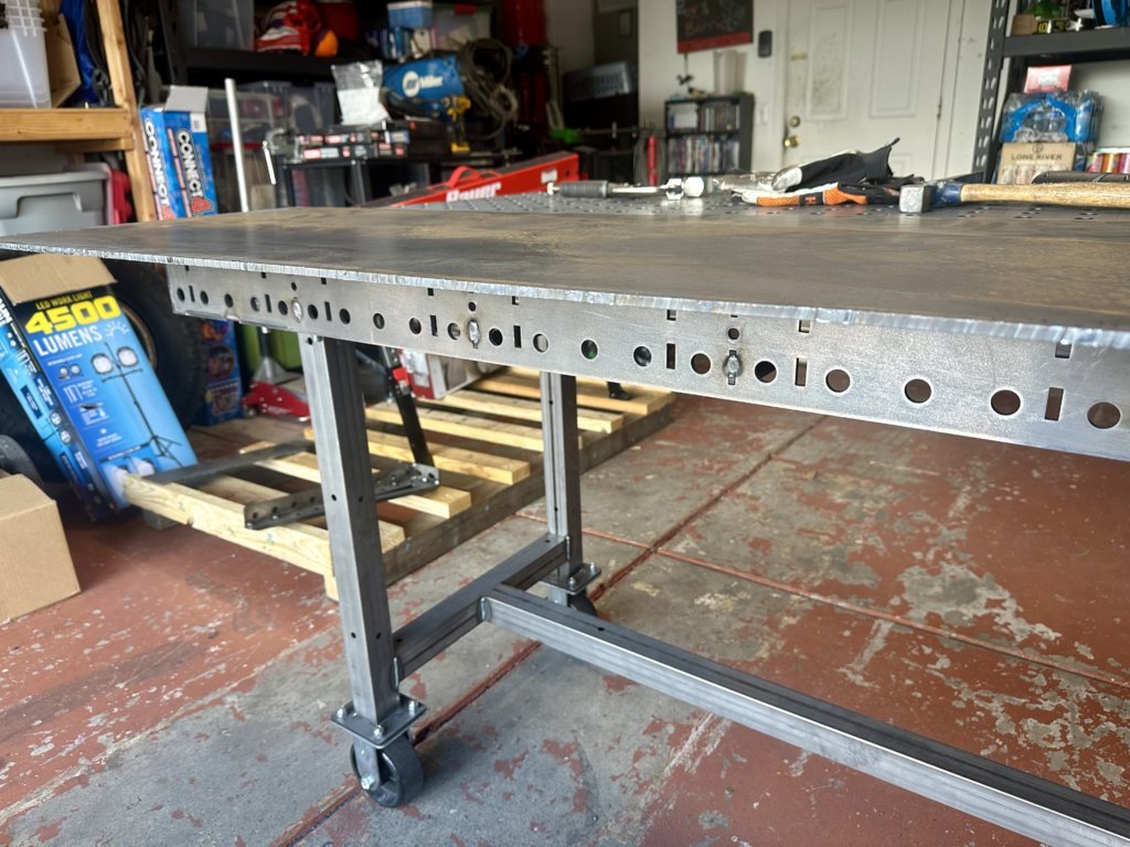

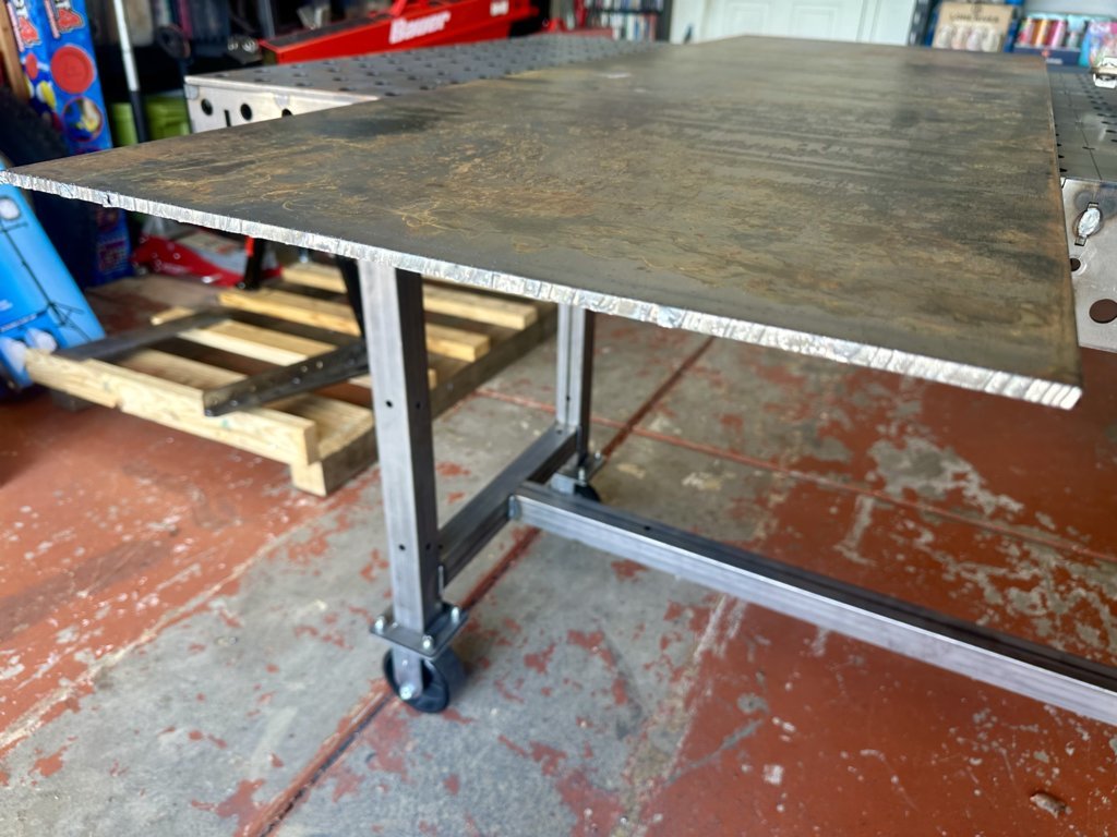

    Got some decent cuts from the little hobo freight plasma cutter today, 1/4” is the thickest I’ve tried on it yet so I’m pleased. Wasn’t maxed out either.
    I booger’d up a few spots but nothing the grinder can’t sort out in short order.

    Table looks good!
    TACOTU3[QUOTED] likes this.

    Sure makes working on something this size a whole lot easier!

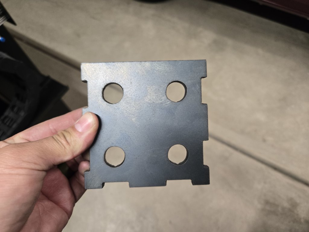

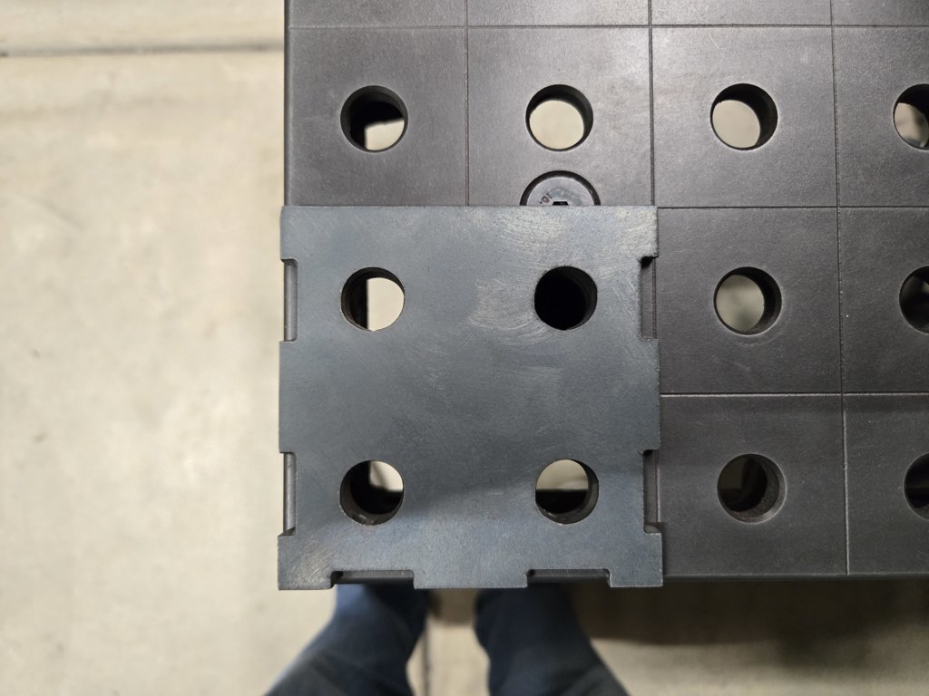

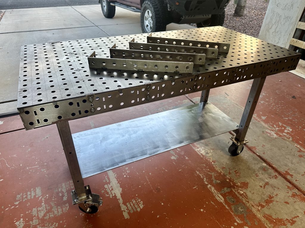

    Also was about to start cutting.
    I did cut this out until I noticed the holes a little oblong; checked my motors and yep one of them had the tiniest bit of play.
    Soon as I fixed that I saw rain coming (thunderstorm) so I shut everything down.
    Thinking I'll just make the holes a little smaller for drilling out, otherwise the overall dimension is spot on
