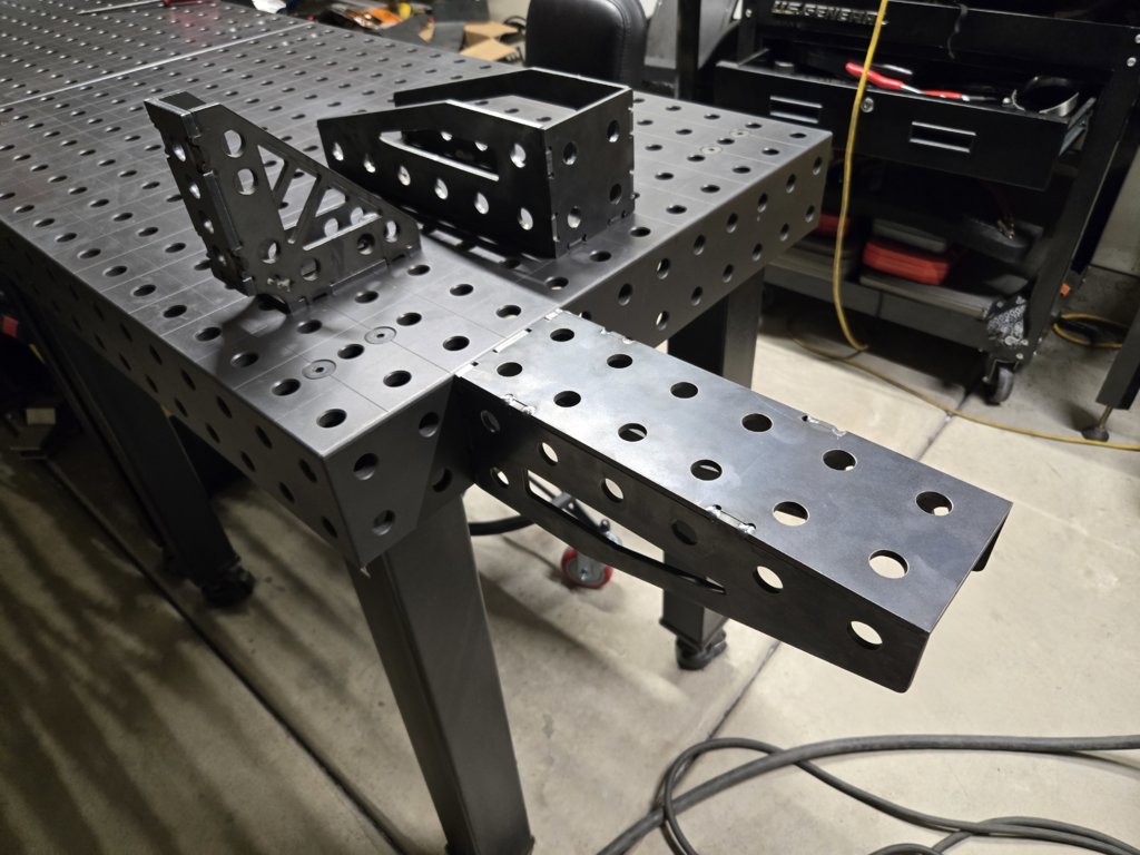

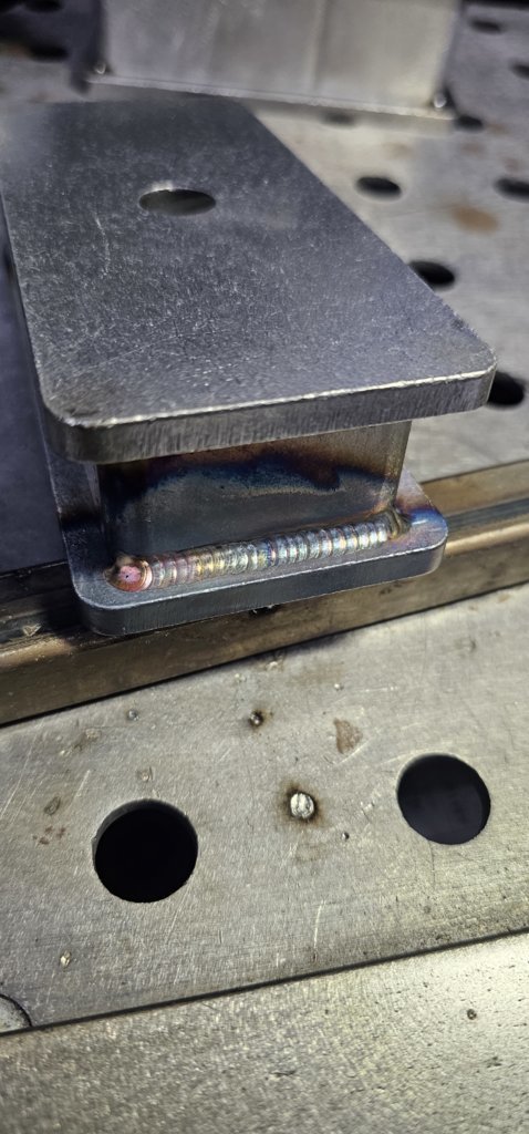

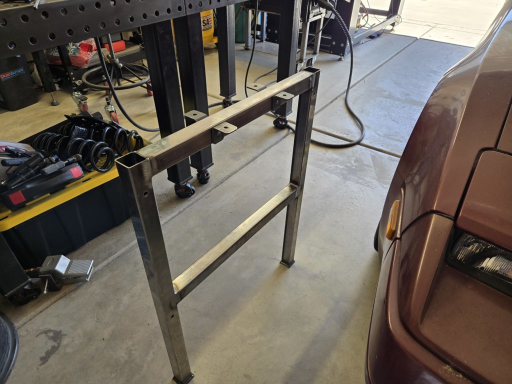

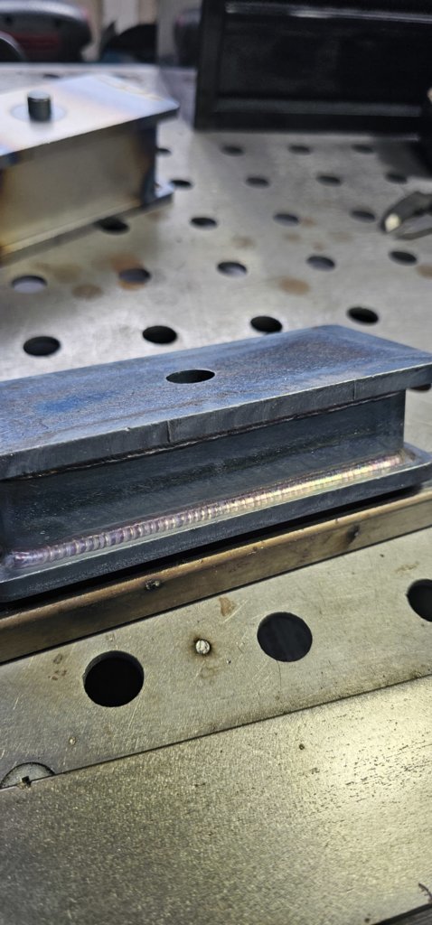

    Since it's been cooler weather out here, thought I'd enjoy being outside this week so I took care of tomorrow's work
    Welded up the 20 tabs on this thing and it's done
    Got some lag bolts on the way which will secure the wood to the top
    Wood top could be finished by the end of the week

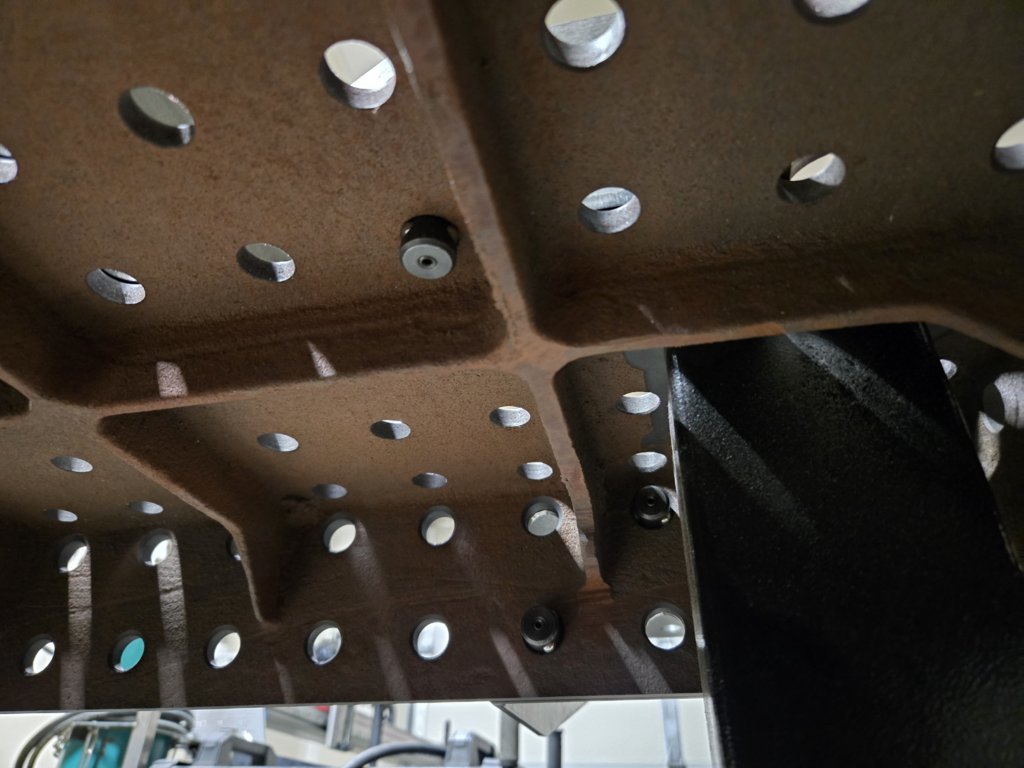

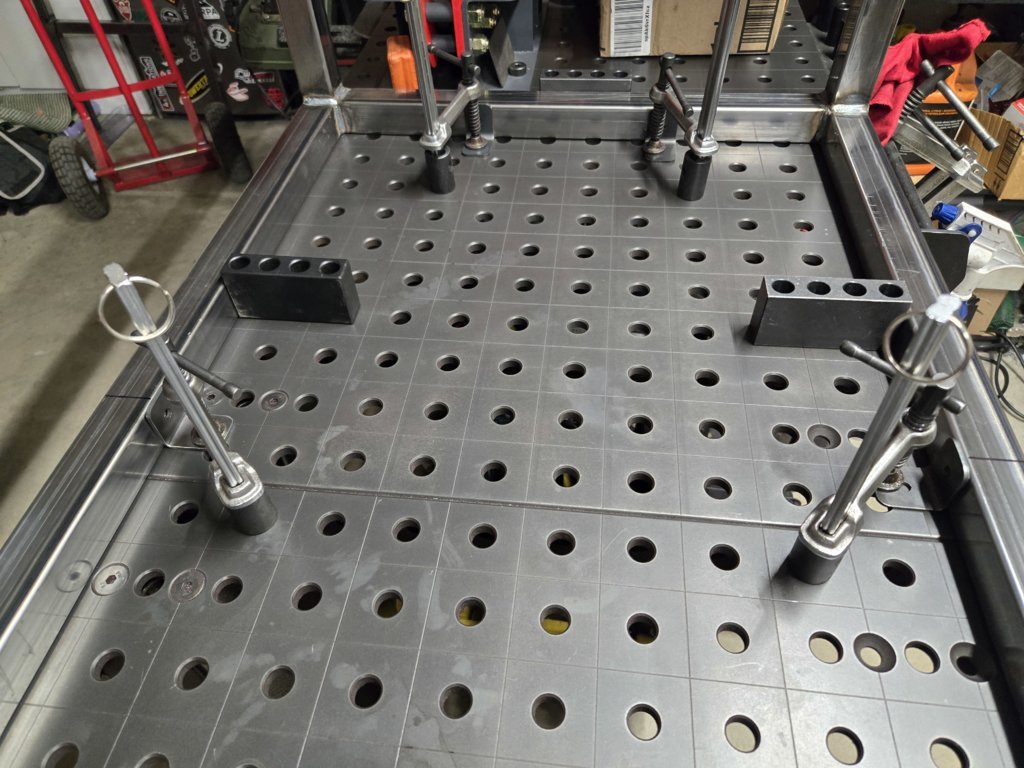

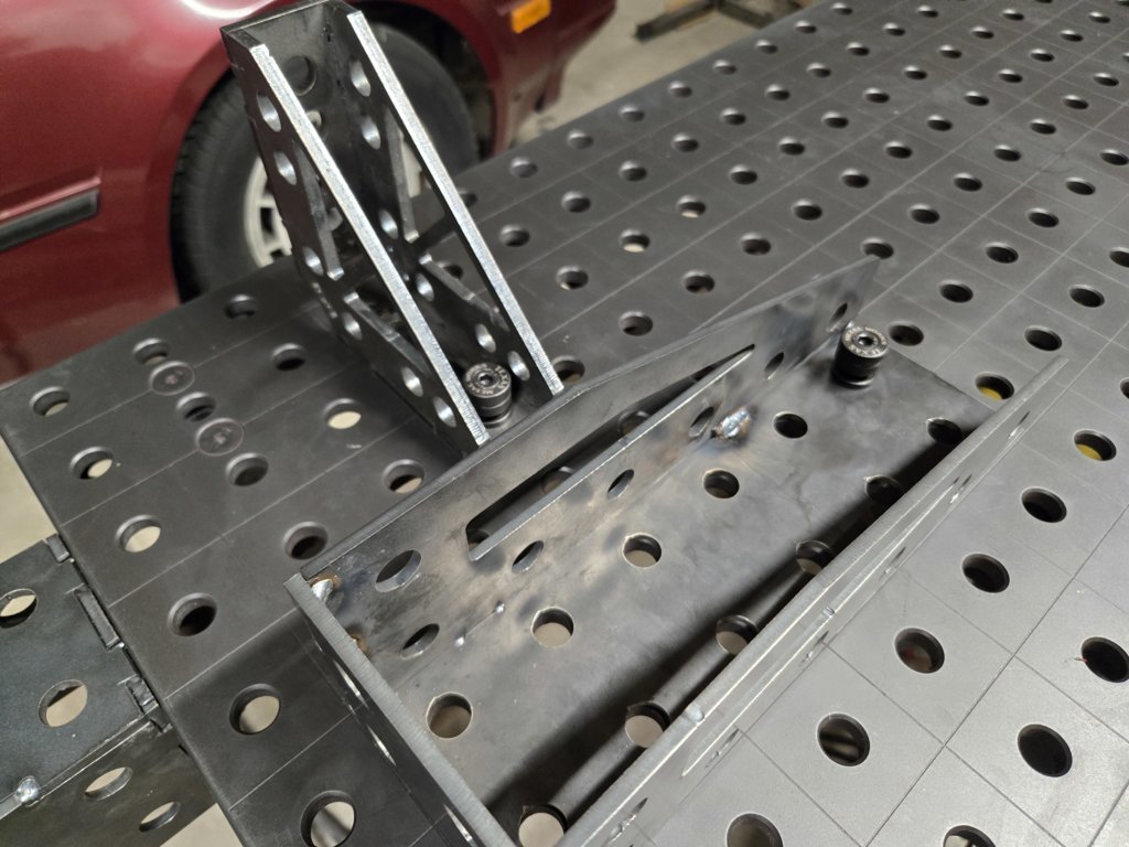

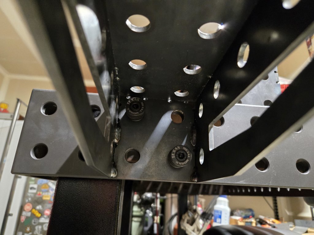

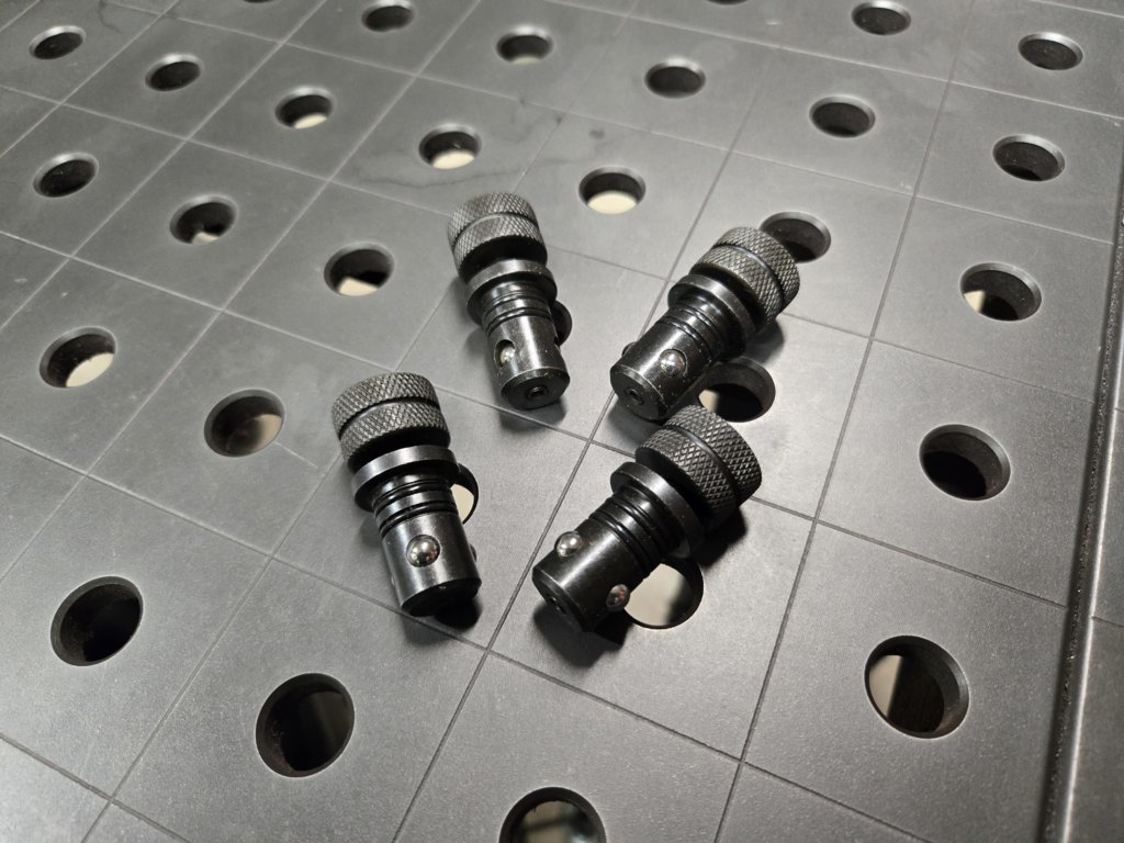

    Took about a week and a half but they're finally here
    They seem to do well holding both 3/16" and 1/4" to the table top, and 3/16" to the sides
    Since the sides are 5/16", it'll be the same as the top paired with 1/4"
    I see Langmuir has a two piece set for clamping down their fixtures but that requires an allen key where this is completely tool less
    Although if you wanted to really make things tight, you can use an allen wrench on top
    We'll see how they hold up given the raw, cast iron underside
    Edit: Mounting 3/16" towards the bottom of the sides doesn't tighten up as much as I'd like. Seems 5/16" measures down at the very bottom edge.

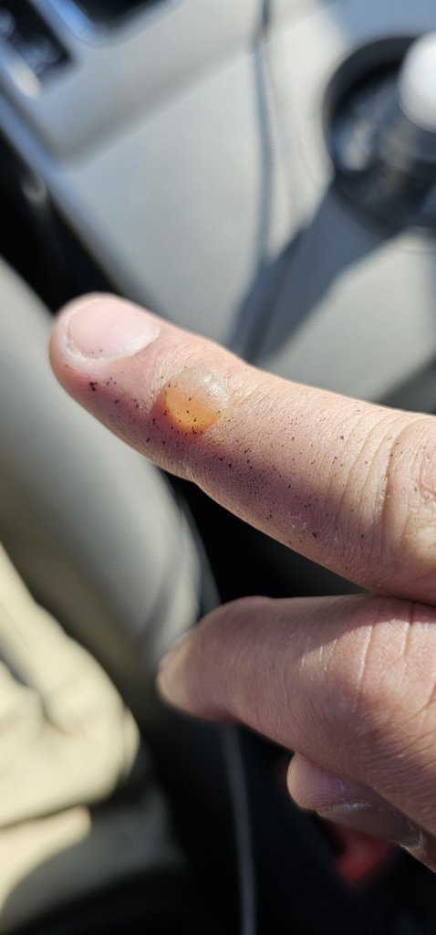

    Guess i gotta change the way I hold the torch lol. Felt my finger getting hot but didn't think it was that hot hahaha. Was wearing 2 Kevlar gloves and a leather glove.
    Welds that caused it lol
  11. Sep 12, 2025 at 2:03 PM
    not_nick
    not_nick Well-Known Member
    Sep 20, 2017
    #230574
    1,940
    keeping jersey dirty
    Do you have a water cooled torch? If so something may be wrong if you could do that before hitting the duty cycle of your machine. If not it's like the best investment a tig welder could make. Game changer. Hard to go back type thing for me
