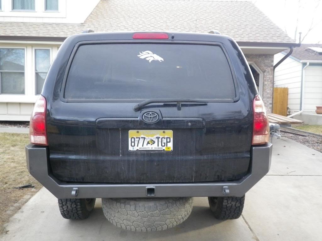

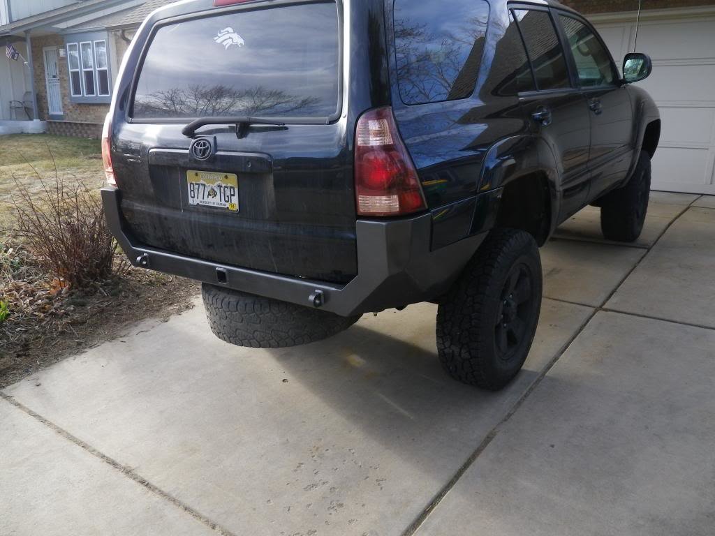

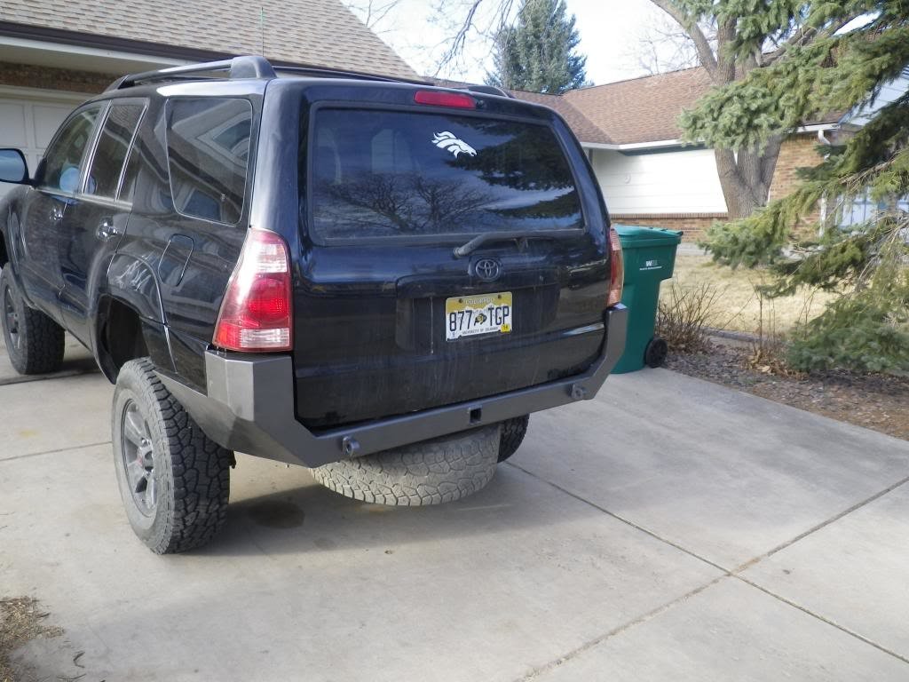

    Bumper complete. Overall pretty happy with it being my first welding and metal work project, fit is not perfect, and some of the welds are not the prettiest, but I learned a ton and will take that knowledge to the front that I will start on next.
    I was able to retain the spare mounting system, it sits on the welded in crossmember in the rear, and while I wont wheel with a tire mounted down there, it will work for road trips, and it will fit inside for offroad adventures until I build a hitch mount tire carrier, and eventually add a swingout to the bumper itself. Plus I could probably fit like a 37" bogger down there LOL, the limit being the width inside the frame rails which is 39" IIRC.

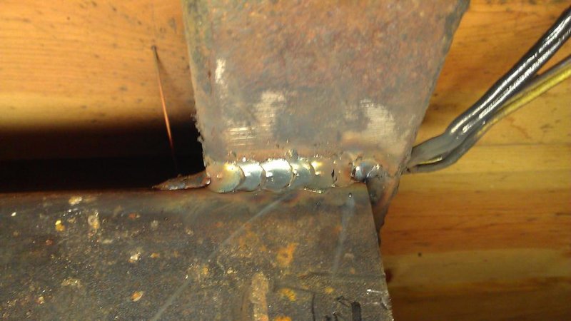

    Here is an overhead weld I did yesterday. Had to replace the tongue on a utility trailer. You can see the stop/start methods I spoke of.

    koditten
    koditten Well-Known Member

    You got that right. After a coat of paint, it doesn't matter. All I care about is good penetration.
    I was just trying to show my style of overhead, mig welding.

    Man I wouldn't trust that weld. Pretty much all you did was tack weld it a couple of times. Especially on a trailer that will have weight on it. If that broke on the highway...
