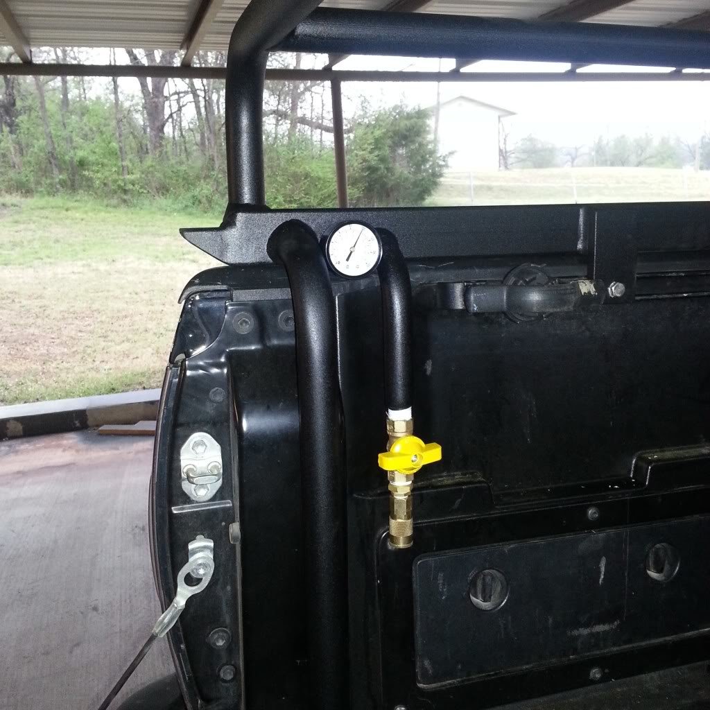

    Finished up my bedrack/ air tank today. Mt Rainier will be going on it tomorrow

    That's awesome, I thought about trying to do something like that when I built my bumpers, but decided that getting it leak free was going to be a PITA. Do you know about how much volume you have?
