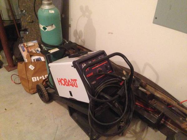

    Picked up a Hobart 175 today. Once I get my 220 plug wired I'll be in here to get advice on setting it up. I'm still trying to figure out wire speed and heat from looking at the weld.
