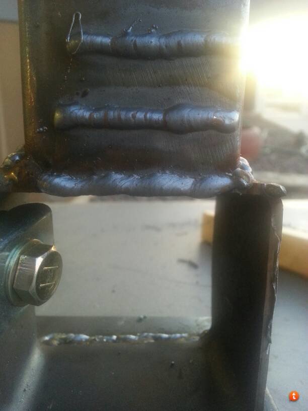

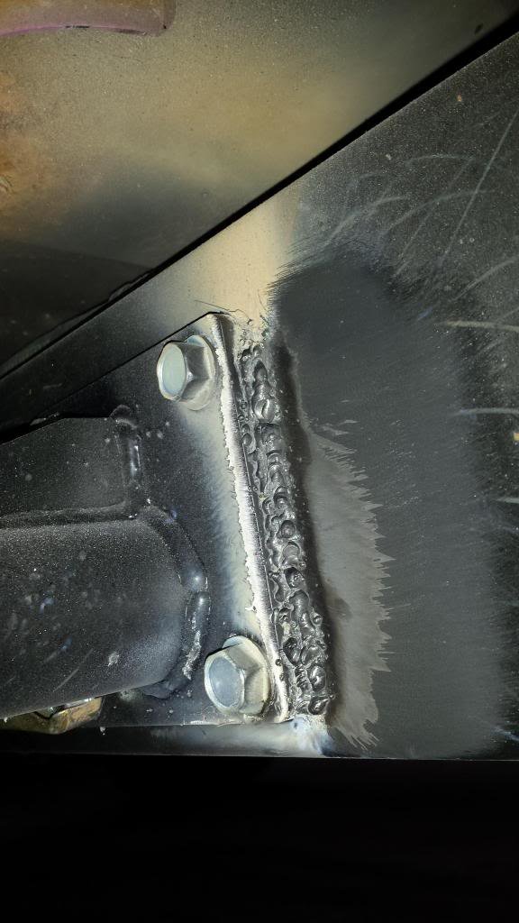

    Well picked up my welder again for the second time. Here is the product. e3eba6u6_a4bd95895ef9b81193b7b5555db4eb91d3193762.jpg
    Stacked it on another weld.

    a little more heat. pause in the toes a hair longer to get full fusion

    Thanks man. I can only try to get better. I have a lincoln 180hd with 75 argon 25 co2

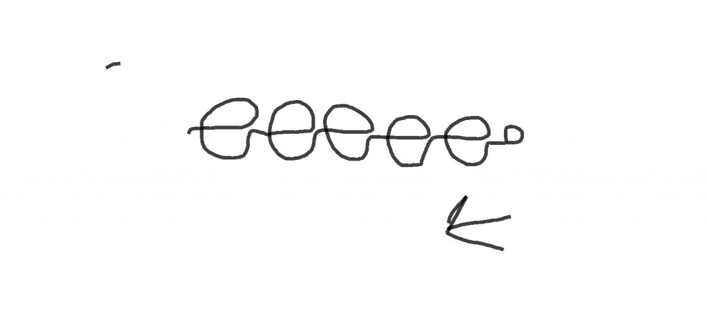

    youre on to a good start. im gonna attempt to use paint and show you the gun movement that i use

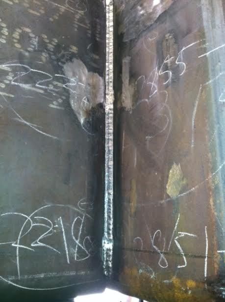

    thats a alright machine and perfect gas. Need to jack that heat up.
    This is from a hobart 210 mvp 75/25 gas
  11. May 9, 2014 at 6:48 PM

    this is the manipulation i use on horizontal welds, but i found it works good on flat welds as well.
    wish i had some pics of welds ive done like this, but they look damn good.

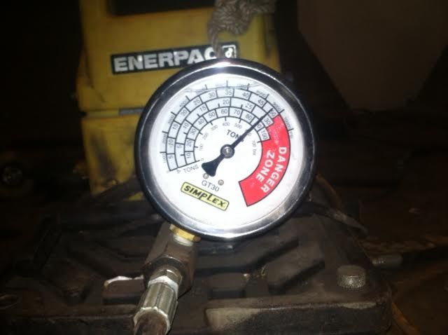

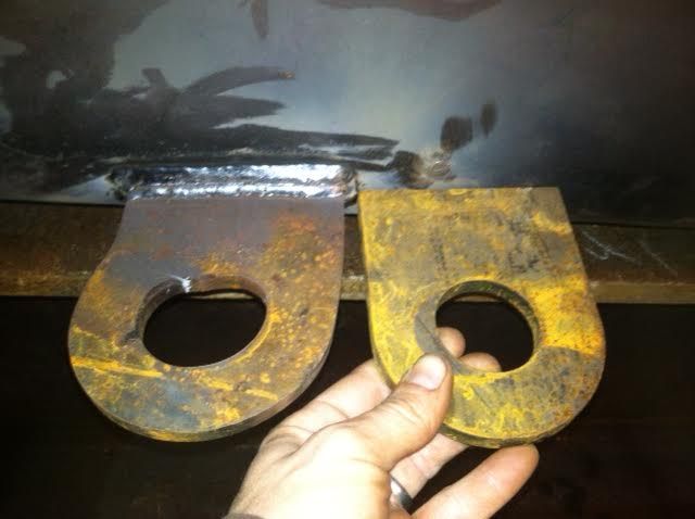

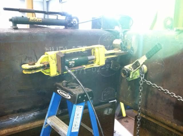

    1/2'' weld. vert one in two over on 3/4" plate
    50 TONS of pressure
    one this spreader bar
    hooked to this 3/8" pad eye 50 tons of side ways force. got a lil rip. number dont lie

    Yes, they are bolt on an would probably be fine without welding. I know my welds suck and I have a less than adequate welder but I have to learn somehow. Oddly enough, the welds on the bottom of the flange (no pics) are even, smooth and flat. It was the vertical welds that owned me.

    just showing how strong steel is Kase.

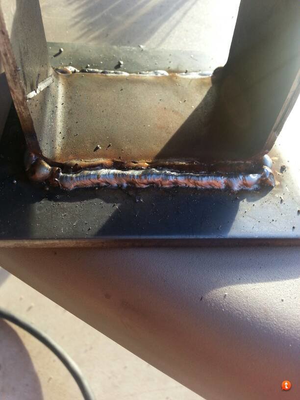

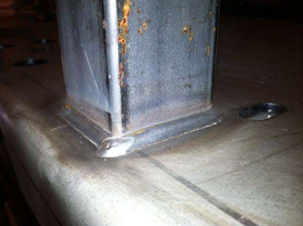

    I still have a lot of practice to do Stil. me2upeve_7532c308034d98d1d9f6c61ef44c72bffacfb40b.jpg
    Can't wait to start building shit.

    It appears that the weld between your frame plates and tube are too cold as well. Proceed with caution

    Is your polarity set right? Usually with flux core your ground should be negative.
