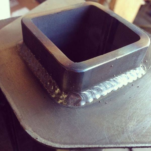

    Meanwhile, here is some flux core welding I did this week. Hitch receiver on one of our work trucks. This was done with a Home Depot Lincoln.

    no dual shield?

    Yeah, that's really clean for flux core without added gas.

    No gas.
