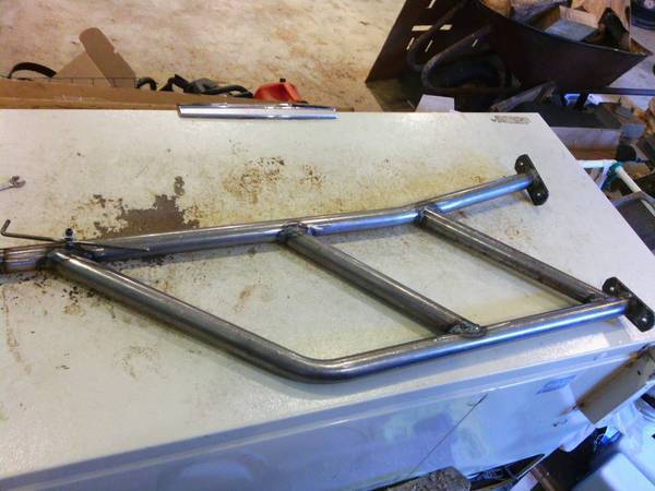

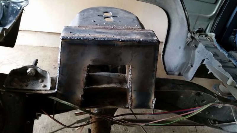

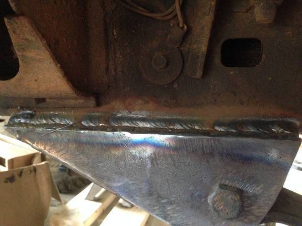

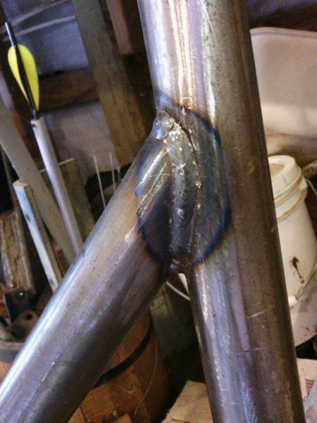

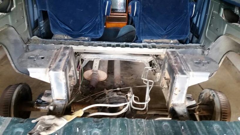

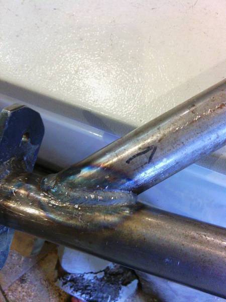

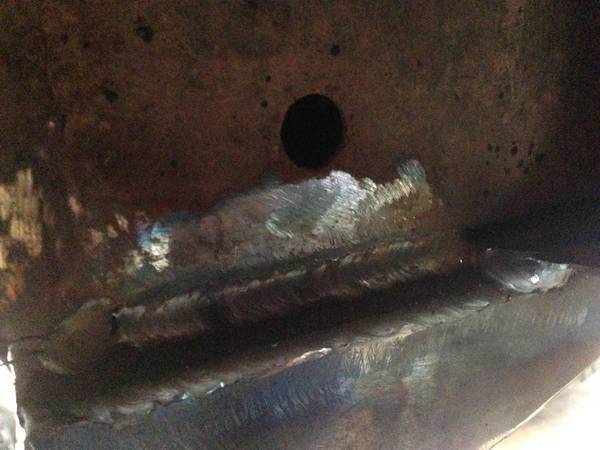

    Here's a few welds from a project I'm working on:
