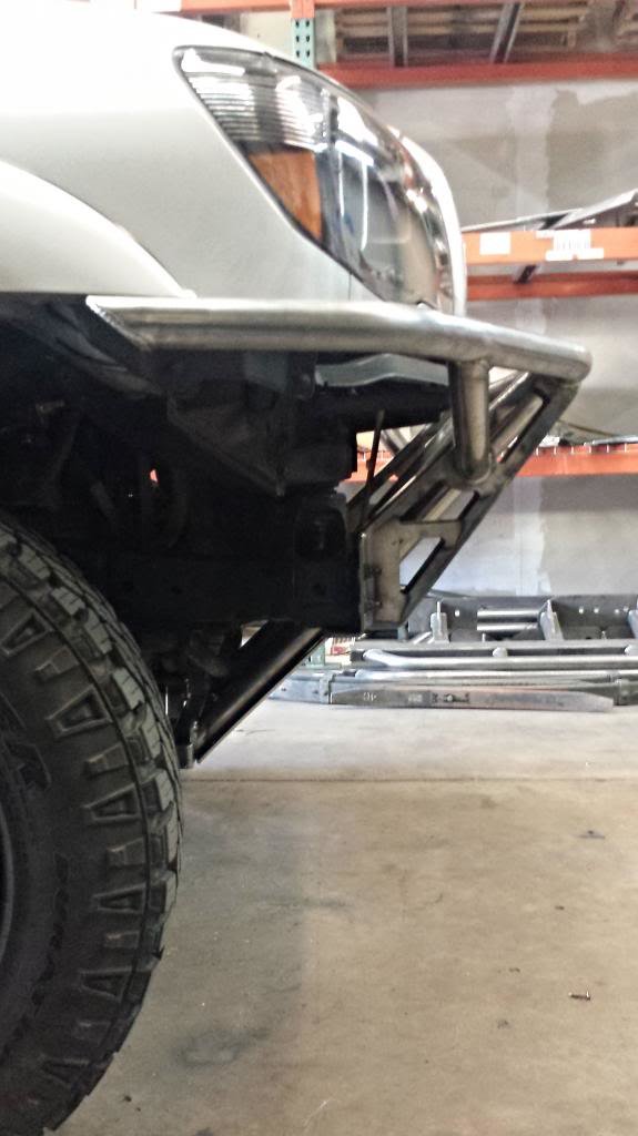

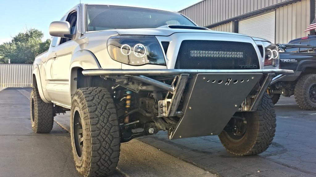

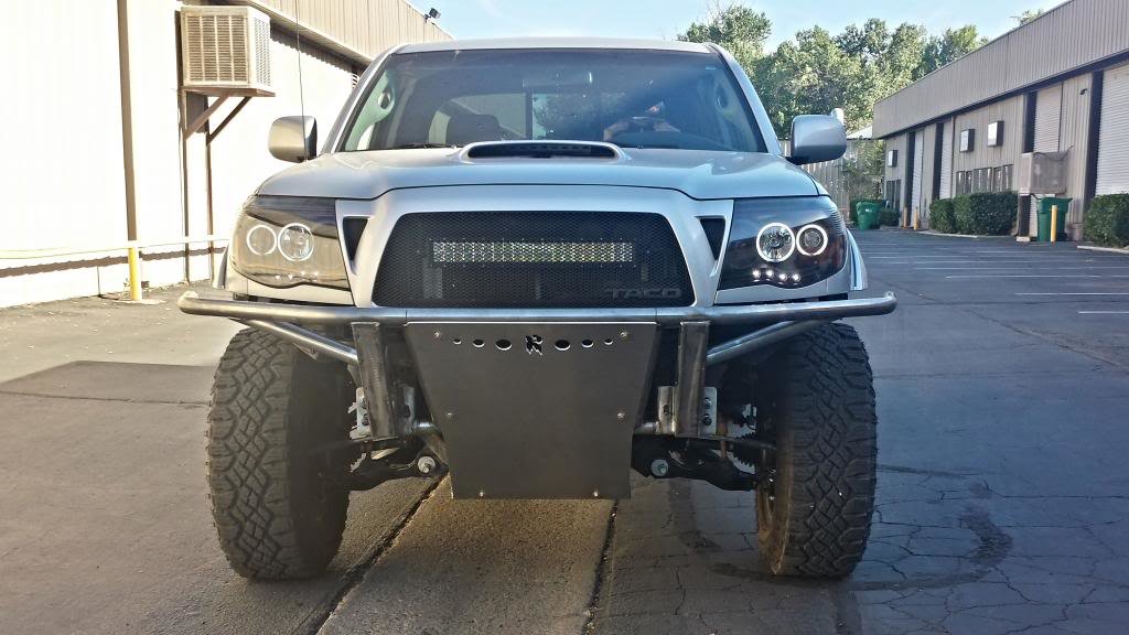

    Looks good. I'm not a fan of the LEDs behind the grill either.

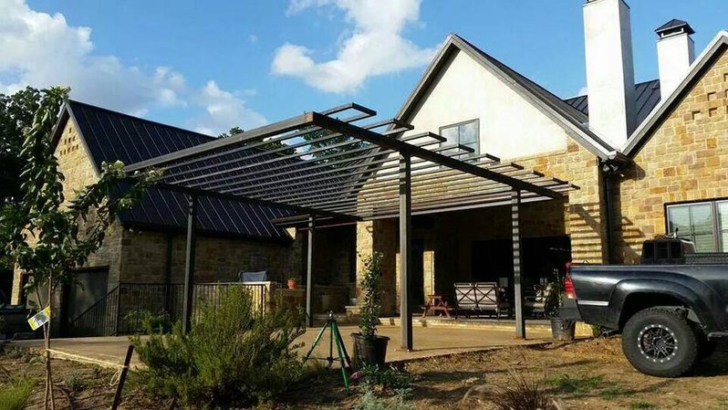

    Pergola I built all finished up

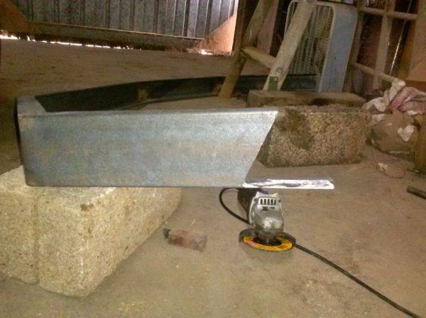

    So i 60° the ends and bent the bottom up to cap the end. It sorta went like i thought but there was a half inch gap i had to fill. Used a 16 penny nail and some 7018s to fill the inside. And made 3 passes with 7018s on the outside and ground it down, this is as good as its getting, caulk and paint make it what it aint. Oh first attempt at vertical uphill with 7018, it sucks for those who dont already know.[​IMG][​IMG][​IMG]

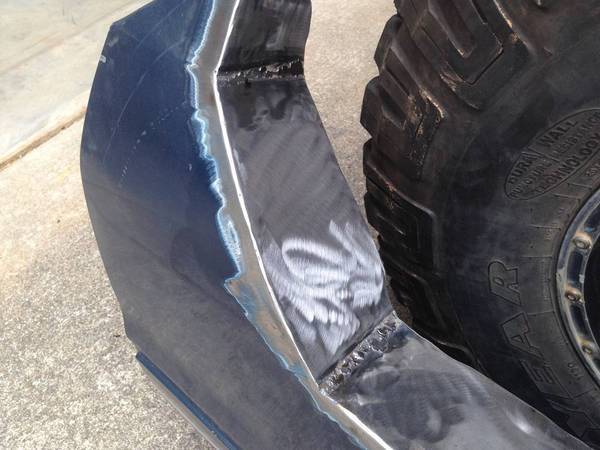

    So to you metal workers with more experience than myself.. how can I smooth/blend these welds? Flap disc wont get in there. Thanks in advance

    An air angle grinder, or a 7" maybe. But it might not be an area where any grinder can get to and you kight have to deal with it

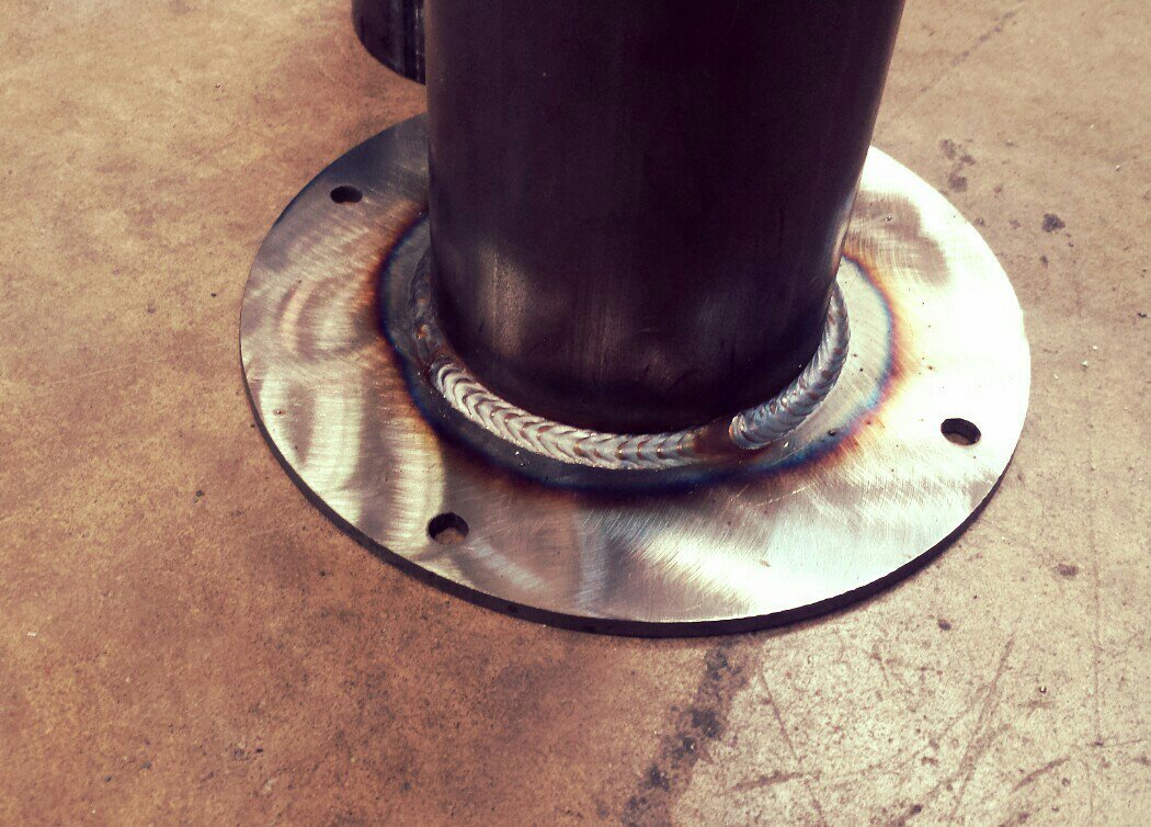

    Some flanges I cut on my cnc and welded up for a carpenter. They're restaurant table pedestals. usuvy6uq_be1d93961bf0e47689e06b9c92e0fb08e1631df3.jpg

    Why you need to flex that inside weld for? Get a flap wheel drum and run on a die d
    Grinder
    Holy hot! Look really good

    I like running a little on the hot side. :cool:

    I tend to myself. I got custom to back stepping while welding

    That's pretty much what I need. I tried to use a regular flap disc like that.. didn't work too hot haha.
    Trying to work with the tools I have. No die grinder or any air tools for that matter :(
    That's what I was thinking of trying. Have one of those cone shaped stones I could use

    Get the thicker flap wheels and force it in there. Sometimes the plastic will get it done hehe lol

    Haha smart ass. It's 22 guage sheet metal. It was an absolute bitch to weld at all. Should have gotten some thicker metal and some to back it with but you live and learn right?
    Dont want to round the corners

    Fiber disc. There's always good old fashioned hand tools:cool:
