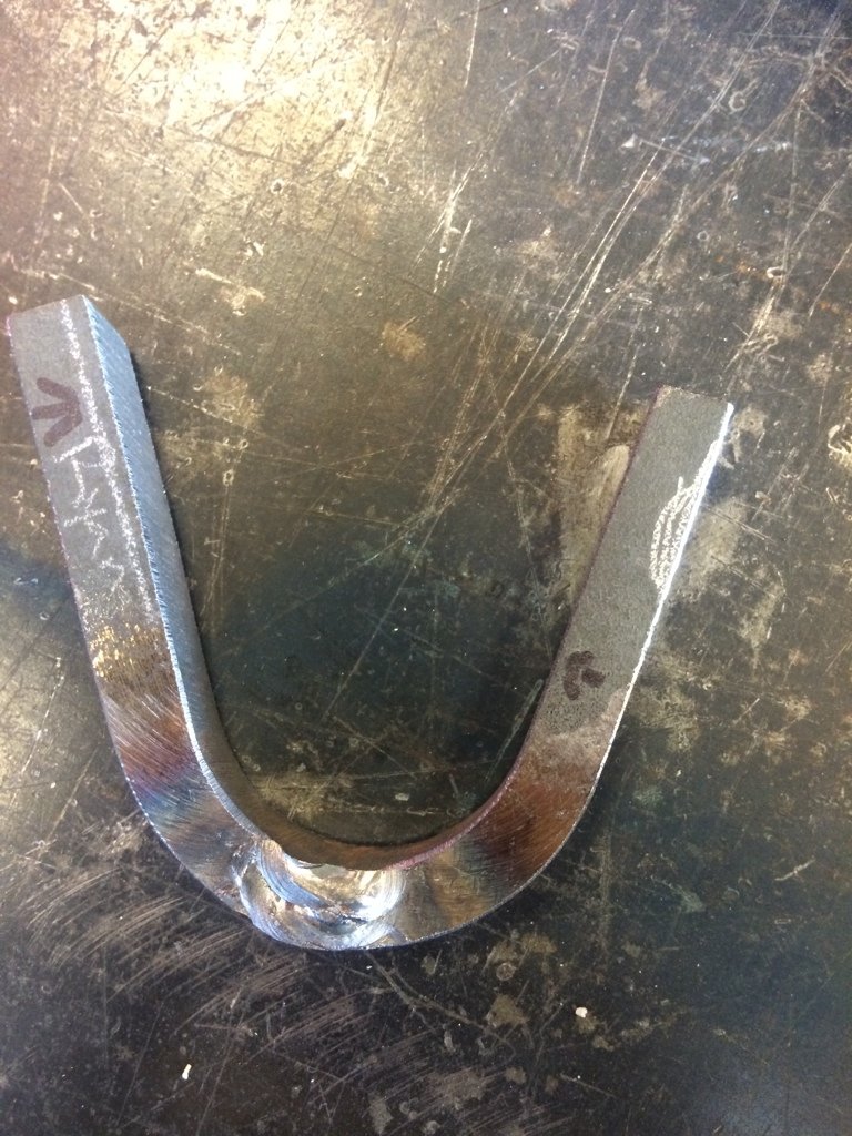

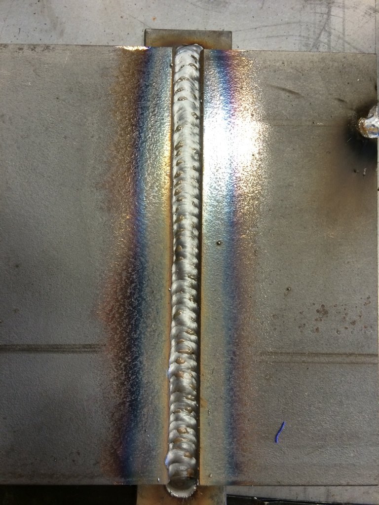

    Got a couple pics of my attempts at 3G. 3/8" base plates 22.5 degree beveled, 1/4" gap, 1/4" backer. These are before the cap. They aren't the best, but I'm getting more consistent. I'm having trouble laying a cap without undercut. I need to pause longer.

    Uphill. Pics might be upside down.

    For the AWS test you can do it in either 2 or 3 passes. I get enough fill on my root that I can only do 2 passes. The weld can only crown 1/8" max over the material and 2 passes is perfect for me. I just need a tad more pause on the edges to melt the beat into the base material so it doesn't undercut. The part has to be under 100 degrees before running a cap.

    I have only ran a mig for a couple hours but ur up hill looks as good as my down hill if that means any thing to u

    I just need to pass this uphill 3G and 4F and I have all my certifications. Then it's on to underwater welding I guess.
    Yep. 7" vertical, you can start and stop in it, or do it all at once.

    I wouldn't dip anything I'm going to be tested on or bent in water. Only on practice pieces

    This! Quenching a weld is a great way to fail

    That you have. If you have an inspector watching you test, they'll fail you without even testing the welds.
    Also, water quenching can result in some wicked burns. Saw a dude get de-gloved when he dipped a piece of 6" pipe in a tank of water. The water went up his arm, down in his glove. When he pulled his hand out, there wasn't much skin left

    :woot: I got my weld test results back and I passed both 3G uphill and 4F first try. I was rather pleased considering I basically taught myself how to weld with pointers and YouTube, and the other employee that paid thousands and went to school for 2 years for welding failed both of his first attempts.
    So now I'm AWS certified in 1-4G and F.

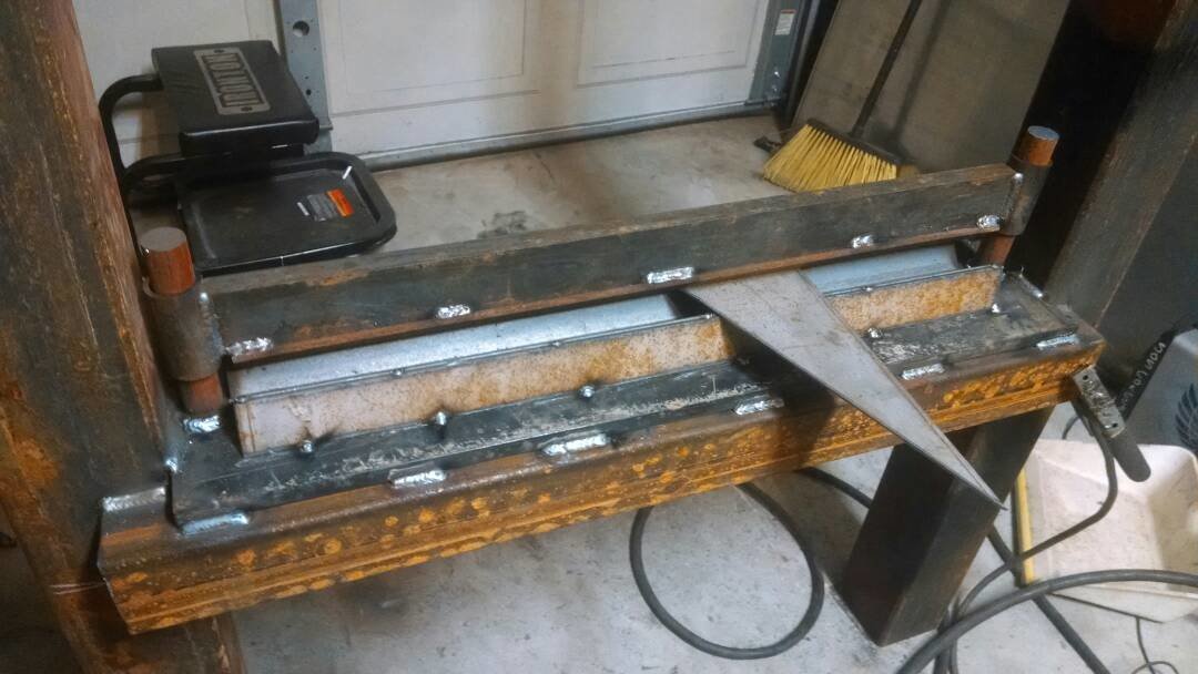

    The start of a home made breakure8e3u5_fd20ae5401cf4f6829e426d390a49c54fd105f16.jpg

    Is that swag off road die kit thing they sell?

    Nope got all this steel at the scrap yard for $40. Im hoping to bend the full 25"

    Looks good just maybe a little more meat on the punch and you should be golden. I have the SWAG kit and its awesome. Just make sure you have the punch tall enough to not deflect under pressure.

    Thanks man. I should get the jack tomorrow

    Ahh I see that angle iron now. I've tossed around the idea of getting the swag off road kit and a big ass press.

    me too for months. really wanted the 40ton but altogether i wasnt about to spend like 1000 plus
