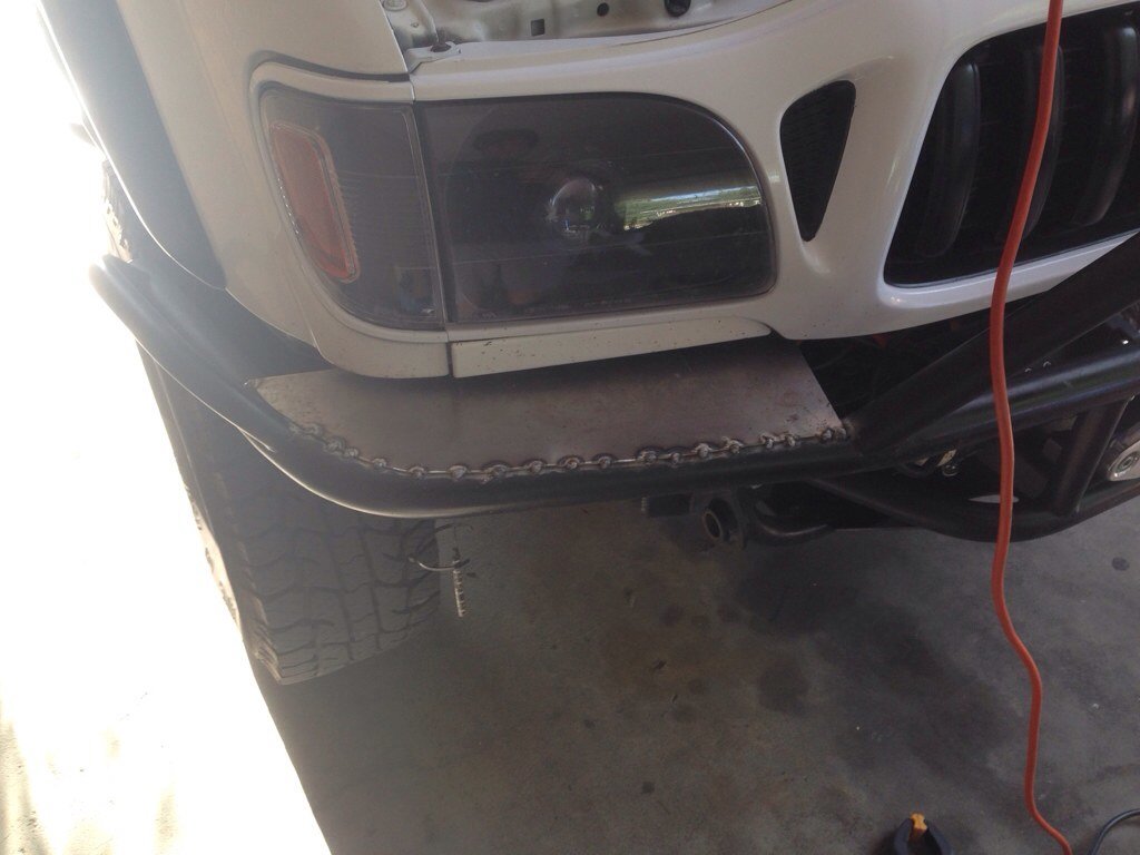

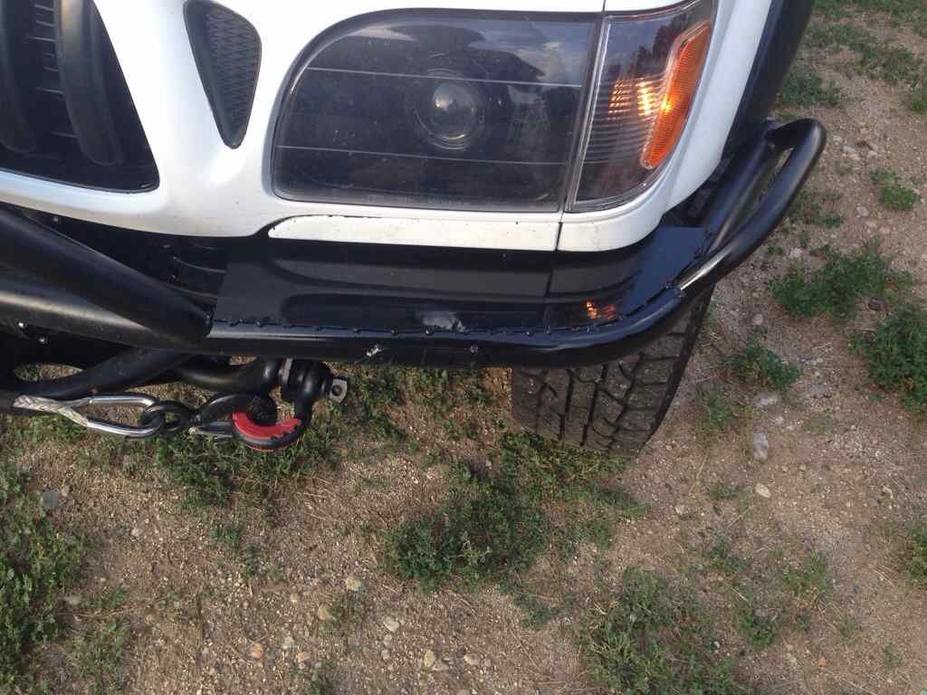

    Pretty much stock with some crap welded to it.

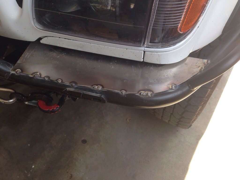

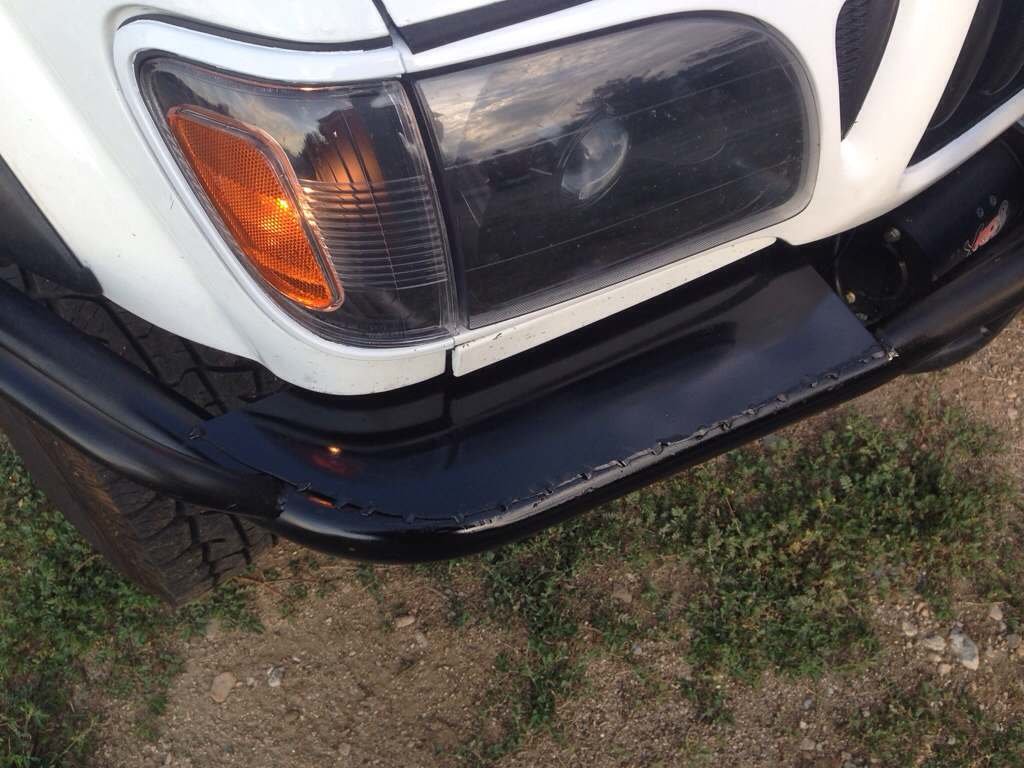

    Made some filler plates for the all pro Baja bumper, came out ok my welding was alittle rusty and I attempted to do a stitch weld kind of thing but not sure if I love the look, I love how they finish the top of the bumper though,
    Sorry for the bad cell phone shots

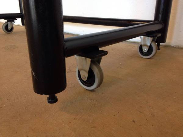

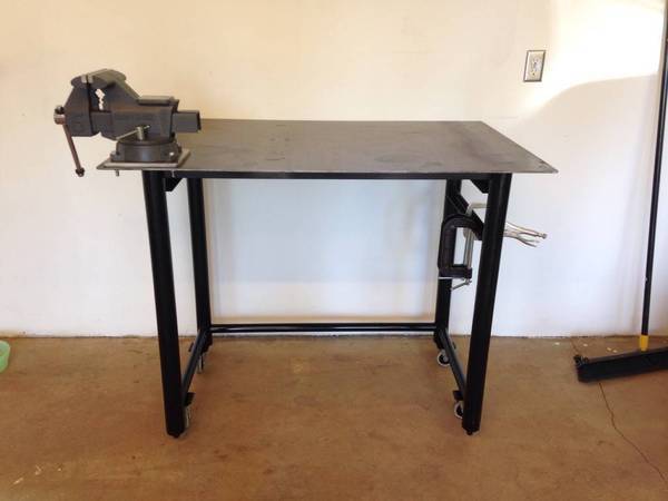

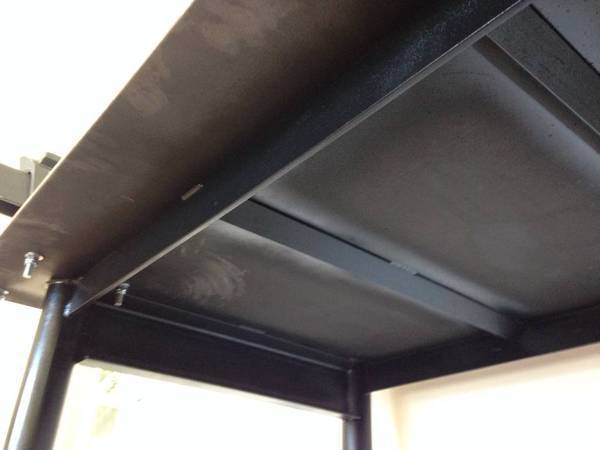

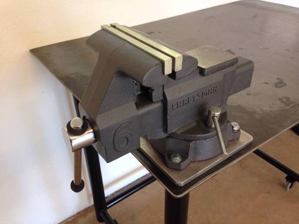

    Finished my new welding/workbench table. Wanted to make something heavy duty but easy to move. 48" x 32" 1/4" carbon plate supported by angle, 2" x 1/4" flatbar, and 4" x 1/4" channel. 2" sch 40 pipe legs and 1" sch40 pipe spreaders. Legs are capped with nuts welded to the inside. Still need to order leveling feet from McMaster Carr. Right now just have 1/2" bolts to level out the table and raise it off the castors.
