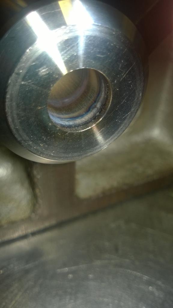

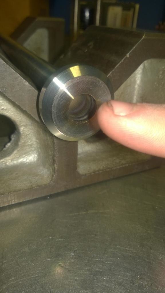

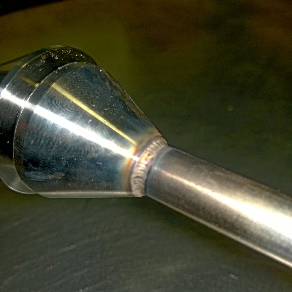

    Some itty bitty stainless welds from today

    badass :cheers: what is that to ?

    They are stainless sanitary fittings for resturaunts, food production etc. Sadly most of what I do is on a rotator and all the welds get polished away. I only post the free hand stuff.. These were filling rods so I assume they come off a main tube to bottles or something similar to fill with liquid.. theyre super tiny.. its all 1/16 tungsten and filler. Those tubes are 1/2" diameter :eek: pretty fun to play with stainless though! Got a few personal projects lined up to get a lot more time under the hood :cool:

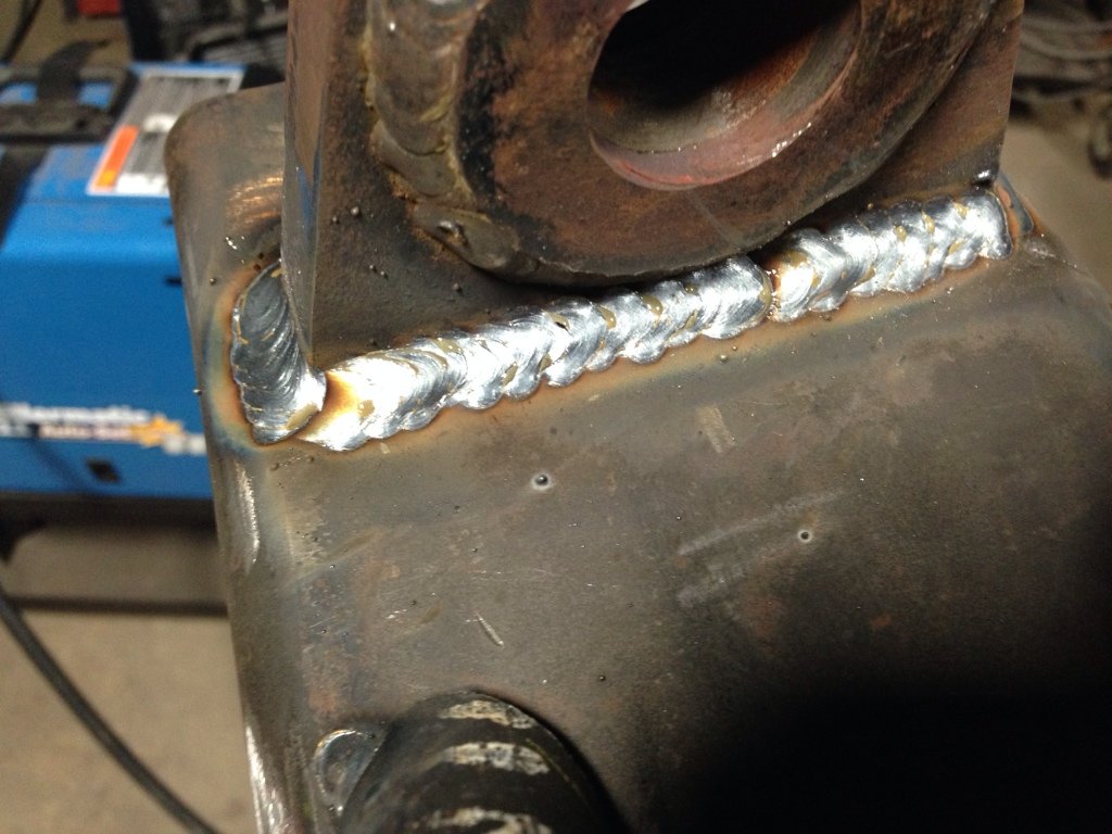

    I'm on my second welding project so I'd like some feedback on my welds. This looks good to me, any suggestions for improvement?

    Clean your starts and stops, get them to flow together vice piling up, and turn your heat up or dwell longer on your weave...There is some undercut

    So the undercut is probably due to not dwelling long enough on the edges, or the heat not being hot enough, correct?
    I didn't know that I should be cleaning the start/stop before continuing with the next bead. I'll give that a shot.

    Yes those are reasons for the undercut.
    Always a good practice to use, if you lift the torch clean the weld.
    And no problems, that's what the forums are for.

    Do you have another welder that can watch you? If you do, they should be able to tell you if it's heat or technique, or a combination of both.
