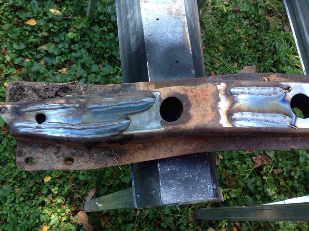

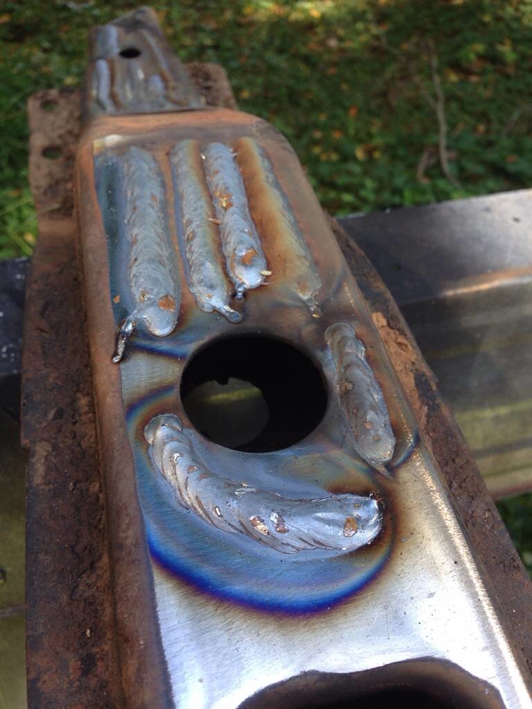

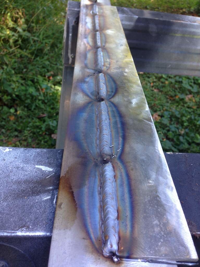

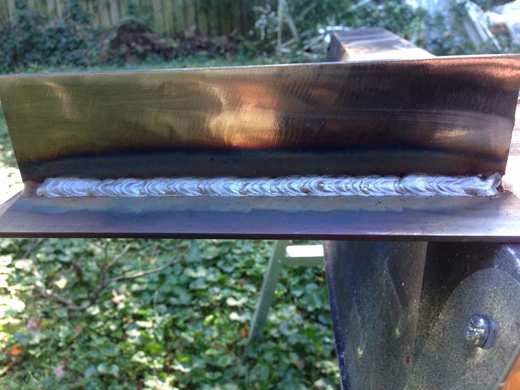

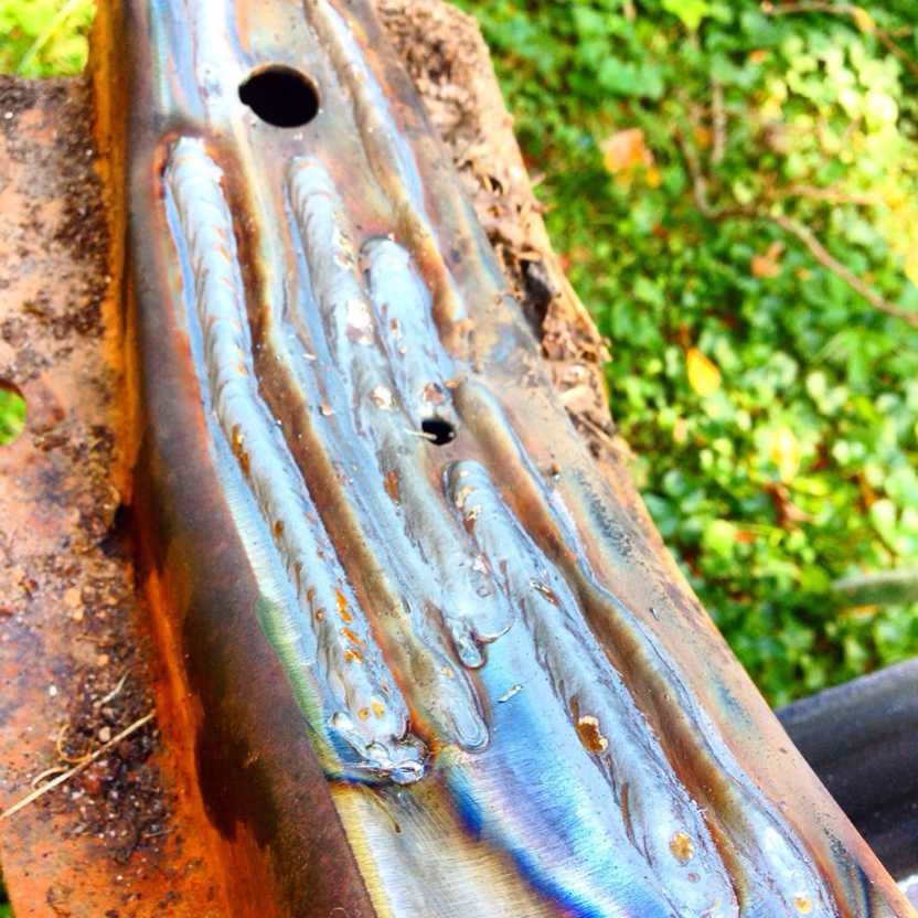

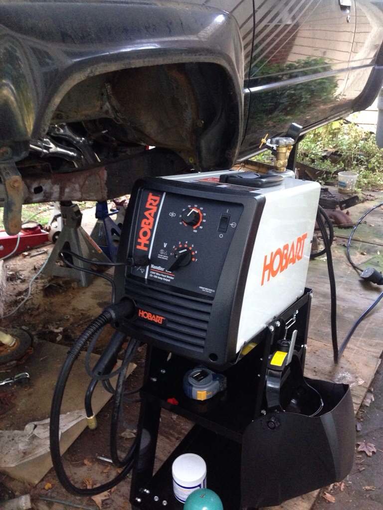

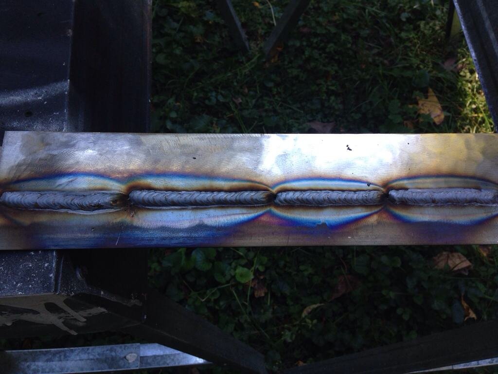

    Got a hobart 190 last week and started playing with it yesterday. Never welded before. Studied weldingtipsandtricks.com.
    .030 wire, 75/25 mix. Started on a scrap crossmember
    Today's practice, a T joint and lap joint. Tried V's and cursive e's. Very happy with my progress and it is fun!
