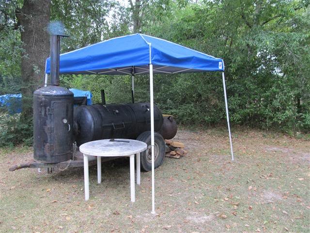

    Example of my work,
    DSC09829Small_bf4342ce5a40208b25a6307eddc9b894526746a8.jpglabor-day-cookout-032011826_e7cbc54bbd9ccfb014d3a1d20a0c7a8bab692dc0.jpg

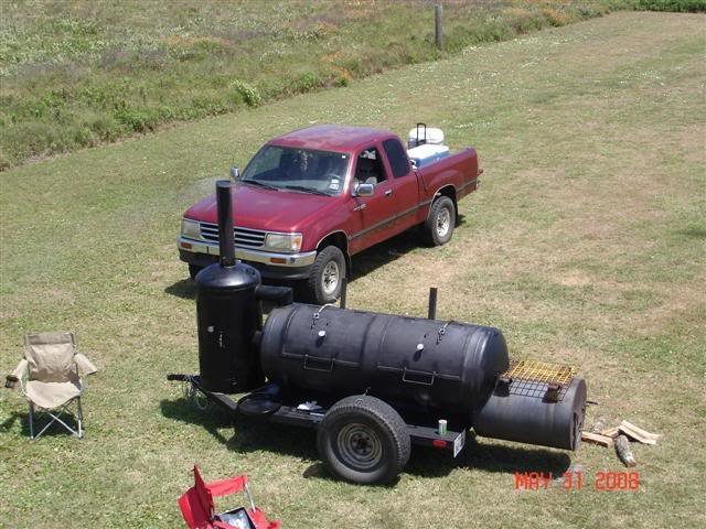

    Here is my welding setup. I was tacking a section of cattle panel on the chicken yard gate.
    I just load the welding machine and generator in the back of my truck and drive to wherever I am going to be welding at.

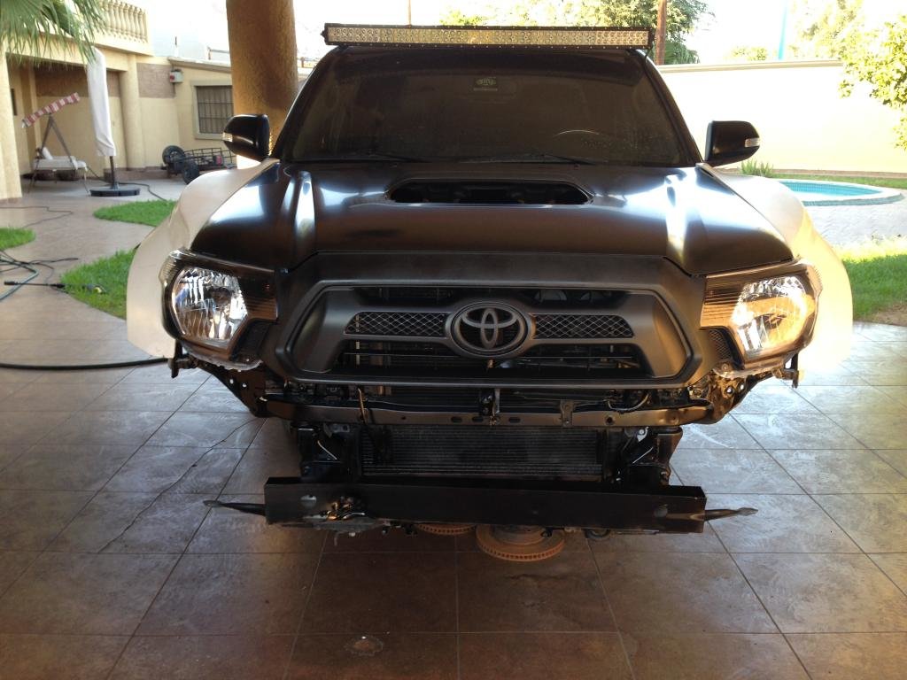

    Ill do all the welding at my garage, this is how it looks like:
    Also plan on getting a flux/MIG welder so I can flux first and when I get a bit more $$ buy a bottle for cleaner welds. I don't care much right now as Ill powder coat the bumper soo...
