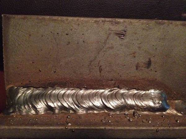

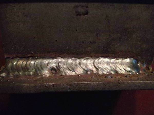

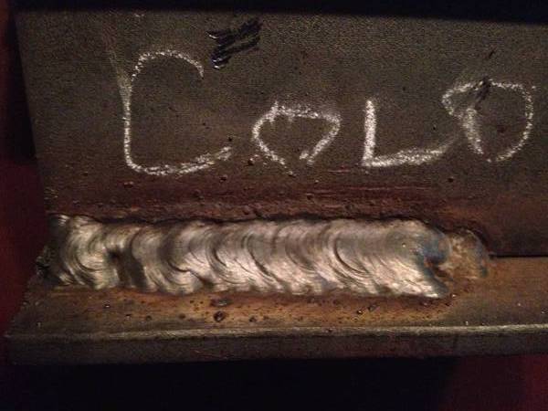

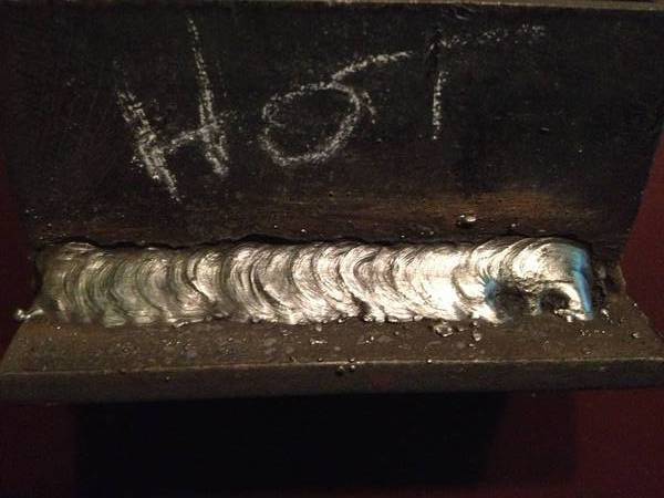

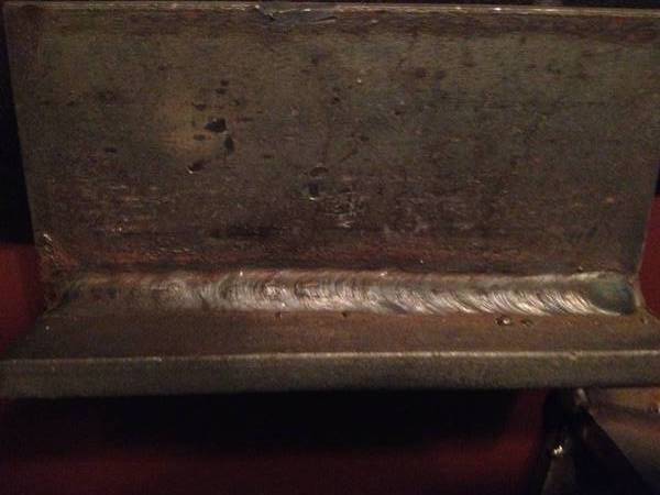

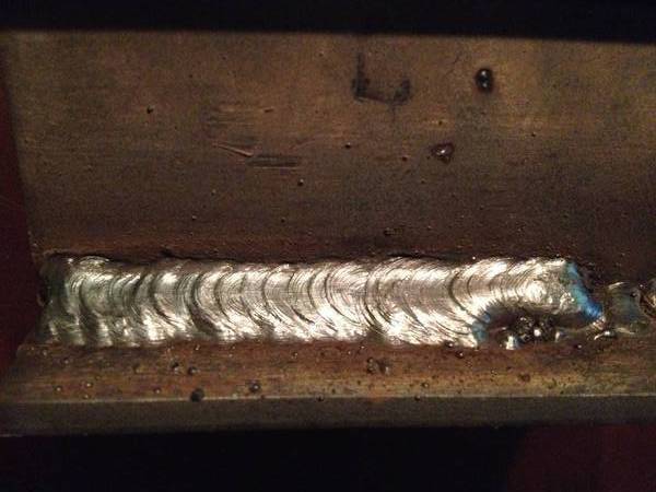

    So Im looking for advice...
    Im taking a class and Im currently attempting t-joints. Welding horizontal but the T is vertical if that makes sense. I can run a stringer as a root pass just fine each time. The instructor is very pleased with that. Tells me my angles look good and speed is smooth while penetration is solid. However, when I go to run my weave over the top, Im getting undercut along the top or vertical strap.
    1/4 x 2 strap at a 90* angle
    1/8 6013
    Ive tried running as low as 105A but thats too cold and as hot as 130A causing greater undercut and splatter.
    I know there is no 1 answer fix but Im looking for advice. When moving between that top and lower edge, Im pausing to allow buildup but Im not sure if the pause is too long or too short. Is my speed too slow entirely and I need to make shorter pauses and a tighter weave?
    Any insight is greatly appreciated.

    yeah sorry.
    Its a fillet we're doing 2F posistion
    Im trying to upload pics at the moment

    Pausing too long will lead to excessive reinforcement. Not sure how your instructor will view that. AWS doesn't like it, but in the real world I would accept excessive reinforcement. Pausing longer or tightening your weave can solve a lot of undercut, so experiment and see which works. I'm guessing it's both though.

    Here are some pics of what I did tonight
    The hot and cold only refers to the coupon being quenched or not. It is not referring to the amperage

    Yeah, I know that arc length can really exaggerate the undercut. They made mention to the "Flame". I can see the flame, but dont think its possible to eliminate it other than jamming the rod into the flux. But doesn't that lead to inclusions?

    It almost looking to me like you hug the bottom piece and need to come up further on the vertical piece. On a couple you didn't come out far enough on either piece so you have lack of fusion at the toe. I can't tell what size fillet you have, but make it wider if you can. Go faster through the middle and pause longer on the sides so you don't get a big crown.
