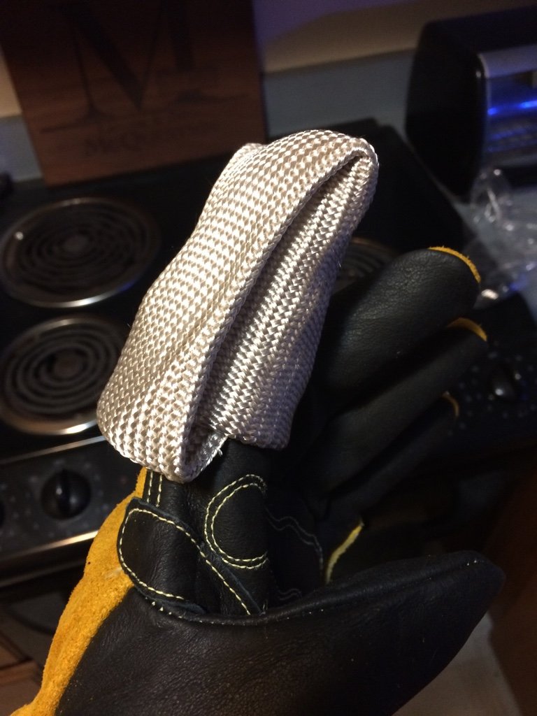

    Picked this bad boy up today, my new welder has a longer shield then I'm used to and I keep roasting my finger on my guid hand on long welds.

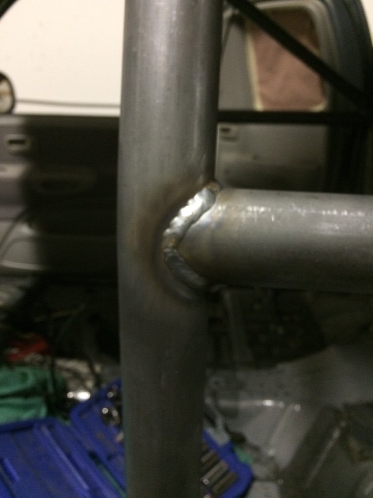

    Oh and some recent weld on my cage

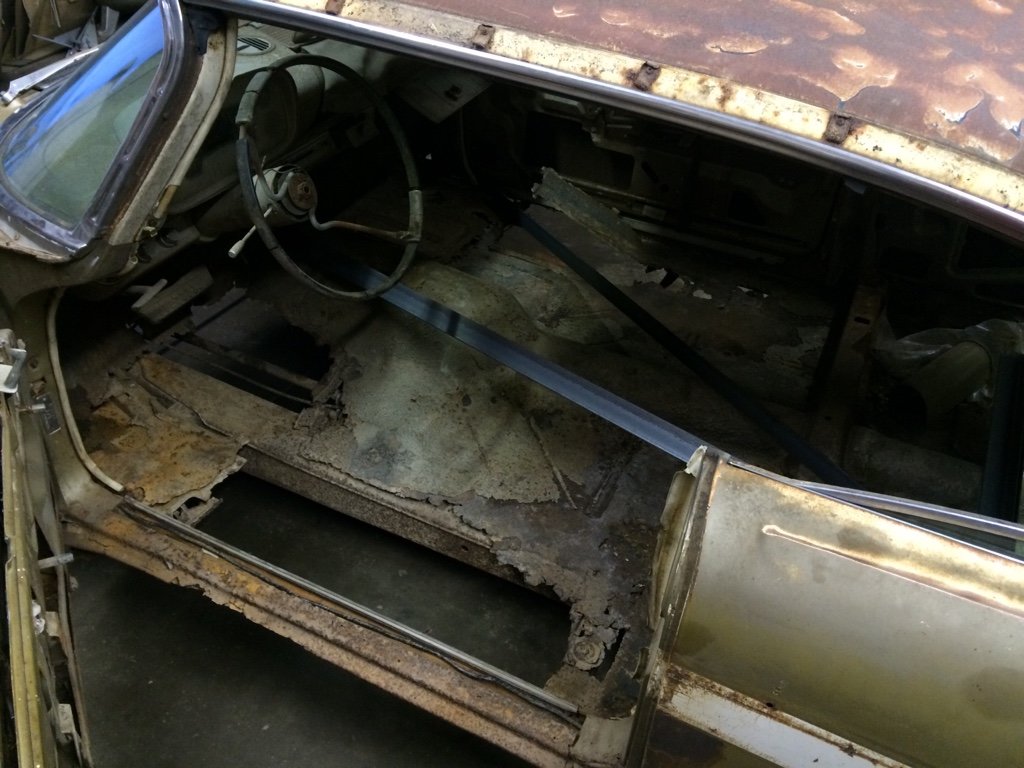

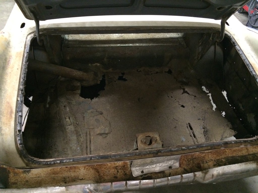

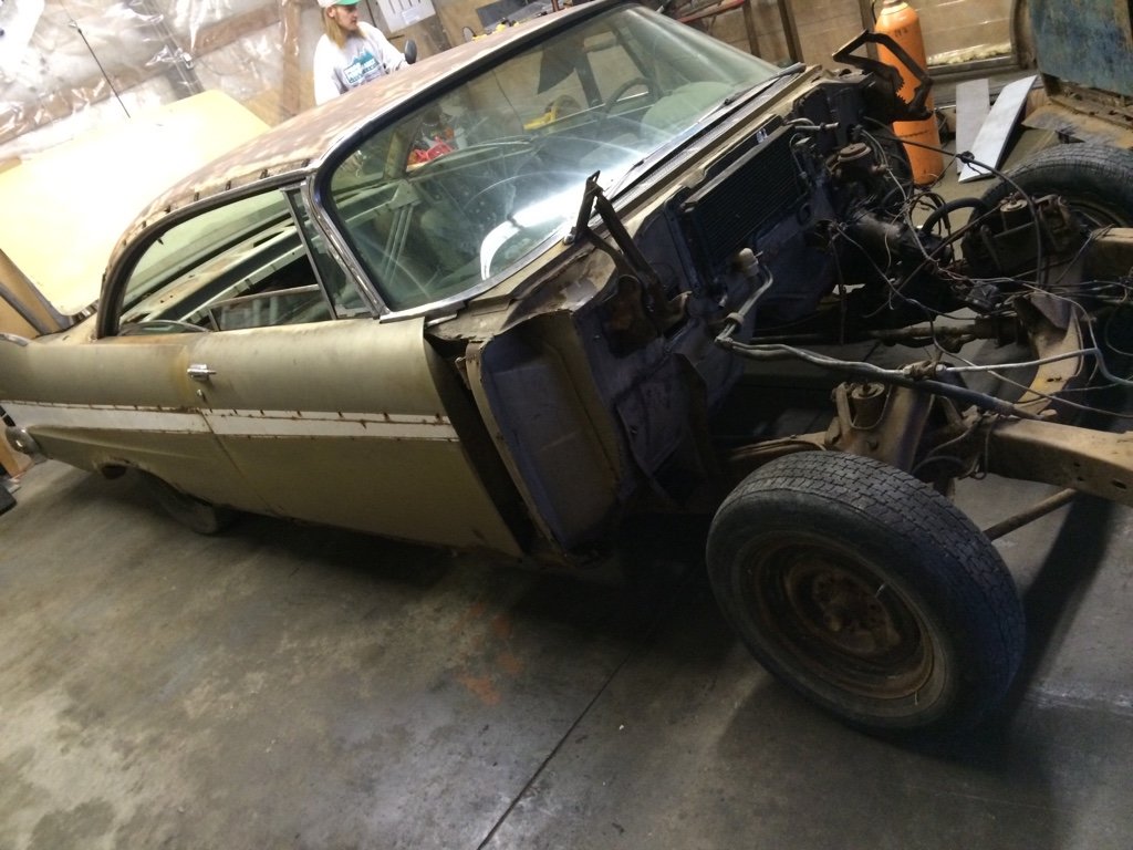

    My next welding project arrived today. It needs a lot of work!
